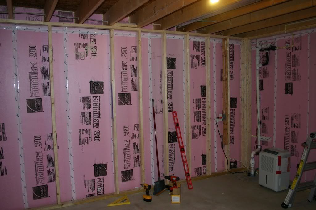

Since starting about 18 months ago I have completely insulated the basement and rim joists with 2" extruded polystyrene, installed a water powered backup sump system, installed an active radon mitigation system, fixed a stubborn crack with polyurethane foam injection and now I'm about 60% done framing the basement. The theater, game room and bathroom are completely framed and I am moving into the gym area now. I will be uploading all my photos very soon within the next day or so to get this thread up to speed of where I am in the project.

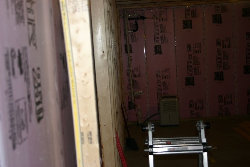

Here is one of the before pictures just as I had started insulation and got one storage shelf built. Many more to follow soon but I have to get back to work...lunch hour is over:

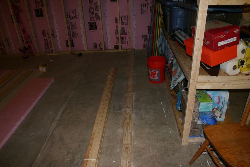

Some more pictures.
Storage complete and floorspace cleaned
Finally some space to work with!

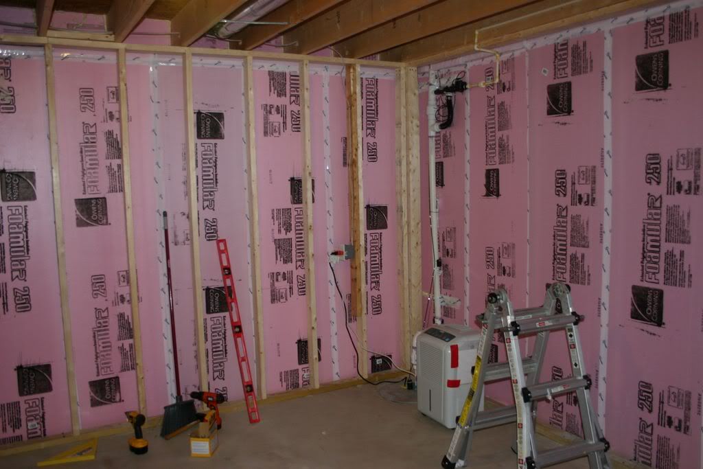

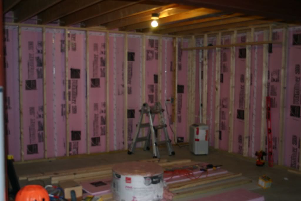

The insulating phase - I used great stuff foam to adhere the panels to the wall and to spray around the pieces in the rim joists. It was quick, easy and effective. I started using red duct tape for the seams between panels but then came to find out this wasn't correct and that I needed to be using a building wrap tape (like Tyvek) instead. So I yanked down most of the duct tape and replaced with Tyvek tape. The only place I still have duct tape is back in the storage area/workshop but I will change this over someday too. Not too worried about it since this area won't be finished anyway but I will do it nonetheless.
Doesn't this look fun?
I insulated all the rim joists as well
The insulation job is complete and I was happy to have this behind me. I can't say it was the most exciting job but progress is progress. The reward for finishing this is that I got to build some walls finally!

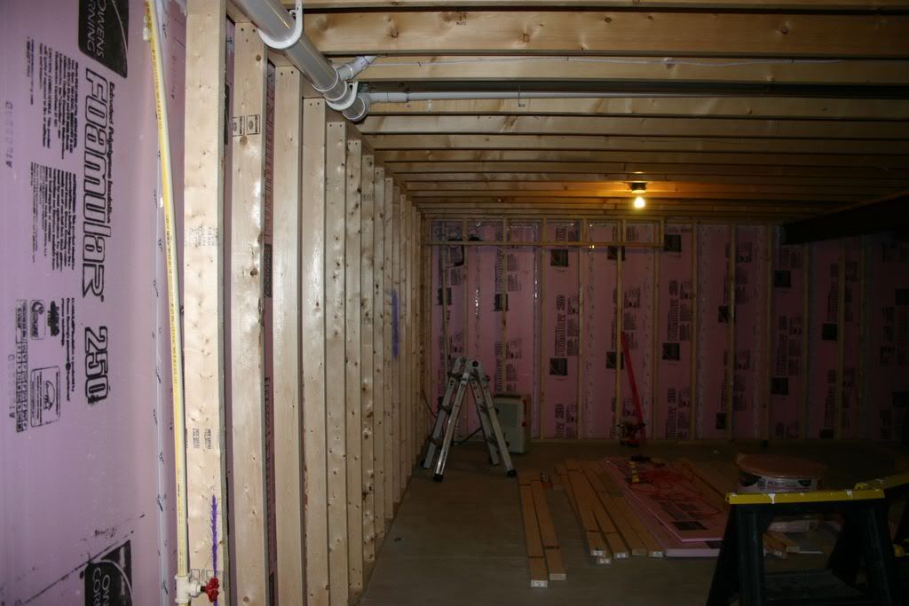

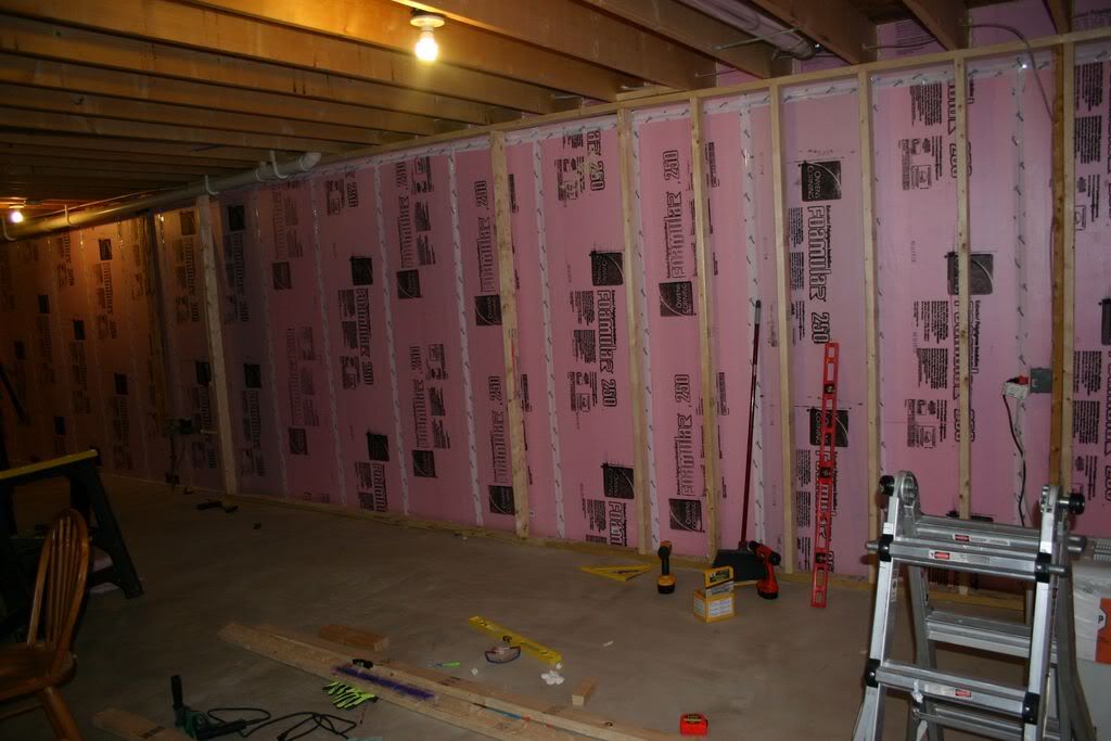

The beginnings of the framing: It was nice after all that insulation work to get back to using the power tools. I screwed everything. Tapcons for the pressure treated sole plates and deck screws for the rest of the studs/plates.
The first wall under way which will be the back wall of the theater and game room:
barlav is offline

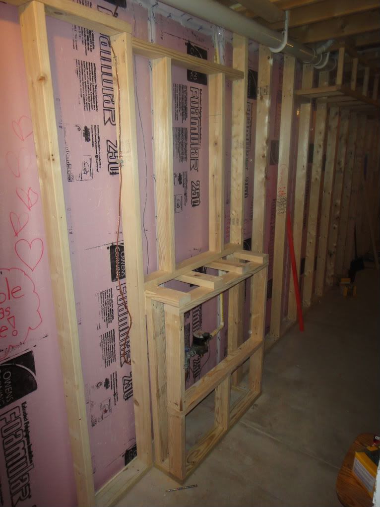

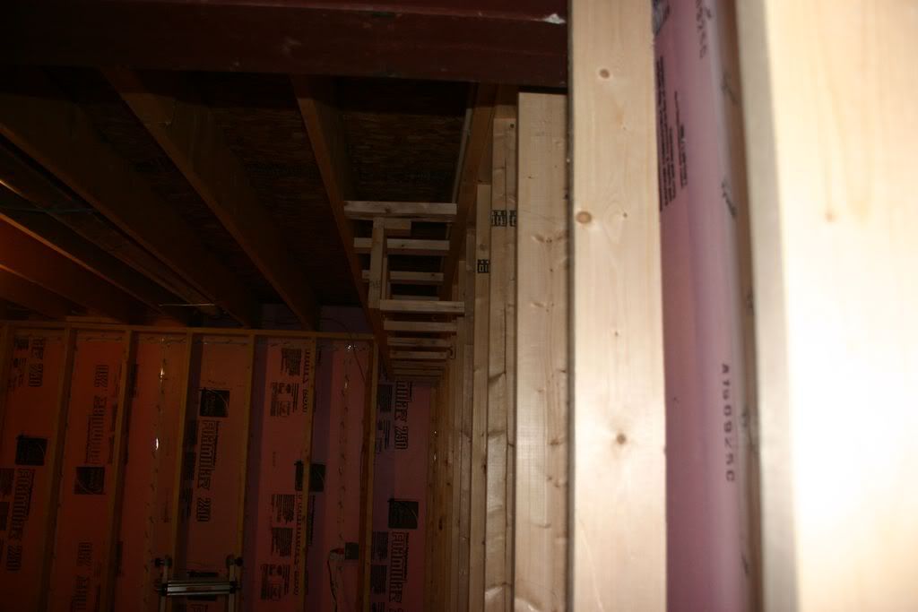

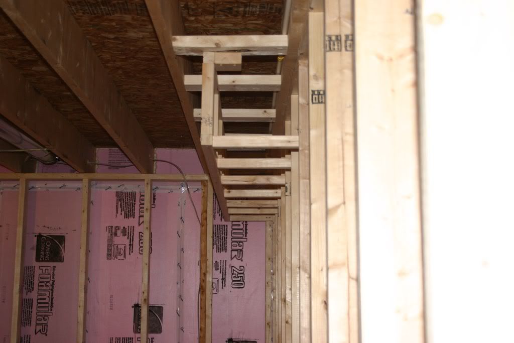

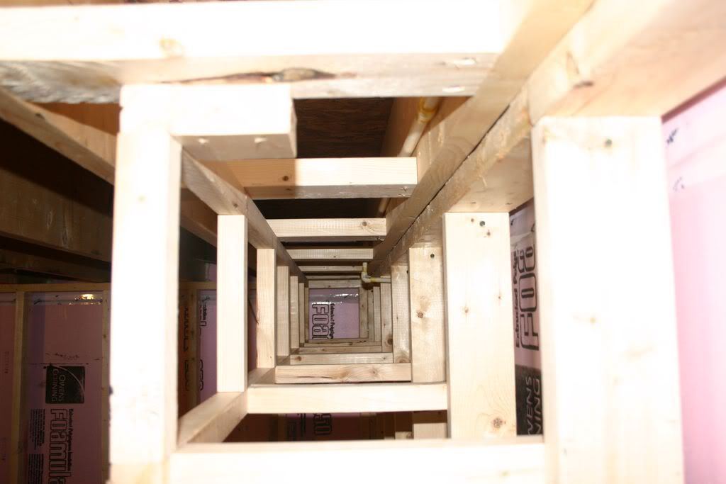

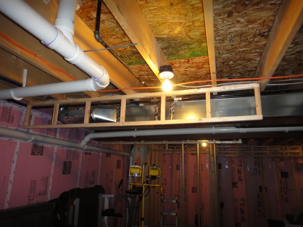

A couple more walls started and some soffit work under way. The theater and game room ceiling will be surrounded with a tray ceiling where I intend to put up a couple levels of crown molding and rope lighting. I wasn't sure if using 2X2s for the soffit work would be strong enough but once I got the first one up and secured I tested it out by doing pull ups on it and it didn't budge so that was good enough for me.
The top and bottom plate for the wall that will be the screen wall
A pointless picture from within the soffit but I thought it looked cool

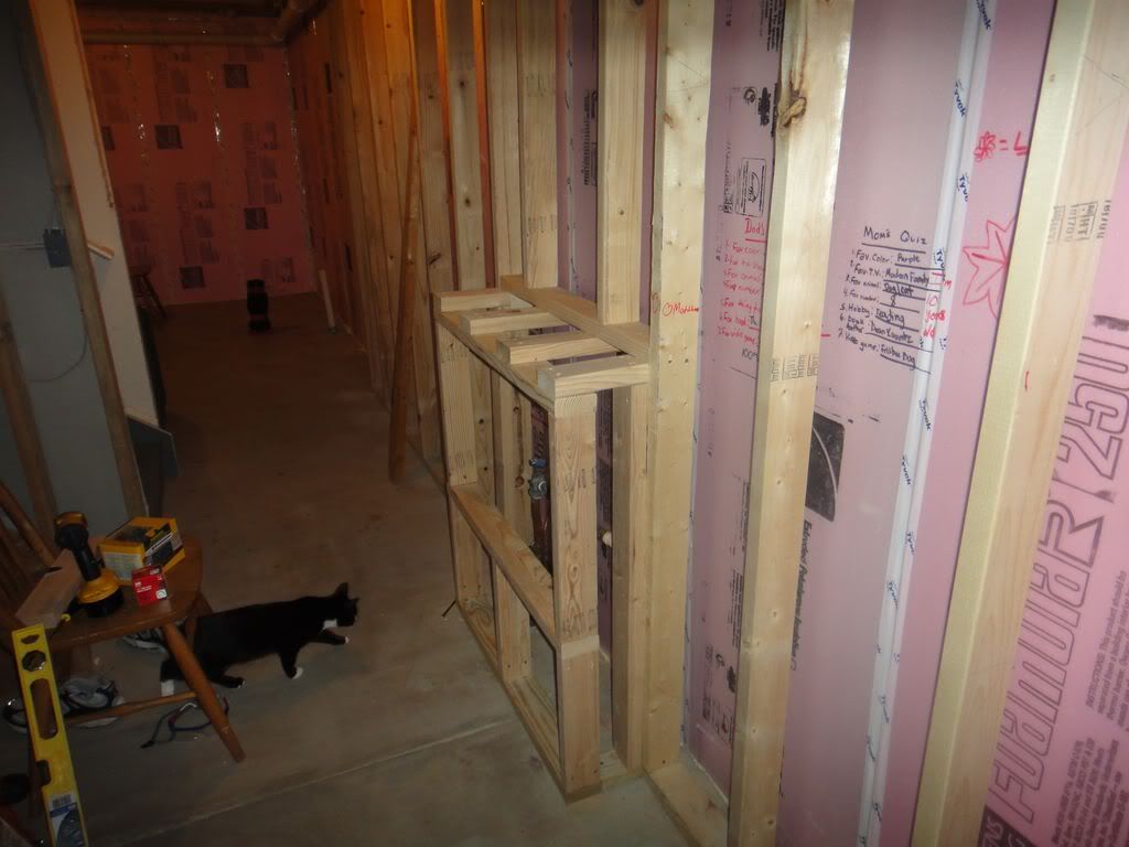

barlav's Avatar
Posts: 246
More framing and soffit work
A few soffit pieces ready for hanging
Behind the screen wall
I had to move the vent from the hot water tank to do get things the way I wanted them here
Improvised here to prevent having to move a water line. I wanted my tray ceiling soffits to be uniform around the whole room and this top plate fell right over a water line so I built the wall a little shorter and put the top plate between two other top plates to get it done.
The sump pit which will be in the left back corner of the theater. My plan is to trim this into a nice little shelf with a removable top so I can get at the sump if ever needed. I plan on using the top of this shelf for a popcorn maker or something.

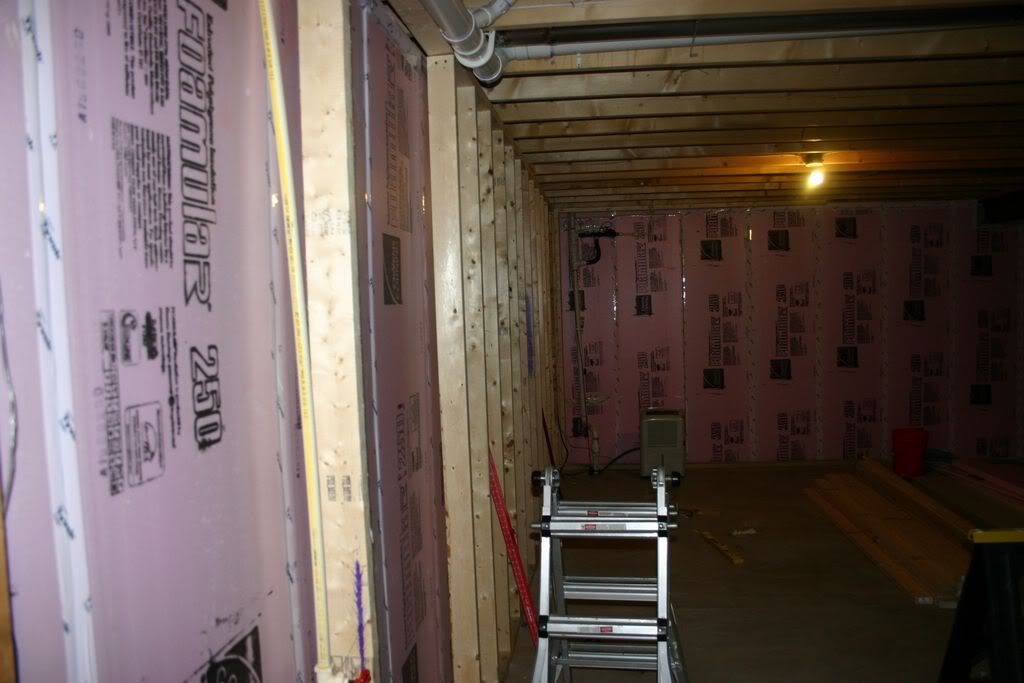

Some more framing:
Theater/game room framing complete. I still need to add fireblocking but I will leave that until later and do it all at once.
The soffit work over where the screen wall and stage will be

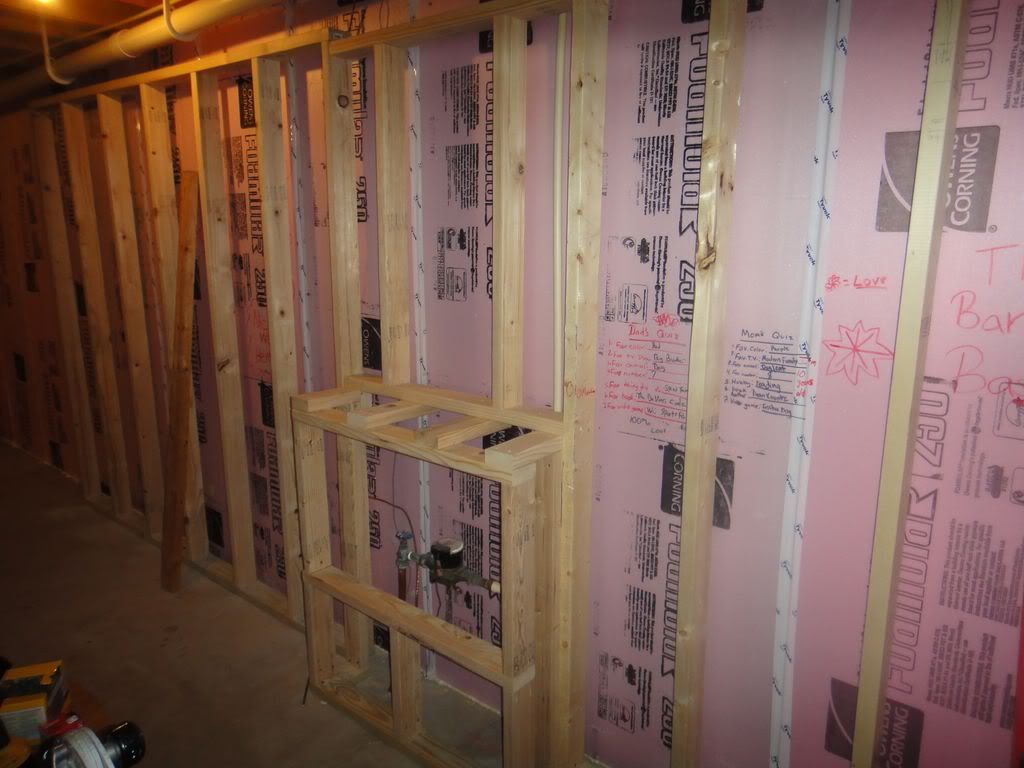

The stupid water meter - The water meter is right near the stairs. Really bad placement for this if you ask me. There is no way I was going to deal with moving it so I framed around it and am planning to trim it out nicely and give it an access panel while trying to make it look like it belongs there at the same time. I am going to put a touch screen above where the framing bump out stops that is going to function as a jukebox so maybe that will take eyes away from it.

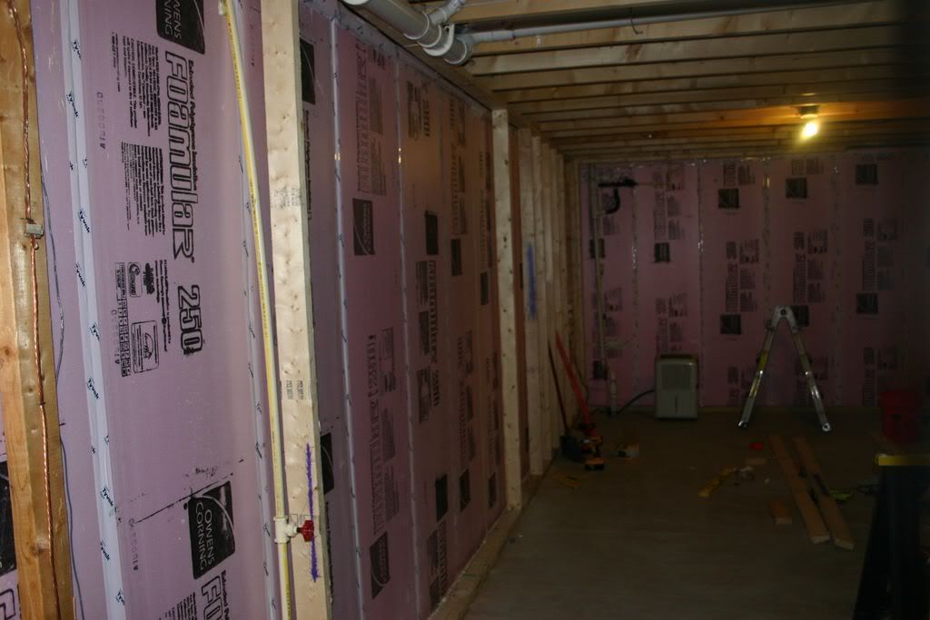

The rest of the framing up to today:
The bathroom layout and framing
The soffit completed all the way to where the bathroom starts
A view of the really freaking long soffit:

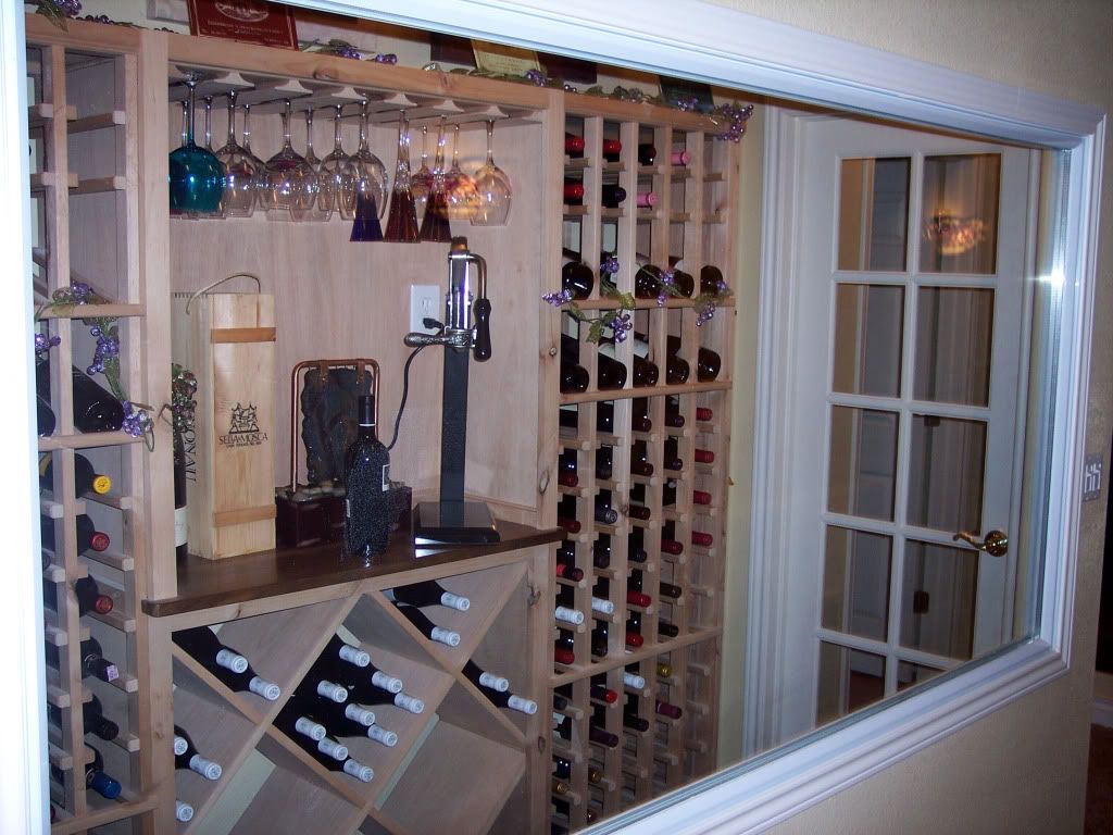

Oh, I also wanted to mention the wine cellar. The photos below are the inspiration for the wine cellar I am going to build. I can't remember where I found these photos but as soon as I saw them I instantly thought how perfect something like this would be in my basement. I would love to talk to the creator of this cellar if anyone knows who that is?
I am a huge wine enthusiast and I would like to expand my collection and this is the perfect solution for that and will add a unique flare to the basement. I am also going to open up some of the other side of the stairwell so you will be able to see into the wine cellar from the theater/game room as well.
As you walk down the stairs into the basement there will be a window on the left that is about 4'X3' where you will be able to look into the wine cellar. It will look very similar on the inside like the pictures do here. I ordered a window about a month ago and I should be getting it in the week or so. The window is a picture window with double paned tempered and insulated glass. I will post a picture of the window when I get it.
This will be the wine cellar but it will be right on the stairwell wall. I plan on using the same kind of door and cooling unit.
The window will be framed into the stairwell wall so that you can see into the wine cellar as you walk down the stairs to enter the basement. My window isn't this big but will be big enough to get the same effect I hope.
