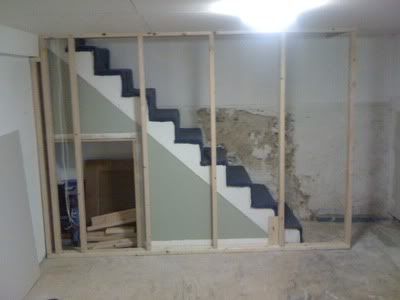

post #66 of 116 Old 03-16-2012, 05:17 PM - Thread Starter
Hockeypuck25's Avatar
Location: Medford, Mass
Posts: 322
Quoted: 12 Post(s)
Ok so cutting into the ceiling to add the wall in front of the stairs.
I figure if I lay some 3/4" plywood across the top along the strapping, that would bring it below the ceiling. That way I could build the wall a touch shorter than the ceiling, stand it up, sheetrock the stair side. Then I could push it right up against the existing green wall and stairs. Then I will attach it to the floor and ceiling.
Anyone have a better way?? Its non load bearing, not adding ouotlets. Its where my screen is going and the sound wont run right up the stairs now.
Thats the easiest, cheapest way I can think of. Im going to cut another access panel to under the stairs in my sons room on the back side.
With a 2x4 just so I could see space needed.
Hockeypuck25 is offline
post #67 of 116 Old 03-19-2012, 06:30 AM - Thread Starter
Posts: 322
Quoted: 12 Post(s)
Got the wall up Saturday morning with not much problem. Temporarily set into the ceiling so the kids dont knock it over.
I need to pull it out so I can sheetrock, sand and paint the back side, then push it up against the stairs and set it for good.

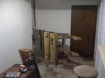

post #68 of 116 Old 03-25-2012, 09:46 AM - Thread Starter
Posts: 322
Quoted: 12 Post(s)
My father in law offerd to come over and help paint. Wasnt 100% ready but had him come over anyways. We got most of the walls primed with 2 coats. Looks nice all one color and yet another step closer. Bar base needed another coat of mud so didnt paint that yet.
BUT after priming everything white, the old stairs had to go. They were just nasty and old. AND while I have the stairs out, that back wall is getting redone also.

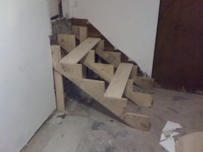

post #69 of 116 Old 03-25-2012, 09:52 AM - Thread Starter
Posts: 322
Quoted: 12 Post(s)
Here is my atempt at new stairs. The old ones were steep and had shallow stairs. The precut are 7.5" rise with a 10" run. To level it, I had to bring it down lower but from the top step to the bottom of the door is about 8" so it works out pretty good.
Since its my first steps, Im screwing everything for now and will nail when I get it all settled in.
post #70 of 116 Old 03-25-2012, 05:29 PM - Thread Starter
Posts: 322
Quoted: 12 Post(s)
I need ideas on how to finish stairs. Wall in back will be new so that side will butt up against there. The open side is where I am stuck. Build a short wall on that side? Don't like that idea that much.
Or drywall to the stairs. Then cut a 1x12 to match stringer to match riser. I'm so confused!!!!!
post #71 of 116 Old 03-27-2012, 06:51 PM
BeerParty's Avatar
Location: New Hampshire, USA
Posts: 1,076
What sort of railing are you putting up (if any)? That will dictate the type of finish you are going to want.
If you were not planning on a railing, I would go for something simple - drywall with a wooden stringer as trim.
Chris
--Despair, Inc. "Regret"
My AviaTrix TM Build
BeerParty is offline
post #72 of 116 Old 03-27-2012, 07:39 PM - Thread Starter
Posts: 322
Quoted: 12 Post(s)
No railing. I have been leaning towards an angled wall to enclose the stairs but I like the open look of drywall and a skirt board stringer. I think for now I am just going to do 3/4" plywood tread and riser then finish it after everything else is set. Give ms time to think it over.

post #78 of 116 Old 03-30-2012, 06:07 PM - Thread Starter
Posts: 322
Quoted: 12 Post(s)
So the last thing that was bothering me was the wall behind the stairs. Again it was all rotted and nasty. Replaced it with new 2x3's and framed out for a 30" bifold door. Also gave myself a little more wiggle room for the stairs. Im happy with it now.
No thats not a second bathroom, just the old toilet I havent tossed out yet. My town went to the "2 per house" trash bins and now they dont take any house debris.

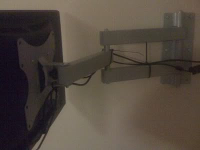

post #83 of 116 Old 04-05-2012, 05:20 AM - Thread Starter
Posts: 322
Quoted: 12 Post(s)
Monitor came yesterday and while I am very happy with the function of it, it may be a bit small. Maybe its just because I hate my basement right now (too much time down there fixing little stuff) or that there is nothing on the walls, no trim up so the empty walls kind of eat it up. But 32" 1080p Tv's that look good are double the price I paid for this monitor. Eventually I will have the projector on the other side of the room so its not the main tv but it just looks small to me.
Ill give it a bit to grow on me. My son and daughter love it though. Maybe im just cranky....
My wireless mouse crapped out on me so my son hacked together a USB extension to have a mouse for now.
Monoprice mount. Need to pick up a 6' VGA Slim Extension so I can hide the junction point for the cable behind the wall. Need a longer HDMI for the PS3 that will be in cabinet.
