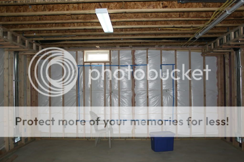

Ok framing is completed except for a couple of minor things in my open room concept.
Width is 17'4" inside faming and 19' deep.
Front wall showing blue tape of 120" diagonal screen(105" wide, 59" high) 16:9. My problem is I can go bigger in my screen but my first row will only be 11'5" to eyeballs before riser:
I can't do false wall and transparent screen due to depth and I plan on hiding speakers in a proscenium.
Any comments here?- was thinking of keeping same height and going wider for 2:37 layout

post #6 of 10 Old 04-25-2011, 07:41 AM
tlogan6797's Avatar
Posts: 5,196
Quoted: 106 Post(s)
Liked: 133
Looks to me like if you are planning to keep that window, you probably do not want the screen to be any taller. That would make the bottom even lower to the floor. I think right now you are probably as low as you want to go. Your feet will be in the way when reclined. If you want to go bigger, go the 2.35 route and make it wider, but no taller.

post #7 of 10 Old 04-25-2011, 12:28 PM - Thread Starter
rthompson10's Avatar
Join Date: Mar 2009
Posts: 79
Tom,
THanks- was going to plug the window and cover with drywall- So I should move the screen up? I have roughly 8.5 feet floor to ceiling where the screen is
RT

post #8 of 10 Old 04-25-2011, 12:37 PM
tlogan6797's Avatar
Posts: 5,196
Quoted: 106 Post(s)
Liked: 133
I would.
General rule of thumb is to have eyeballs about a third of the way from the bottom of the screen. Looks to me like you are closer to halfway. Then, depending on what you want to do for a screen wall, maybe you can go taller.
I still like the idea of going wider for a 2.35 screen. Then your 16:9 image can be as big as it is now, with black bars on the side.
