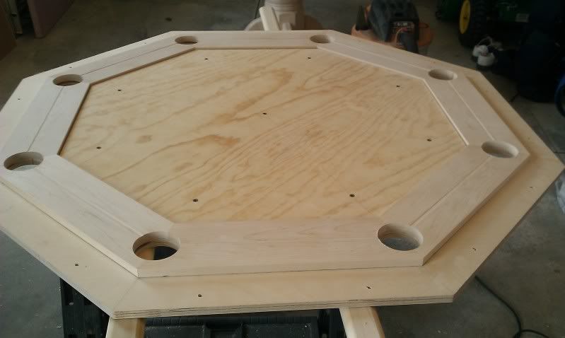

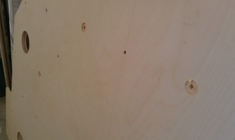

Well since the Theater is pretty much done...and I have a Graduation coming up, my daughter is graduating, brings a tear to my eye So Me Bride told my when we built the house the bar needs to be complete for Brooks graduation....well game on I have 4 weeks, we have been here 4 years this June I have the bar stuff ordered and in the mean time I have started building a poker table. So I thought I would share the table build then the bar build as well here. I am pretty far along on the table and should be complete early next week.

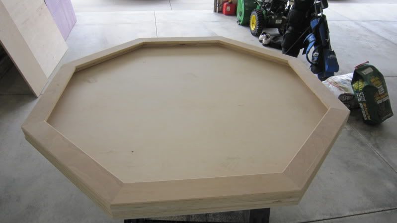

I decided for my own table I wanted an octagon, not real popular but I think these look pretty classy and my games are rarely over 8 people. I also wanted a gaming table that was nice to play Uchre and other card games which a Pro hold em table doesn't fit real well.
So lets get on with it

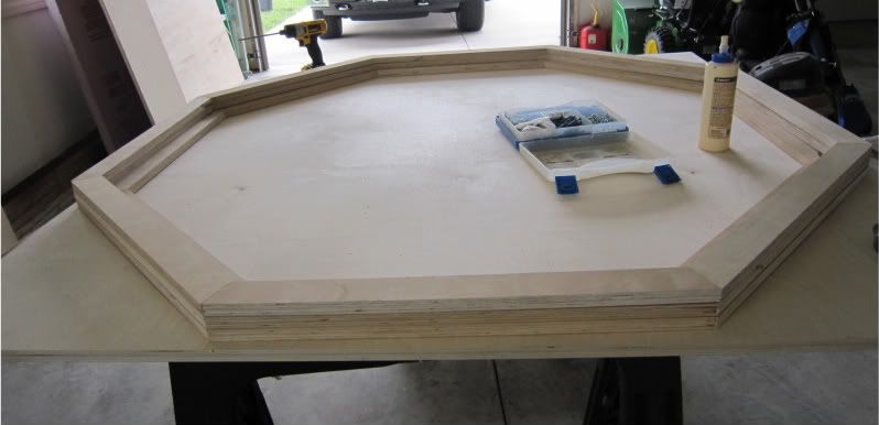

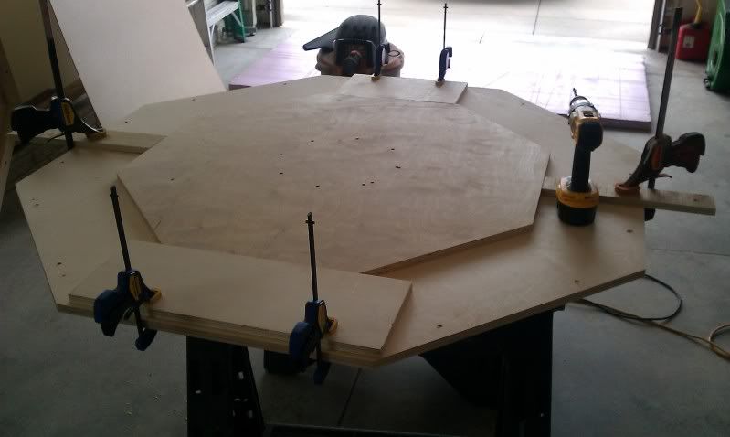

The table is 58" so I special ordered some 5x5 ply wood, only takes 2 days to get from a local lumber yard. Barely fits in the back of the truck :shock:

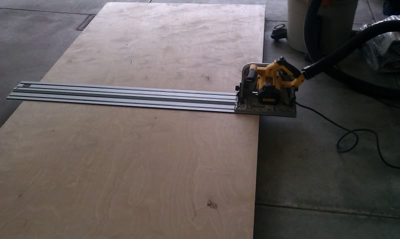

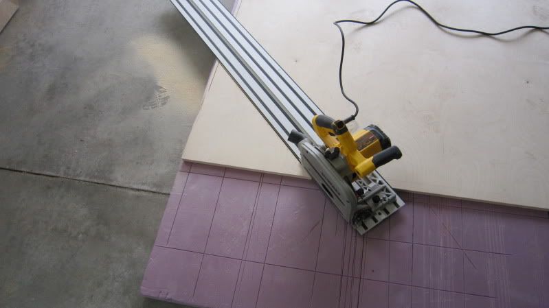

First I cut a 4x8 sheet down to a managable piece with the track saw, the other half I will use as the sub base

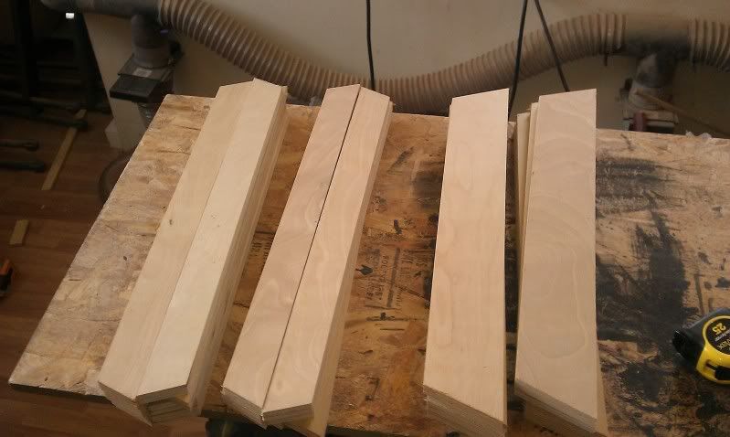

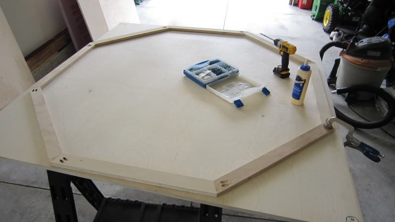

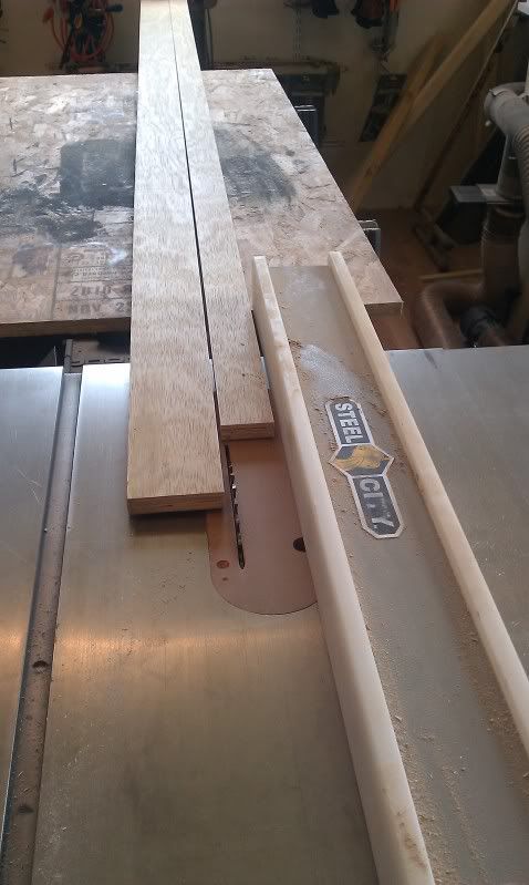

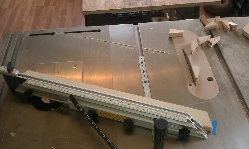

Then cut strips out of some 3/4 ply and mitered them on the table saw

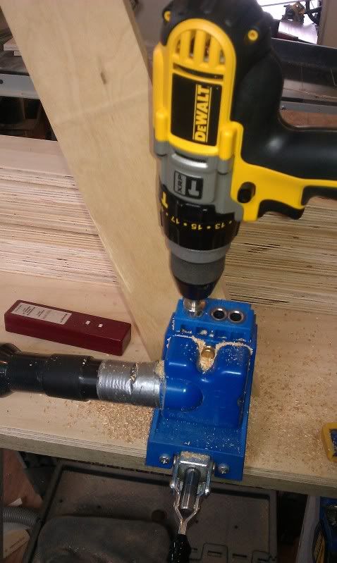

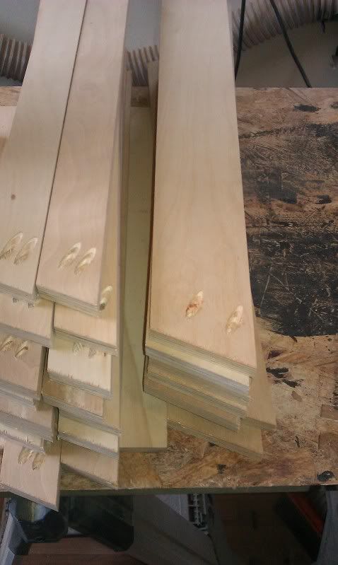

then pulled up a stool and drilled a bunch of pocket holes on one side of the miter
Once complete it was quit work to glue and screw and fit perfectly
Once all three "rings" were complete I simply screwed and glued all together, rounded over the edges and the raw rail was complete
Next I used the rail as a template and traced around and broke out the track saw again and cut out the base
I left the line on these cuts as I will run the flush cut bit around to finish it off. But it fits good as is!
The table will be assembles using threaded inserts and joint bolts found in RTA furniture.

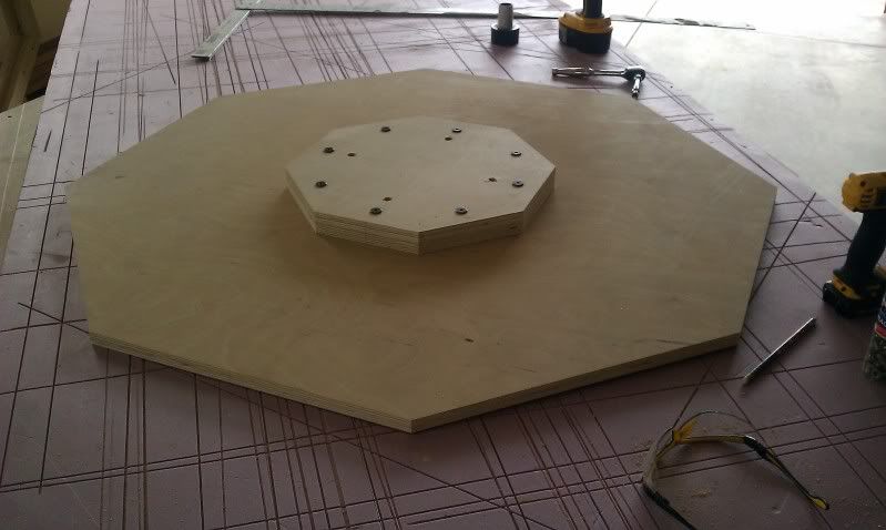

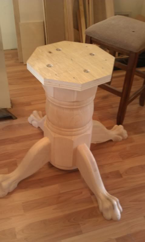

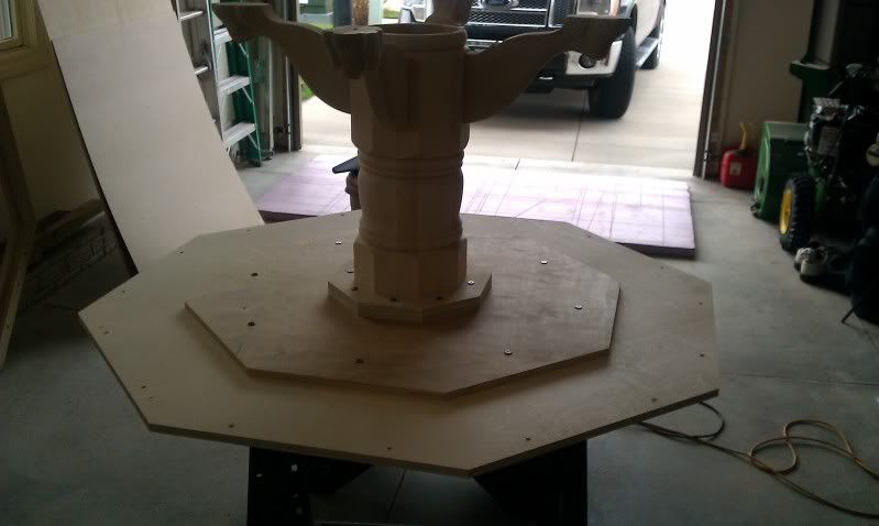

Made the pedastal sub sub base....wanted to raise the table up a bit
Then cut sub base and mounted these two together
Then the sub base to the base
And fit all together

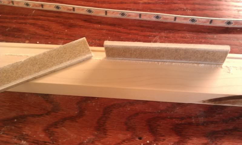

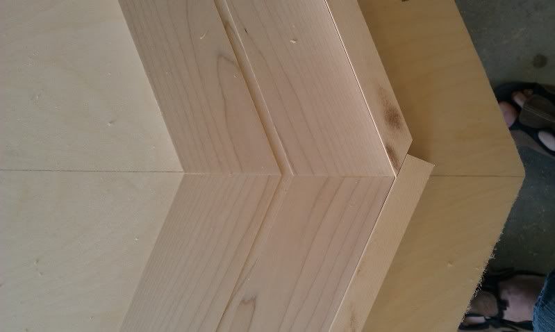

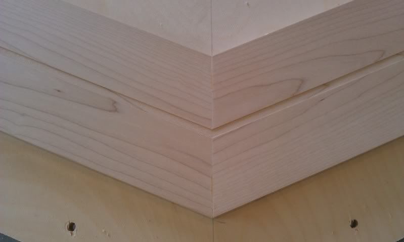

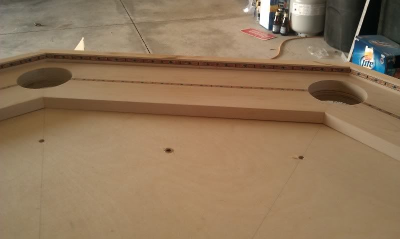

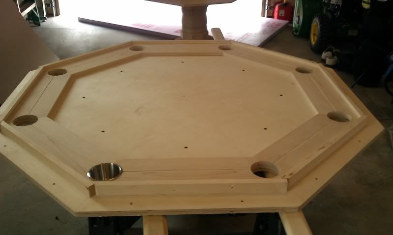

Was able to get get the Race track and inside riser complete as well as the cup holders.
Started by routing all the race track for the single inlay and assembling the race track

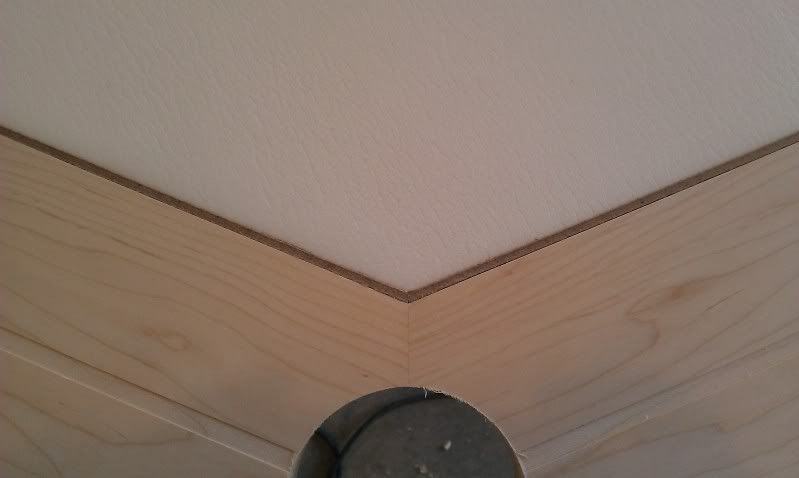

Then cut the riser pieces. Notice the "reverse" miters. This allows you to just miter on end with not much care about length other making it long enough for the overlap
I normally cut a sharper angle by a degree or so you get a real tight miter joint. Note the riser is just floating and not attached.

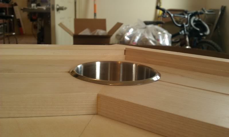

Then routed the inlay dado for the riser and cut the cup holders. I cut the maple using the router and the Jasper jig, flipped over and cut the ply with a smaller
hole saw then used the flush cut to clean up.

Well I am getting closer! I finished up the playing surface this afternoon.
Cut out the half inch ply. I used a piece of the 1/8th inch hardwood as a spacer when I traced it out. Once cut I tested the fit using little spacers all around and it fits perfectly
Then tackled the mounting. Some more of the same here, I countersunk the head side for the sub base.
Tested the fit
Then stuck down the foam and installed the hardwood boarder.
this method of the boarder allows for the playing surface to be level with the race track. A common method is to just cover the foam that leaves a slight round over. No big deal but this is a nice added detail.
Looking good so far. I need to get the inlay in tomorrow. Been troubling with how to do this in terms of finish. Want to make sure the inlays do not get the color finish on it. Not sure if I will shellac mask or what....any suggestions?

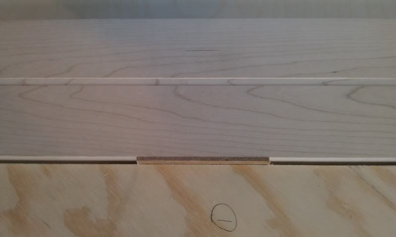

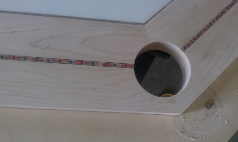

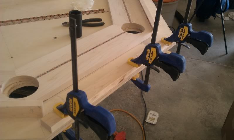

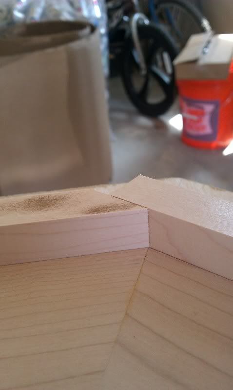

Well I slow boated the build a bit...Been trying to get up to speed on using dyes for finish. but I thought I would toss up an update of where we are

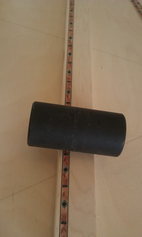

I decided to install inlay into the race track and riser. This is the first time using and thought I would share on how I did it. Probably the long route to get there but seemed to work pretty good. the inlay I bought is specified as 5/16, so I order a 5/16 router bit to cut the dado, wrong! I found out pretty quickly that this inlay is far from constant and was not even close to fitting width wise. So i ordered a 11/32 router bit DOA! This was way sloppy! So the ticket I found was to tape sand paper to scrap 1/8 hard board to sand the side. This allowed me to sneak up on the width with out removing material from the bottom. Took some time but a good music listening beer drinking activity
Once the fit was good I used a big Ole socket as a roller. I remember buying this thing for something on my CJ7 years ago but is now my inlay roller!
After a few pieces i noticed the mitered end of the inlay was not completely seated in the dado so I started to clampt to the base to make sure it use securely glued...
And bam here we go. the race track is sanded flush I still need to hit the riser but here are the dry fit pics
Tomorrow is Finish day! I have been big time troubling over the finish. My first attempt at an all spray finish using dyes and toners and stuff I have no clue about. Add the inlay and I was nearly ready to pass out! I spent a great deal of time on the finishing forums and have decided that I am going to come up with a finish schedule that I can blast over the inlay and still have the look I am looking for. I will be running a bunch more test samples then going for it. Should have this wrapped and in the basement by mid week

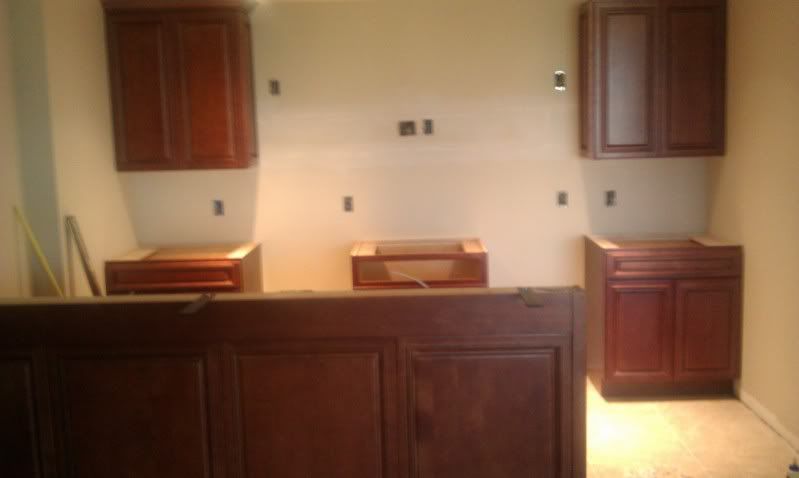

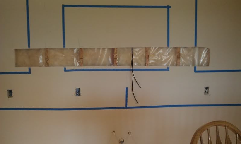

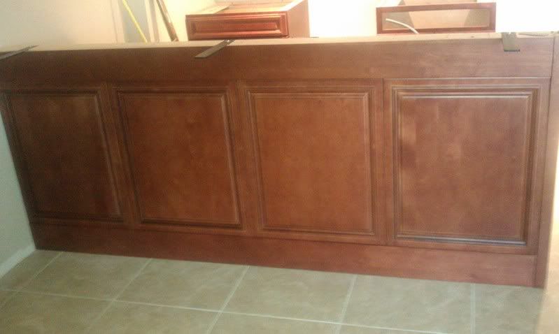

I haven't been taking to many pics but here are a couple crappy ones from the evo

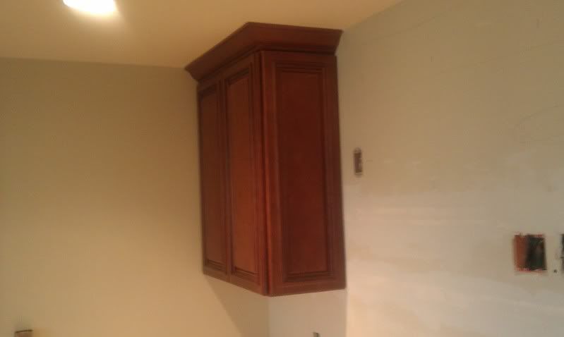

I needed to preform surgery to get some electrical and comduit in for the flat screen

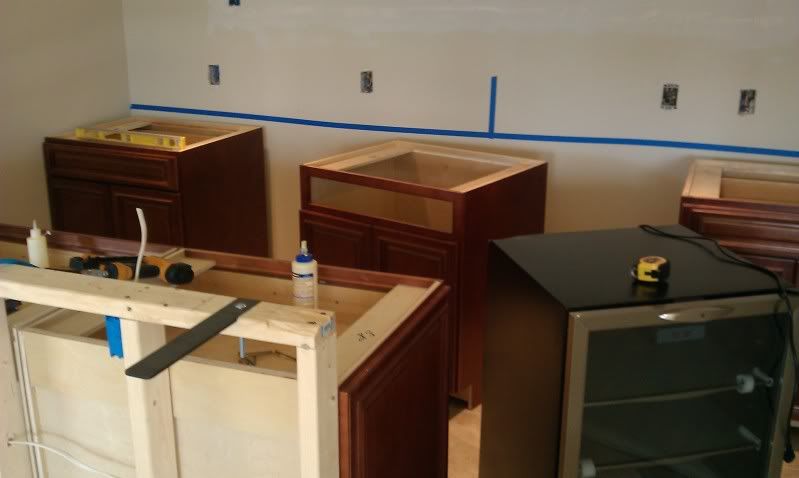

Got all the cabinets finished and down stairs

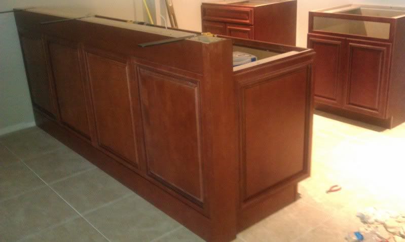

Notice the flat stock bar supports. Just dado'd them intomthe bar wall
And the cabinets set and the bar front complete
I have the counter sub straight almost complete so with any luck I will get the copper glued on and ready for epoxy today.
Cheers jeff
