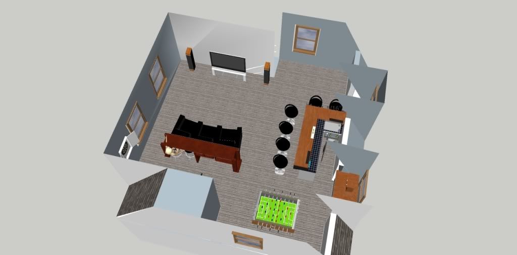

Old 05-22-2011, 12:13 PM - Thread Starter
saucemanpc's Avatar
Join Date: May 2010
Posts: 36
Here are some updated sketches of what I'm looking to do in the space:
I'm going to wire it as though I'm going to be putting a PJ up and in-walls speakers.
What do you guys think?

Old 06-21-2011, 01:25 PM - Thread Starter
saucemanpc's Avatar
Join Date: May 2010
Posts: 36
I've actually added a small siting area behind the theater seats.......what do you think?

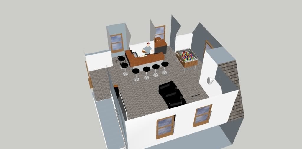

Old 06-27-2011, 06:12 AM - Thread Starter
saucemanpc's Avatar
Join Date: May 2010
Posts: 36
I definitely would like to put a pj up there eventually. My main concern with that would be that it won't be temp controlled environment 100% of the time. I will be turning the AC/heat only when I go up there. Therefore, I may just go with a larger (73") DLP for now.....unless you can talk me out of it.
I changing the room around a bit. Here is my sketch:
I'm putting up my knee walls as we speak along with the electrical. I will try to snap some pics today.
saucemanpc is offline
Old 06-27-2011, 08:24 AM
hanesian's Avatar
Posts: 2,878
Quoted: 25 Post(s)
Liked: 69
My two cents: your last layout is a bit lopsided. You've scrunched too much on the one side of the room, leaving the game area to occupy the majority of the space. If you really intend to have games be the main focus of the room, fine. Otherwise, I'd go back to one of your earlier designs that has more balance.
Also, I may be biased, but I don't follow your reasoning for going with a huge (expensive) TV instead of a larger and less expensive PJ. Lack of temperature control will be a problem in either case, but I don't know of anything that indicates that a TV would be more temp resistant than a PJ.
Your lack of regular temperature control may be your real issue, as that alone could keep you from using that room as much as you'd otherwise like. I'd be reluctant to invest a lot of money into that build without having a plan for year-round temperature control, even if it means holding back on some equipment purchases now. It's easy to add equipment later; it's not so easy to retrofit climate control.
Oh, and congrats on winning the Stanley Cup again! Don must be thrilled!
The Un-Theater Un-Build
hanesian is offline
Old 06-27-2011, 08:58 AM - Thread Starter
saucemanpc's Avatar
Join Date: May 2010
Posts: 36
Thanks for the input hanesian. The reason for the change in design was so that people at the bar could just spin around and watch the big tv. I completely agree that I am scrunching things in on that side, but I think the ability to watch the tv from the bar outweighs the tightness. My opinion.

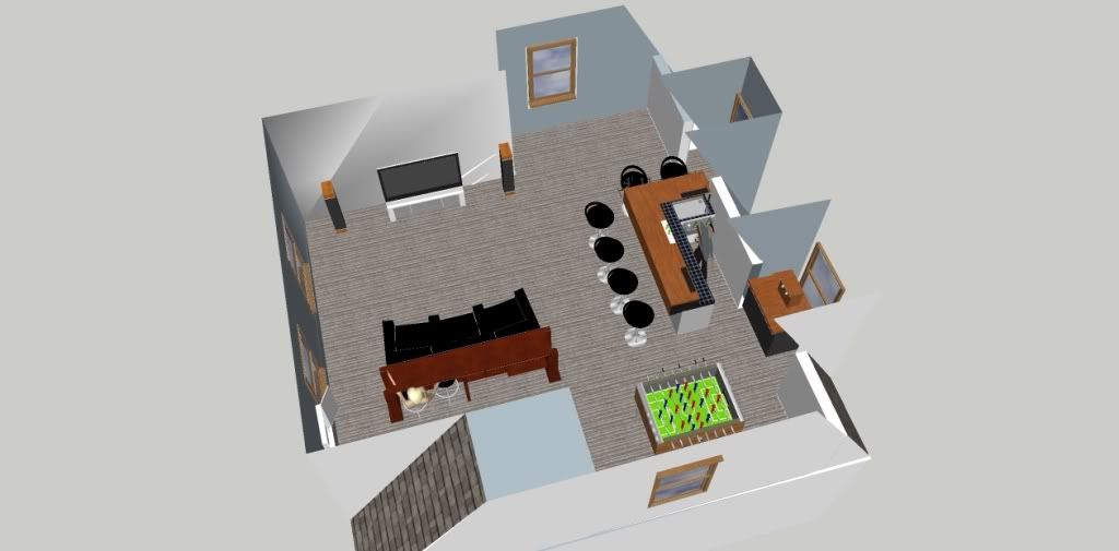

Old 06-27-2011, 11:58 AM - Thread Starter
saucemanpc's Avatar
Join Date: May 2010
Posts: 36
alright........how about this.
Old 06-28-2011, 08:14 AM
Scout's staff's Avatar
Join Date: Jan 2011
Location: Massachusetts
Posts: 590
I have to agree, I liked the bar back in the original corner. Maybe swing it out at a 45 degree angle. I also think you would be much better off having the room temp controlled. You can always have the thermostat turned down to say 50 degrees in the winter and 80 degrees in the summer when not in use.
The drawings are looking good - best of luck trying to get the girl in the bikini to show up

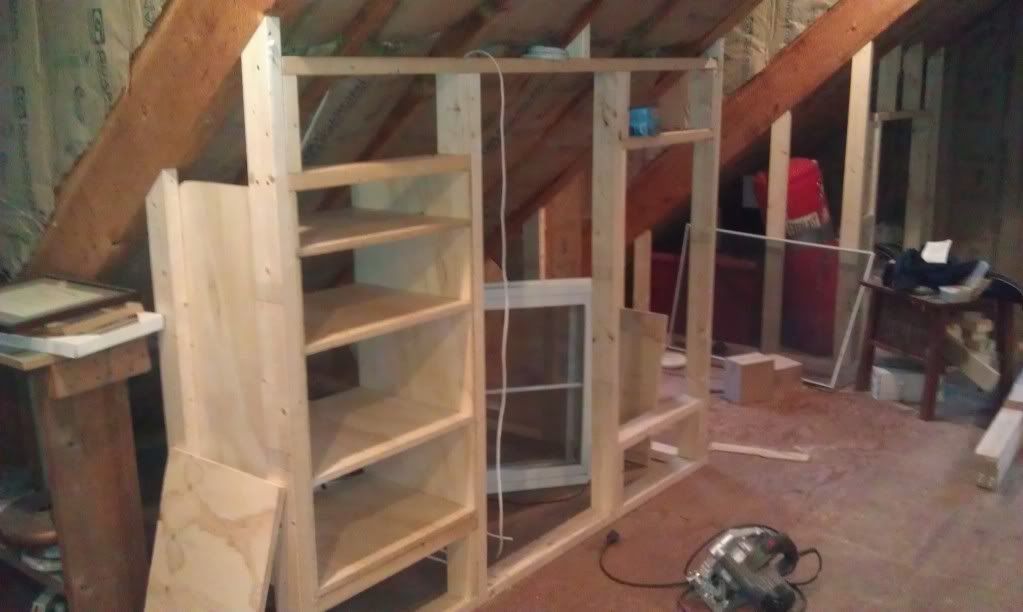

Old 07-26-2011, 07:46 PM - Thread Starter
saucemanpc's Avatar
Join Date: May 2010
Posts: 36
Some more "small pics". The screen wall, bar skeleton and framing of the av rack.

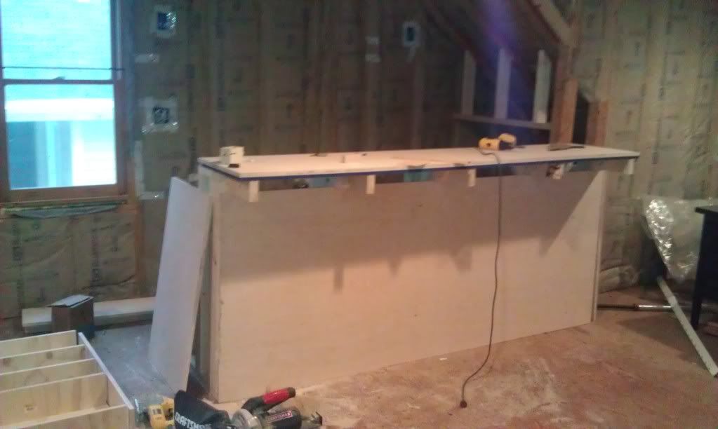

Old 08-15-2011, 02:44 PM - Thread Starter
saucemanpc's Avatar
Join Date: May 2010
Posts: 36
Here is a shot of my diy audio rack almost finished:
and the bar with a little maple skin on it:
