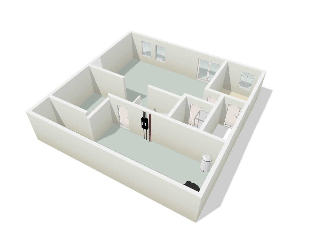

Here are the plans:
2D
3D

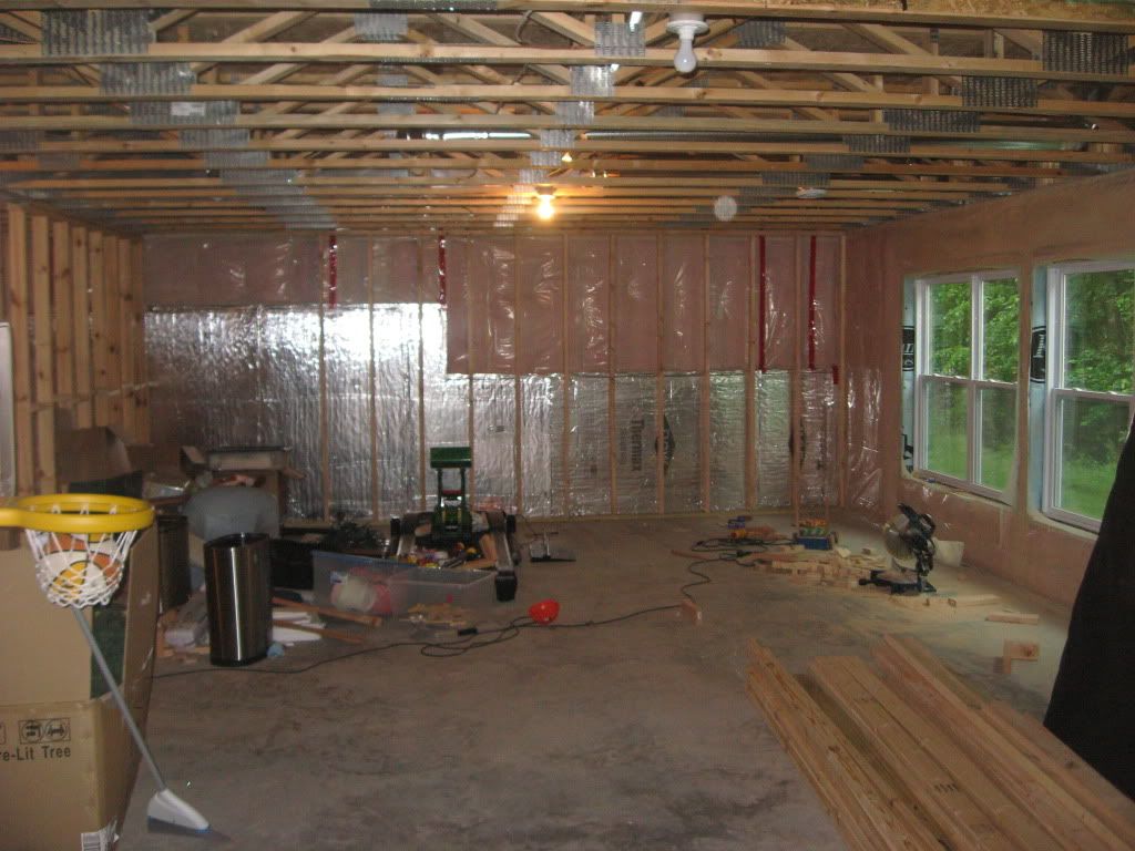

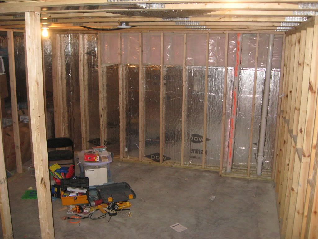

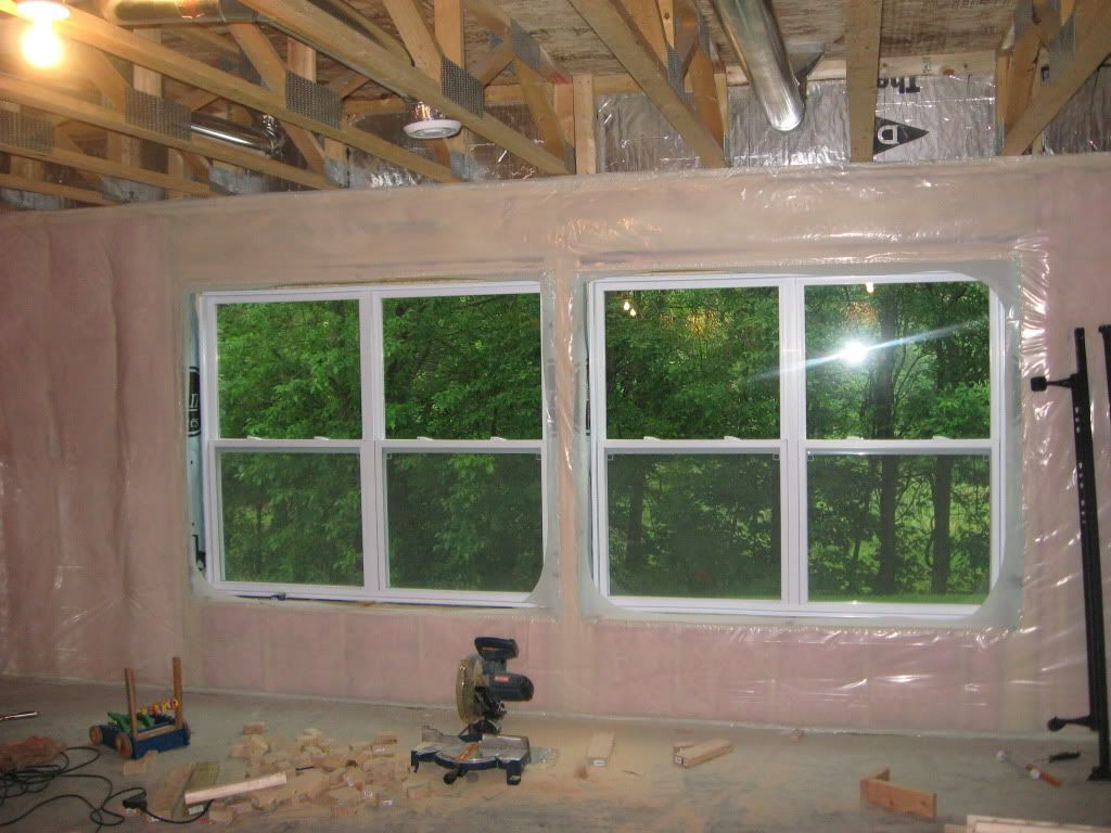

Here are some pics of the space and the build:
Media room:
Screen wall:
Playroom:
Walk-in Closet (to the left), Bathroom (to the right):

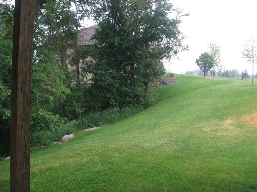

One of the view's from the media/rec room:
Bedroom:
View out the sliding glass door:
More views out the walkout:

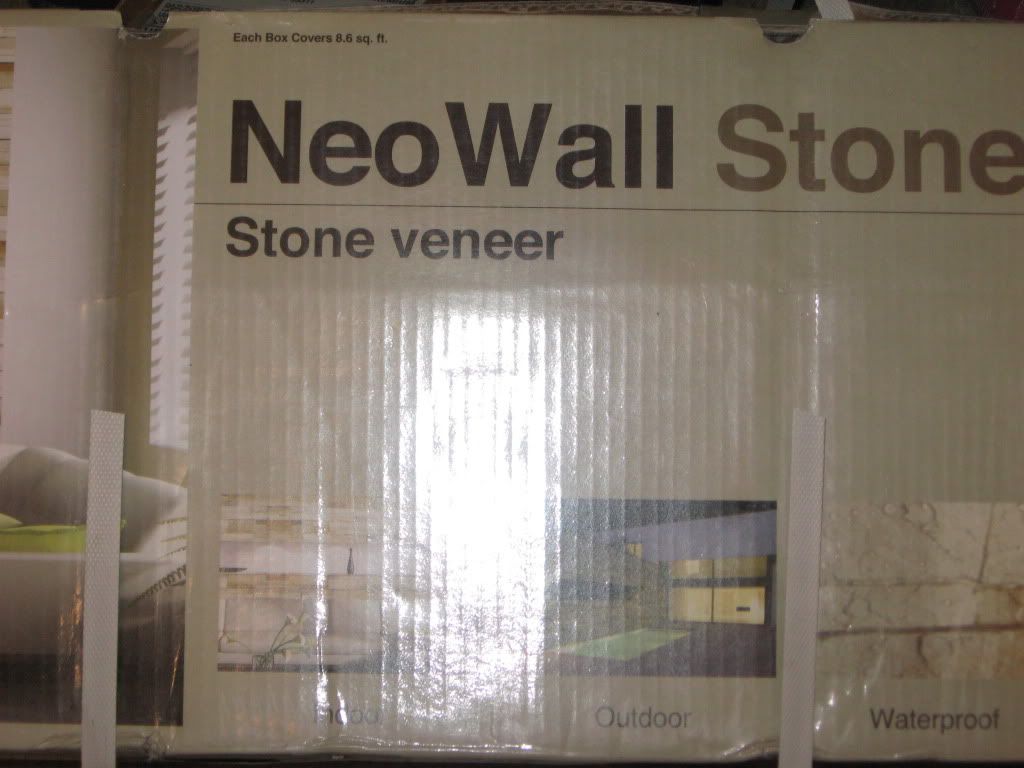

For the bar and fireplace area, scored a great deal on stone veneer at Costco. $24.97 a box ($2.99 a square foot). Ten boxes later, unloaded the van.. Heavy stuff, but this should really compliment our wall color...
This is a great price.

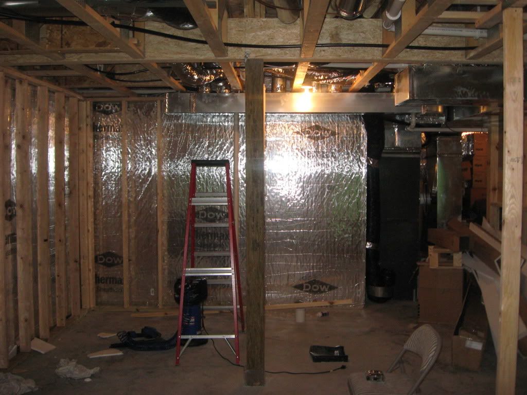

EDIT: What is that mixture of insulation on the one wall? Looks a bit unusual. Is this new construction with the insulation by the builder?
Hanesian, thanks for the support. After hauling all that stone veneer yesterday I feel like this:
As for the insulation mix, that is an exterior wall and the builder put in the original insulation and vapor barrier. I am asking the question now in the dedicated theater forum on how to handle it:
http://www.avsforum.com/avs-vb/showthread.php?t=1342095
Let me know if you have any thoughts on this.. I am guessing I need to remove the vapor barrier, insulate with unfaced in the wall cavities, than apply a vapor barrier to the new wall which is the heated side?
That's pretty much what I would do. Further rambling thoughts/details in the separate insulation thread you linked.
This seems to be the consensus in the other thread. I will check with the local inspector to see what he thinks.

Unless there are a bunch of pipes or a sump pump in the bottom left corner in the mech room, which I can't tell from the pics, why not extend the play room all the way to the exterior wall, making the mechanical room smaller? Seems like a waste of space.
That is a great price... nice score. I have 6 boxes sitting down stairs, waiting for me to install after drywall. I bought them about 3 months ago (thinking they would go fast) for about $38/box.

The scale is a little off for the storage/mechanical room. We really debated making the playroom larger, but, we are a family of five with lots of crap. So we went with more storage. My neighbors have a similar floor plan except the builder gave them little storage, and they helped us decide to have a little more.
Funny enough, I almost jumped at $38 too. After pricing out the local big box stores you still scored a great deal.

Have a fireplace consultation in the morning. Going with this gas fireplace in the corner:
Instead of tile will be using the veneer as posted above from Costco. Plan on having the fireplace about 12" off the floor so I can carry the veneer below and above.
Going to make a big push this weekend to get the rest of the framing done (or most of the rest if that makes sense). Plumber coming on Wednesday. Waiting on one more final bid for electrical and then I will be pulling the trigger. It will be nice to let somebody else do some work
