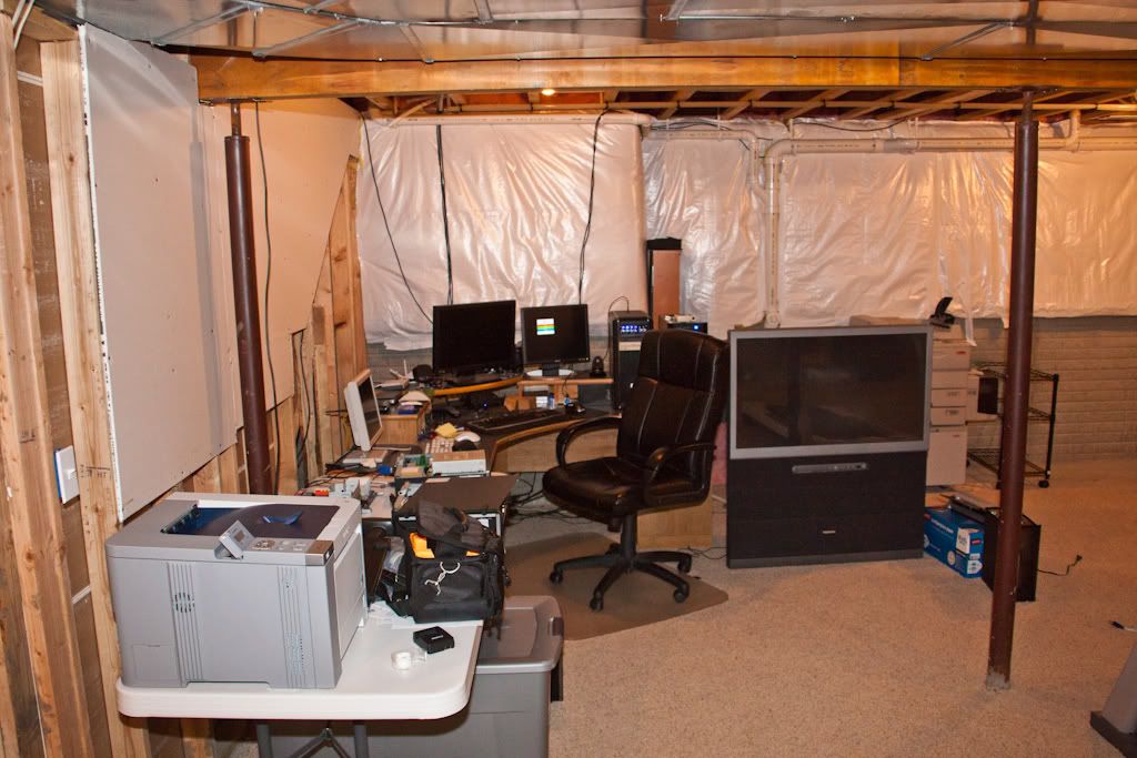

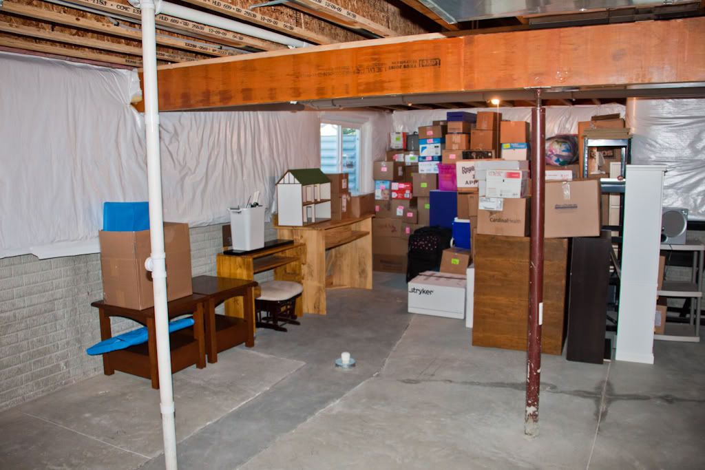

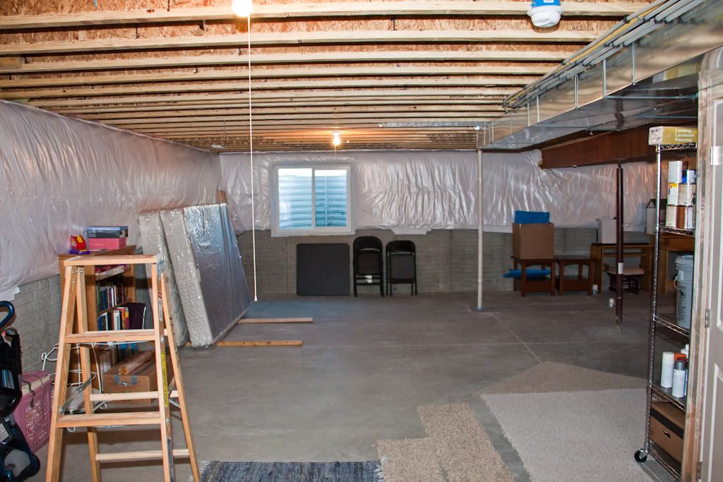

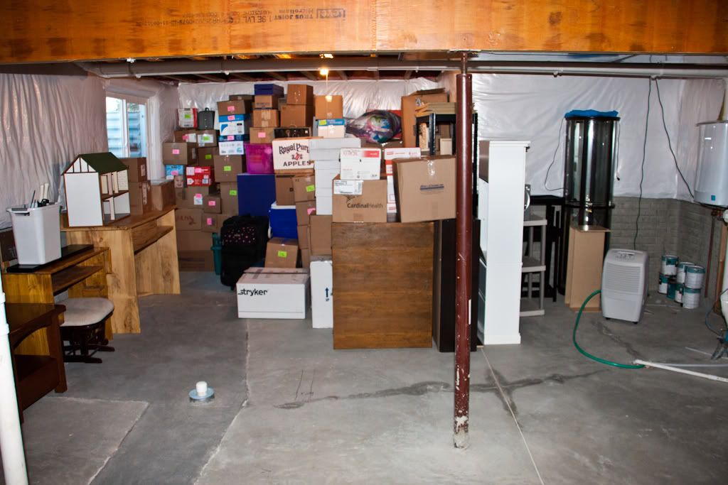

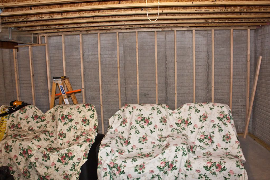

EDIT: Got some pics done tonight so here they are

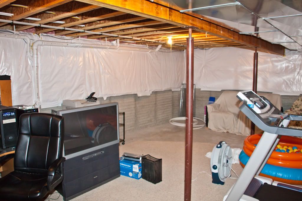

This one is right out of the steps looking at the TV/screen wall
This would be facing 180 from the first one looking toward the bedrooms

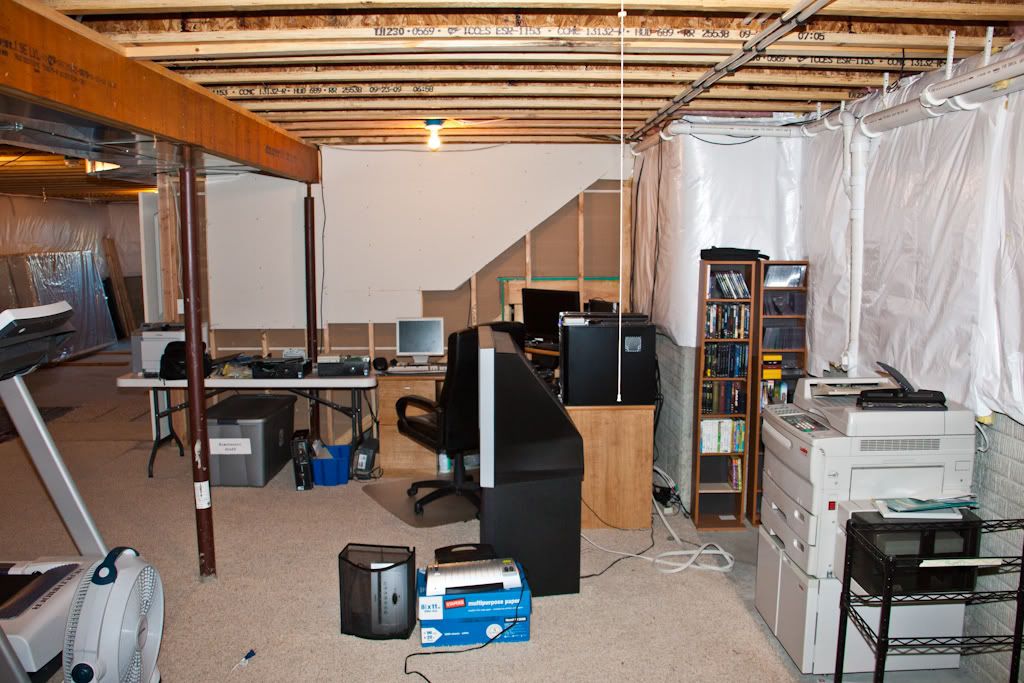

The next three are of the computer room

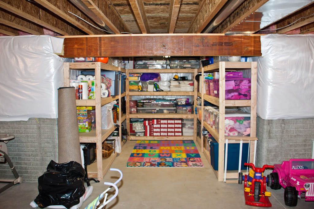

Looking at storage room

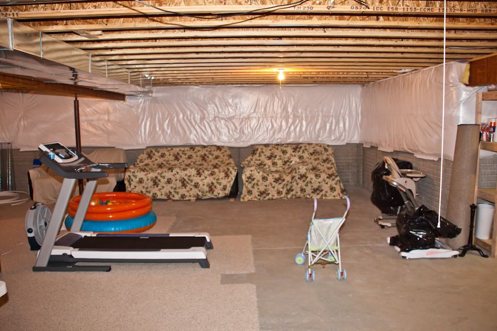

Next two are bedroom and bathroom area (and all the stuff we are storing )

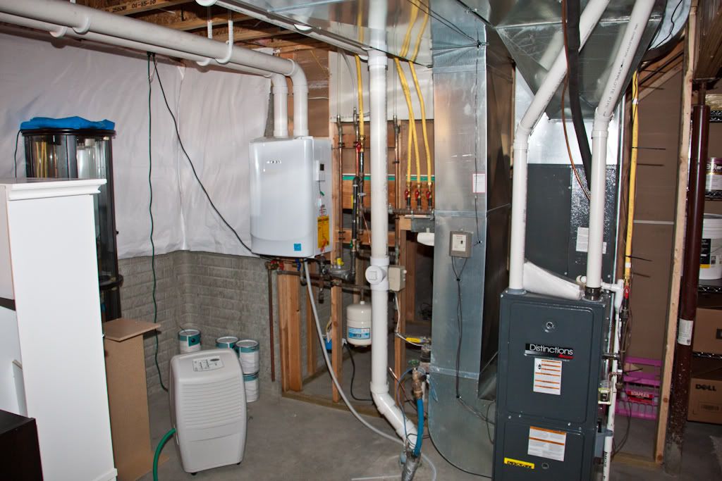

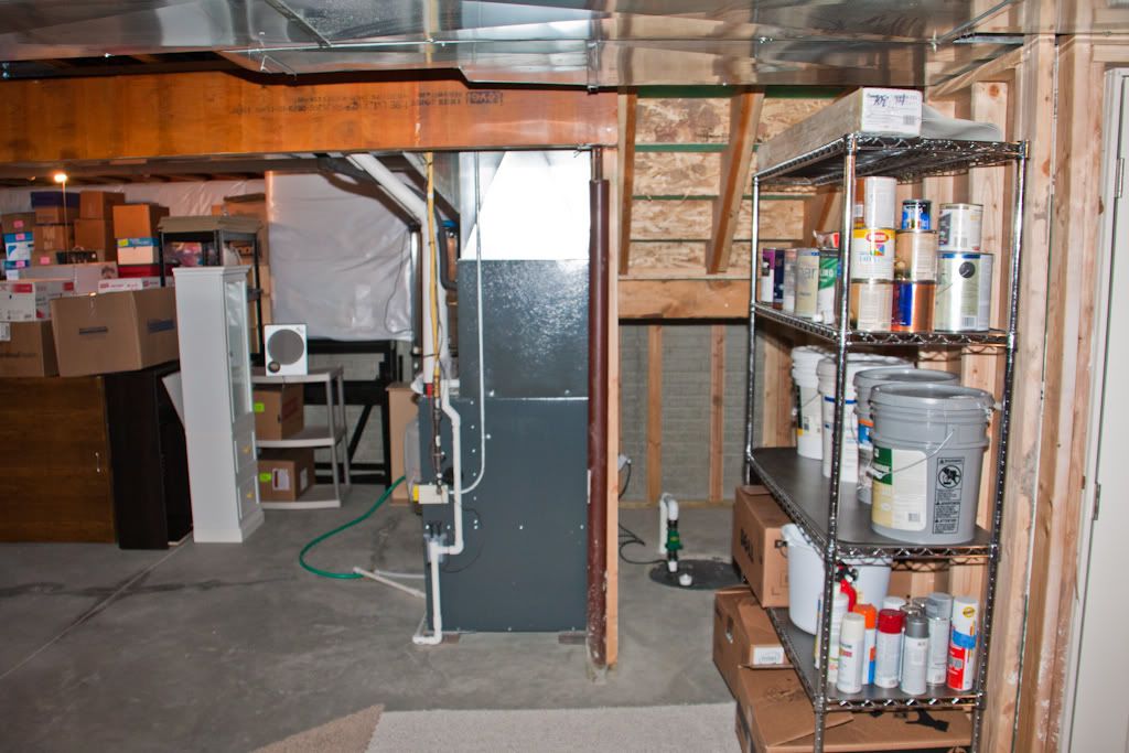

Under steps and utility
and finally a better one of the utility room

Regarding storing your friends' stuff: I had a similar challenge with my BIL & his family, although it was not their stuff, but them. Four months of togetherness with them & their 4 kids under the age of 7! It's all worth it in the end, so long as it only delays your efforts.
Anyhow, my question is:where are you located? Looks like you have the typical new construction "insulation" on the basement walls, which is almost useless if you live aywhere that actually needs insulating. Fortunately that is easy and not too expensive to do.
Also, what is the cause of that discoloration around the crack in your concrete floor?
Thanks for the reply! I know how living with in-laws goes, we lived with my wife's sister for 4 months while our house was being built
yeps its the typical new construction insulation, house was finished last year in may and i live in central Iowa.
the different colored concrete where the drain is, was from them having to move the bathroom stubs since they put them in the wrong spot initially. the discoloration around the crack to the right of that i'm not sure what it is. we haven't had any water come up through there and have a dehumidifier right there running, there was some white crystal like stuff that formed for a bit but has since gone away but the color change hasn't. i think i might put that on my list of things to ask the builder when they come back.

Iowa is cold enough - I hope you are planning on replacing that blanket insulation with proper insulation. It is pretty easy and relatively cheap now, but once you build the walls it becomes a big project.
I'd also have someone double check that discoloration near the crack in the floor. I'm no expert, but that isn't the norm for a new house!

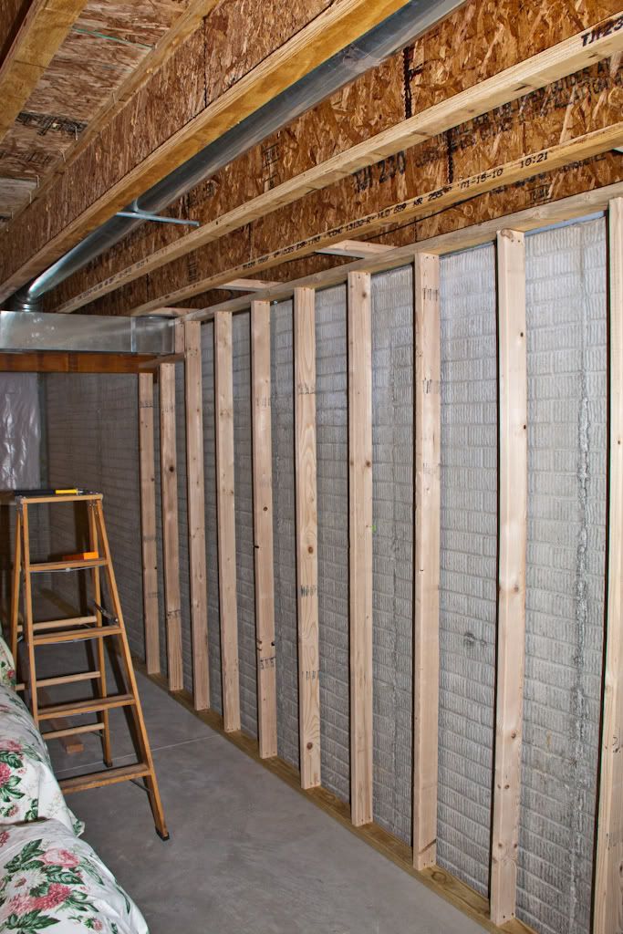

well the first pre-basement finish project was finished tonight! i was putting a utility sink in the garage and since i was going to have to cut into the water lines i decided to go ahead and rerun the lines in the ceiling instead of under it, its the ones in the pics of the computer room. That way i don't have to worry about dropping the ceiling to accommodate them.
as to the insulation, yep all the blanket stuff will be coming down and real insulation going up in all the walls once they are framed.
as far as the furnace goes, based on what Tom said i think there are two different things the furnace has going on. From the pics you can see there are two white PVC pipes that go into the furnace, those both go outside, i would guess that on is exhaust and the other is intake for the combustion air.
the other thing is the "fresh air exchange". there is another flex pipe hooked to the system that goes outside. when that runs its basically exchanging the air from inside the house with air outside the house, kind of like having your windows open. so for example, i've got the A/C on right now set to 75, every once in awhile you will hear the furnace running and air coming out of the floor vents but the A/C unit outside will not be running. its supposed to cool (or heat in the winter) the incoming air with the outgoing air as to not change the ambient temp.
so, based on all that info, my guess would be i wouldn't have to worry about any kind of air return vents in any of the rooms of the basement?

The simplest (and cheapest) solution without a total re-design,
would be to reduce your shower stall by about a foot +/- (just a guess)
and reduce both bedroom closets by the same amount so the post is in your utitity room.
The rooms can stay the same size just push the doors down enough and you should still have room for a 48" shower.
If you need a little more room the toilet only requires 30" by code.
Are the plumbing rough-ins already in place?
Typically a builder will place those according to your future plans because its a lot eeasier to do before the slab is poured.
I try to make a suggested layout for bedrooms and bathrooms at the planning stage so the windows end up centered in the rooms,
plumbing drains go in the right location, and posts and plumbing stacks get hidden in walls or storage areas.

hooray progress!!!! well things were slower to get started then i had anticipated! between vacations and work and getting my wife pregnant again its been slow going. unfortunately pregnancy is not good to my wife, she is nauseous and sick all the time and will be for the entire pregnancy so its been kind of limiting on when i can work, basically the stars have to align where someone is watching my daughter for me and someone is either taking care of my wife or she is feeling OK but not sleeping so i can go down and work without the noise bothering her.
so anyway, got part of one wall done so its started will just be slow(er) going then i had hoped.

Did you ever figure out what you are doing structurely? That is an odd looking set of supports, but perhaps that is what is being done today in parts of the country. There are definetly ways to move those, but you will need a structural engineer to look at it - it could involve steel beams.
Yeah, differnet permit requirements in different parts of the country. I did a smaller set of work in Seattle about 10 years abo and only had to pull electrical and plumbing permits and did all the work myself. I did hire out drywall for one larger project (living and dining room ceilings in a 90 YO house with failing plaster), just because it is such a pain in the neck.
