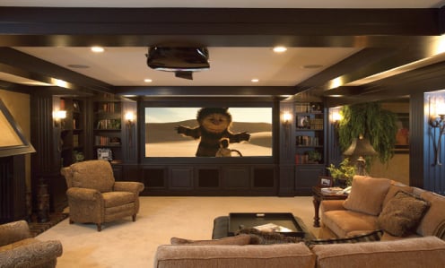

#2 looks pretty good, but it looks like it could use a little extra. Would you ever think of adding some floor to ceiling bookshelves/cabinets in the far left and right areas around the subs and then incorporate the columns? It might make it seem a little homier. Not quite like this, but you get the idea...
Just a thought. Progress is looking good.

Thanks. No boookcases though. I'm going for more of a dedicated viewing space in an open area than I am a family media room type look. I totally agree though if I I wanted the end result to be something like the picture you posted - that's a very nice looking casual media room.
Keep in mind, the columns will be stained wood and the front wall will be painted black. I've considered doing some heavy drapes behind each of the subwoofers, but that's about it. It's all about clean, contemporary lines this time around.
