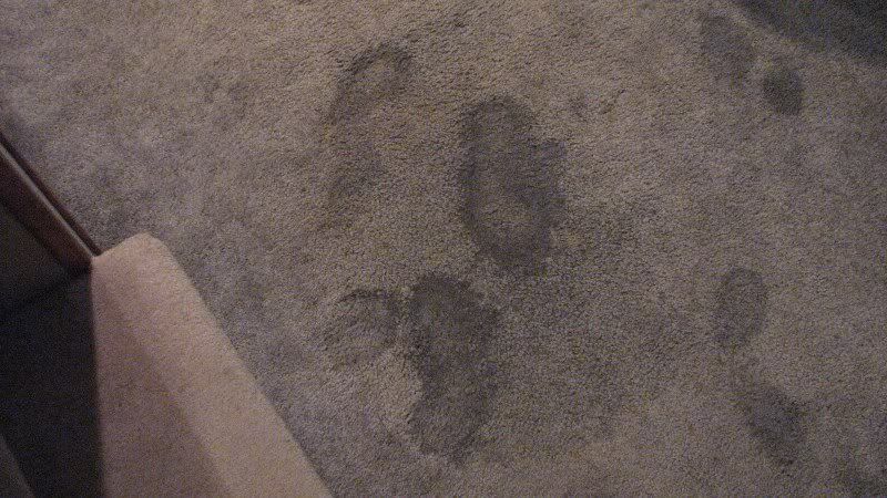

I had only seen water in my basement two times before -- once when the washing machine hose came undone and once when there was terrential downpour. Even then, there was just a 2 x 2 section of carpet that was wet. I cleaned it up easily with a steam cleaner vacuum.
Spring of 2010 was a very, very wet year in Michigan. It rained, well, a ton. It seemed that every time the ground might have a chance to dry up, another rain would blow through and saturate the water table again.
It was a rainy day in May when all hell broke loose. I was getting ready for bed and looking outside -- there was one of those crazy terrential downpours that I mentioned before. It's the kind of rain that comes in so fast that the streets can't keep up. I fell asleep in the middle of the storm.

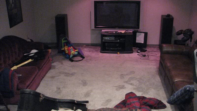

About two hours later, my 8 year old comes in and wakes me up. "Daddy", she says, "I hear a scary noise, like a monster." It was 1 am, two hours after I'd fallen asleep. I was not happy to be awake. I took her back to her bed and told her I'd check it out. About half way down from the second floor, I heard it -- "BOOOM". That wasn't thunder. I searched around the perimeter of the house but didn't see anything. It was still raining. I heard it again. "PFFFFFFF". It sounded like it was in the basement, so I crept down. I heard it again, this time VERY loud. It was deep, explosive, bass. As soon as my foot hit the bottom of the basement, it all became very clear:
My foot was soaked. I looked toward the north end of the basement, and there was my subwoofer, sitting in water. It was shorting out, making explosive bass pops so loud that it woke up my daughter two floors above.
This was the room, full of water, even if you can't see it very well from this picture:

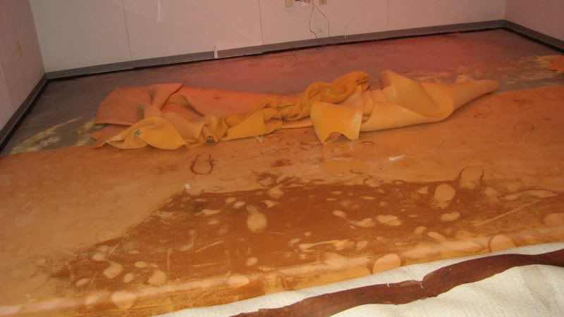

I moved everything over to the opposite side of the basement that was electronic or valuable and tried to go back to bed, but I didn't sleep much.
The next day I got my steam vacuum out and tried sucking up the water, but I'd fill up the vacuum with just 10 seconds of vacuuming. Dump. Start again. Dump. Worse yet, it seemed like the more I sucked, the more water seemed to come up from the ground. It didn't make any sense.
We had the insurance company come out, and they surveyed the damage and recommended a cleaning company. He told me the carpet would not be salvageable, so I ripped it out.
The company came out and put up huge dehumidifiers that tripped my breakers non stop. Two days later, another storm came through and flooded the basement AGAIN. This time, I was able to watch it. Water wasn't coming from the walls, it was coming from the microscopic, tiny cracks in the basement floor.
Another call to insurance, another deductible (separate floods are separate claims!), and more dehumidifiers. At this point, it was pretty silly, because water had saturated all the carpet tack strips and the bottom of the drywall.

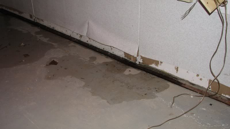

I started pulling off the bottom two feet of drywall to do some investigation. I had no idea what was behind the drywall. I quickly found out that the original installers used 1 x 3 firing glued to the wall with 3/4" foamboard as insulation.
When I ripped this off, I discovered what I feared the most: when the flood happened, the drywall wicked up the water, where it slowly traveled up the wall and turned into black mold.
When I told tWife about this, she freaked out and wouldn't let anyone near the basement. So it bacame quickly clear that I was doing a total demolition. In retrospect, this was a great decision, because it allowed me to build proper frames, insulate better, eliminate all possible sources of mold, run new wiring, and waterproof.

Ok, finally getting around to updating my final completion of stage 2.
After I got the floating floor installed, it was time for carpet. I was super excited that Home Depot offered 72 hour installation, because I could get the project completed by my birthday! Unfortunately, they were backed up by three weeks. So much for that guarantee. Anyway, the wife helped me pick out a plush carpet that had a lot of mixed tones to help hide the eventual spills and dirt that my kids will create.
Carpet installed:
Next, I assembled my entertainment center. I originally had plans of building one, but somewhere along the line I realized it would be a) a lot of work, and b) way above my skill level. So I created this arrangement using the IKEA Besta system. Pretty cool online tool lets you design your own cabinets. The cost was probably cheaper than what I would've paid for materials to build my own.
This next shot features the ambilight feature on my Philips Plasma. I love the feature. It changes color based on the color of what's on screen. It gives the room a real ambiance (cleverly named) when the lights are low.
Decoration included some Star Wars posters that I had from college on one wall, and some framed vintage Beatles prints on the other wall flanked with my guitars. I'm big into music DVD's, and I wanted the basement to pay tribute to music.
That's it for stage 2! The absolute best thing I did was pay for top quality insulation. The spray foam made all the difference in this basement. It's now the warmest room in the house. The media room has now become the source of many parties and great family movie watching.
My bank account took a major hit, so I'm assuming it will be about a year before I dive into my final stage, BAR CONSTRUCTION.
