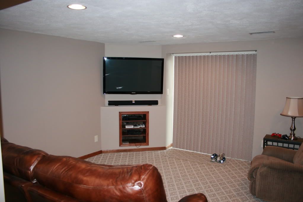

I left about 10" between the bottom of the TV and the mantel. But that's mainly because our mantle is huge and "we" put lots of decorations on it.

I mounted a 50" and tried to get close to the bottom third of the tv screen at eye level when sitting. We did end up putting it just a bit higher because of the bar area across the room and alot of people standing during game parties. In hindsight I do wish I would have done it about 4 inches lower as we are only about 15-18 feet away when sittin on the furniture.
