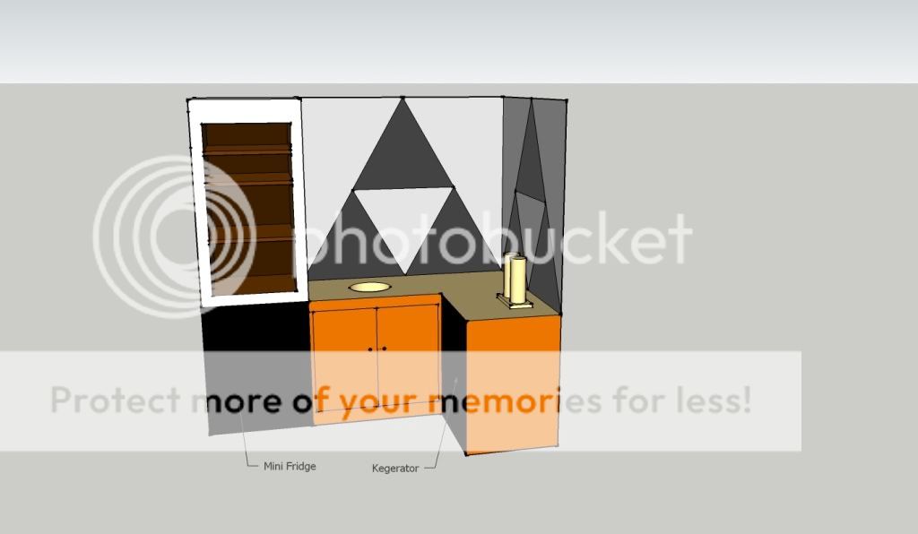

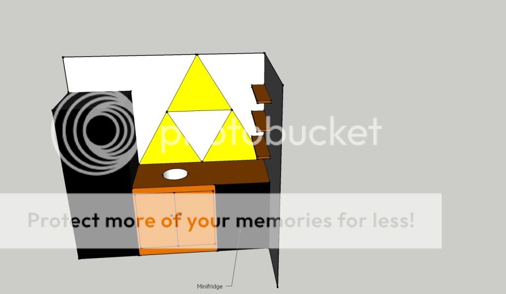

I have some pics I've been meaning to post. Just changed jobs so free time is limited. I have a few sketchup drawings for the bar area is like opinions on. I'll try an posted updates tonight or Friday.

The first has a built in cabinet for the liquor bottles and glasses. Figure it would be easier to kid proof but would limit the amount of kegs I could hold.
The second is simpler and has the liquor out in the open, but would let me get a full size freezer or fridge that could become a kegerator.
I have put a pic of my basement layout for reference. Bar would be at the base of the steps.

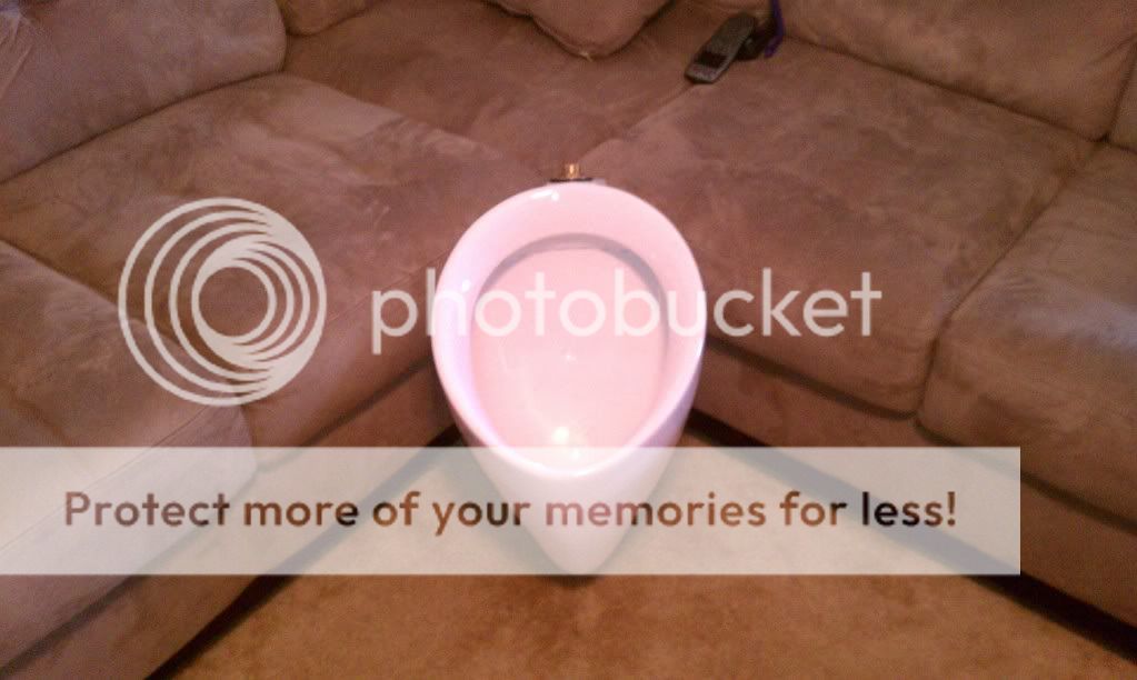

I will have pics of the framing and sofits this weekend. We are putting the last finishing touches on this Friday and finalizing any few layout tweaks before the plumber will come for the bathroom and wet bar. Getting quotes on plumber just running the pipes and I do the final hook up when I'm ready or just having the plumber finish the entire bathroom. Drywall, flooring, and fixture hook up. If it is less than a $1000 difference I'm gonna let the plumber have all the fun in there.
Here is a pic of my urinal. I know it is childish, but I think the idea of having a urinal in my house is ultra bad ass.

My brother in law has one in his basement bar build, nice touch and also helped out with boy potty training too, at least that's what he told his wife!!

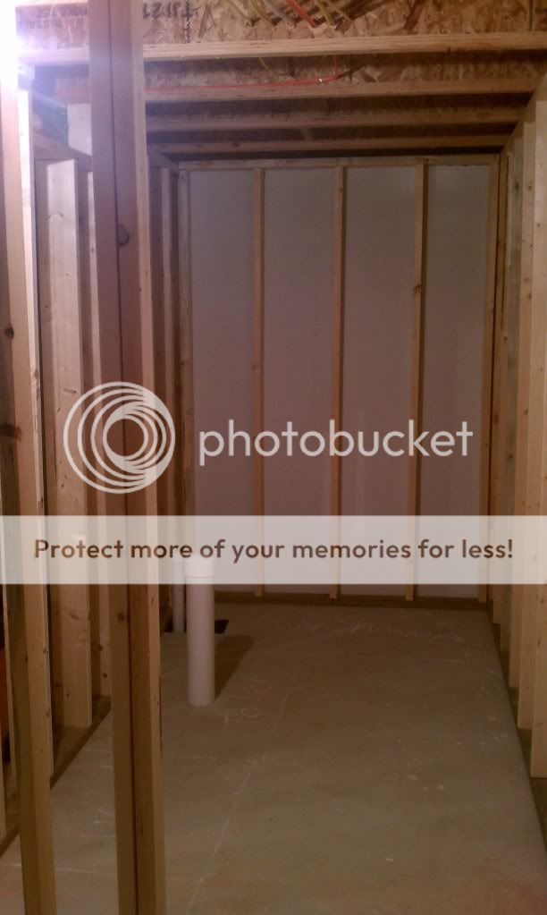

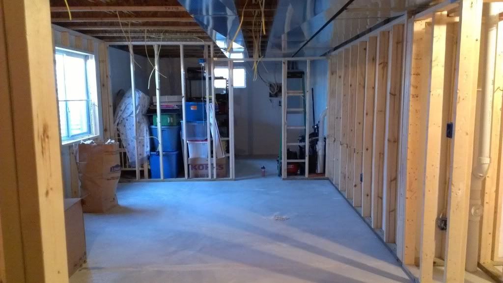

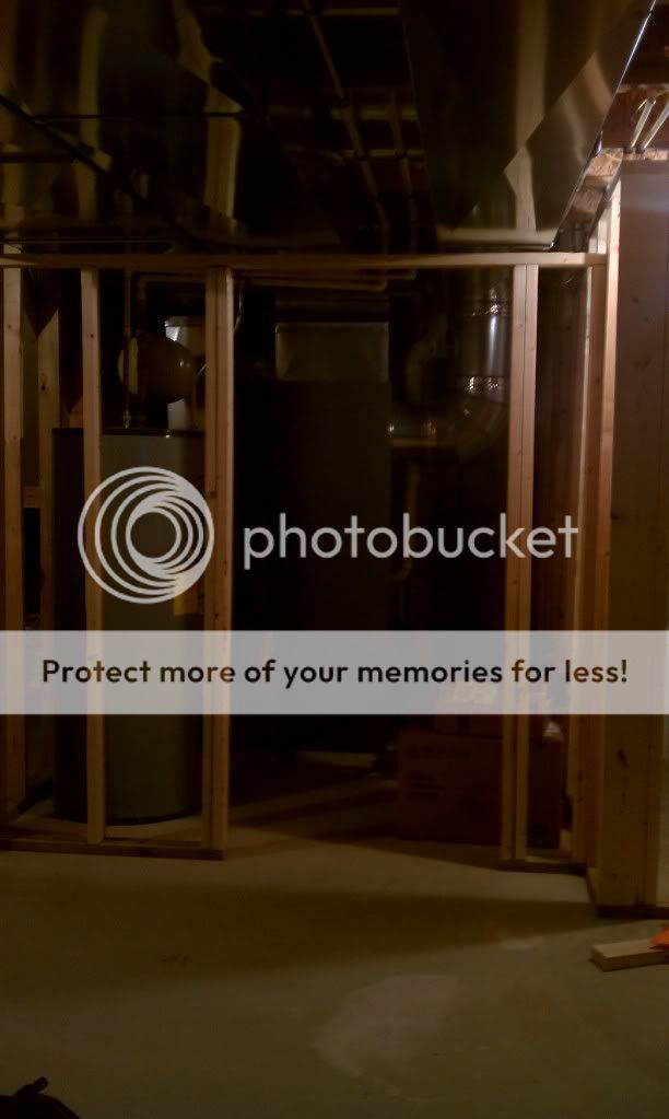

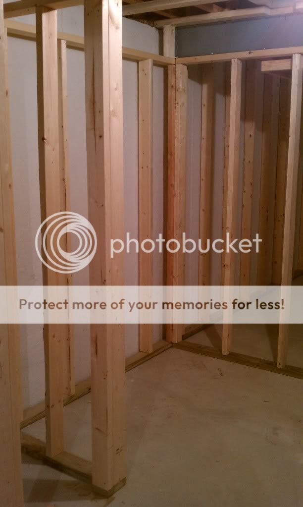

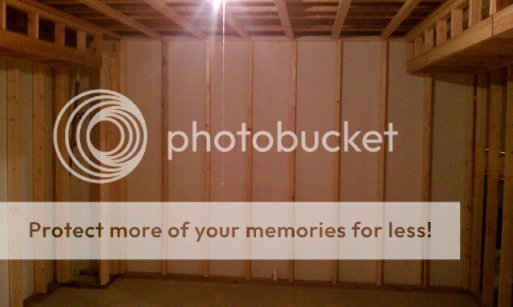

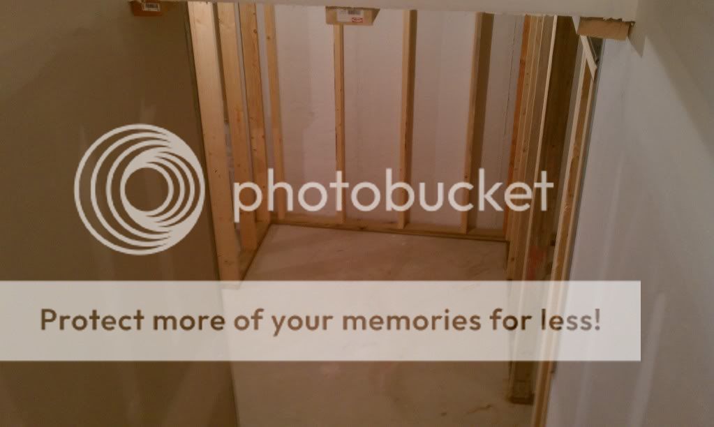

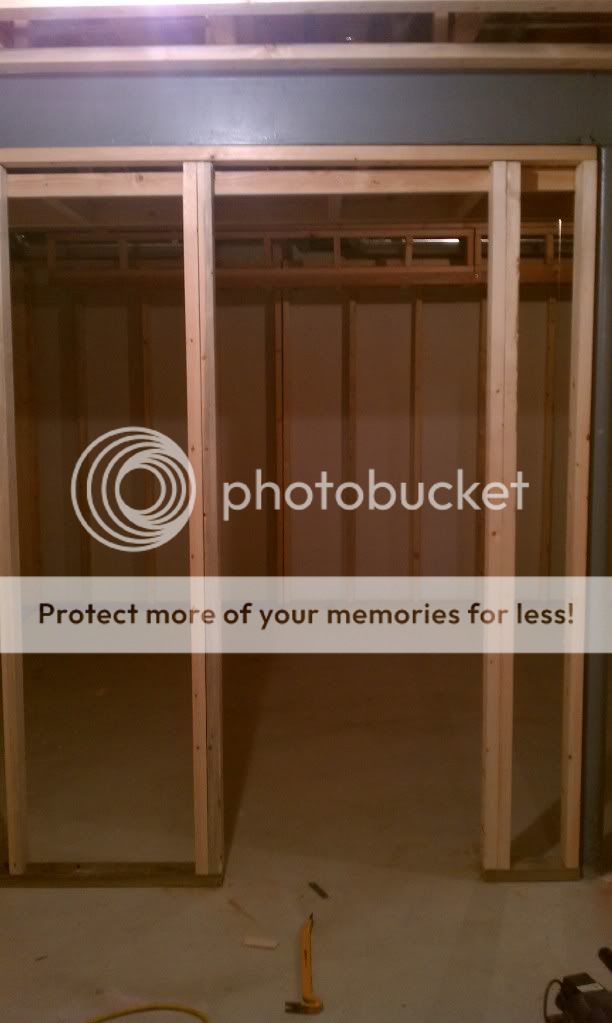

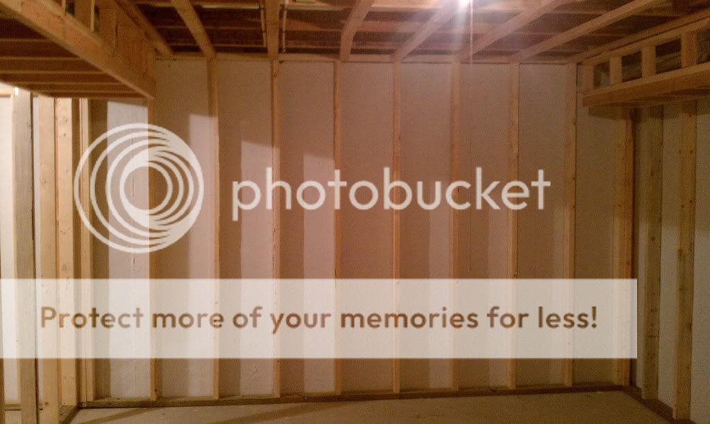

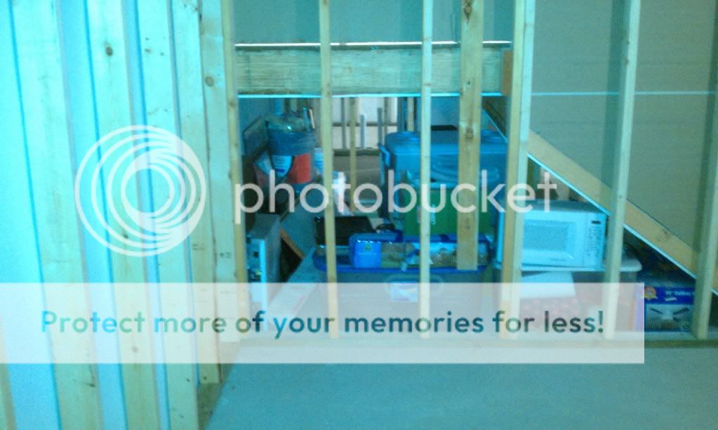

Here are some pics of the framing. Finished theater will be about 16x12 after the AT screen wall goes up. It is 18x 12 now.
Screen wall
Back wall
Entrance way
Future AV equipment
Down the steps into the basement looking at the future
From the left of the bar
Bathroom
Bathroom entrance
Mechanical room

Backwall is actually the screen wall and vice versa

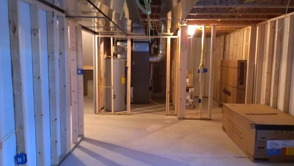

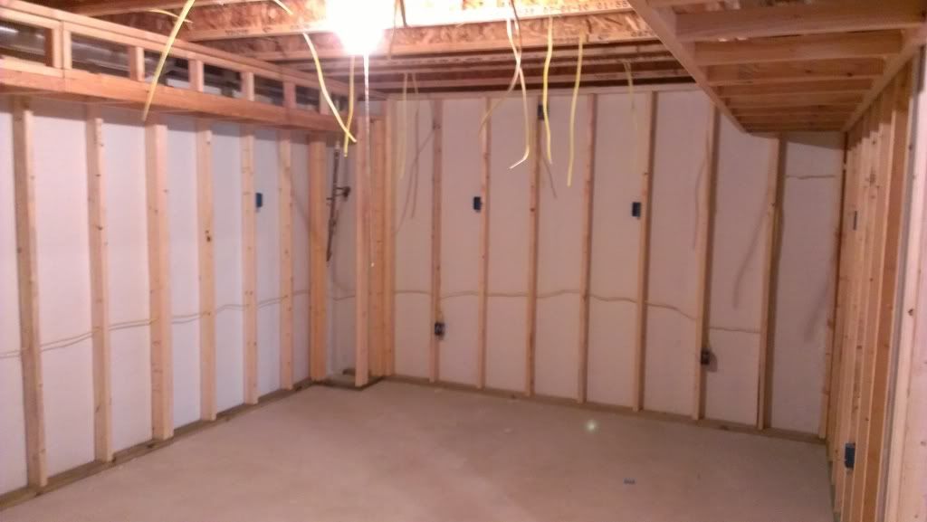

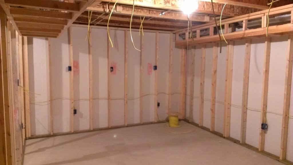

Here are a few pics of the rough in electric for the theater area. I'll have the rest of the basement pics up after this site is done with the server change.
