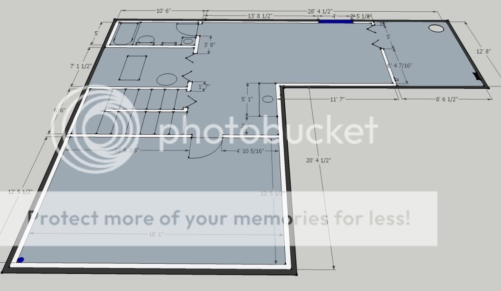

Hello everyone,
I'm a long time troller, but new poster. I am nearly ready to start my build. I wanted to post my general layout and get some feedback and ideas on how to maximize my space. Basement is completely dry and crack free for 3 years and a sump hooked to a drain system all around and under my foundation. Here are my main hurdles.
How to best hide/work around my sump and electrical panel without violating codes or losing a lot of space/ visual appeal. I am torn between framing around the sump only and putting it in a little closet or bumping the wall out 3' and having the sump and panel behind it. Can my electric panel be in a closet like setting even with proper clearances all the way around?
While this will be mostly a place for the family, wife and one 2 year old, to watch movies and play video games, I would like to keep it as open as possible for entertaining and having parties which we do somewhat often.
I would like to have the screen wall be the wall of the sump and electric panel to keep everything in front of it open.
I'm not a huge audio or videophile, but both are somewhat important to me. After the build which will be 80% me and 2 buddies. Plumbing and drywall contracted out. I will have about $3000 for a projector, screen(prefer fixed audio transparent with LRC hidden behind screen) and 5.1 maybe 7.1 sound (inwall speakers is an option since I am pre-build)
Here my basic basement plan and a few pics of the actual basement.

How about making your storage area the Media Room? Your drawing and pictures don't really show how big the area is, but I think there is too much going on in the area you have identified as the Rec Room (i.e., 2 windows, elec. panel, plumbing...). Can these rooms be switched around? I guess the questions are:
1) how big is that storage area, and
2) how much storage area do you need?

The storage area if finished would be about 18'x 12' 6". I could definitely put the theater set up there and move the bar area down or around the corner.
I like that better, too, and moving the bar around the corner would seem to give you very easy access to the existing drain stack...

With doing this switch I would prolly just make it a dedicated home theater and use the rest of the space as an entertaining space. I could easily just add a 40-50" TV to the rec area.

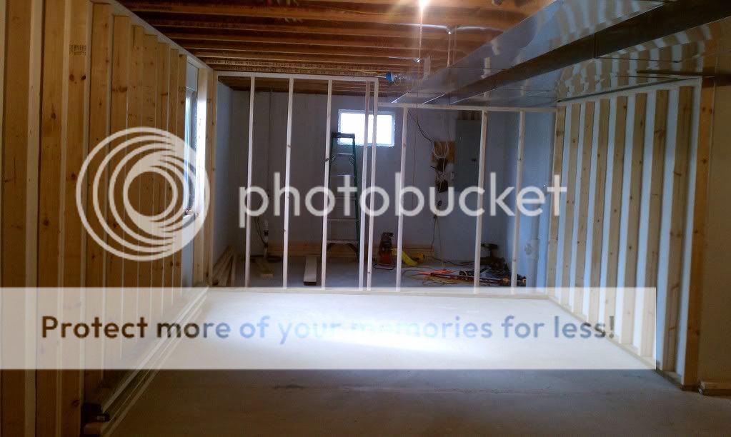

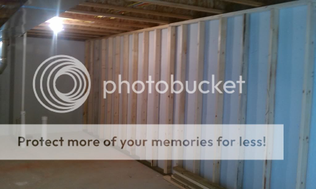

Half the basement is framed. hope to get the rest done in the next two weeks. This whole family and job thing is really gonna cut into my basement finishing time.

Finished framing all the walls this weekend. Still need to build the soffits and finish framing the doorways. It's nice to give definition to space.
