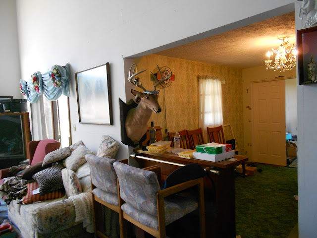

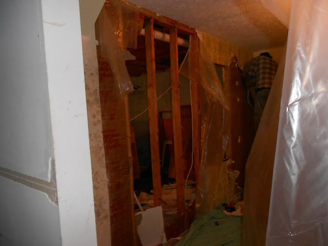

this is looking at the dining room wall we are tearing out
this is looking toward the dining room & great room where we are closing up the patio door
starting demolishing

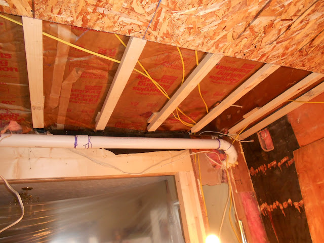

so the following pictures of are doing the wiring
and other finishing before the stucco.

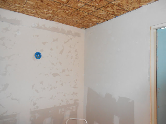

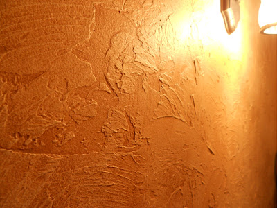

ok, guess the next step to show is the stucco on the walls.
wayyyyyyyyyy back in the 70's there were many houses with either a Spanish feel to them or Italian stucco on the walls. I just thought it was so cool looking. one of my favorite affect was where the ceiling was painted a certain color ( red in most Spanish decor) & stucco was applied over it (usually in a white color) so the background color showed though in parts. it was really neat looking. although probably a nightmare if you had to paint over it.
there were * are houses with the cottage looking wood & stucco outside, ^ of course the look of stucco walls just evolves the thought of olde Irish (or Renaissance , for that matter) bars. THAT is what I wanted for this one.
now accomplishing this was easier said than done. yupp. I searched online for YEARS for internet help how to apply & then paint it with a color wash over it to look old. with ALL the stuff online, there is just not a tutorial on how to do this!! ok, I did find a few youtube vids that show somewhat stucco finishing, but it was not exactly what I had in mind. we had taken close up pictures of the bar walls we were in, to get a feel of what we needed to copy. *sigh*. a Lot of th Italian Stucco vids were a knock down/flat finish, we wanted a swirl like effect. soooooo Hubby did a couple of practice boards.
Now a note on Hubby. He is pretty much a jack of all trades, ( I am sooooooo lucky) but there are a few things that he hates with a passion. Laying Brick ( I had to practically hold a whip over him to get him to finish the brickwork around our fireplace (lol) & he Hates miter coping. Now it seems he has been dreading the stucco work with a passion,,, almost ,, almost wanting to hire someone to do it ( & that is NOT in his vocabulary,, he always does his own building).
Anyway, He put it off for as long as he could, then I said enough,, we have to get this done. I think he did a marvelous job, the only thing he kept doing that needed some nudging , was he wanted to sweep the trowel like he did on doing concrete work & he had to really concentrate to get the sweep going in many directions.
we put tape on the walls to get a clean edge from the stucco, for the moulding edges we are putting up.
what he felt was easier than just trowling on a glop from the bucket , was to slap blops on the wall & then smear/trowel them around to get the effect we thought was pretty close .
what the wall looked like dried. you can't really tell from the picture, darn, hard to take good pictures sometimes.
now the painting was left to me. & as with the stucco, I had a very hard time figuring out how to get the washed look. I thought I'd paint the walls one cream color. then roll on a darker color & wipe it off leaving the darker color in the nooks & cranies. I tried it on one of the practice pieces Hubby did. It actually looked ok... BUT it ws ONLY on a 2 ft square sample. the real thing, well it just did not work out the same on a larger wall!
for one thing I used flat paint. ( thiught that was the best, as I did not want a shiny wall. just an old dusty looking wall.), BUT the top coat went on, the bottom coat went :SSSLLLUURRRRRPPPPPP: IT Just sucked in the top coat & would not wipe off as I had wanted. arrghhhhhhhh. after staring at the wall & a good cry. I painted it back over again , and tried to figure what now..
this is where I tried the 1st painting, where you can see how horrible it is on the right, & on the left where I started painting it over again.
soooooo off to home depot again, to figure out what to do. sales person said I needed to glaze it. BUT she told me wrong measurements, she said 1 part glaze to 4 parts paint. but it was opposite, (crud) < and no I didn't read the can>. plus she said to use eggshell or semi-gloss ( & should be semi-gloss or gloss) . so next coat, I DID use semigloss, but only a partial amount for the glaze. It worked better, but dang, after I found out what I should have done, I was not going to repaint it.
here is the 1st wall , it looked "ok" but not perfect. as you will see in the other photos of the bar, you can see the swipes & smears of trying to wipe off the paint. Hubby does not really like it. but it's growing on him. he hates the smear look. BUT since then we have been in several restaurants where the walls are similar, & the stucco /paint work looks garbagy compared to ours. So Hubby is warming up to it. ALSO...... I keep reminding him that I am putting so much stuff ON the wall, you will barely see smear to smear...(VBG).

Here is another closeup of the wall. the color is off from the picture, but you can get an idea of the texture of the stucco

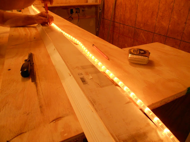

putting the rope lighting on the back of the crown moulding
this is the crown moulding on far wall & the ceiling lights over the bar.

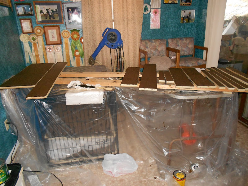

Now we are up to the part I **HATE** with a passion, & that is staining & varnishing.
over the past 30+ years I am the one stuck with the job. I must have stained thousands of board feet, & it mostly turns out fairly well. I had started with /sherwin williams stuff ( I loved the danish walnut color) but they stopped making their own brand over the years & I was pretty much stuck with Minwax.
Now, we have ALL seen some pictures on the web of some pretty bad staining jobs, (you know what I mean) with streaks & whatnots, I knew I never had problems with that before, so thought even though this was going to be a massive stain project , it should also be a no brainer. ha. little did I know, some *thing* decided to work against me on this project.
The 1st things I started was the wainscote... staining went ok. THEN I went to put on the minwax poly. it went horribly. it all applied with tons of little bubbles.. nooooo NOT the bigass bubbles you would get if you shook the can, it was like foam. now I had just , this past year did hundreds of feet of wainscote with minwax poly & no problems,, so could it be cause it was inside, in the middle of winter? smoothed it out best I could, but still looked like *yuck*. tried a foam brush, 2 other brushes, etc. called minwax, they said air must be getting in the brush, soak it in mineral spirits *sigh* ok, but that didn't work. I don't get it (hear me scream????)
after some other web searching, I decided to try general finishes wipe on poly. alrighty, that goes better, but still I can get it foaming in the cloth if I wasn't careful. & I wasn't too happy that it will take double the coats to get the same results as minwax.
at least I started with the pieces that don't matter that much & could be hidden behind furniture. Now as we went along, as I was starting to do the large sheets of oak veneer plywood, It looked pretty good. BUT when we put the pieces up next to each other on the bar front, it was very noticeable that something was wrong,,,,,,,,somewhere.
One piece was wayyyyyy darker that the others, & later on we noticed it was actually stripes of mismatched wood grain next to each other. what the heck? when we bought the plywood, we asked what was the better side? they said both were "A" side, personal preference. so we decided to use the side that did not have the stickers. now as I said the pieces looked fine laying down after staining & varnishing, but after upright next to each other, you noticed it.
It became obvious that we ("I") stained the wrong side. there was nothing we could do with the bar front, as that was glued, but the booth benches we took apart, & redid the other side. that resulted in some bad edges & holes where the screws were, but we are working to cover those with moldings.
Now I have seen on a few of the web bars of mismatched grain panels, does it matter to you? One I noticed on HeyNow^'s front BEFORE he stained it, , I can't tell if you can see a grain difference afterward, HeyNow^ maybe you can fill me in on that??
So, since it is the middle of winter when we started this project & I did not want to work in a bullet heater heated garage...... I stole the dogs room to stack up my staining. It wasn't a very big room, & spent weeks going through laying out boards/staining/varnish & moving them into any other room I could till we put them up. I never really had stacks of wood, as we pretty much purchased the stuff as we went through them.
I only had so long to use the Dogs room, since I was going to be kicked out of the soon since one of our dogs was about to deliver puppies... I then had to move the wood finishing into the bar area, ( the last thing I planned to work on was the bar top, so I just laid the wood on top for now to finish.)
The Dog room
Below: In case you are interested......
this is the mom.
Ok, back to building.
here is the first wall of the bar itself, you can see the far 4ft sheet of oak plywood that is darker.

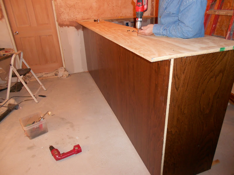

ON to buiding the most important part of the room "THE BAR"
I had subscribed to several bar plan sites on the web & followed a few other websites ( other than here on
avs) & it just seemed like they were really all too complicated & lots of extra steps. since Hubby has built cupboards before he just basically built something of those, I just needed to give him basic dimentions.
so the start pretty much was a base platform that was the size of the cupboard base & he screwed the front pieces of oak veneer into them.
one 4 ft wide piece on each side of a 2 ft section.
now he put a top piece on, that the actual bar top will be ( we are using flooring) & then the bar rail will be on the edge.
ok, remember when I told you about the floor having a hump in the center?
well I kept investigating solutions, and kept coming across self leveling concret to level this out.
head to Home depot, check out the CORRECT stuff, & it costs 3x the price over the regular bag that says it can be USED as self leveling... Frugal Hubby insists he can make the regular bag work.
we use the bag of stuff, (of course mixing a dust cloud of cement in the room) & it kinda works, but the concrete floor already down sucks the water out of it & it kinda ends up in lumpy rolls... not too bad, better than what it was, but the next few days I think there has to be a better solution. decide to review youtube videos on what the correct stuff actually looks like.... so off to buy the correct stuff along with the spray sealer for the floor ( which is what we should have done in the 1st place.)
Below is working on that stuff.
it worked fairly well, although we really should have used 2 more bags for the floor.
gluing the veneer plywood together, you can see along front edge where the bar rail will be.
& putting the counter top in
