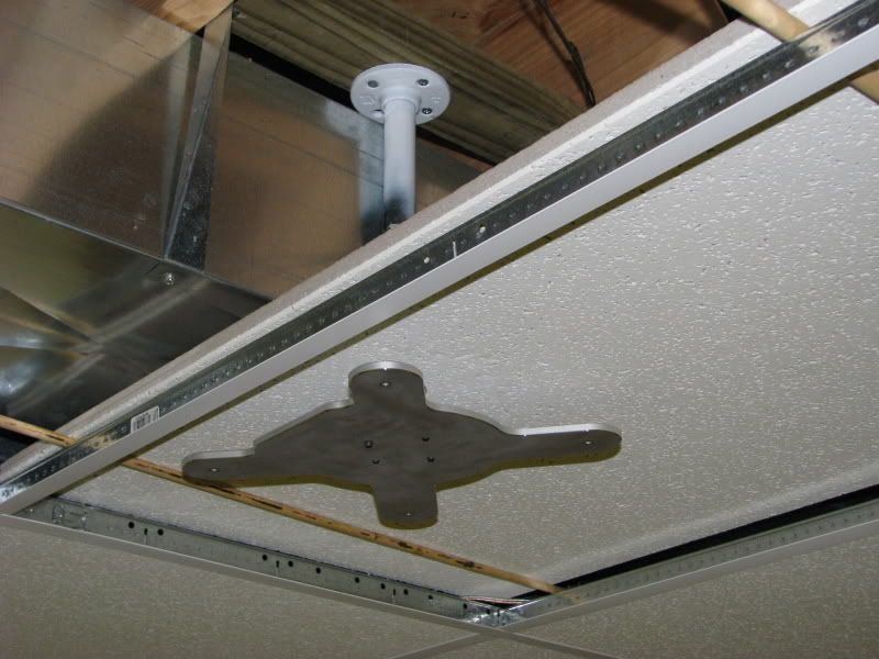

Here's how I mounted mine to a 2 x 4 screwed between the ceiling joists with a galvanized pipe and fittings from the hardware store. The aluminum projector mount is custom made.

If you use a Chief mount system with the down pipe you can just put a round pole through a hole in a ceiling tile and their is no need for a custom plate.
