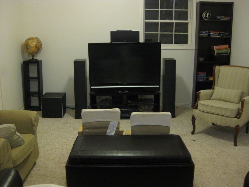

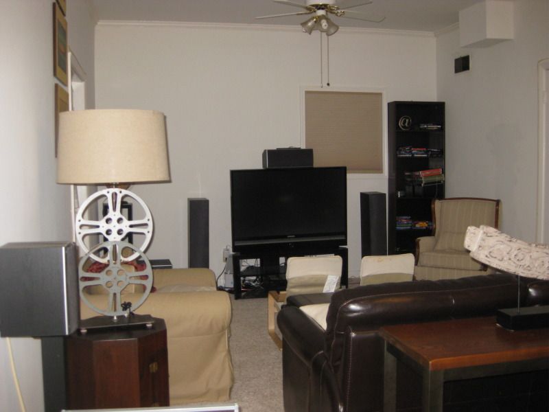

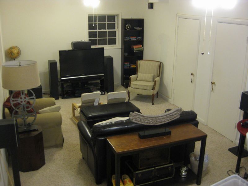

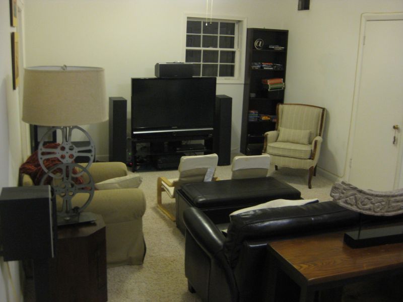

Ok, here are the pictures... full description to follow in another post !
Wide Angle View:
Closer Look:
View from behind Main Seats:
Reverse Angle:

For one thing, I think the front left/right speakers should be spread out just a little bit more, and then toed in. They seem too close together for a good stereo spread.

thanks for the advice! i do think i can spread the l/r speakers a bit further apart without the right speaker being blocked by the wingback chair. i'll try that later tonight.
i'm not sure if i want to add 2 more speakers to the rear since the 'home office' is back there (pardon the mess!), but it has crossed my mind before... just not sure if adding that extra 2 speakers back there will make a huge difference... already my family looks around the room whenever the surrounds are being worked!

I installed the window shade and moved the L/R speakers as far apart as i could without getting the right speaker behind the chair.
I'm thinking of moving up my surround speakers a little higher up the wall now...
