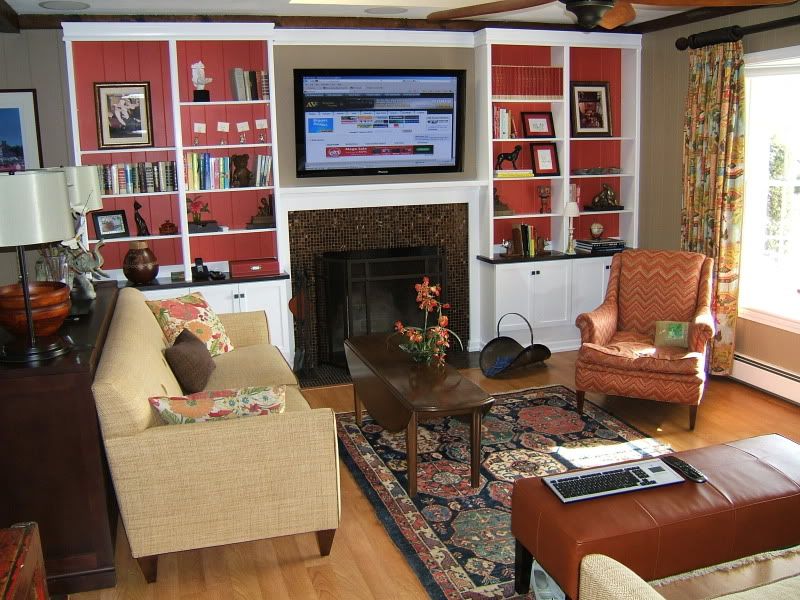

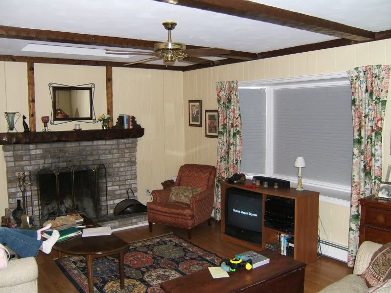

I was trapped into over the fireplace due to less possibilities than you. Having the display so it can be seen from my dining room and kitchen is a huge plus with zone2 speakers in those areas. GFAF forced in-ceiling speakers with a downfiring sub behind the zig-zag chair. You do get used to the display being high but I suggest getting it as low as possible.
Your fireplace is screaming for a mantle and that would help take the focus off the display; flanking bookshelves would help even more. Plasma helps with the viewing angle too. There is actually a false wall in front of where my display is mounted...
here is my before and after:
vivatech likes this.
WOW TJ7- that's a transformation! I only realized that was the same room after I read your post a few times- I thought it was two different places. Great work on the fireplace surround tile.
I totally agree with needing a beefed up mantle. The granite there is kinda blah anyway. I guess I have more designing to do! Time to rent a fireplace design book from the library!
What do you put in the cabinets? AV equipment? I'd want that.
Where are your front left/center/right speakers? EDIT: I just saw they're in-ceiling speakers. I've never heard front ceiling speakers- what's the verdict on that?
Although your shelving looks really good I'm not sure it would work for me. More nicknacks for the ::ahem:: maid to dust and more target practice for kids to knock down! I have to figure something out like that, though. You reclaimed so much space by removing the brick facia.
What minimum depth should a mantle have? I'm concerned about heat from the fireplace that I'd want to deflect as well as consider the TV mount depth and center channel speaker depth. The mantle should come out the farthest distance from the wall regardless, right?
vivatech is offline
We are happy with the transformation too; thanx. The in-ceiling speakers I have are 8" speakercraft aim series. I think they sound great but then again, I have not heard other speakers in this room. The general rule is to avoid in-ceiling front stage if you can. If I had to do it again I would install Triads or Def-Tech rcs-ll's. I was not given an option so in-ceilings were a must but using them does eliminate what to do with the center channel. If you end up using bookshelf speakers or the like then put the center on top of the display so it doesnt compete with the Kinect camera and you will be able to keep the display as low as possible.
The cabinets are too shallow for components but just deep enough to hold an Xbox along with games, cameras, binoculars, CDs, and movie disks. All my gear is in a hallway cutout behind where I was standing to take those pics. My Kinect camera sits on the mantel and I installed cabling in the wall for its connections.
My mantle is 9" deep and it is more than enough to deflect any heat from the fireplace; and I get the fire crankin' too. There are codes to follow here in MA regarding the proximity of combustible materials from a fireplace so be sure to check your locale. If you look at my shelving, it holds lots of useless things but it gives the room balance.

Pros:
  • While the audio height is noticeable, it's not bad when sitting at the LP and they tend to fill the room well. Not great sounding, but it's not bad. However, the current speaker positions do not make me want to invest in an expensive set; maybe better quality speakers would make it more enjoyable but they must be modestly priced. After hearing the speakers high and low, I would prefer a 9-channel setup with the LCR speakers low and using LR height speakers to aid filling the room.
  • The living room area seems really large now without furniture in front of the fireplace. Lots of room for kids to play.
  • I really enjoy not worrying about kids knocking over the TV. Mounting the TV with the VESA attachments vice the included stand calms my nerves when kids are playing in the living room. Plus if a toy gets thrown, it's less likely to hit the screen up in the air.
  • When the kids walk in front of the TV I can still see it well. No more constant yelling, "down in front" or "please move away"!
  • I can see the fireplace again. Not that we really watch it anyway, but it's aesthetically pleasing to see the entire fireplace and surround.
  • While sitting reclined in the LP with my legs outstretched and even with a laptop open on lap-stand, I can easily see the TV. No more having to shift around or keeping legs down to block the TV.
  • No neck strains when sitting in the LP and looking up. The TV is at an approx 10° angle and just fine.
Cons:
  • Overall, I'm not getting the minimal theater experience I originally desired. This is my main TV and it feels like more of a background TV. I would be totally fine with that if I had a dedicated theater in my house, but I don't. It's disappointing.
  • When sitting in the middle of the room for Xbox or just lounging on the floor, I'm not getting accurate audio as I was in the LP: it sounds bad. If I had the speakers at sitting ear level or the center channel below the TV, this would not happen.
  • The TV appears small and really far away. Just moving it 2 feet back and 2 feet up from where it was created an immediate exponential size decrease. The experience wasn't that immersive to begin with, but now my 60" seems like a 42". frown.gif
  • I feel the TV was too expensive for me to view it so far away. The PQ is still outstanding, but not as outstanding if it was 8' away. I could have used a much cheaper TV in this application.
  • With the TV far away, I need to put a chair in the middle of the room to play Xbox games like Call of Duty to see enough detail. At this distance, my neck hurts because the viewing angle is approximately 30°. My neck hurting me is a big issue. I'm not sure how so many people can sit so close to a high TV.
  • The size of the TV is too big for the bare fireplace. It would look much better if it was installed over a mantle, but that would raise the TV height even more. When I paint the wall I already need to raise the TV a few inches- it already needs more of a gap from the fireplace surround trim.
Summary:
  • I'm glad I tested out all the positions. I'm much more informed.
  • I wish my "getting informed" did not take so long. Neither does my wife! There were a few technical obstacles and time obstacles, but sometimes it worked out in my favor (like the TV defects).
  • SWMBO likes the above-the-fireplace location because she's not as picky as my Con list above and it's taken so long to get to this point; HOWEVER, she has also approved a solution that blocks the fireplace entirely! There is a lot of potential in this:
    • Speakers can be ear-level and not a custom application.
    • TV is not so far away.
    • TV can be VESA-mounted to a hutch.
    • Less construction hiding wires.
If I would have had permission originally to block the fireplace I would have bought a 82" Mitsubishi DLP to really fill the room for about the same price. mad.gif
