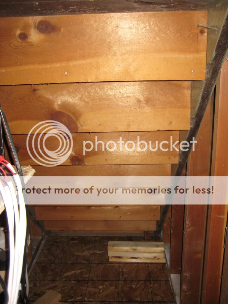

So here's a question that hopefully someone can help with. As you can see, I've got smurf tube that is longer than it needs to be on the left side of that equipment closet, with speaker wire inside. Does anyone have a clean method for cutting that tubing without damaging what's inside? I seem to recall when I was originally installing it, that I would use a hacksaw to cut through one side of one of the ribs, then basically break the rest off. It was effective, but ugly and probably not good to do all that bending with the wires inside.

Take an exacto blade or something similar, carefully slice a vertical cut in the tube a inch or so long and then go around the circumference of the tube with the blade being careful not to go too deep with the blade. Doing that should give you a pretty clean cut.

Thanks RT, your exacto suggestion worked perfectly, after a little bit of practice on some scrap smurf tube to get "the feel" dialed in.

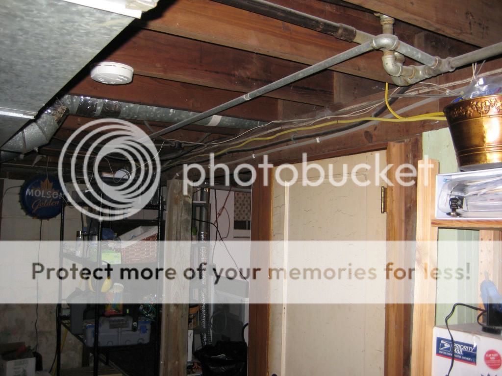

In the meantime, we have been gathering bids for the first few critical items that need to be hired out before I can start really building up the bedroom. We've put a deposit down for our egress window install, and we're just waiting to get it scheduled. This window is going to turn into a 28"x41" egress window, which is south facing, and thus should make the room pretty bright for being in the basement.
We are also having a plumber in to remove this gas line that runs over to our electric dryer, and to clean up that rat's nest of piping.
Getting all that excess gas pipe out of the way will then allow us to have someone take this HVAC line and move it next to the beam, where the unused gas pipe currently is. They're also going to make the supply wider and less tall, which should allow us to gain somewhere between 2 and 4" of ceiling height, which is critical when your already at 6'11" from floor to joists.

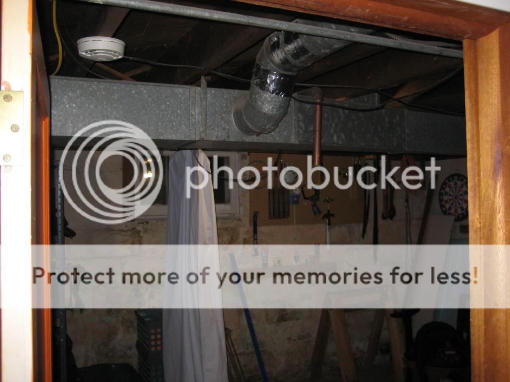

My plan is to enclose that HVAC supply in a soffit, along with all the electrical that runs along the beam. I'll throw out a few questions and see if anyone has run into these items before.
1. Junction boxes in a soffit? My current plan will involve enclosing at least 2 j boxes in the soffit, which I will have to maintain access to. I've used the plastic access panels you can get from the big box stores for water shutoff valves, etc. in the ceiling, but I wonder if anyone has done something more creative.
2. I plan on taking advantage of this time while we are waiting for contractor items by running all of the low voltage stuff I never got around to before. Does anyone have recommendations for tools that I'll need to run coax and cat5 throughout the basement and the ground floor rooms that I have access to through the basement?
Thanks for any advice you can give. Hopefully my next update should come in a couple of weeks, and will include an egress window as well as a much cleaner looking equipment closet.

One thing you could possibly do with the soffit junction boxes would be to put some low profile light fixtures at/near the junction box locations. All of you wires now have someplace to go, and you get the added benefit of some additional lighting under the soffit, which is often dark due to the soffit shadow.
Obviously this will only work if you can move the wires far enough to put the lights in reasonable locations.
