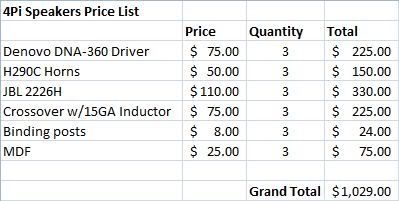

Keep 3x Wayne Parham's 4Pi speakers as close to $1000 as possible. Actual: $1029

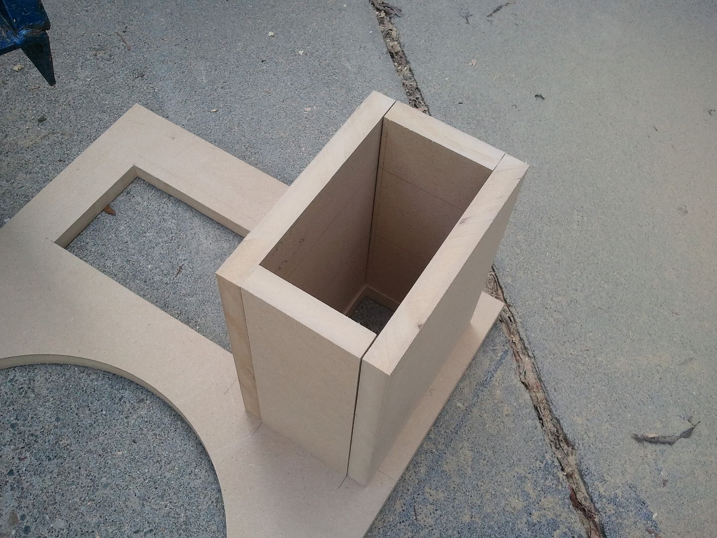

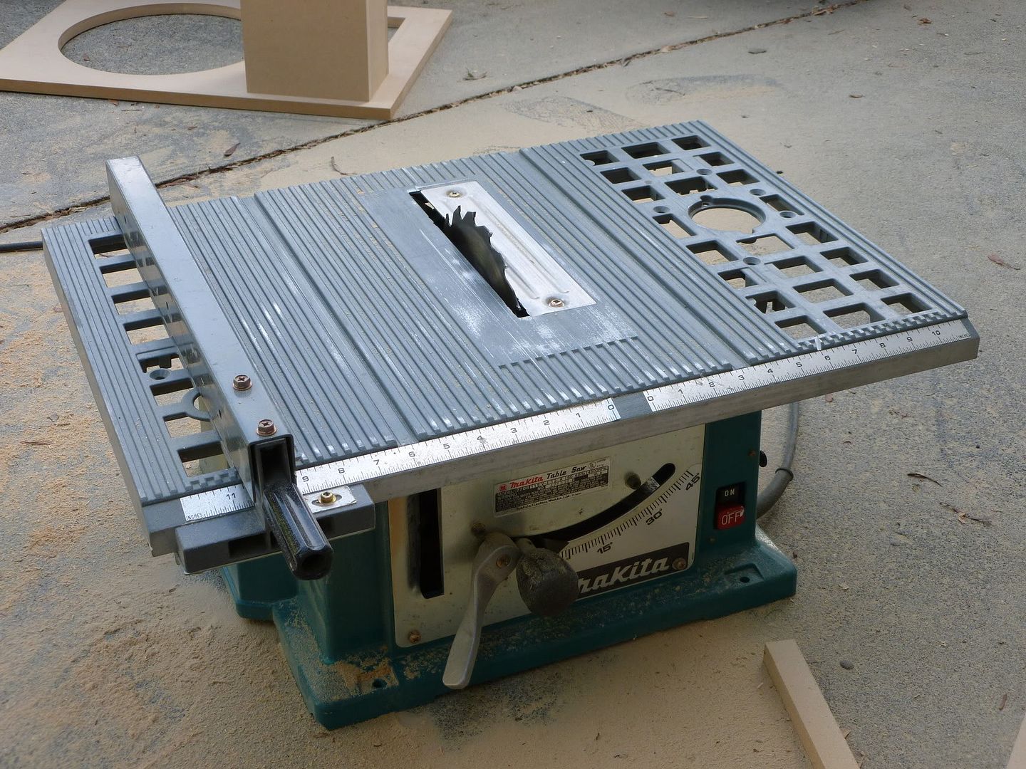

I'm going with 4Pi speakers in this build. You can find info on these over at pispeakers.com. Wayne Parham, is a great guy and definitely knows his stuff when it comes to speakers.

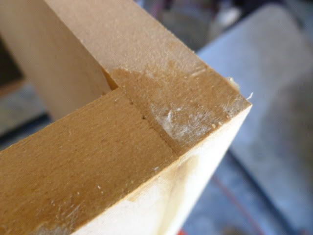

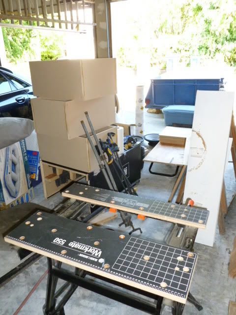

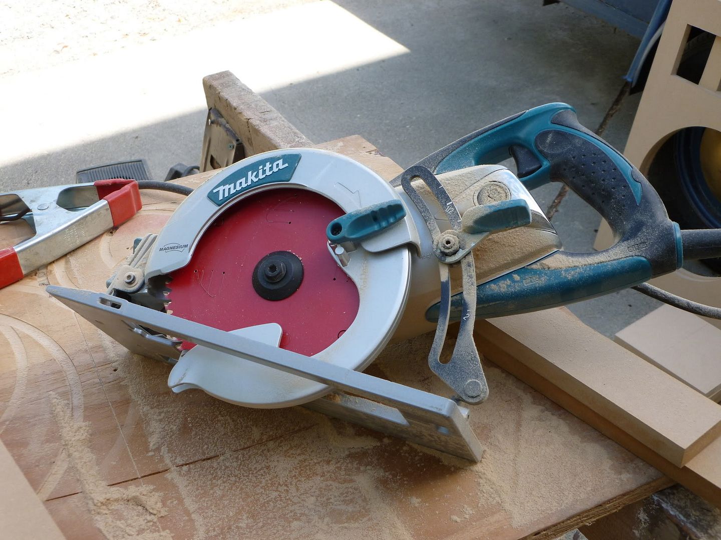

Since I'm paranoid and don't like screwing up cuts, I used a circular saw to get the rough cuts. I allowed an extra .25" on all sides to makes sure I had plenty of room for error. I forgot to take pictures of my panels before gluing, but I used my friend's large shop table saw to make all the final cuts.
The workspace:

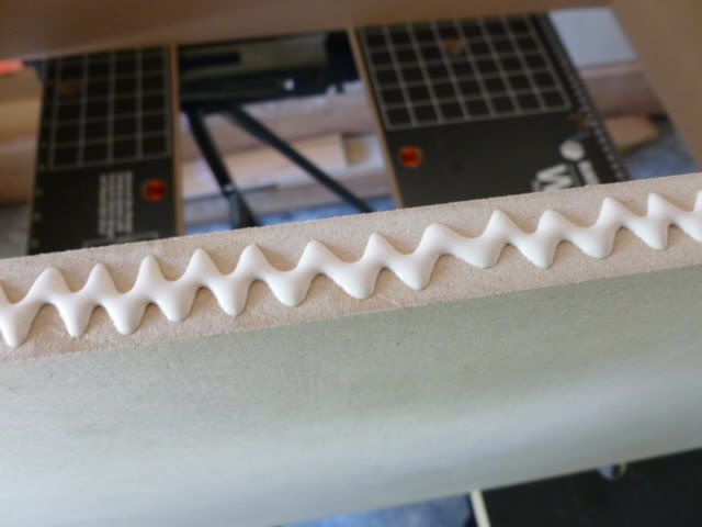

My sinusoidal gluing method:

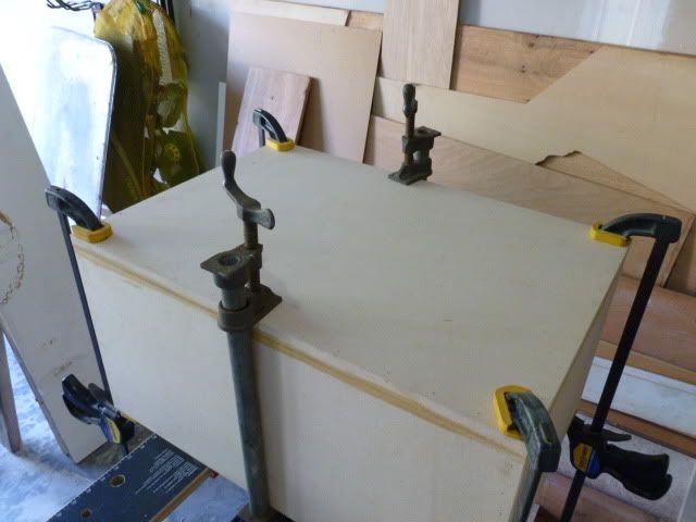

Everything all clamped together (less the front baffle):

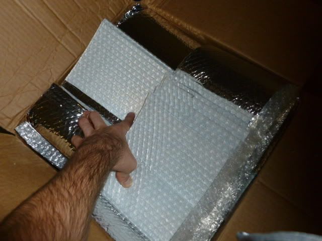

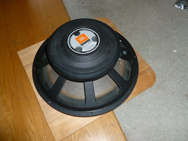

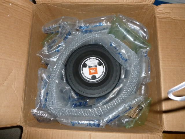

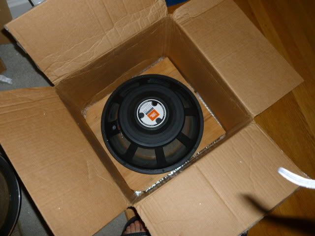

I bought all three of my 2226H speakers from a member at another forum. At $110 a pop in great condition, these were a steal. However, one was damaged during shipping. We have since worked out a deal to replace it and I'm shipping the damaged driver back to him today. If you're ever wondering about the best way to ship drivers, this is how:
Screw the driver to a piece of plywood that is the same dimensions as the box it's shipping in. This protects the cone from getting smashed. Then, stuff bubble wrap and the little plastic pillows to your heart's content!
Watch out for wookies!

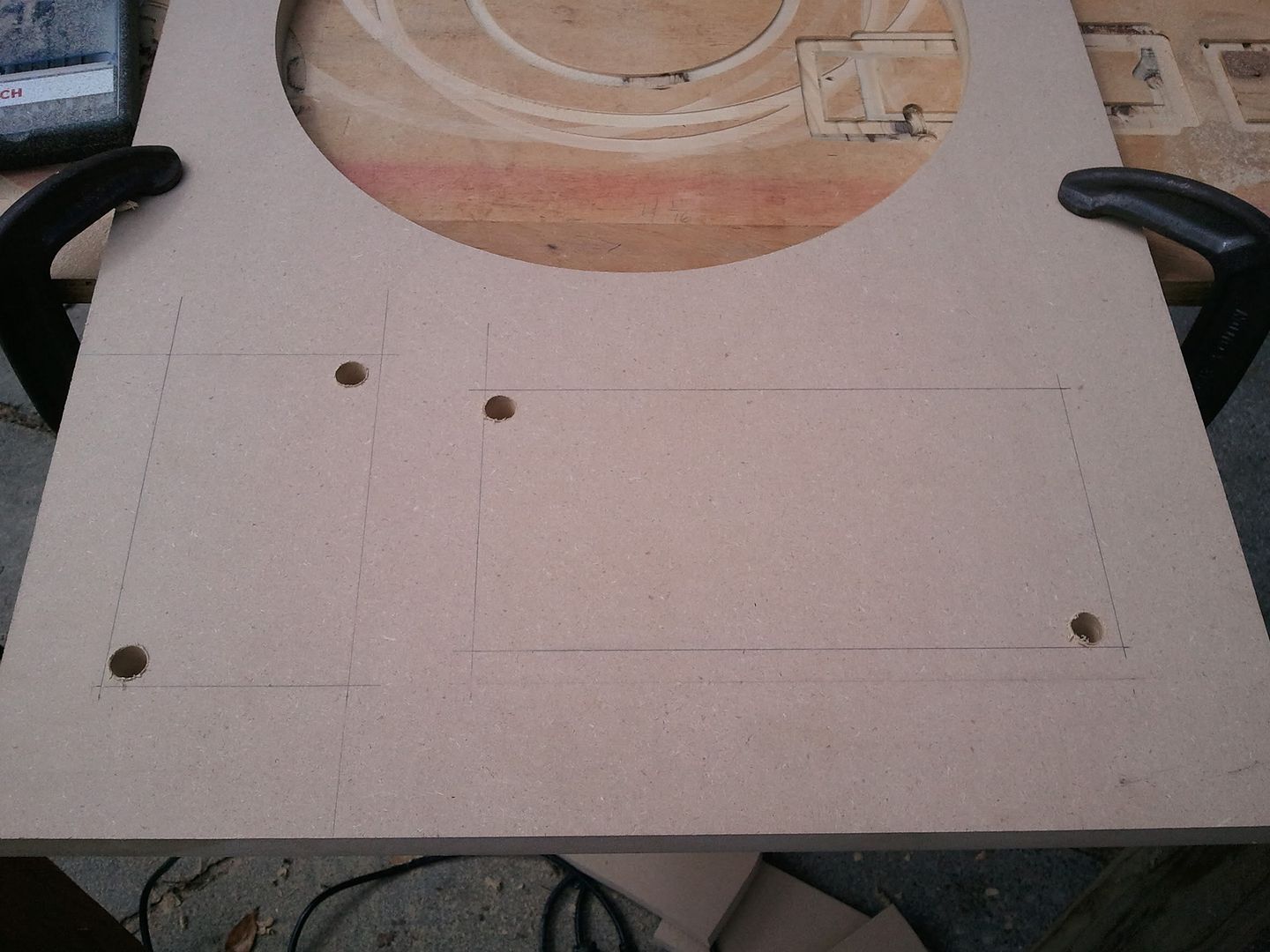

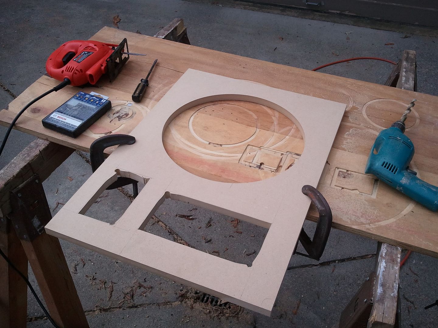

Today I took most of my time cutting out the holes for the horn and port. My old jigsaw held the blade crooked and the shoe was no longer straight, so I bought a new one. Home Depot has a great Black & Decker model for $30 right now.
My method for cutting these square holes is pretty common. Brace the board and drill two holes large enough for the jigsaw blade in opposite corners. Then simply cut away from the holes and the piece falls out. Then, trim up the edges if need be. I cut my ports a bit small intentionally so that I can use a flush-cut bit on my router to clean it up and make it exactly the same dimensions as the port once glued on.
Test fitting. You can see the excess I have to cut with the flush-cut bit.

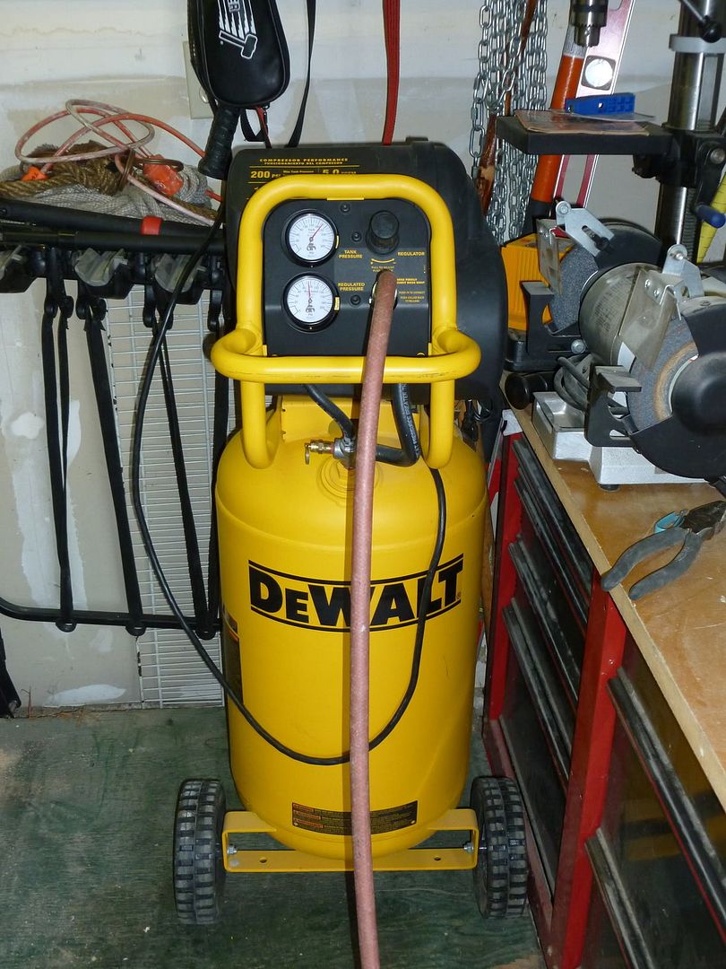

I'm using finishing brads to secure the panels in addition to the wood glue. My old compressor crapped out so I bought a new one. Holy cow this thing is a beast!
Some of my other new toys. Most of my tools were nearly 20 years old I've been using at my dad's place, so I've replaced many of them to new ones that work much, much better.

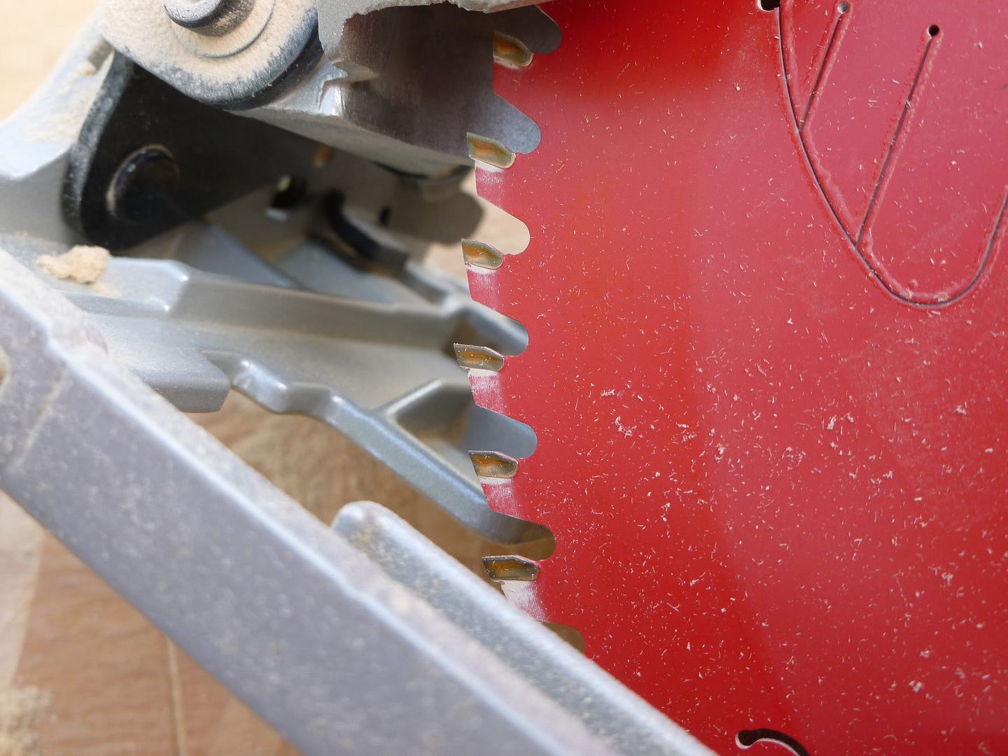

A fine tooth blade is crucial when cutting MDF so it doesn't chip. This is a 60T Freud blade.

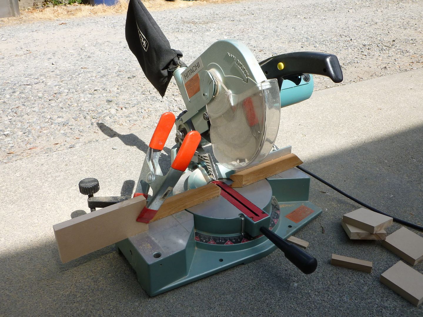

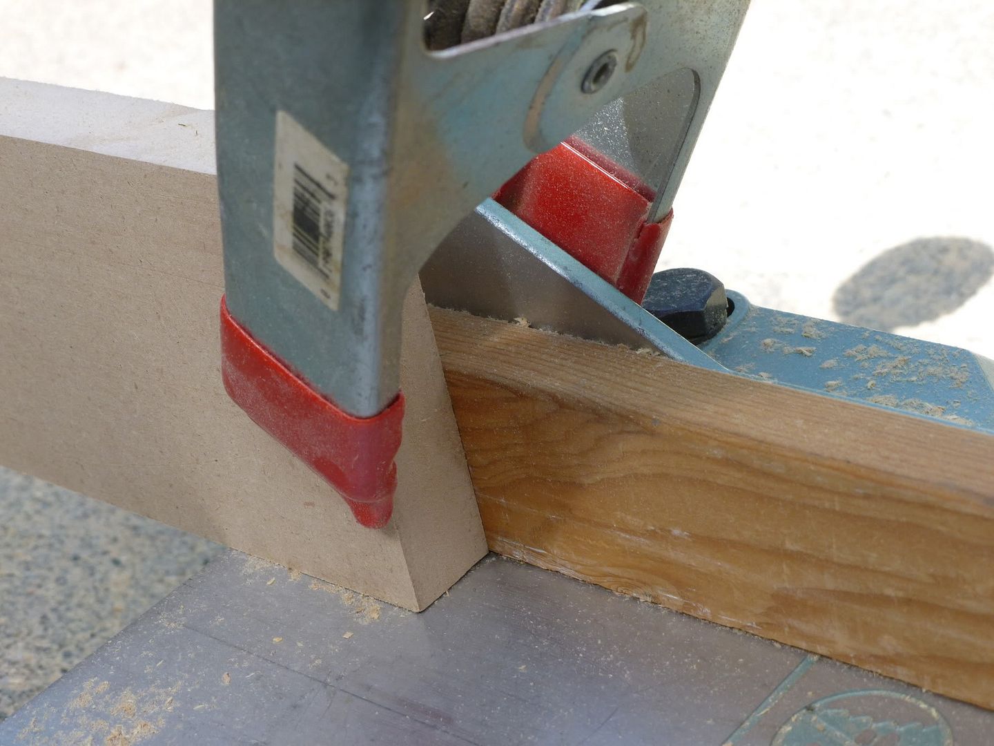

Simple way to make all your cuts the same length on nearly any fixed blade tool. Clamp a block and butt your cut piece up to it. Works every time.

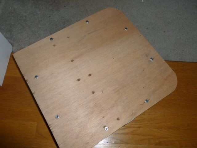

After they were painted, I installed all my t-nuts. Don't forget to use some sort of heavy duty construction adhesive to bond the t-nut to the MDF. You will thank me later when one pops out and starts spinning on you without the driver removed. I used some of the original formula of Liquid Nails that I had laying around, but Amazing Goop also works great. While the t-nuts are secure and the adhesive is drying, install your drivers and really crank down on the screws. This will pull the t-nuts into the exact right place so you don't have an "oh ****" moment when one of them isn't aligned with the driver.

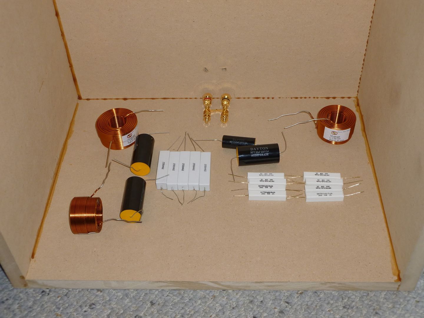

Next, let's talk crossovers. I decided to split the crossover into high and low sections and place them on the side without insulation in their respective areas, top and bottom. Using Amazing Goop, which bonds literally anything to everything, I secured the crossover components to the side of the cabinet. Important, keep the cabinet on its side while the goop dries for 24Hrs. If you don't, the inductors will likely slide out of place and you'll have a much bigger, messier problem to deal with when they bond to the wrong part of the cabinet. I used one of the braces to hold an inductor as well. You can never be too safe!
Here is how I had them laid out, post gluing. Note, the speaker is on its side!!
Low section.
High section.

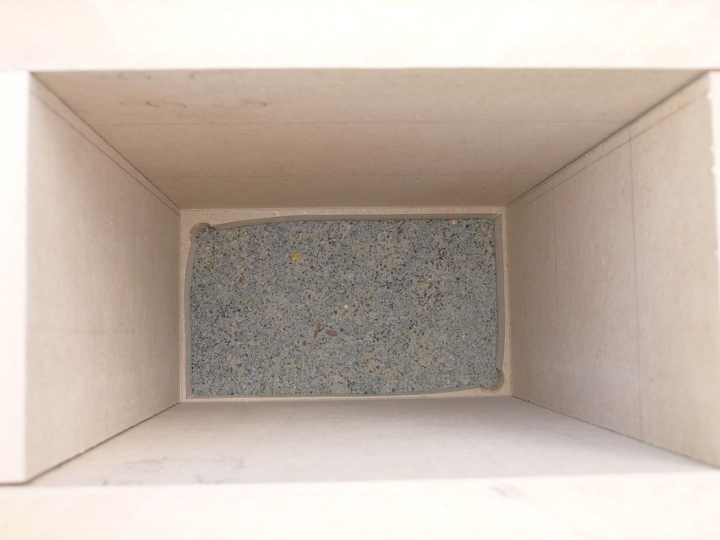

Next, I put all the insulation in. R13 is thick and a real bitch to get in the cabinet, but it's the best stuff to use. It also flattens pretty easily if it's too poofy for your liking.
This is the inside of the cabinet. I couldn't find any good pictures of the insulation on the bracing, but this is what you need to do. In the 4Pi instructions it is said to put some across the bracing to separate the high and low sections. What this does it to allow all the bass frequencies to pass as necessary, but prevents the high frequencies from echoing in the cabinet. This greatly reduces standing waves and reflections, allow for a smooth mid section.
I tried to not cover up too much of the crossover to let it breath and dissipate heat as necessary. Place the XO about 3 inches up from the bottom and rear of the cabinet to allow room for insulation.

Frosteh,
what did you use to mount the horn and drivers? t-nuts?
zheka is offline
post #24 of 24 Old 09-28-2012, 03:56 PM - Thread Starter
Frosteh's Avatar
Join Date: Jun 2011
Posts: 307
Originally Posted by zheka View Post
Frosteh,
Yes I did. Don't forget to lather the base of the T-nut with construction adhesive. I've had enough t-nuts pop out halfway through screwing the driver in that I take no chances anymore.
