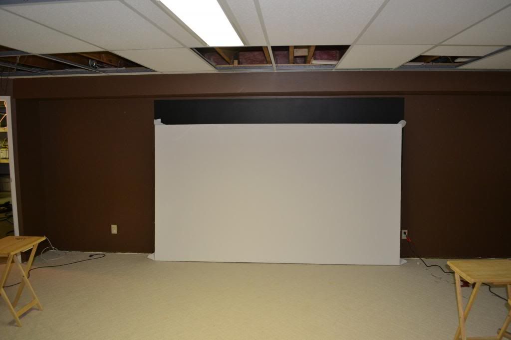

Fast forward to my nice sheet screen, we were having people over and my wife wanted to watch UFC and play XBox on a big screen
After a while I built an actual screen using Seymour AV material with a home made frame. I'm ashamed to admit that the room stayed like this for far too long.:

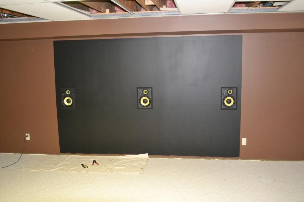

Got the front speakers installed and wired today:

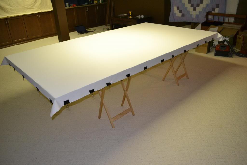

Built a frame for the AT material:
Mounted the material with Binder Clips, it works very well:

Spent some time getting the first column trimmed out, still need to route and sand it though.
I'm pretty happy with the way they are turning out.
