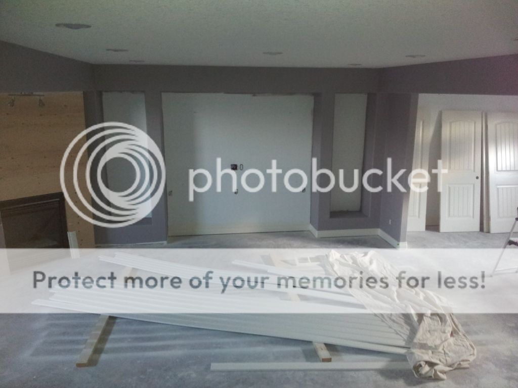

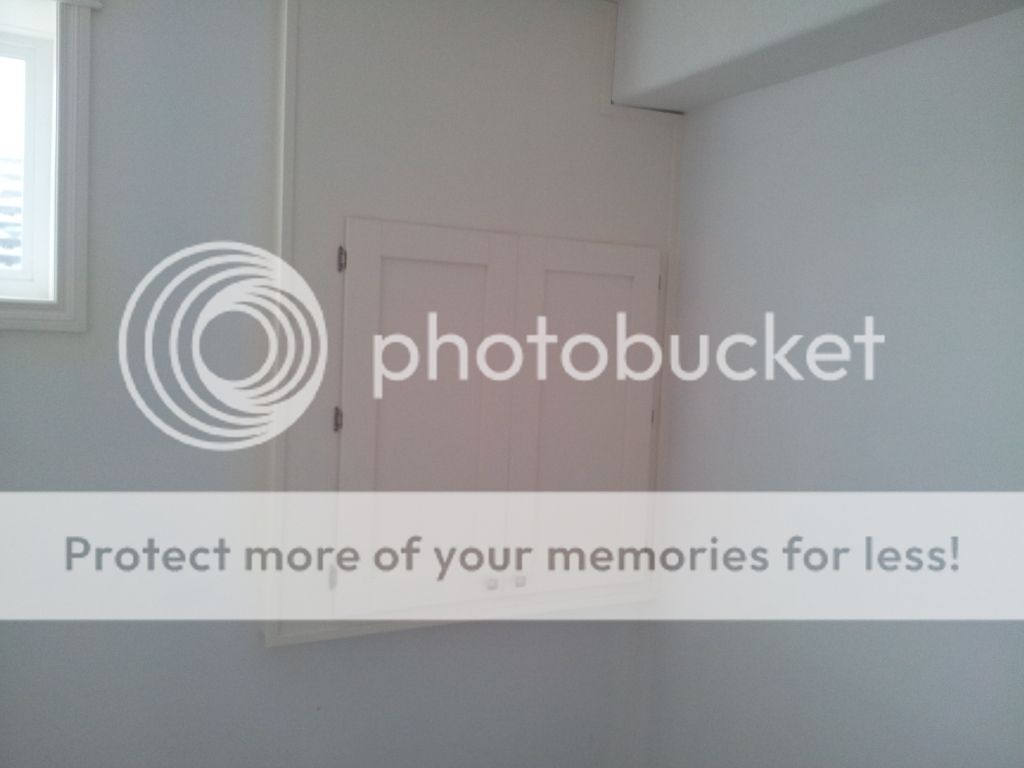

Trim is done, being painted as we speak. Went with a grey color. It looks a little purple but not as much as the picture suggests. Wife likes it a lot and I don't mind it so I guess its a win-win. Tried to take some pics last night but didn't turn out too good. They will be coming. I have a little bit of tiling in front of the bar area and fireplace to do before the carpet is installed on the 26th. Place is looking good.
Electrical panel cover with diy shaker doors.

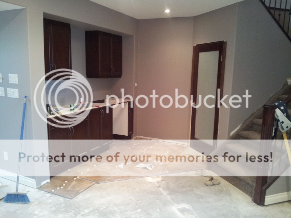

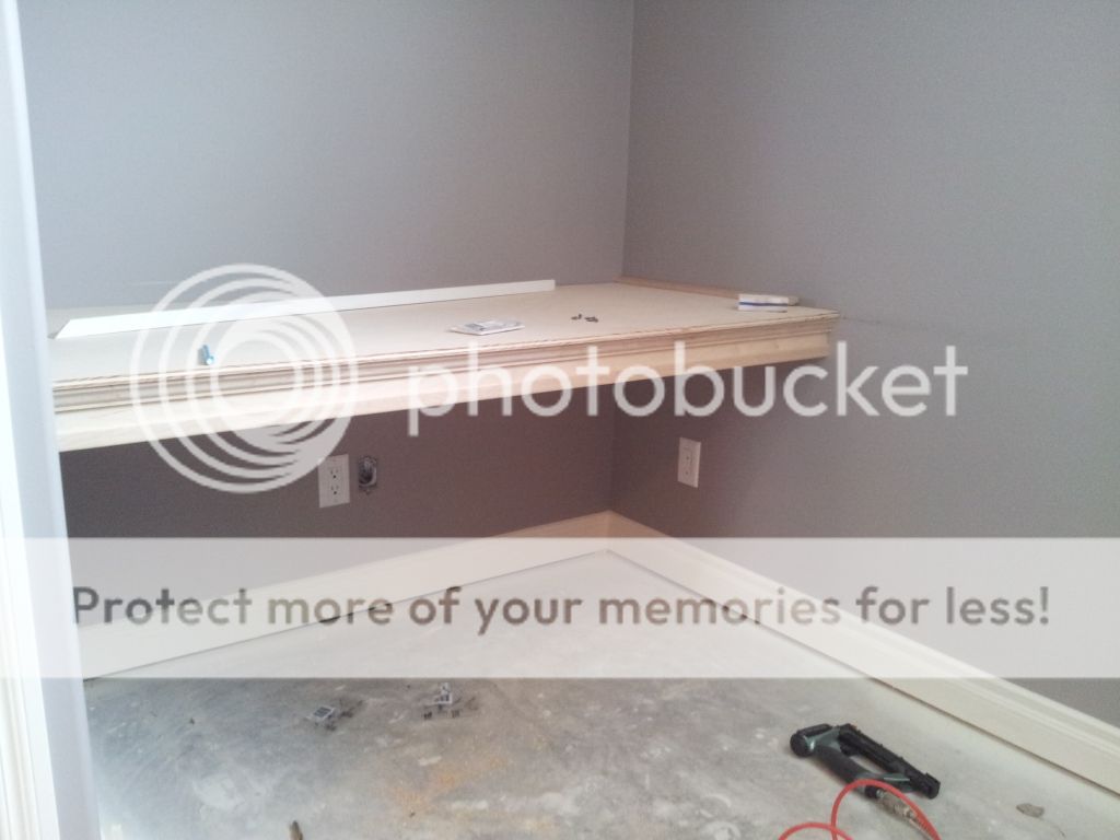

Did some tiling yesterday, on the home stretch but still seems like so much work to do.
Maple trim up and stained (trim needs varnish coat)
Bar area with tile (wasnt quite able to finish yesterday but good enough for the carpet guys to come in:
Computer desk, I have some upper cabinets to stain and install. Still have to edgeband the top ply.
