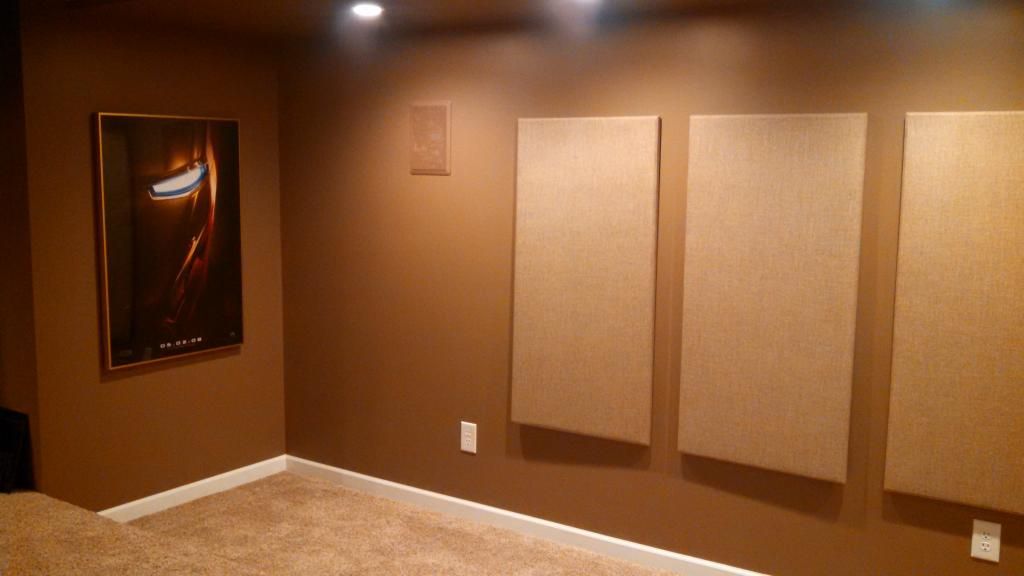

Acoustic panels installed on side walls
Update today - We did the exercise to locate all the first and second reflection points of the L and R speakers. Then we added first reflections of the center channel. We did this for 8 seating locations, so we ended up with 48 pieces of tape on the walls scattered throughout the side walls for the most part.
I had initially bought four 2' x 4' x 1" panels from Acoustimac.com and was going to put two on the front wall behind the front speakers, and two at the first reflection points. Then, I decided that since I was planning on having 8 seating locations in two curved rows, that one panel on each side probably wasn't going to be enough so I ordered two more panels.
Now that I have seen the spread including the center channel, I put up three panels on each side wall covering pretty much all of the first and center reflections. Some of the seconds aren't going to be treated, but I think I can live with that. Now I am going to wait hopefully for a Labor Day sale to order two more panels to go on the front wall since I robbed those two for the side walls. I'll post pictures soon!

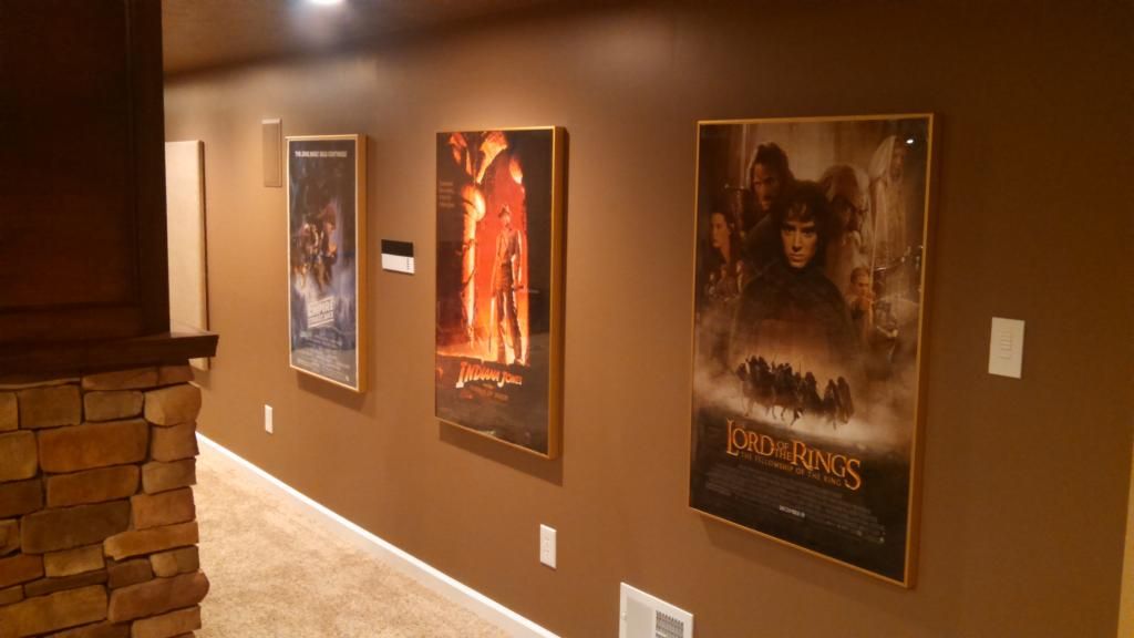

The movie posters are not acoustic panels. I've had most of the posters since way back from my old house theater, and I placed them outside the first and second reflection points for the most part. They are 27" x 40." The Iron Man poster could probably be an acoustic, or I might even need a bass trap in that corner. I'm just going to treat the front wall and first and second reflection points with absorption for now, then when I get all the seats in and everything calibrated, I'll probably try to measure the room with Room EQ Wizard and try to play with the acoustic treatments a bit. Still trying to absorb all that acoustic stuff, and there seems to be a lot of conflicting opinions about where to use absorption vs diffusion, whether you need bass traps or not, etc.
My side panels are 1", but if I get some for the screen wall, I will probably go with 2". They cost more, but are probably worth it in the long run.

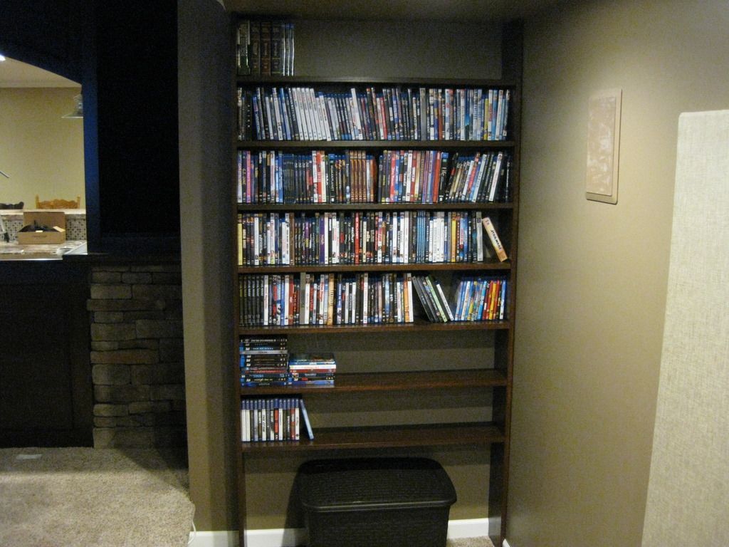

Quick update - here are the blu-ray & DVD shelves complete & installed:
They are 1x8 poplar with the same color-matched stain from the bar columns and dartboard case. Semi-gloss lacquer to finish. The lower supports had to be notched out for the baseboard trim, and along the side I had to remove the baseboard completely to allow the right side to be flush to the wall. L-brackets underneath the shelves anchor the whole thing to the wall behind.
