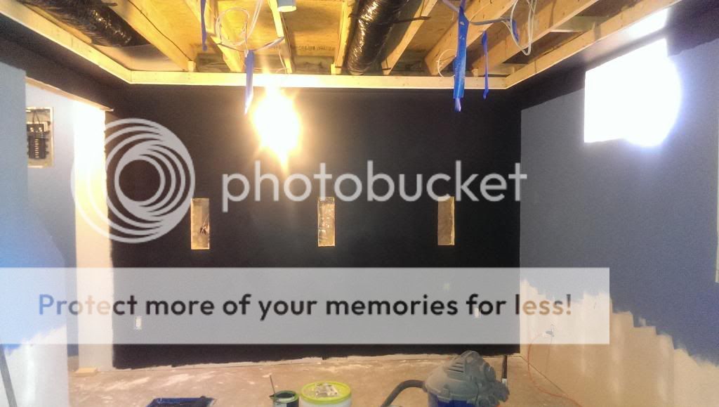

Progress pic finally.  All drywall and mudding is finally done.  Yay!
Between yesterday and today I've had 3 Axiom M22's, 4 Axiom QS8's, an Emotiva XPA-5, and an Emotiva XPA-3 delivered.  I really need to get my rack finished so i can install this stuff.

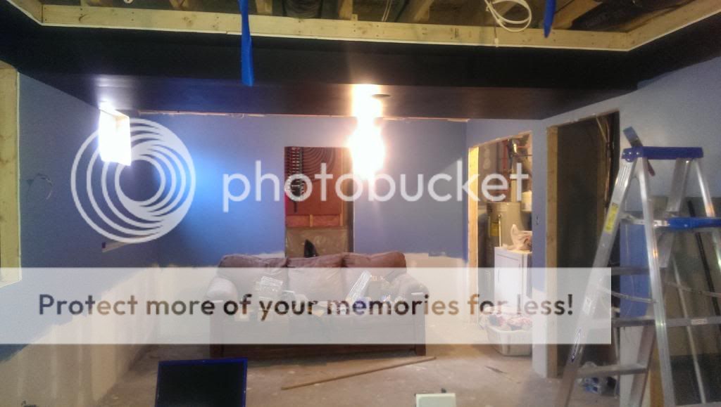

Got some work done in my basement over the weekend. Got all the walls painted and picked out my stain for the trim and wainscoting. Will have wainscoting on all but the front wall. Black stripe at top of wall won't be visible. Well, mostly. Putting up crown molding with LED lights so only a small amount of the black will be visible above and behind the molding.
Also, I'm not sure why it took me so long to think about this, but I have FINALLY tried out my new speakers and amps. Not sure why it took so long to think to just connect them to my laptop while I wait for a receiver.

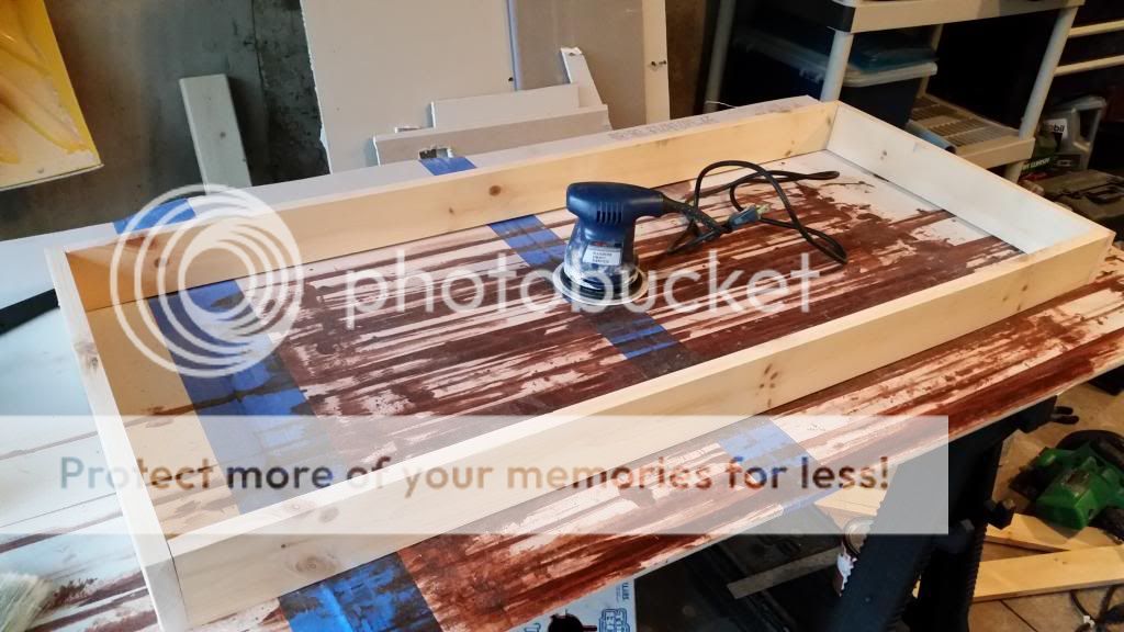

No progress in the room itself, but I'm getting all the doors and trim stained. Hoping to have everything finished by next weekend so I can start putting it in. Still have to stain and seal beadboard wainscoting.

Still working on the stain, but am almost finished. In-between waiting on coats of poly to dry I've got all the door casings and trim installed. Just a couple more days and I should be 100% finished with staining and can knock out all the wainscoting. My personal deadline to have this room finished is June 28th. Having a July 4th party at the house and would like to have it finished by then. We shall see....

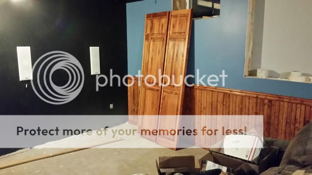

First I gotta show off my father-in-laws great help with the room. I wouldn't be anywhere near as far as I am if it wasn't for his help so far. I've done all of the staining and poly, but actually installing the trim and wainscoting has been mostly him. The side wall is almost finished.

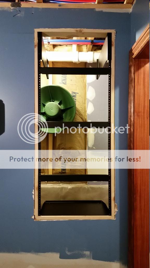

I also, FINALLY, got my rack rails and got them installed in the wall. I went with the MA RRF 27U rails. That's more than enough space for what I currently have and hopefully enough for any future upgrades. I built a box out of 1" x 4" pine (actual dimensions are closer to 3/4" x 3.5") that is going into the rough opening and shimmed in place to ensure level/square.
Then the rails are fastened thru the pine and into the double studs with 5 3.5" lag bolts per rail. I also put a 2x4 across the bottom with legs going down to the bottom plate, like framing a door, to provide support from underneath. I may have went a bit overboard, but this thing ain't coming out now unless the whole wall comes down.
All of my equipment is finally here and tested, just tested the subs last night, except for the Oppo which is still shipping so I should be good to go with no need to return DOA equipment. Maybe I shouldn't say that until the Oppo shows up.
In the next few days and this weekend I want to get everything moved into the rack and finish staining/poly the wainscoting. With the wait times between coats that seems to be taking forever to get finished.

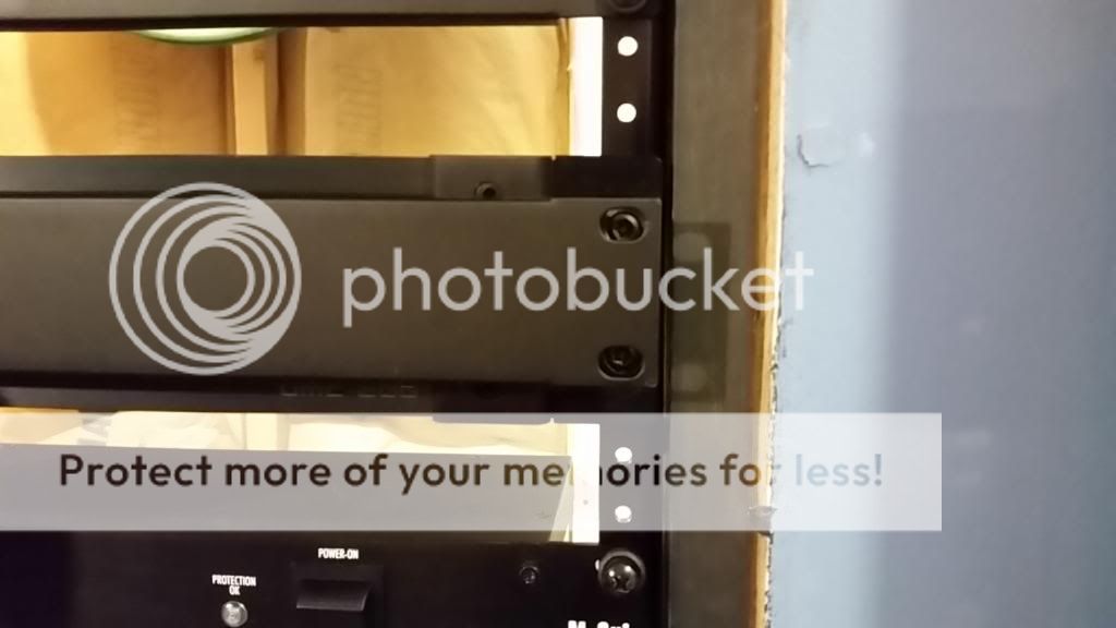

I got all the gear I currently have in the rack now with the exception of the Oppo. Once I get around to picking up my cable box I'll order a MA custom shelf and faceplate for both. The UMC-200 is a PITA for rack mounting. I knew when I purchased it that the rack kit was 1.5RU, but I assumed that half RU would be all above or below the full RU. It's not. They split the difference. So there is an unusable .75RU space both above and below it.
I'm going to pick up a sheet of aluminum from Lowes this weekend, cut two .75RU pieces, Plastidip them, and fill the gaps. We'll see how it turns out.
The 75 pound beasts that Emotiva calls amps are mounted too. That was a chore for lack of a more suiting term. I can think of many more suiting terms for it, but im afraid none of them are pg-13. The bottom of the bottom amp is about 6 ft high and the top amp is 5RU above that. I held both in the air over my head while my brother in law held the front and screwed them in. I put them at the bottom to begin with, but that would of made the xbox, bluray, and receiver too high for the kids to reach so I decided on putting them at the top. With the 6 3" lag bolts per rail I highly doubt the rack is going to go anywhere even with majority of weight at the top.

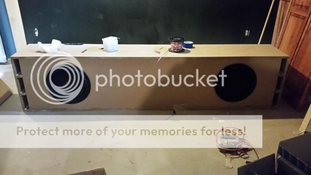

Sub box is built now. Just have to fill the screw holes, sand it down, and paint it. Two 15's fill this room beautifully.
Build thread:
http://www.avsforum.com/t/1533297/lukes-dual-ported-ultimax-15s
