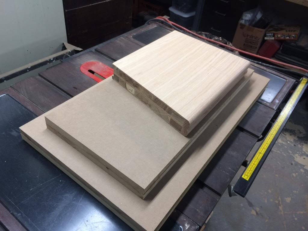

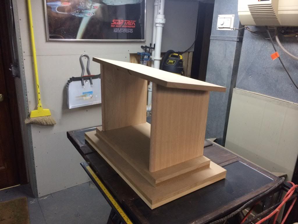

OK - just a few photos; a stand for the center speaker (Klipsch RC7).
Didn't like any of the commercial offerings so doing this instead. Will be angled up 10 degrees to hit the MLP.
The horizontal MDF slabs will be finished in black Duratex
The oak uprights ( from an oak stair tread) will be finished in golden oak to match the trim in the room.
Cuzed2
CuznEddy Cinema
cuzed2 is online now

Originally Posted by cuzed2 View Post
speakerstandroughfit_zps541f4436.jpg[/URL]
Remember to put a lip or edge along the back edge so the speaker doesn't slide off during reference volume. smile.gif
deewan is offline

deewan,
Good catch for sure!
Will actually have a 1/4" filler piece on the back cavity, it will extend high enough to keep the speaker from sliding backwards....
