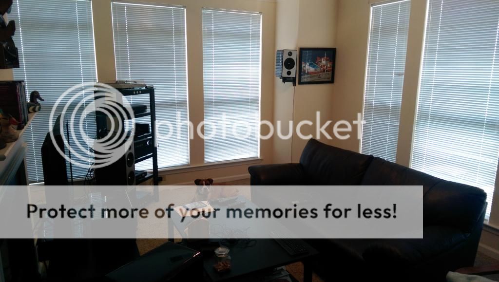

Why can't you wall mount the fronts just off the stone wall pointing towards the sitting position and hang a center speaker off the TV?

Aesthetically, I think a soundbar would look much cleaner. I have to have the girlfriends approval, and she is not a big fan of me having exposed speakers hanging off the wall, especially the stone wall.
I was thinking of hanging them on the dry wall sections to either side of the stone so you don't mess up your stone look. If you look at this picture of my system (STILL IN PROGRESS OF SETTING UP) of the surround you could hang 2 up high and those supports can pan and tilt as needed. In my opinion these will out preform soundbars. Just my two cents. More info on the mounts here: http://www.amazon.com/gp/product/B00...?ie=UTF8&psc=1
However, a soundbar will probably be the cleanest look except for in ceilings which I wouldn't rule out. If the aesthetics of not having speakers visible I would seriously look into this. Go to a store where you can listen to some. Some in ceilings can tilt the whole speaker or just the tweeters towards the sitting position.
