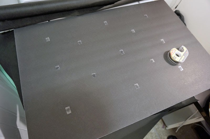

Place double-sided tape in dispersed pattern. This will keep the fabric from sliding off and help keep it from sagging in the future.

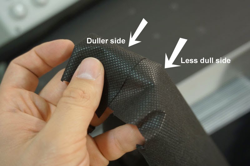

Determine which is the duller side. This is the side you want exposed as it will absorb light better than the other side. The easiest way to figure this out is, at least with the fabric I used, the side with the smaller squares is the dull side.

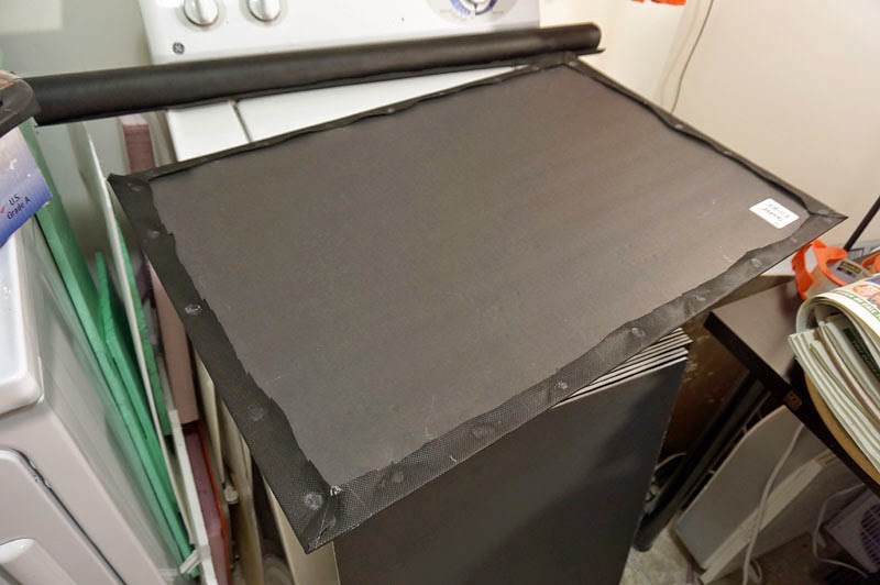

Add a about dab of hot glue to the center edge of the board closest to you. Use a low-wattage glue gun for this. Too much heat will deform the board.
Grab the edge of the fabric from underneath, stretch and fold it over to where the glue is and quickly press down over the glued area with your thumb (it will be a tad hot).
Repeat on the opposite sides, working your way towards the edges. If you've put together fixed projection screens this should be second nature. It's best to stand the board up vertically while stretching the fabric.
Completed tile.

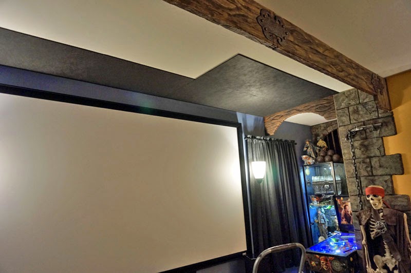

Using just five tiny pieces of mounting tape was enough to stick these up to the ceiling (on near each corner, one in the center).
Yes, it's a pirate themed room. The masonry and woodwork is actually carved out of foam.
Complete setup.
Cheap, yes. But effective. And best of all, 100% wife approved! I hope this post will help those looking for a cheap and easy solution to ceiling reflections.
