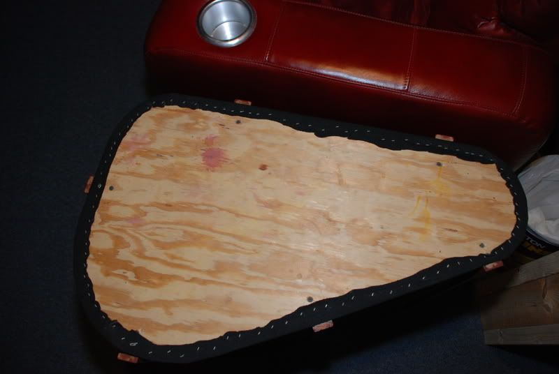

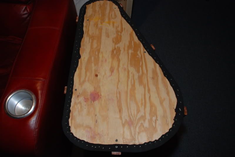

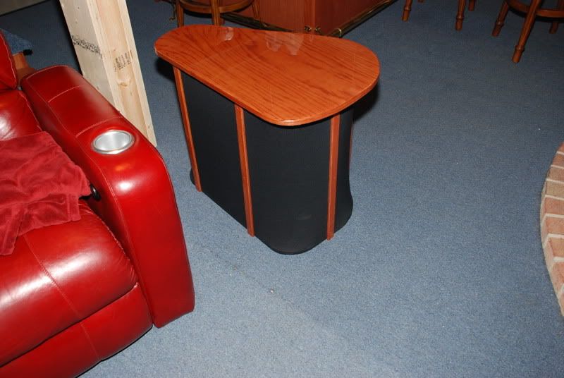

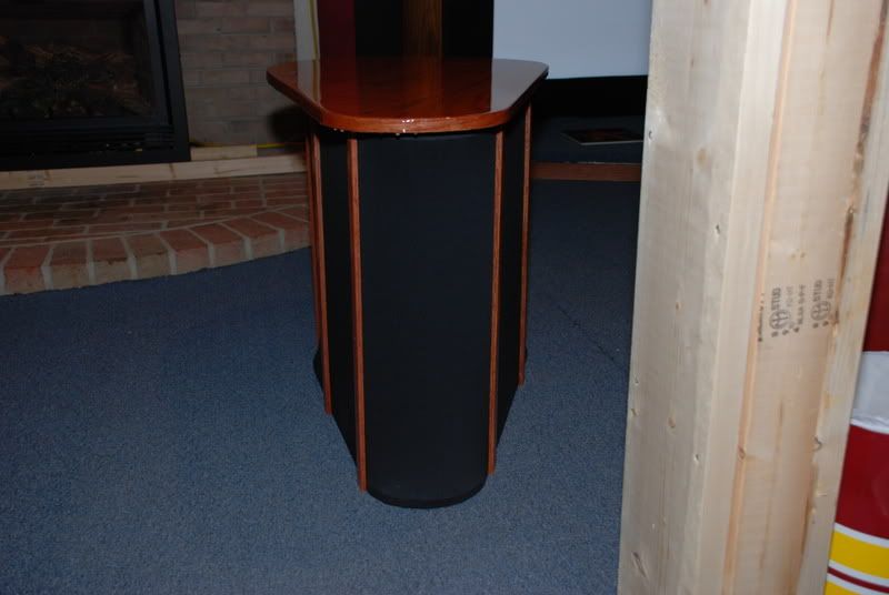

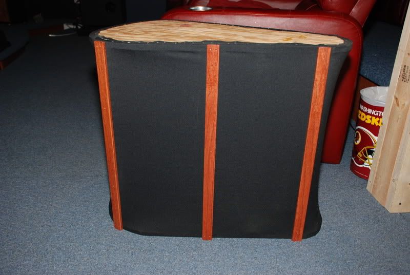

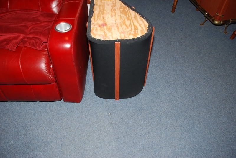

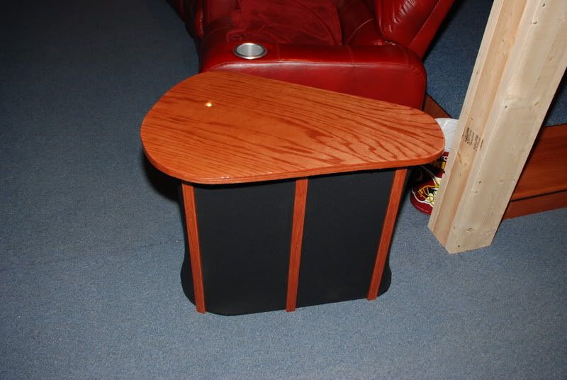

My wife wanted a table beside her chair. I had some decent plywood left over from another project and a few 2X3's. I cut the top and bottom to match. Used veneer tape around the plywood edge. I screwed the 2X3s in various places leaving a rather deep lip. Here is where it get's weird. I stuffed the inside of the 2X3's with OC 703. I then took some black Celtic cloth and steached it around the 2X3s. I then tacked and stained oak strips from top to bottom over the 2X3s and celtic cloth, enviorntexed the top and that was it. Cheap if you have the extra wood and other parts. I'll post a couple of pics tonight. And it absorbs some low frequencies to boot.
Edit, Hope this gives you some ideas;
you can see where the 2X3s are screwed to the top
with the top on
HeyNow^ is offline

thnaks for the idea, hey where do you get your helmets at and do you get them cheaper tehn usual? I have 5 full sized ones, south carolina and 4 hs ones from the area. Im not too big on pro but would like to get an eagles helmet for cheap

Randy, table looks great. Is it acoustically transparent? Did you really stuff it with insulation?
I'm actually still in search of a good table that would pop into the cupholder in the Berks. I have found a really nice one (actually at work), but it's part of some mobile work furniture line. Well made, but I haven't found any pricing on it yet. I have a few leads there I just need to track down.
Bud
chinadog is offline

Yeah...it's stuffed with one 2X4 peice of OC 703. And the materiel is AT. If you stand anywhere near it you can tell it's there. The wife used to use a fold up tv tray table. I had one of those days that no matter what I was buidling in the theater it just didn't seem to be going right. I needed to make something, regardless of how simple it was, way out in left field to energize my creative juices. So in about an hour, I knocked this thing out. I figured if it sucked, I could make an nice bon fire with it this summer.
The wife loves it. And I got to test out my enviortex pour prior to using it on my bar top.
I have surrounded the Pole with 2X8s and drilled access holes for speaker wire. I have my side surround for my 7.1 speakers installed. I am going to skin it with MDF and oak veneer and then trim it out.
On the cupholder thingy...I have SS cup inserts that slide into the plastic cupholders installed in my 090s. They are about 3.5- 4 inches deep, maybe more. I was thinking that I could make a thin lightweight table, cut a hole large enough for the SS insert and then put the insert with the table attached back into the chair....maybe it would work.

I thought about making a table insert just as you described, was thinking about filling the mounted cup with something to give it more stability and weight, like BBs or ball bearings or something. That would help with tipping if there are any gaps in the cup holder or if someone accidentally stood up while the tablr was in place, it woudn't just fly off. Still chewing on that idea, also a little bit easier and time consuming than doing a star ceiling.

Randy - I finally got a chance to see your table pic above (it was blocked the last time I was in this thread). Nice work!
