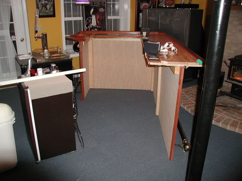

I made my bar portable. Why? Simply because I may need to move it to get items in and out of my basement door. Believe me, it's stable and it slides across my carpet with ease. I just unscrew two bolt attached to the base cabinet and I can move it by myself.
As you will see from my pics, there is no blueprinted plan. I actually placed blue painters tape on the floor to see how the bar would impact on mobility in the room. I moved the tape several times.
I'm still adding items and changing décor frequently. I like my environment to be flexible; i.e. Superbowl parties, movie parties, etc.

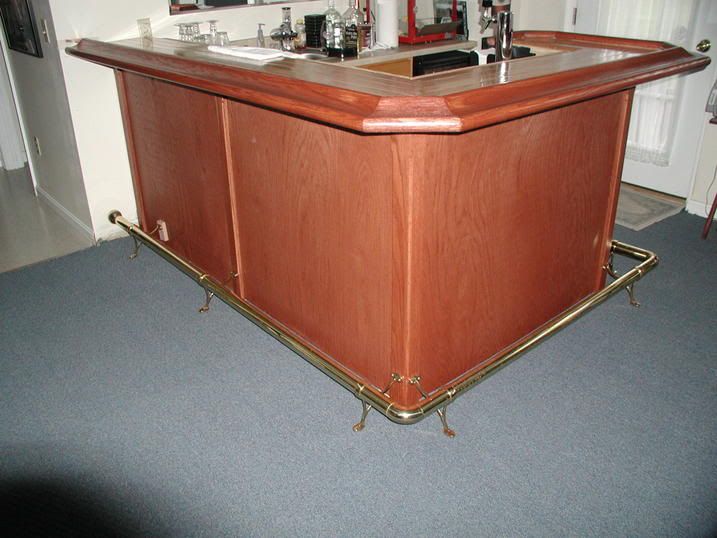

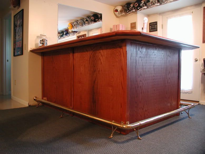

This shows the long dimension. My base is 7 feet long by 4 feet wide with a 2 foot return.
This shot shows the 4 foot section of the base and the ¾ plywood top.

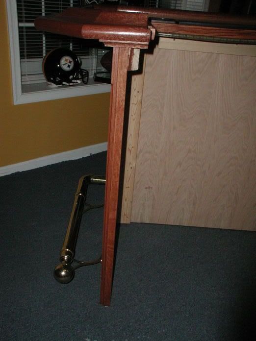

This shows the return and you can see the back of the bar that I used 2x4s to bridge the plywood sections.
How the unit will relate to the half of the basement room.
The beginning of the application of the bar railing. I love this stuff. It drove me crazy, but it looks good and is very comfortable. The chair is there to check the height, but it was several inches shorter than our final chairs. So why did I bother? Because I was thirsty!
Long side with railing application
Return side

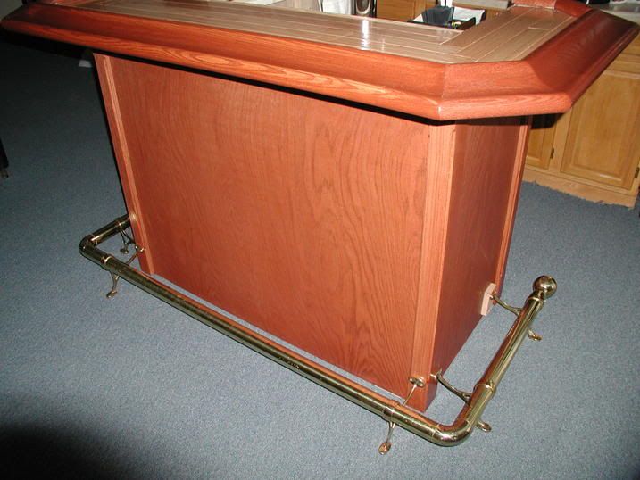

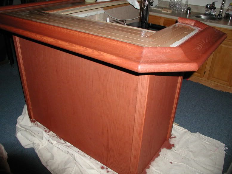

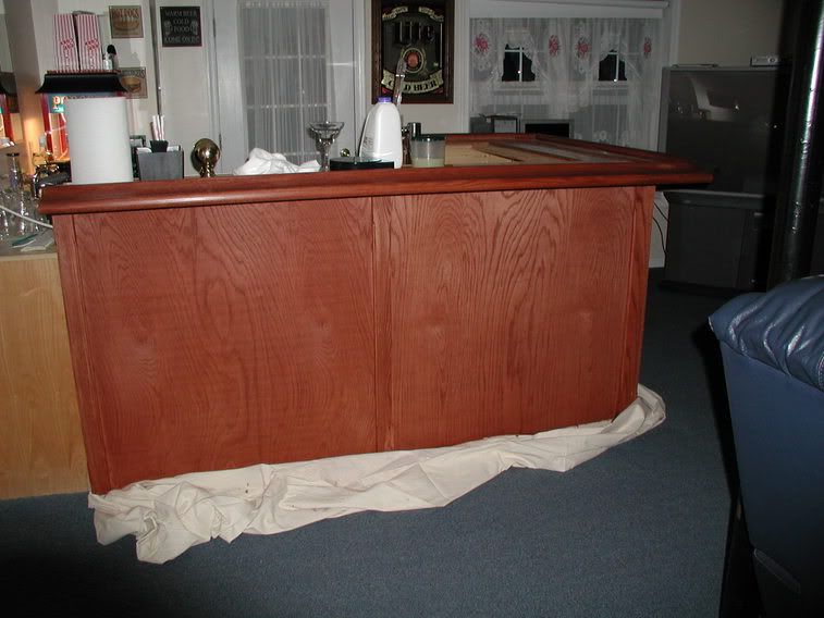

The staining begins
I wanted black granite tiles for the top but couldn't find a vendor that didn't require a large minimum number of tiles. So as you will see the top is oak flooring.
I used 1X3 oak on the corner ends and seams. I used a router to add a groove.

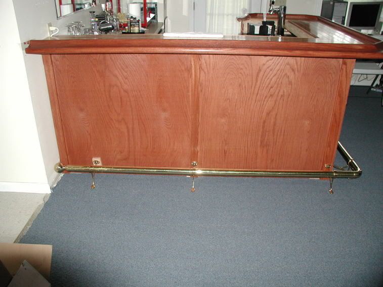

I decided to put brass railing on for the footrest. Wood and brass, I like it. Search the net, there are bargains for brass railing and fittings, some are twice what others are.

Thanks for the construction shots, it gives me some more ideas. I'm curious where you found the bar mouldings (the chin rest)? Sounds like you did some online sourcing. That moulding makes a huge difference in the final product.

Hey Biggie.

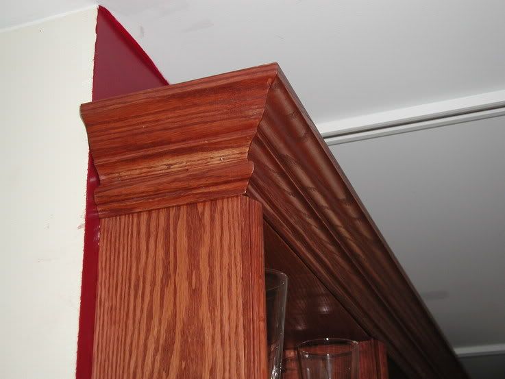

I found the molding at a local Hardwoods vendor, believe it or not, just 10 minutes from me. They have all types of molding and exotic wood material. Bless the yellow pages!

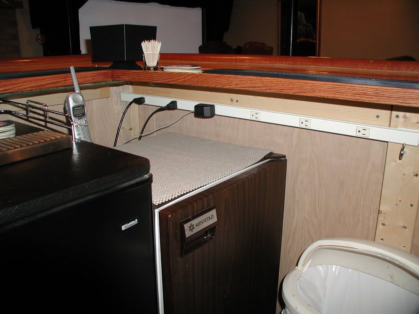

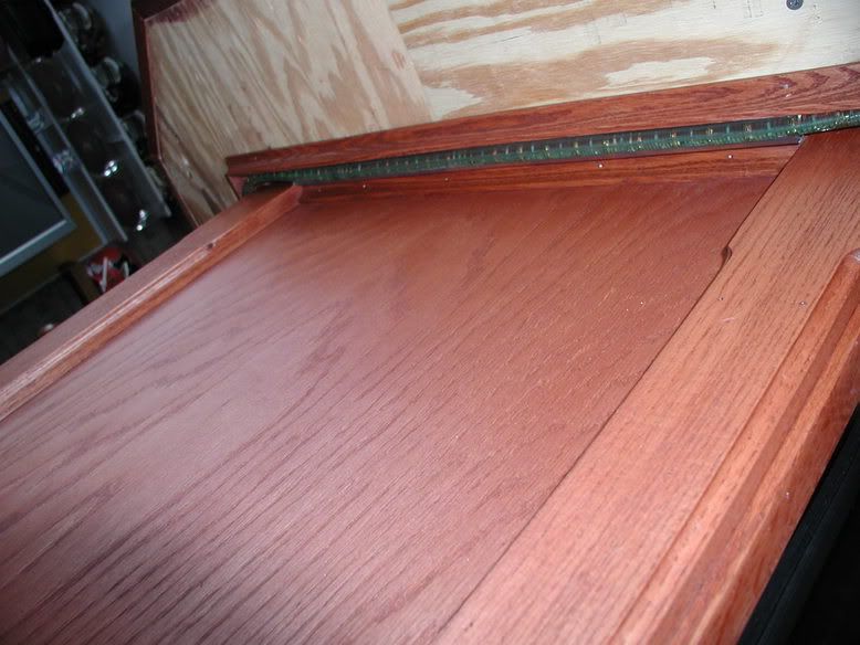

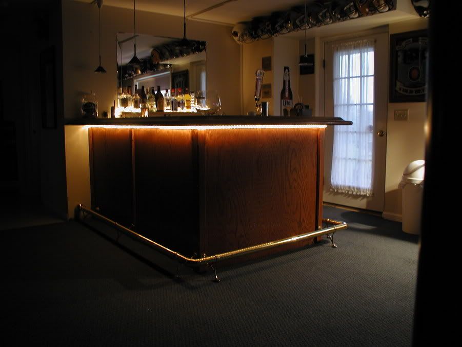

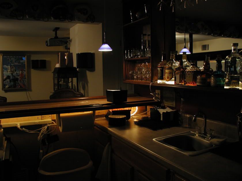

Since the bar is stained pretty dark, I decided to add rope lights under the top. The non-dedicate theater seating area is adjacent to the bar; I had to figure a way to avoid the light hitting you at eye level while sitting in the Berks.
So I laid the rope in clear channel and then pinned molding in front of the string of rope light.
Problem solved.

HeyNow,
Where did you connect the rope light to the electric? Did you run it behind the bar? I strategically placed a switched outlet on the wall where the bar counter meets the wall for plugging in EL Tape, Rope lighting or whatever works the best.
Great job.
Bud

I ran the rope from left to right on the outside all the way around to the inside terminating at the wall. I then plugged the rope into a lutron lamp dimmer then into wire mold that I installed on the inside of the bar. I have the kegerator and one small fridge plugged into the wire mold as well. This way I can disconnect one wire and move the bar around.
It is a little cluttered in this early picture, but you can see the wire mold under the bar top.

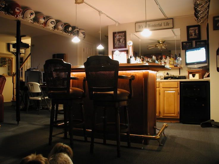

Here is a shot as the bar is today. I'm constantly moving things around, but you will see the new fridge the wife got me for Christmas.

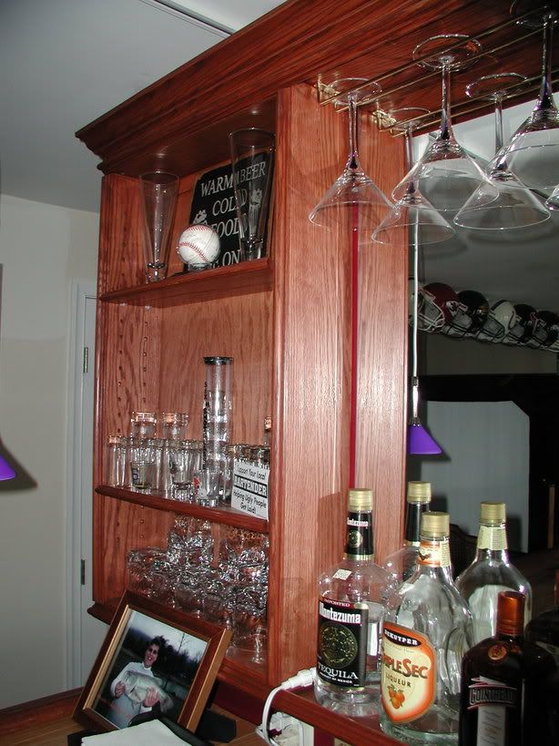

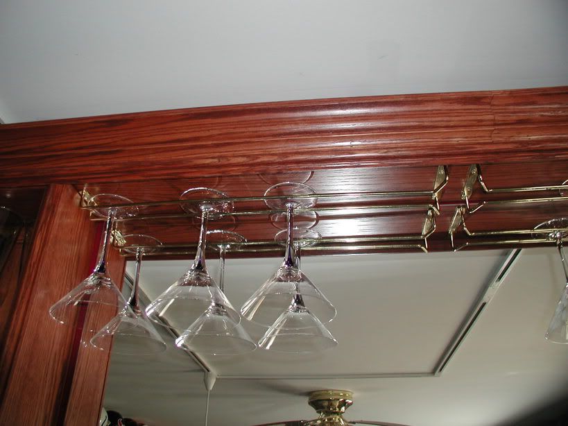

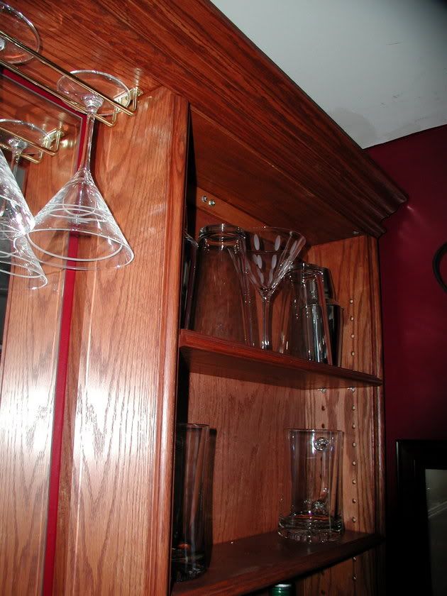

The back bar consists of 1x6 oak boxes (2) connected to a 1X6 shelf. The top is a 1X6 oak plank with crown and trim piece. The top lifts off and each box can be removed from the wall separately leaving the bottom shelf. The mirror is beveled standard mirror fare I got from Lowes.
A couple of close-ups of the back bar detail. I still have to paint the ceiling darker.
And one final shot of the completed (yeah right, my work is never done) BAR!
Hope this will give interested folks some ideas.

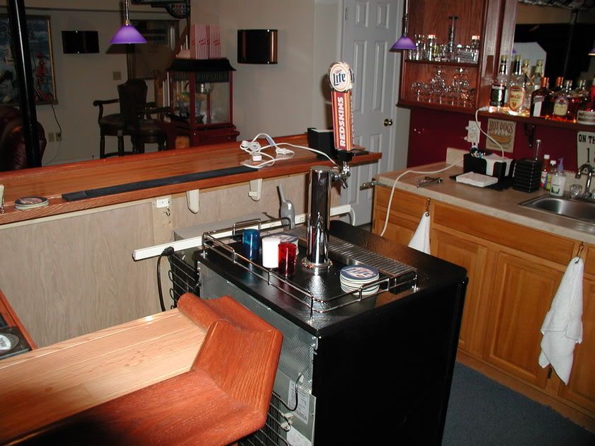

I have additional counter top to put above the fridge that sits next to the kegarator. You could certainly do shelves in this application. Shelves would not work for me on the long side because I couldn't open the left drawer or cabinet door. That area makes a great place for the trash can. I didn't need any additional shelves since I have the storage under the sink.

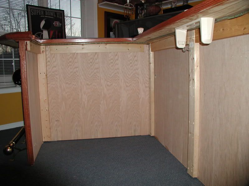

CaptRandy,
I'll take some this evening and post just for you!
This is for CaptnRandini,

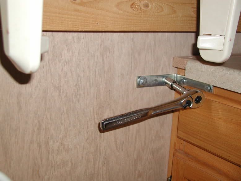

First two bolts are removed
Take off the wire mold (two clips hold it to the 2x4). Unplug the rope light since it's attached to the bar top. Pulllll ..moves well on the carpet with nylon slides on the bottom of the bar.
Inside of the pulled out bar. Lots of room for shelves if you want to build them.
Return sidenotice how thin this is? Think office furniture.
This is the long side that goes against the wall. You can see where the rope light begins. This is a very telling cross section of the build.
Distance shot

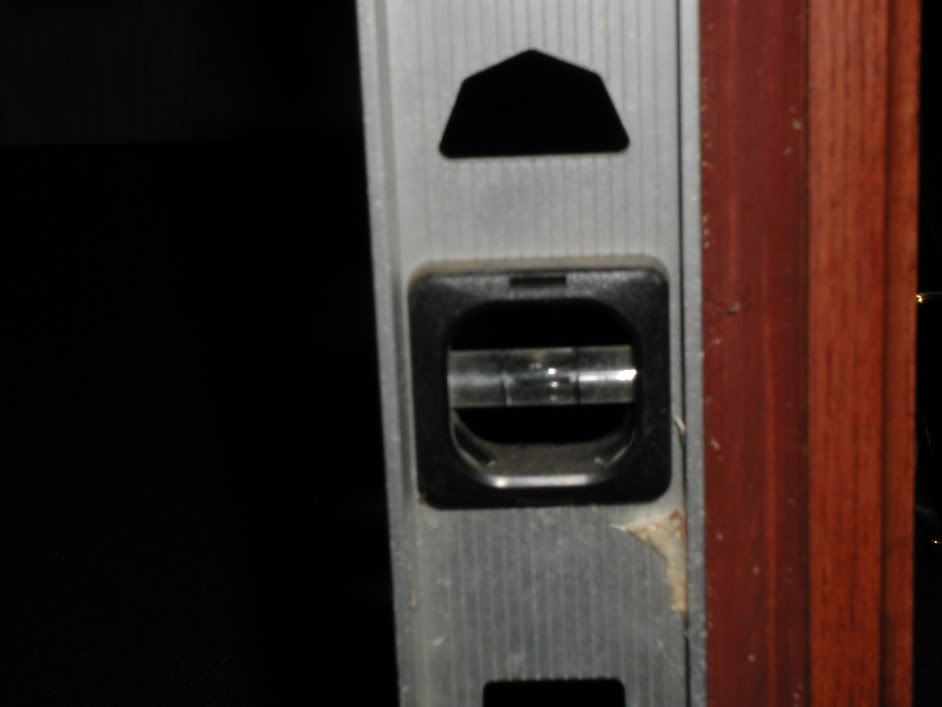

I'm bragging.standing alone it's pretty plumb
Bud, you can see the wire mold clipped back on.
For this demonstration, I did not move the kegarator or mini fridge. The are easily moved out of the way with wheels.
There you have it CaptnRandy!

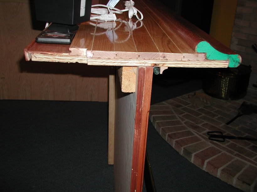

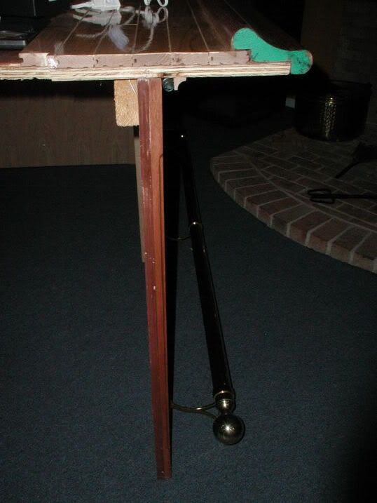

Great pics! Thanks. One more question...the cross section pic is worth a thousand words about how you did this. Have you felt the need to brace the top at all? It looks like it is only attached to the 2X4 from the top, or are there some braces not shown? Does it wobble if someone leans on it too much? I'm thinking even just an end piece of plywood would stabilize it greatly and not add too much more weight.

Tom,
Very observant of you! I was worried about the same thing. But surprisingly with the 3/4 plywood base top and the 3/4 oak flooring AND the wrap around bar molding this baby is extremely rigid. At some spots there is an additional 3/4 routed trim piece that adds additional support underneath. That makes it a total of 3 inches of width support. It is glued and screwed. There is no wobble or flex at all. I think that it has to do with the backward "J" shape of the top itself. The top is attached to a sandwich of 2X4 and 3/4 inch plywood. Now, I won't kid you, if someone got on the bar and danced near the wall, I would guess it would give a bit. But only slightly on that end. I could put a 1X on the wall to hold it up or an angle iron like I have to attach it to the base cabinet, but the back bar is there and that prevents any major weight on that end. Besides, the largest beer I serve is 1 litre .
Here is another close up of the cross section. You could brace it with an angle brace under the bar.
