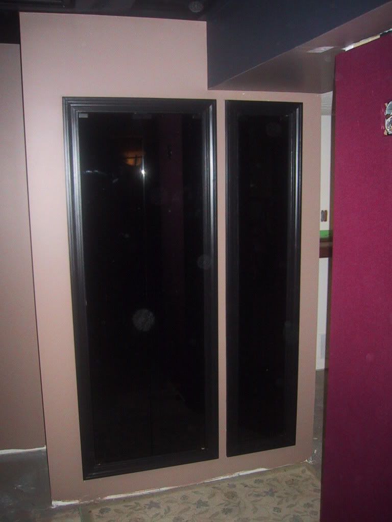

I hit it hard on Saturday - including the installation of my glass doors for the Eq. and media racks. Then rebuilt my sump pump pit with new plumbing and new primary and backup pumps.
For the final phase of my build: Whenever possible I will provide photo updates by showing the best before and after photos I can find, so here goes:
The Eq and media storage area , Before:
And After:
The glass is 1/4" tempered dark tint glass.

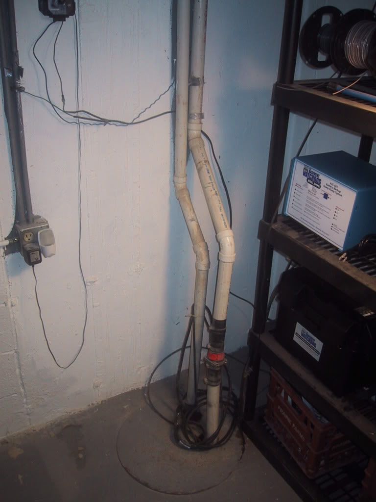

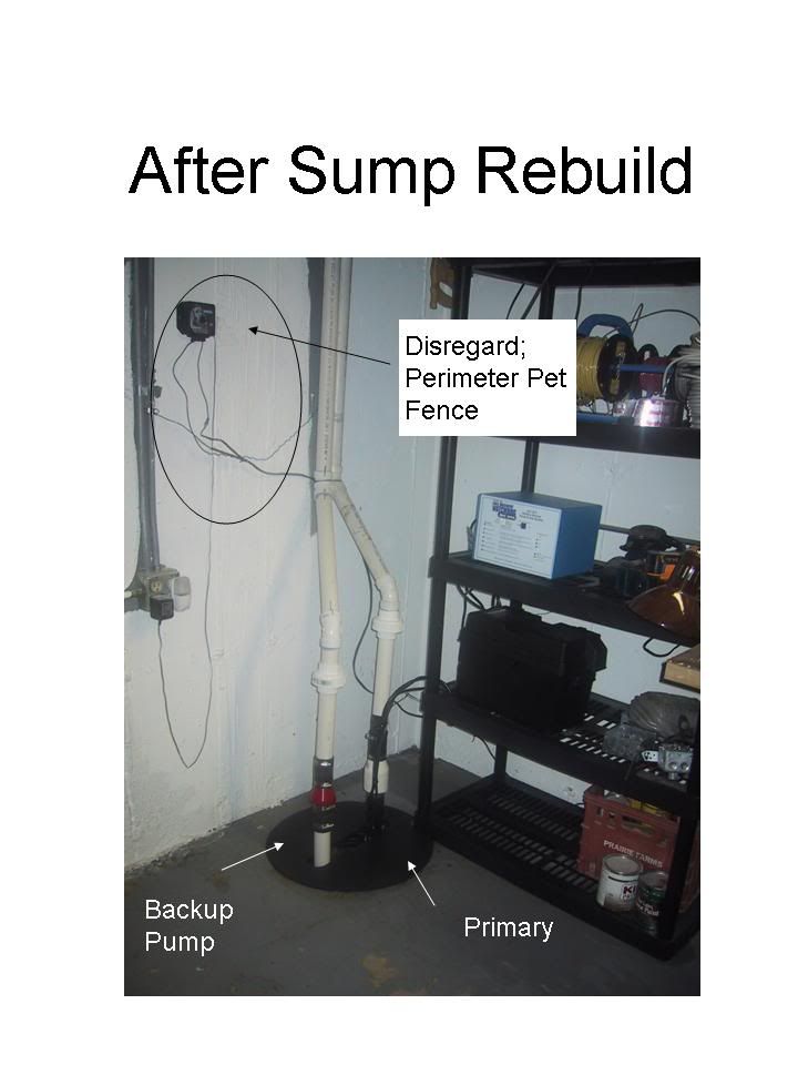

And the Sump Pit Before:
And After (Sorry about the Pet Fence note - this is simply the Emily Post version of etiquette training for canines)
Talk about a mess I inherited from the previous owner; I knew I had a non-working back up. What I didn't know was that there were 1.5 dead backup pumps in this pit. There were 3 pumps total in this hole, a second one backup with the float cut off - unbelievable shortcuts one finds!
Then on Sunday I had one of my F-Day guests drive me to the local Menards with a pickup for about $700.00 worth of paneling (wainscoting) and hopefully enough trim to finish the basement. Then cold ones, family, and the BBQ - A Good Day!!

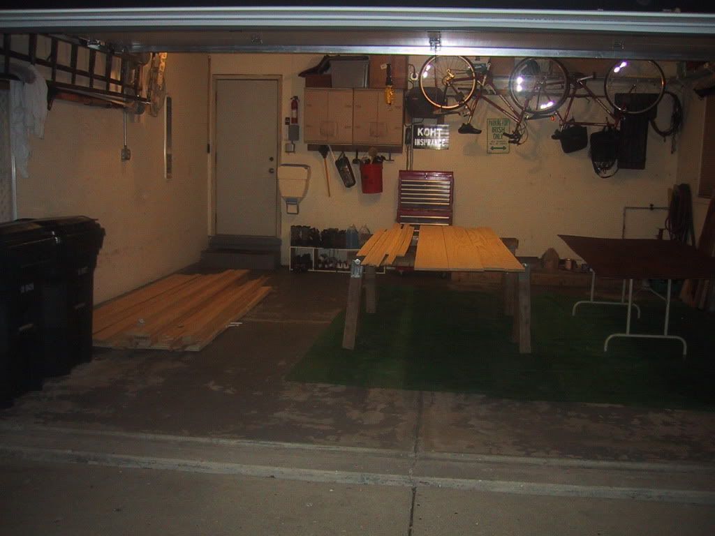

OK; these next photos are for Hanes and for those of us that are: OCD planners, procrastinators, or simply "trophy husbands" that take their time with their builds.
I believe in the East (VA), they might refer to these individuals as "Logan types", or people who participate in some unofficial contest titled "get loganed".
I would like to propose that it is time to add a Central States contest titled "Get Hanesed", or perhaps "Get wedgied". An appropriate logo might include a photo of a pile of lumber slowly waiting to get processed....
My own, next big (almost final) step will eventually include: preppping, routing, sanding, and staining the wainscoting materials and trim for my final push.
Therefore I might suggest the "Hanes Meter", it is important not too rush into these next steps. However; progress can eventually be measured by checking the height of the piles on the left and comparing to the height of the piles on the right:
And of course in some future month (to be determined) one might have actually end up with a pile of "finished" lumber on the right that is fully seasoned, of the appropriate color, and ready to be made into wainscoting and trim?
And Most Important - DO NOT RUSH THE SEASONING process - it is very important to take your time, and ask yourself the questions:
1) I could go to the basement or garage and work....?, OR
2) I could revisit my cold beverage and contemplate how best to proceed...?

Now that's what I'm talkin' about - proof of progress by wood pile picture status!! Perfect for us illiterate types to grasp!
I'm not sure the AVS world could handle a Midwestern version of being Loganed, but a "Hanes Meter"? Or Hanesometer perhaps? Hmmmm ....
You just might be onto something there, my friend. Do you reckon there would be huge royalties involved?! Maybe even a made for TV movie? Or should I keep my day job for a while longer, just to be safe?
Must run, but let's do lunch sometime!

You won't regret the purchase of the backup. Mine certainly helps me sleep easier at night as my drain tile is seemingly always active even during dry months. It is not cheap, but IMO it is well worth the money and piece of mind.

Thanks , I also have some fairly inexpensive "water leak detectors" that I will be installing. If they sense water they will sound an audible alarm and will dial a preselected emergency phone number ("Big" recomended the product, less than $100.00).

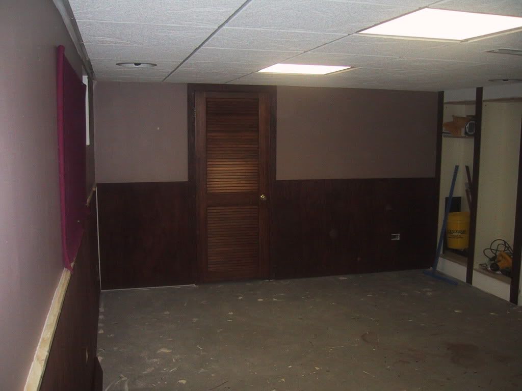

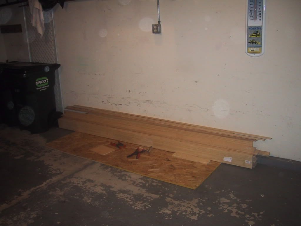

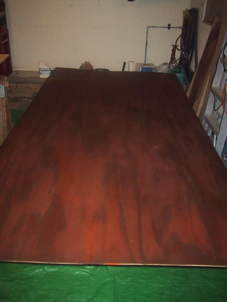

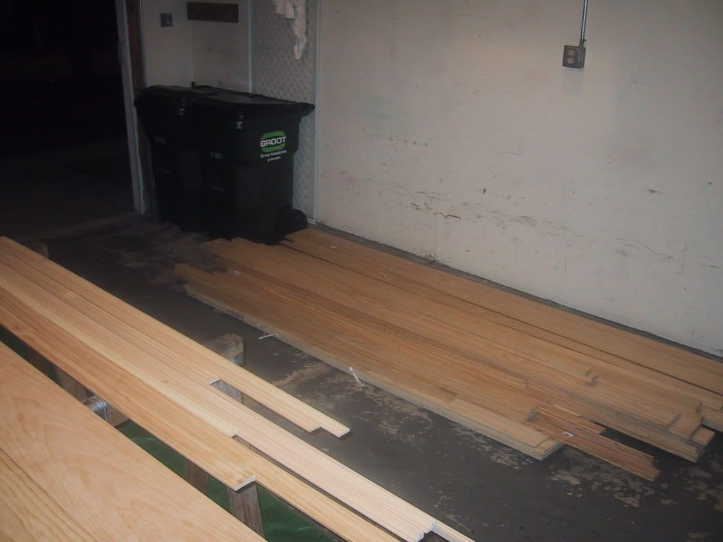

First - I really hate this "trudgery" called staining >> Good news I'm over 50% done with this task.
Check out the "Hanesometer" Wood pile proof Photos below.

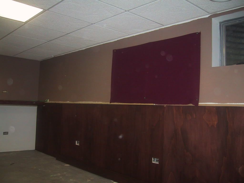

Hanesometer Before:
Hanesometer After (look close there really is a difference). What's left to be stained are the stiles and upper lower horizontal trim pieces for the wainscot wall - these need to have edges routed before they can be stained (also in this pile is about 180' of door casing for the rest of the basement).

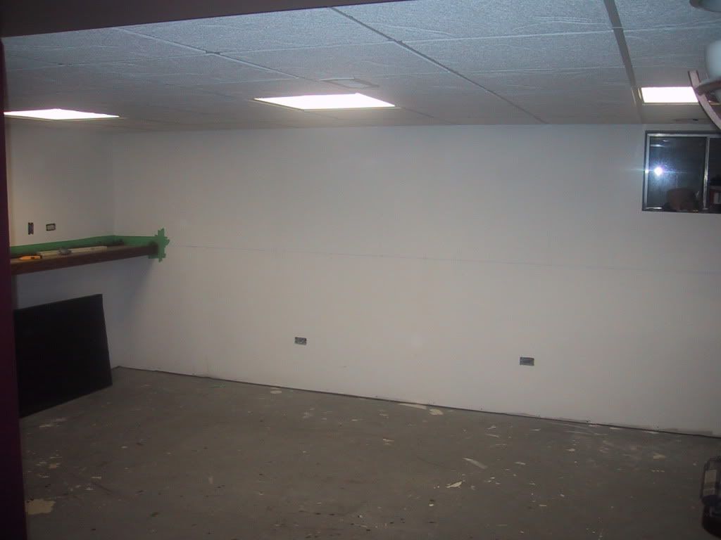

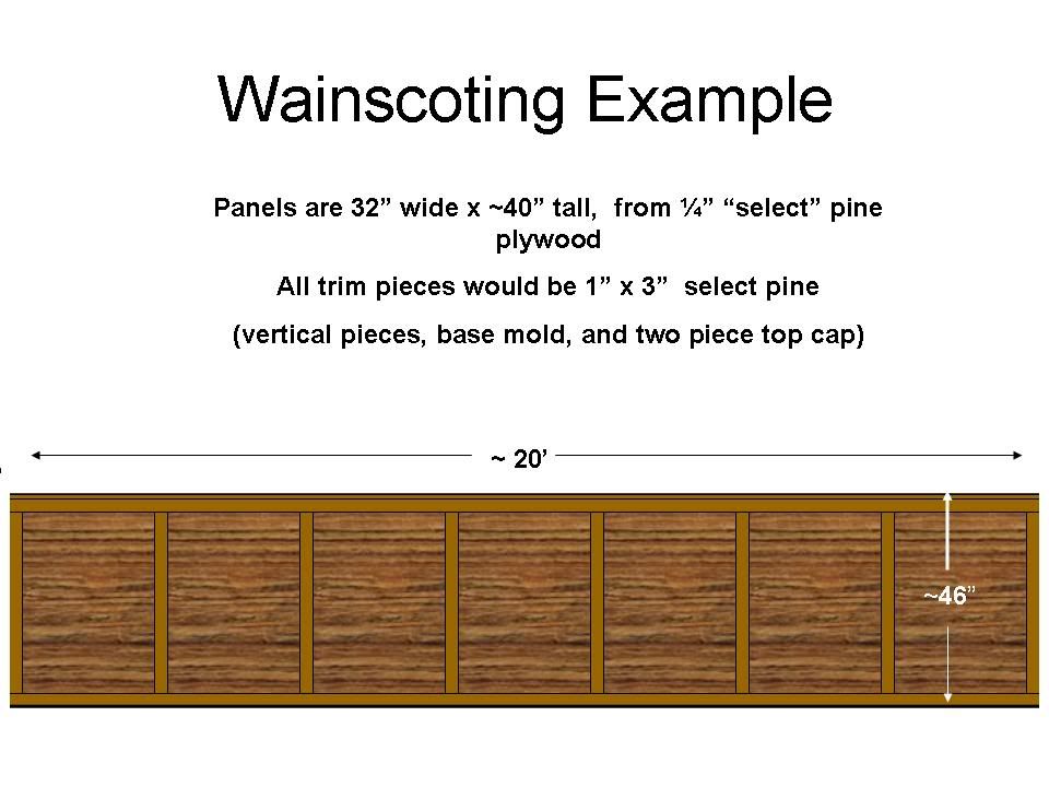

The Goal is to get the billiard room to look something like this. I have adjusted the height from 46" to 43.75", and the grain will be oriented vertically. Still not sure if I will run my vertical stiles on 48" centers or 24" centers?

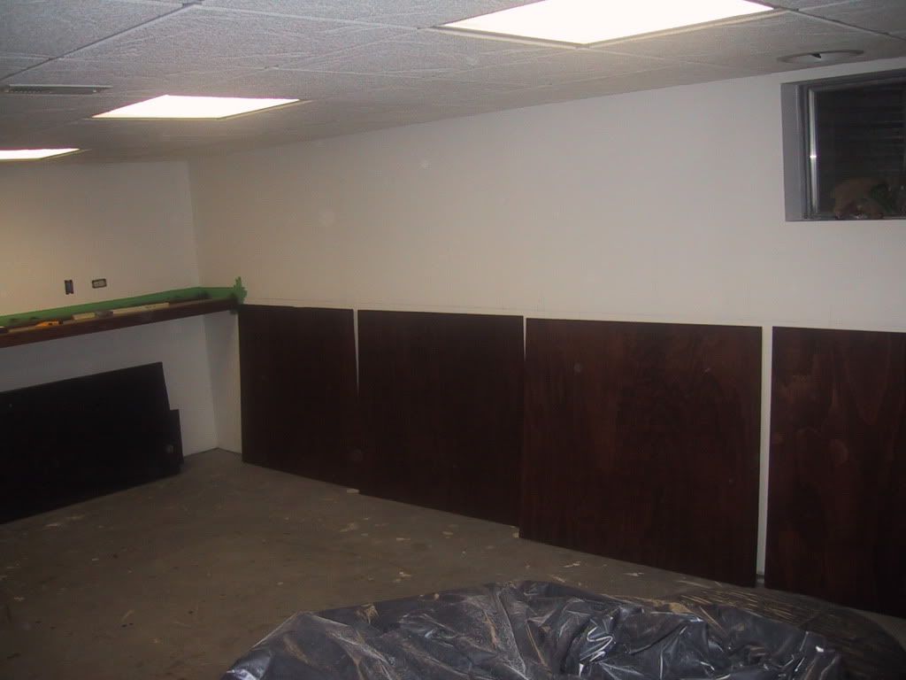

The next two photos are the NW wall;

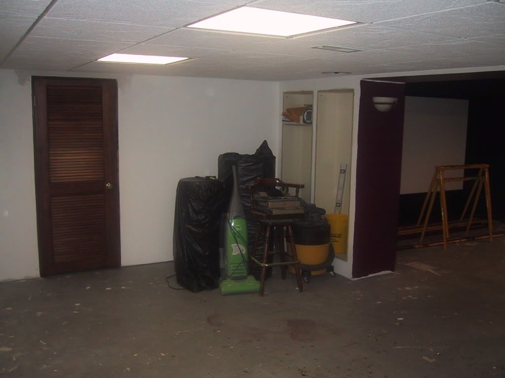

Ready to hang plywood:
And a teaser - The true stained color of the wood did not photograph well, the stain is mahogony and it gives a nice slightly red hue to the pine plywood
The 1/2 wall treatment will be on 3 walls; the long wall shown, the area under the drink ledge, and the opposite end (bookcase and entry to my crawl space). The next photos are the common "wall" separating the HT from the Billiards room. For this "wall" I will go floor to ceiling with the stained plywood.

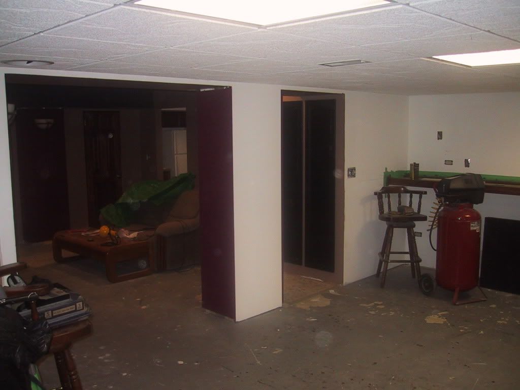

The SE corner (you can see the screen wall in the background)
The SW corner (you can see the EQ rack in the background):
Plan for the Holiday weekend, besides celebrating and BBQing; is to get all of the plywood up and then begin the edge treatment (routing) of the stiles, and horizontal top/bottom trim pieces, then more staining - did I mention I hate staining...?

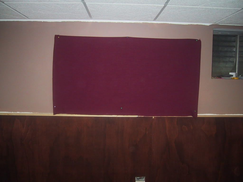

So I have managed to get most of the wainscot paneling up on the lower half of my walls.
Disregard the horizontal furring strip in these photos (temporary for locating the upper edge of the wainscot trim). The first photo is the west end of the long wall looking toward the drink ledge. Still need to "panel" under the drink ledge.
This is the East end towards the crawl space entry. Still need to finish the trim surrounding the built-in bookcases
Now the question:
For the purpose of deciding the upper wall treatment; I painted the upper half of the walls, and I also hung a sample of my Burgundy GOM. I had always planned on painting the upper portion of these walls. At least that was my plan until i discovered I had over 30' of leftover Burgundy GM from my HT treatments !!
I have enough GOM, and 1" Linacoustic to cover the long (20') wall pictured above (but not enough for the short end walls - they will be painted as shown).
So my question: Should I leave this long wall painted or go ahead and give it the Burgundy GOM treatment?
If I go with the GOM it will be done primarily for decorating and aesthetic purposes.
If I go this route; I will fir it out and will use the Linacoustic. Not so much for acoustics but because I have some leftover, and who knows even though it will start at 42" above the floor it might still be of some minor acoustic benefit.
Cuzed2
CuznEddy Cinema
cuzed2 is offline
post #299 of 1672 Old 07-10-2009, 05:55 AM
cane.mba's Avatar
Location: North Atlanta area
Posts: 561
Hey Cuz what kind of floor are you putting into this room? Carpet, Tile, Wood? The reason I ask is that with a hard floor the sound from playing pool will be pretty loud. So even though it's only 1/2 the wall the GOM may help cut down on some of that. DISCLAIMER** I do not claim to have a clue when it comes to sound ** There are many people here that are awesome with sound.
However, even without the possible noise reduction I think it looks good.
so +1 for the GOM

post #300 of 1672 Old 07-10-2009, 08:32 AM - Thread Starter
cuzed2's Avatar
Location: Chicago Area
Posts: 4,937
Mentioned: 19 Post(s)
Quoted: 200 Post(s)
Liked: 256
Mike,
Good point about the pool-table noises! Didn't think about that one.
I will be carpeting the billiard room with the same carpet that will be in the adjoining HT room.
Only one thing is holding me up on the GOM:
The billiard room has flourescent lights, and the HT room has incandescent can lights.
With all lights on in both rooms the GOM appears to be two different colors:
Almost a Cranberry (desirable color) in the HT room (under incandescents)
And a drab Burgundy in the Billiard room.....?
Cuzed2
