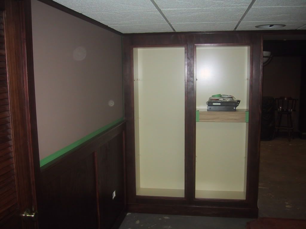

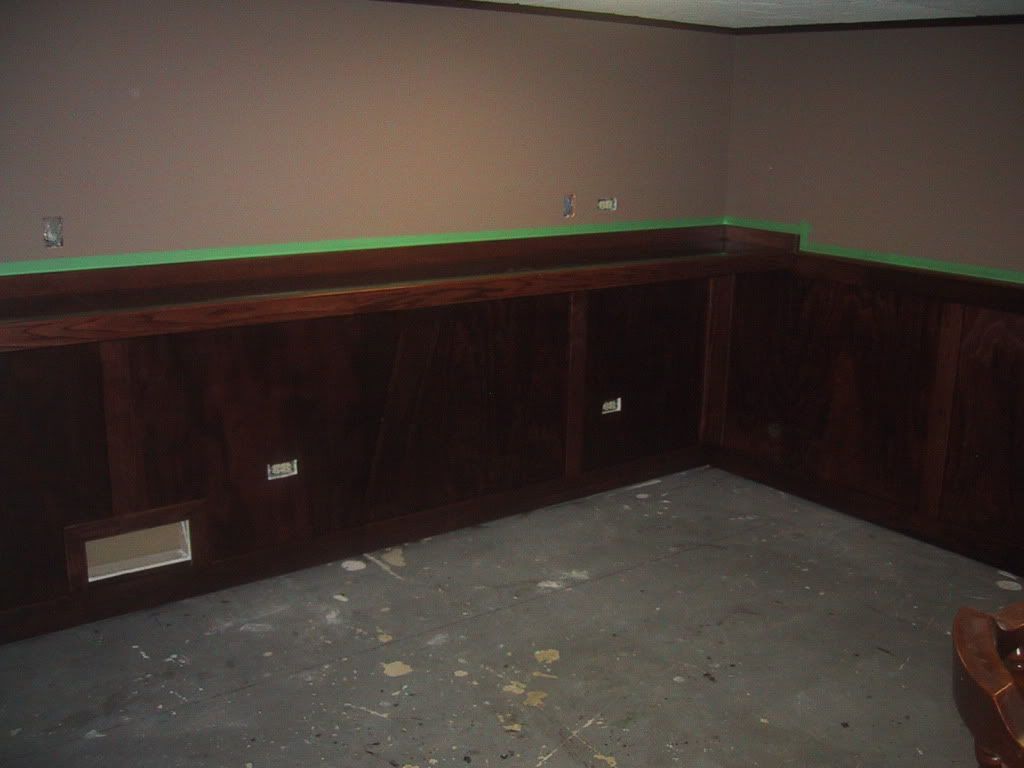

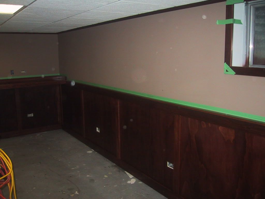

So; this week was small stuff, not much worth photographing:
Stained some misc trim odds/ends.
For the Wet Bar room:
Stripped, sanded and re-stained my in-wall dart board case, to better match my trim. Also; prepped this room so that I can finish painting (the Spanish Tile color will stay - for now).
For this weekend, I hope to:
Finish sealing (wipe-on poly) the dart cabinet and misc items
Paint the Wet bar room (and stairwell?)
Install the 1x10 stained trim on both sides of the stairs.
And if I'm really productive
Final painting of the bathroom
and begin poly top coating the wainscoting in the Billiard room
We'll see.......at least I can dream - goals are good -right?

**And the result, what I actually got done
Finish sealing (wipe-on poly) the dart cabinet and misc items ** Done
Paint the Wet bar room (and stairwell?) ** Wet bar room is done (stairwell is not)
Install the 1x10 stained trim on both sides of the stairs ** Done, also cut some
additional 1 x10 trim for the other stairwell areas, and base mold for the landing
Cuzed2

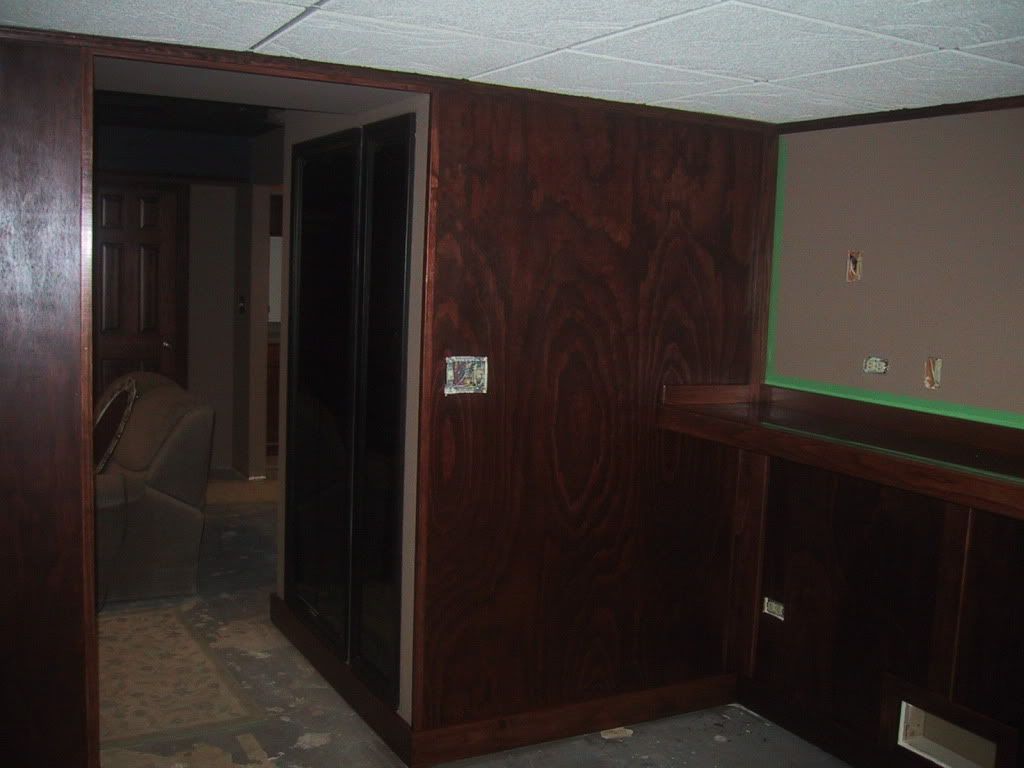

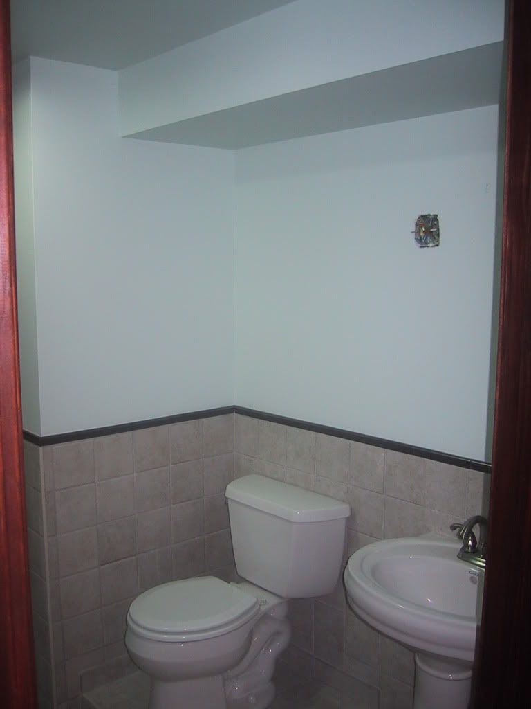

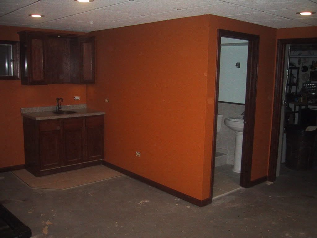

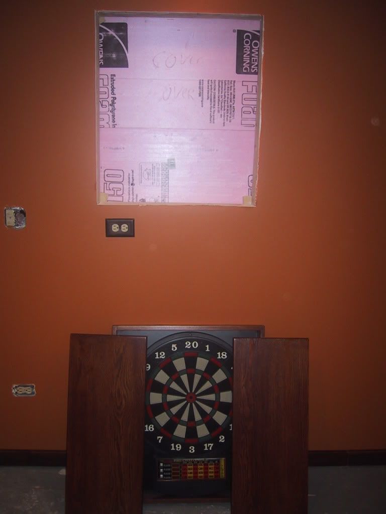

OK - hope this update finds everyone had a great Labor Day weekend..?
I actually got about another 20 hours working down in the "hole" (as my wife calls it). This time I took photos, I know way overdue...
Started the weekend by getting the 2nd coat of Spanish Tile painted in the pub room. Started to paint the entire stairwell this color, but changed my mind as it would have been too dark. Therefore only one wall of the stair well will be this color. This color is still growing on me, but have decided to keep it (for now). Also got the first coat of paint in the bathroom - just visible to the right in the photo below.
The next photo is for Hanes:
Check out the display in this photo - how's that for cutting edge AV Nirvania?
The treadmill will vacate this space and will move to our recently vacated 4th bedroom (now that my 24 year old has moved out). So this room will become a pub room.

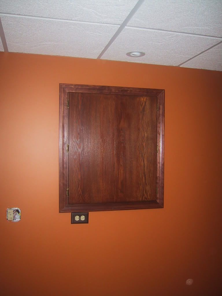

Every pub needs a dart board. First I had to refinish my old dart cabinet as it was originally finished in a Golden Oak. I did manage to get it installed and trimmed out.
Next Post will show the time consuming trim (and paint) project for the stairwell - stay tuned

Why does that outlet make me so nervous? ZAAAAP Bulls eye!

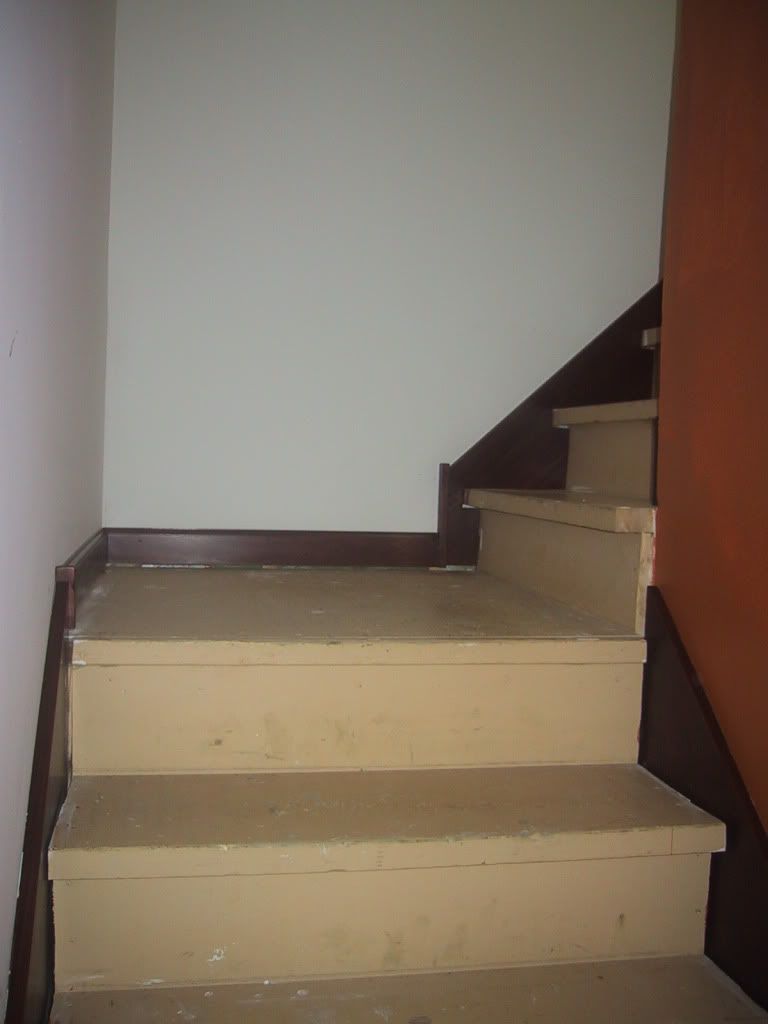

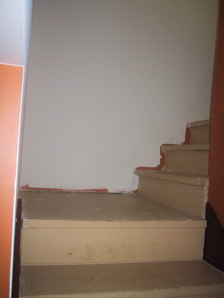

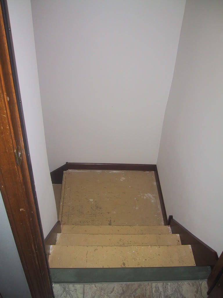

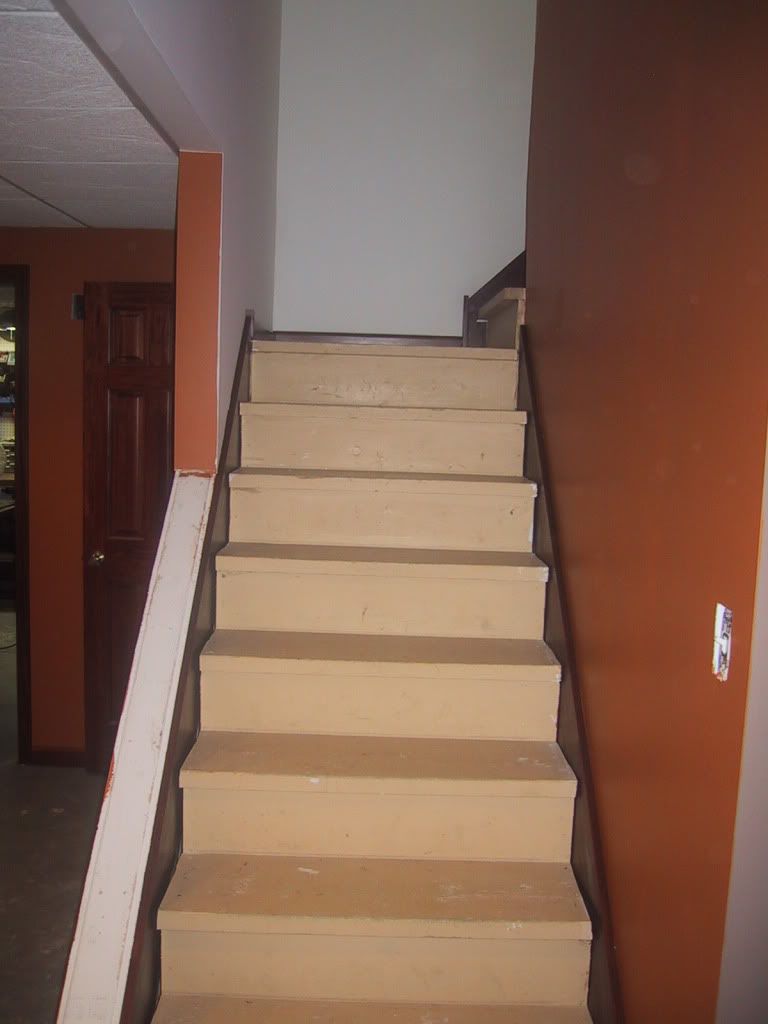

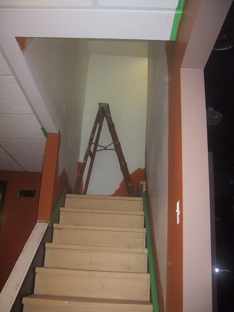

Some of the before photos were taken when we thought the entire stairwell would be painted Spanish Tile - Way too dark, only the large wall will be painted this color, the rest of the stairwell will be a much lighter color - white for now. NOTE: So far only one coat of paint, final coat and the railing will happen after the carpet is in, and the furniture & pool table have been moved downstairs.

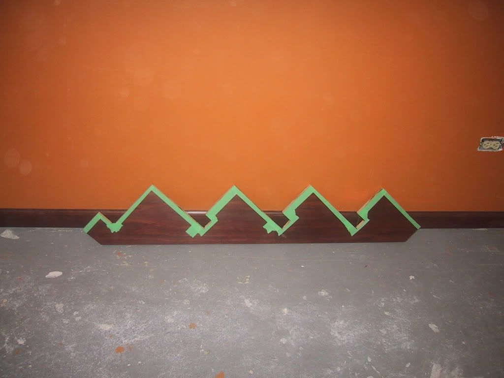

I needed to get the "rails" on the sides of the stair treads installed, the lower run was easy as their was a ~1.25" gap on each side. After some cautious angle cuts on both ends I dropped in some ~9 ' lengths of 1"x10"s on each side. The run on the right side has been taped in preparation for painting that wall to match the pub room
Next up was to fabricate "rails" to fit the treads above the landing. This was necessary because the treads extended to the drywall on each side
Spent several hours making a pattern, and then likely broke all available table saw safety guidelines, (and a jigsaw). Made two of these:
And the result, from below:
And above:

Good Point! Actually this will be converted to a single outlet, and will be occupied by the Dart board PS when the board is in use

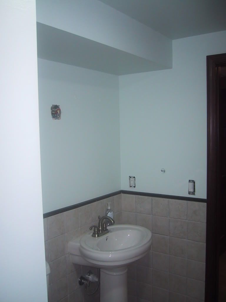

No work last night, although I did go down to check the bathroom paint job:
Looks like I need to 2nd coat the bathroom walls
My son vacuumed down all the trim and wainscoting :-) At least now it will be easier fpr me to start the poly finish coats!

Despite losing Saturday to a wedding, and 1/2 day Sunday (was overserved)
I did getthe following accomplished: spent Friday night getting my first coat of poly on the wainscoting in the Billiard room, Sunday: a second coat of poly, final coat of paint in the bathroom, and Eq closet prepped for painting.
The Billiard room photos:
The dark photos make it a bit hard to see, but the first 2 coats of poly are really bringing out the depth and grain in the wood. I'm very happy with how that is going
I am using a satin level of sheen - I wouldn't want it any glossier (although the flash in the photo below is a worst case)
A question for the photo below, Should I paint the interior of this book case a darker color, or leave it as is?
And the "almost finished" bathroom photos, need to give the tile a deep cleaning, and remount the mirror and accessories

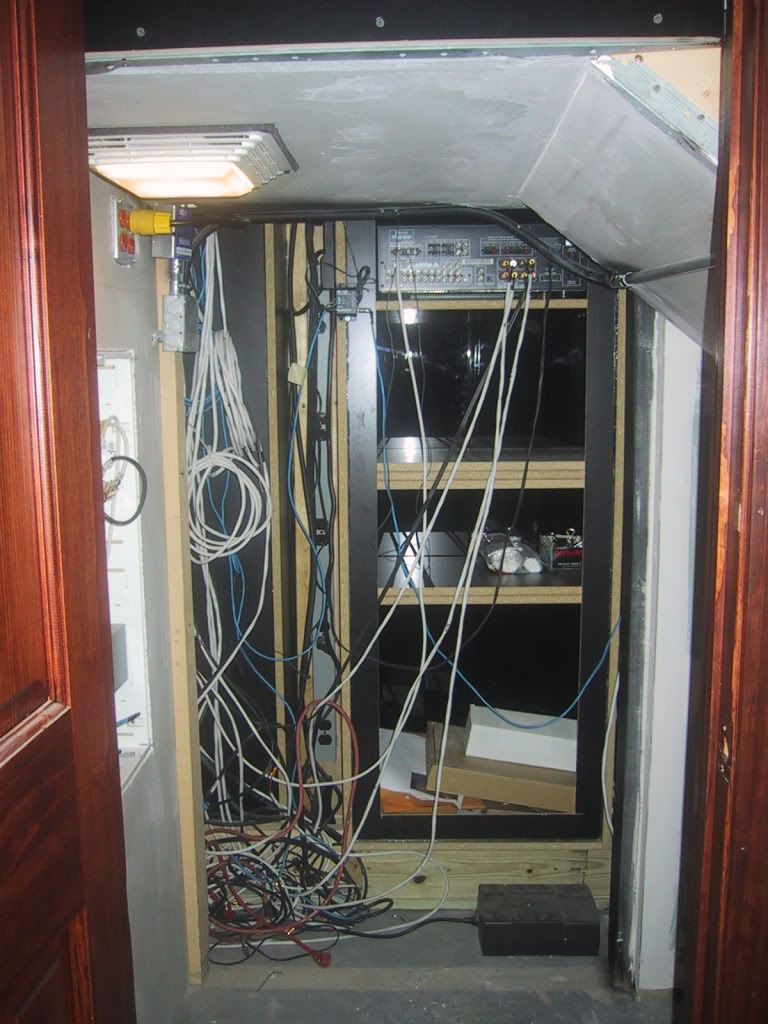

Eq closet ready for paint, followed by equipment and dressing out the wiring
