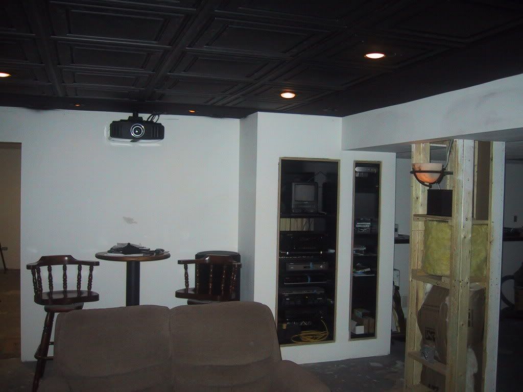

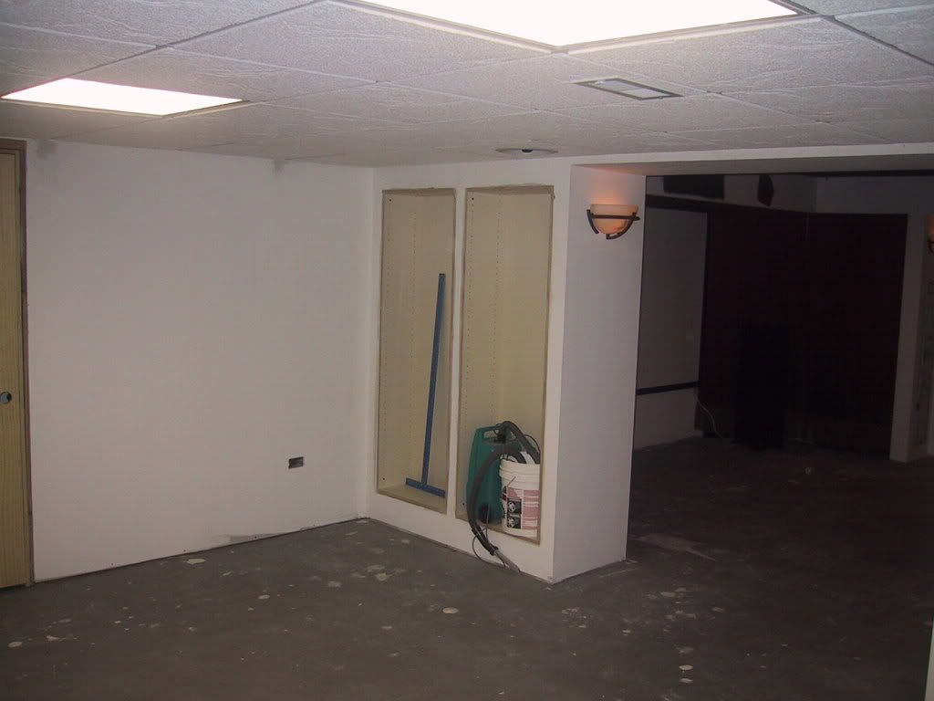

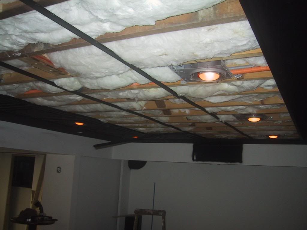

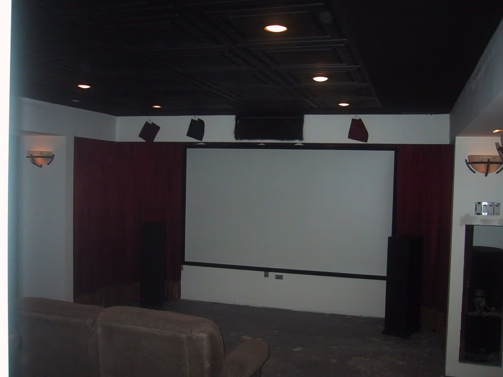

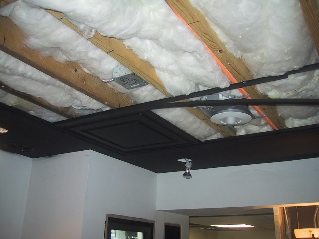

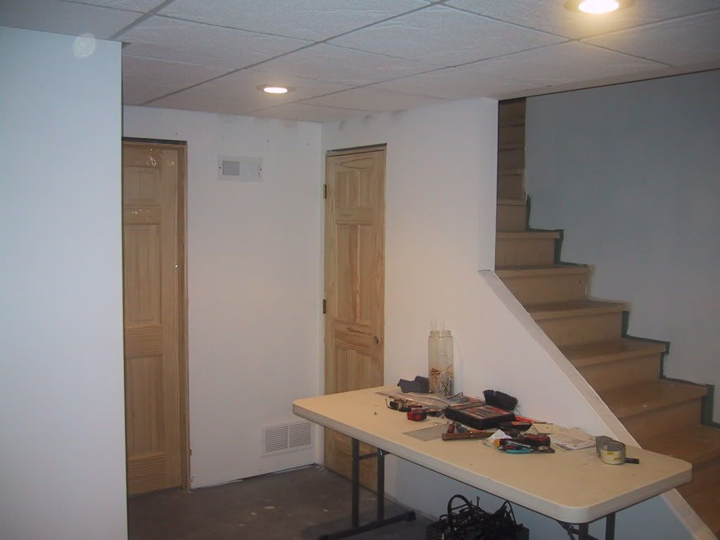

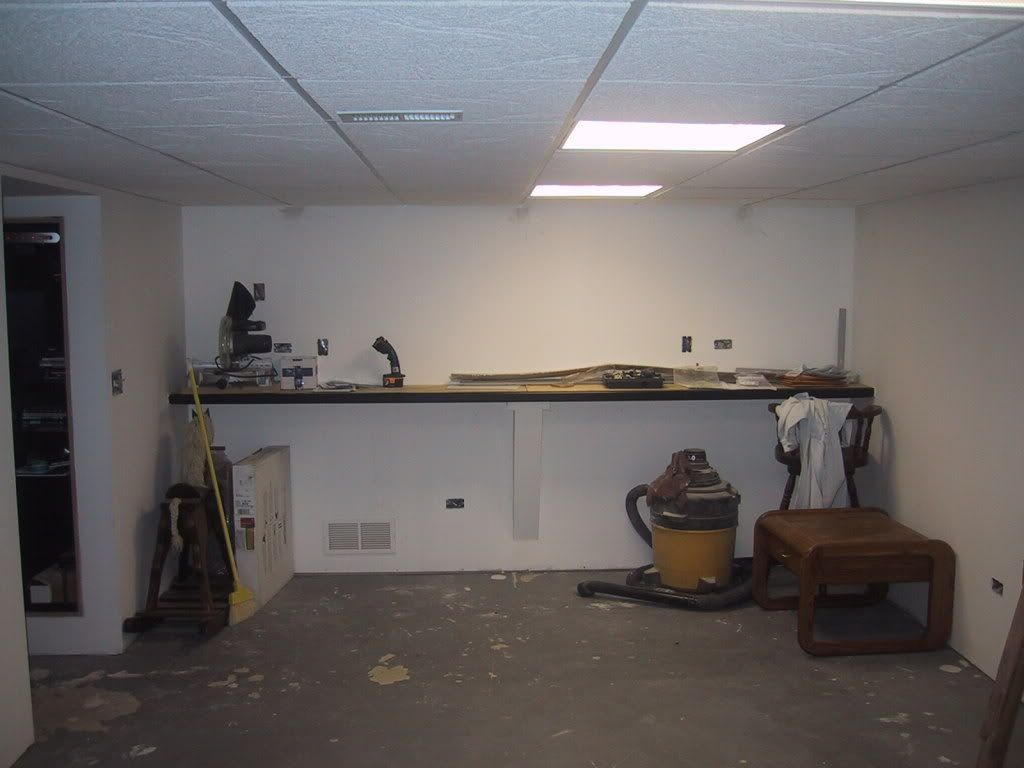

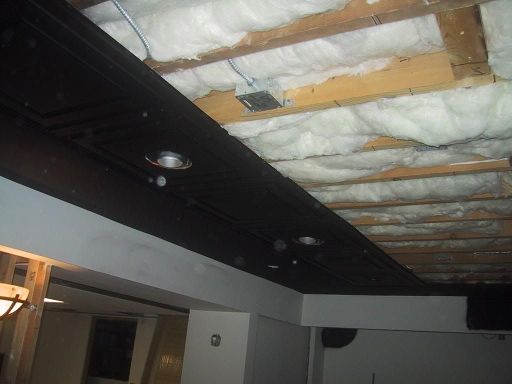

So for the last few weeks - the work has been steady, albeit NOT at breakneck speeds. First up was to finish the 2' drywall ceiling border in flat black (one coat primer, and 2 topcoats).
After temporarily mounting my RS-1 and testing screen size and placement > I decided to locate the PJ closer to the rear wall (from 11' back to about 16.5' back). Very thankful that I anticipated this possibiity and had a raceway and some reinforced bracing already in place behind the ceiling drywall.

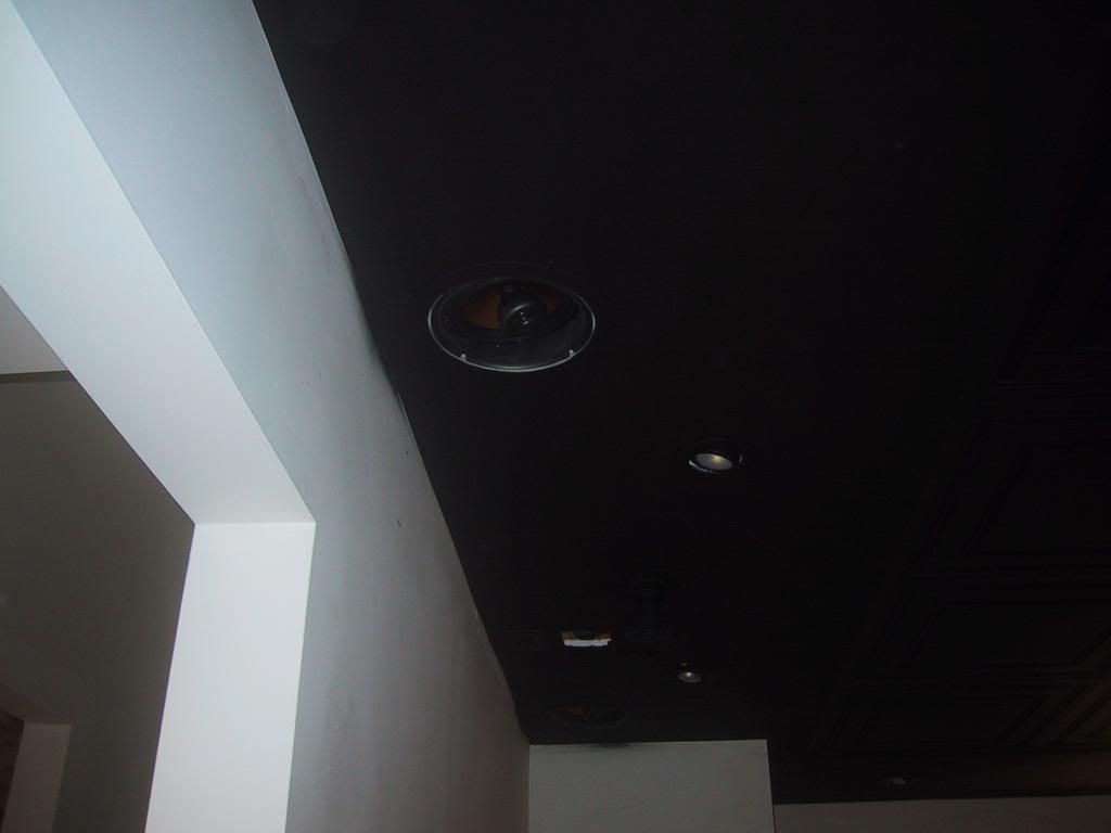

This was also a good time to install my 7.1 rear seakers (Klipsch 6/5" in-ceiling style). So much for photographong a black ceiling - believe it or not there are 2 speakers, a chief ceiling mount, and a PJ power recepatacle hiding in this photo:
Next a side note; the Ceilume company (Empire West) was very responsive - they air shipped replacement tiles to me. The initial shipment was damaged by UPS - great service from Ceilume!
Below is the ceiling-link grid system (from Kensa -another great product), installed and ready for tiles:
First tile installed above EQ rack:
3 hours later and almost done (the most time-consumng part was "fine-tuning" the postion of the can lights)
And lastly the finished product - despite the dust and my poor photo lighting.
Two out of 3 celings are now finished, this week will be a tossup between:
1) setting up and checking out my new-used marantz 7002,
2) or finshing the celing in the adjoining room, or...maybe both....
Thanks for looking!

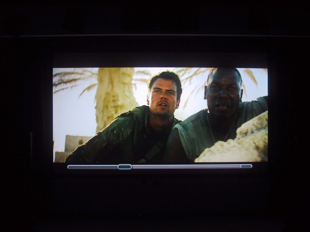

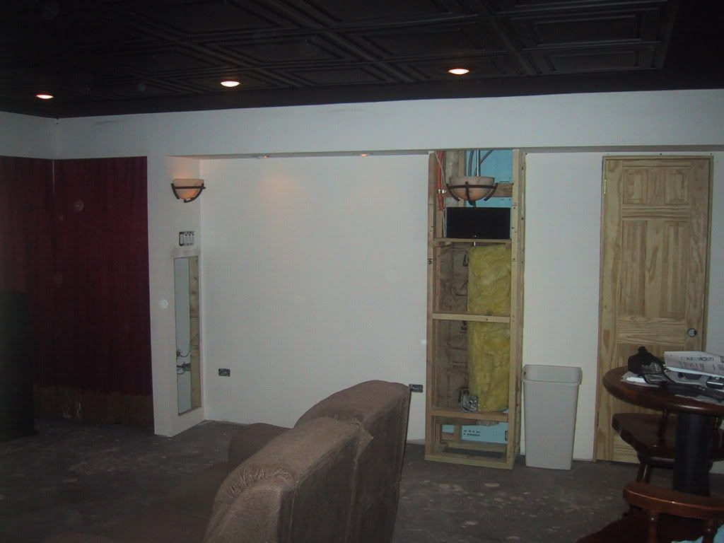

Got my ceilings finished, doors cut & installed (more construction photos later).
Decided it was time to appreciate the recent round of efforts by taking a viewing break!
Finished my homemade screen over the weekend; DW on an Aluminum "80/20" frame.
A big thanks to "20fan":
He has a nice thread going over on the DIY screen forum for this slick aluminum frame idea. Got the screen wall mounted just in time to see GB stomp the Bears
My screen dimensions areas follows:
-Viewable area 57" x 101.5"
-Overall size is 61" (delivered width of the DW) x 105.5".
- 2" border
For cutting the DW; a few tips that resulted in a very clean edge:
Bought a new plywood blade for my skill saw, taped the "cut line" on both sides, and cut from the unfinished side (finished side down).
I used contact cement to attach a 2" border. Here are the supplies.
I meant to take a photo showing how I masked off the inner edge of the border with painters tape. This kept the contact cement off the viewable area and made it much easier to get a nice straight edge with the border.
The finished result:

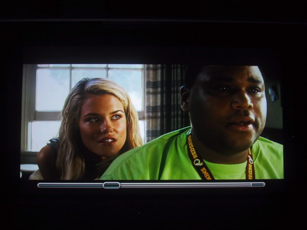

And Temporarily Mounted (screen will be coming down so that I can install linacoustic, GOM, trim work, and finish the drapery valance on top):

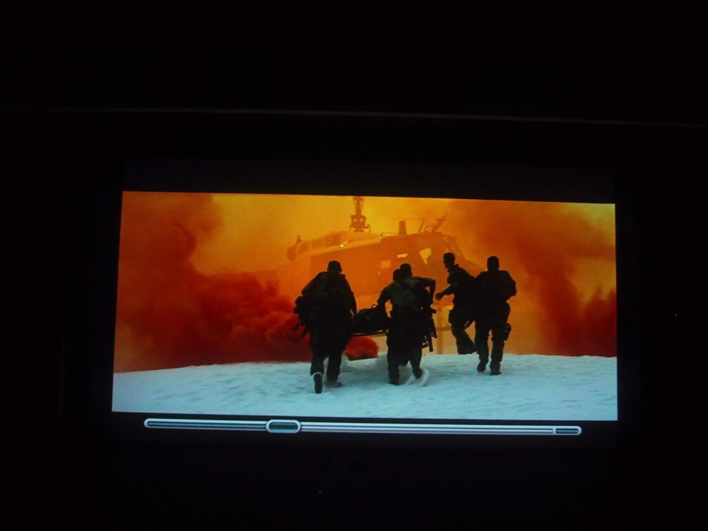

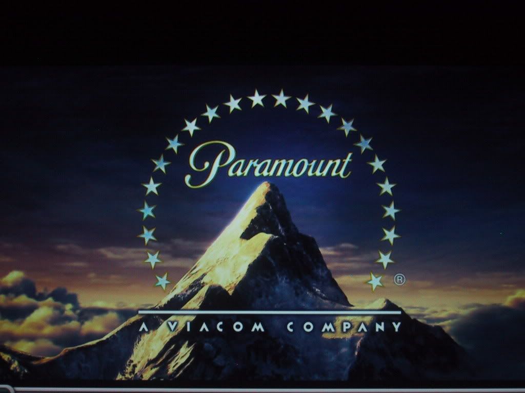

The following are HD-Ota shots from a JVC RS-1. Sorry did not have time to put up any 1080p blu-ray material. (will also make my excuses in advance; did not use a tripod, my first attempts at screen shots, and have not yet tweaked the PJ with Video Essentials Essentials disc).
First up - 1080i from Fox sports:
Remainder are 720p from PBS:
Cuzed2

Finally - got my Blu-Ray player (slightly used Samsung 1400) up and running with the DIY screen. I thought the Video would be the biggest Wow factor > the new Audio formats might be the bigger story.
Following are from Transformers/Blu-ray via JVC RS1 (note; the pixelation you might see below is most likely from my old 2Mb Elph camera.) In real time I have to get to about 4' from the screen to see pixels.
Cuzed2

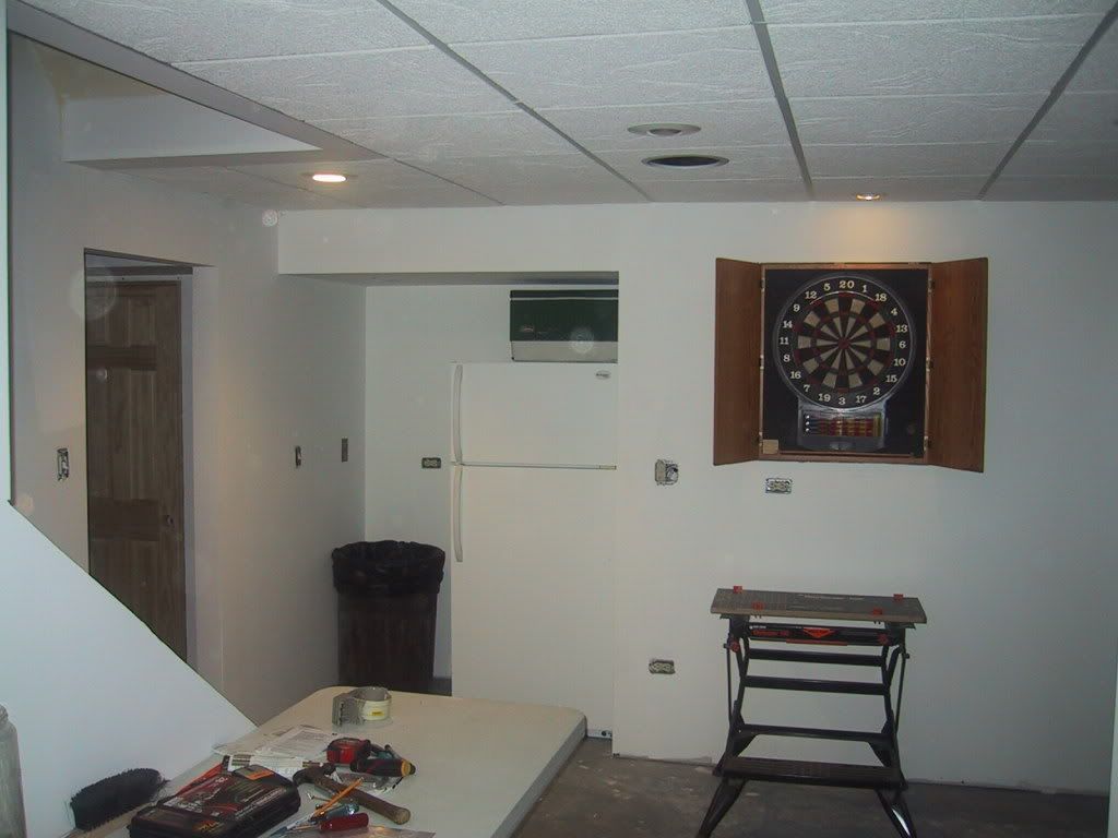

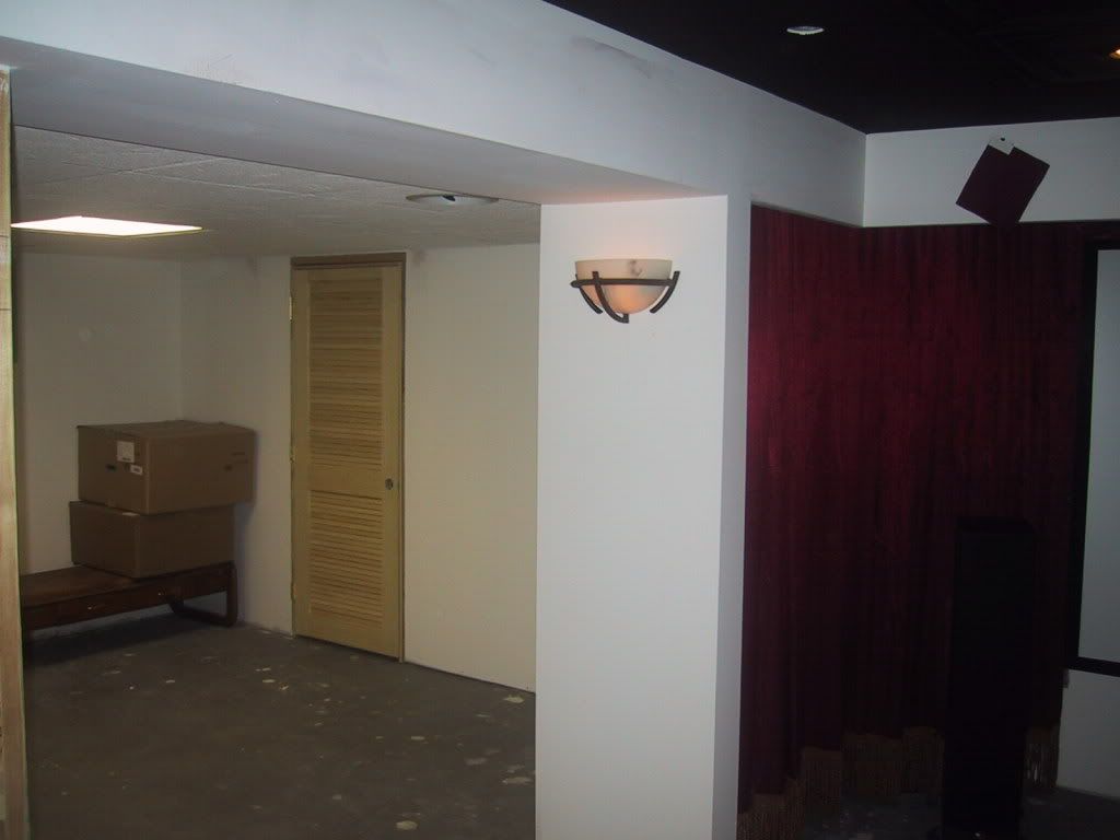

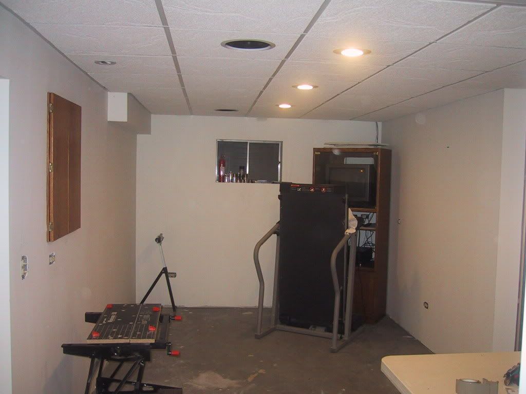

Here's the Latest. Items left to be done:
Trim
liacoustic and GOM on screen wall
Surround speaker columns
Paint, Carpet, Stair Railing
(possibly tile work and wet bar**?)
First photos are taken at the bottom of the stair landing. **Still haven't decided if this room will be an exersize room, or will become a pub room with some form of wet bar (behind the running machine and cabinet I have plumbing stubbed in).
Opinions Anyone?
Eq. closet - wiring needs to be dressed:
Next Up are from the Theater Room:
Final photos are the from the adjacent open area game room
and the future drink-ledge at the end of the game room
Cuzed2
CuznEddy Cinema
