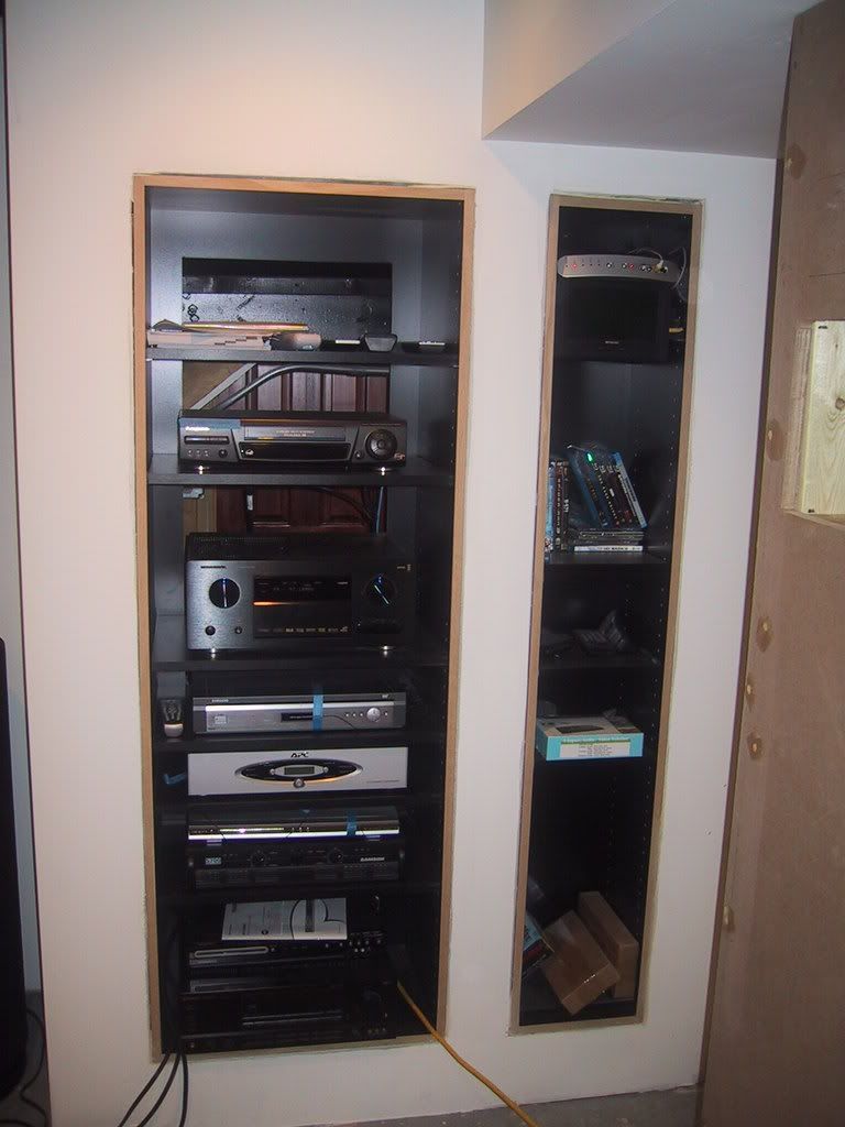

Iusteve,

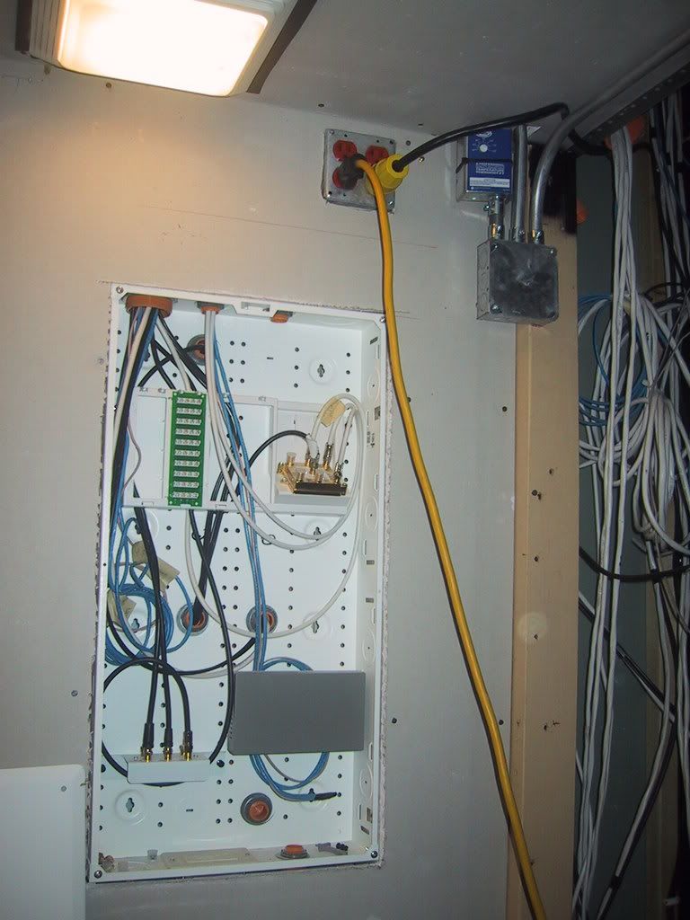

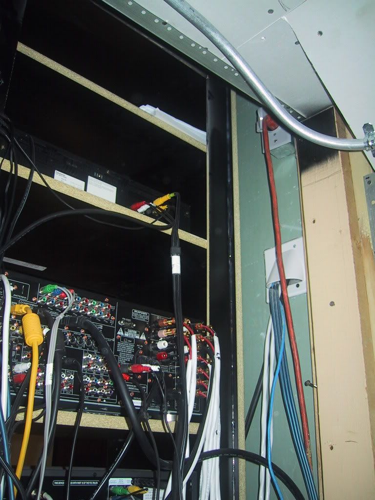

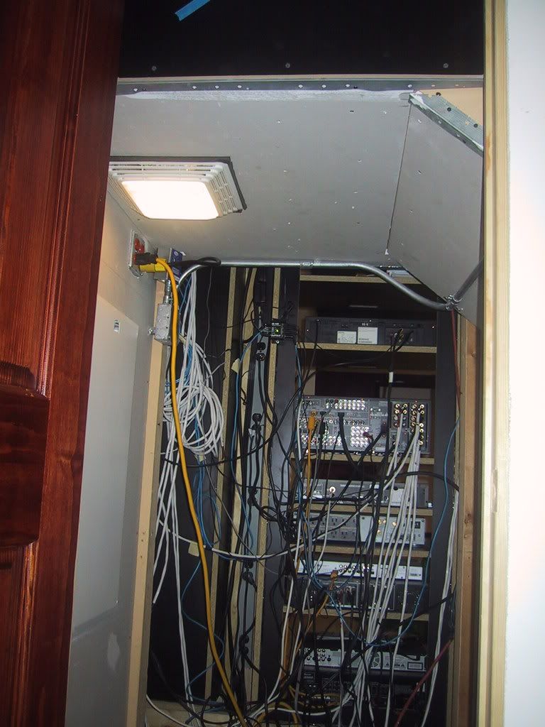

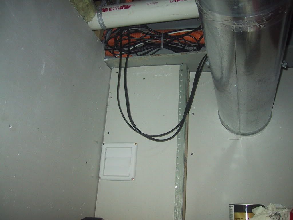

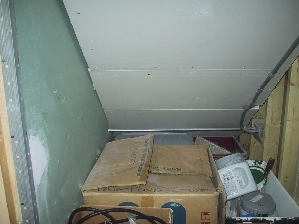

I believe you were looking for some additional photos. Feel free to ask away;
With a gear "test-fit" > OK I have been cheating and watching a few movies
So much for neat wiring - this will get reworked (someday)
Upper right hand corner - these are the "thru-wall' feeds to the PJ.
The structured wiring box, and the AC power feeds. The orange outlets are 2-20amp dedicated (and isolated ground) recepatcles.
Below this temporary rat's nest is; the exhaust fan outlet venting into my shop area.
Yes there is still storage under the steps. I need to finish adding 5/8" drywall, mud/tape, and "fireproofing". Be sure to check your local codes - mine require that finished spaces under stairs be finished with 5/8 fire rated drywall.

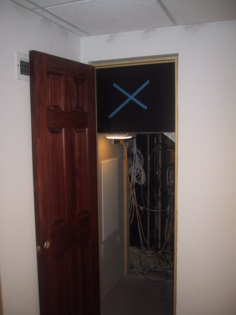

Update:
In addition to staining and finishing 6 doors; I decided to use this long P-Day weekend to finish some tiling. The first area is the bottom of my stairs (a fridg/pantry area).
If you turn right at the bottom of the stairs (turning left leads to HT), takes you to an adjoining "flexible use" room; about 9' x 16'. In the far corner by the window I tiled the floor for a walkup wet bar. I will install 45" of base cabinets, wall cabinets, and a sink. This area could become a full bar if I ever decide to add a bar in front of the tiled area. In this photo the grout is still wet, fortunately it is getting lighter as it dries.

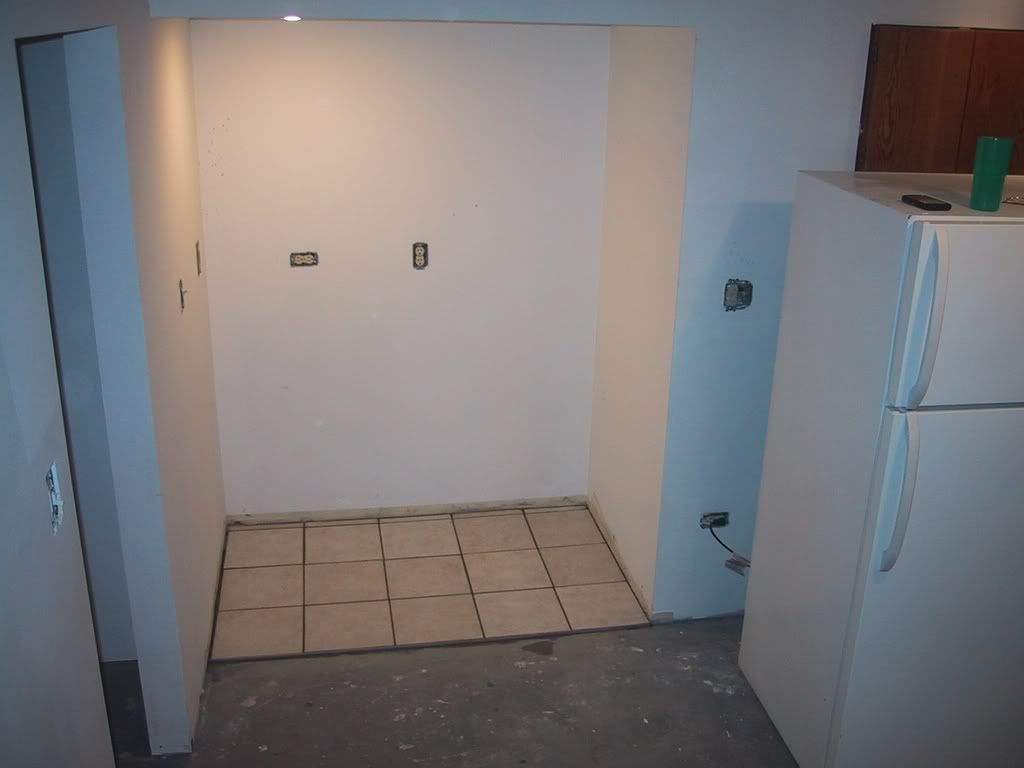

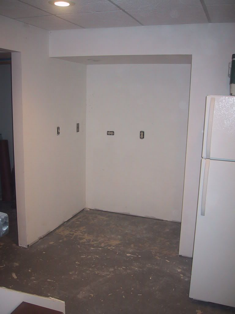

After attending an excellent HT meet in Chicago on Saturday (Big Thanks to Mr and Mrs. Zamboniman !!) >> I was inspired to visit Lowe's and buy some cabinetry for my basement & adjoining HT areas
First Photo is the bottom of the stairwell. Well have wall cabinets across the top.
Next Up is the bar area, a walk-up/wet-bar for now. Who knows this could serve as the back bar if I wanted to build out into a full sit down bar later
Next photo shows the fruits of my door labor (I hate staining, but have to admit I kind of like the distressed-6 panel Pine result, actually lighter in person). Door to the left goes to the bathroom, center door to my shop, and the open door to the right is the EQ closet under the stairs
Next two are from the HT room:
First one is the RR surround column, small coat closet, and the entry to the HT. Still trying to decide weather to cover the columns from top-bottom in burgundy GOM, or add a chair rail and do the bottom 1/2 in matching stained wood, opinions anyone?
Last photo is looking across the HT room and shows the Left rear surround column, and a view into the adjoining pool table room. That door goes to my crawl space.

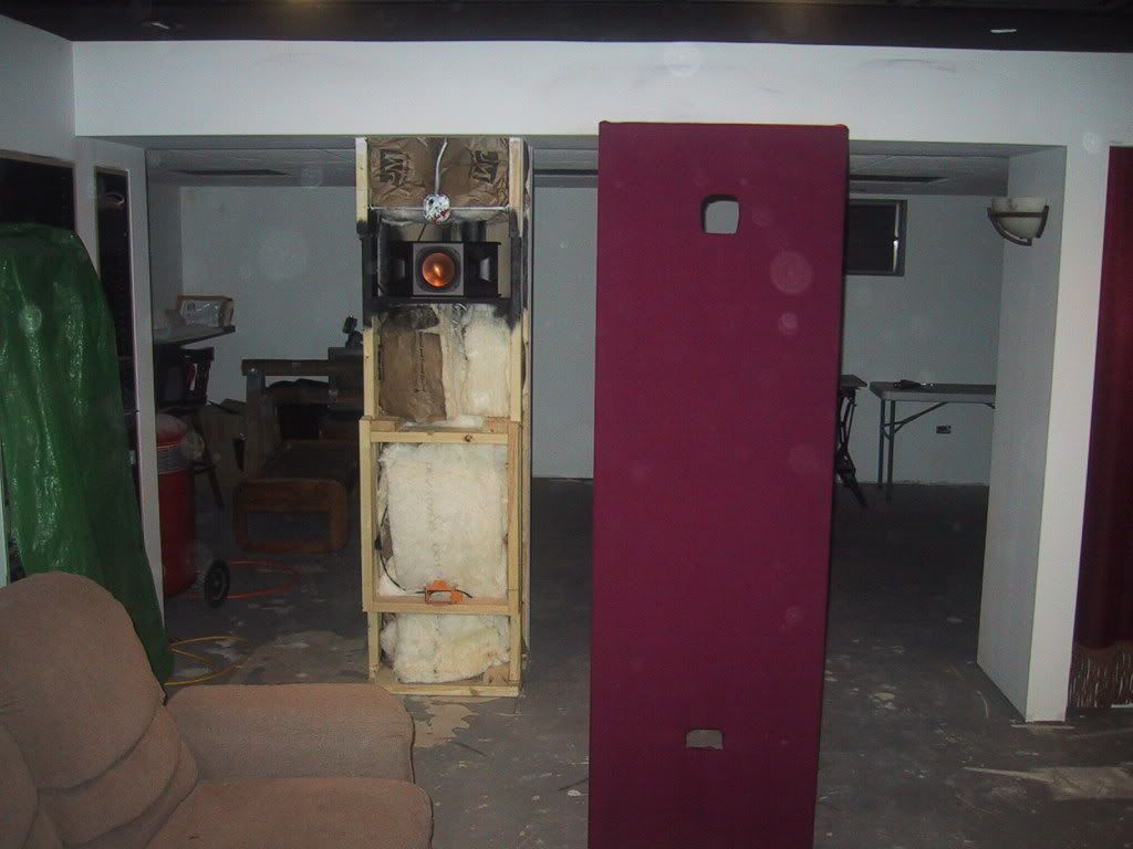

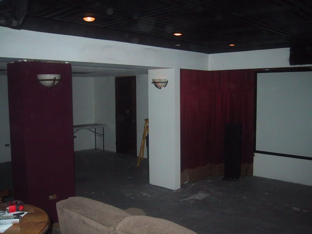

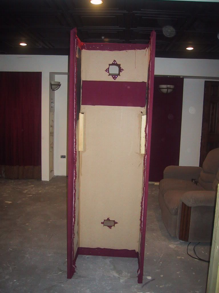

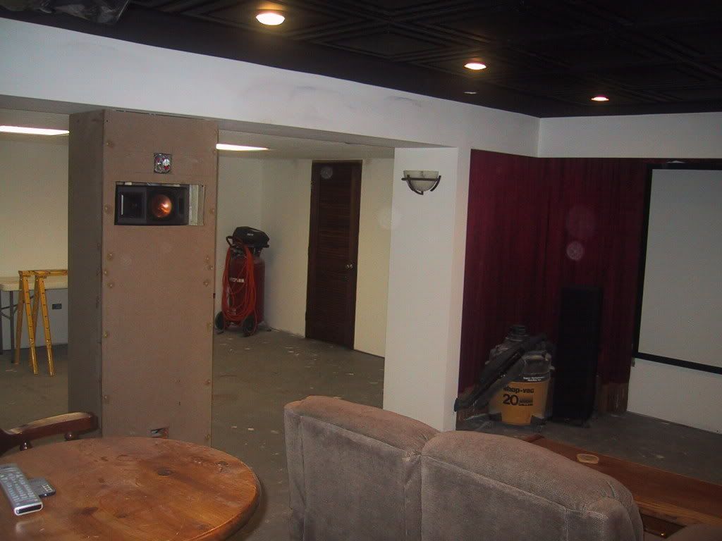

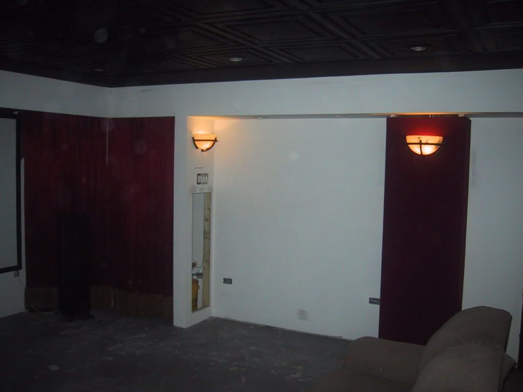

As you can see below I have the majority of my column labors finished.
First 4 photos are the LH column.
Before:
And underway:
Left Side Result:
RH Column:
And Now Questions (and comments) relating to my "markups":
"A"
Plan to cover this "end-cap" in matching Burgundy GOM, What do you think?
"B"
I am planning to paint extend the ceiling flat black to the vertical soffit surfaces?
"C"
I will add a stained pine moulding to this vertical wall edge to separate the end cap from the curtain area? I am thinking of using decorative fluted piece, and will cap the top edge where it meets the soffit with matching stained crown mould?
"D"

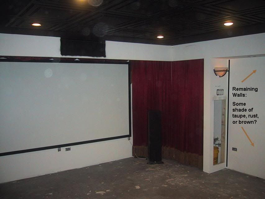

Area under the screen will receive linacoustic covered with Burgundy GOM, or with Black fabric. Your opinions Burgundy or Black GOM...?
"E"
The last photo is a question of color for the surrounding side and rear walls ...?

A: My fear is it becoming too burgundy with the velvet curtains but burgundy would certainly keep it consistent with your other columns. I'm confused though, why is there a cut-out in the right column. It doesn't appear that you are putting your fronts in them.
B: Agree.
C: I'm a sucker for fluted trim and crown. But I'm not sure how it would look with your drop ceiling?
D: Definitely black GOM for under the screen. You want that image to float in a sea of blackness.
E: I'm not so great with colors but like visuals. Can you photoshop different ideas in? I don't know how to do it but others have done it for me and it helps tremendously for decision-making.
By the way, nice wrap job. I do have one question though. I see a little air on top of one of the columns. Will your crown be hiding this gap?

"A"
I think that would look good.
"B"
Definitely absolutely positively.
"C"
I'm having a hard time picturing this so can't really comment.
"D"
I like the idea of burgandy curtains cut off to match the side curtains, with GOM behind it. I saw someone else do this approach on a build thread here (can't recall who) and it looked great. Otherwise if you can't or don't like that approach I would tend to go straight black GOM.
"E"
All comments/suggestions are welcome - Thanks!
Something other than burgandy or black, but complementary, like gray perhaps?
Looking nice!

Queen,
Thanks for inputting, my additional comments** below
** Am also concerned about an abundance of Burgundy - I think i will temporarily cover these end caps with the Burgundy to see how it feels.
**The right hand build out/end cap, hides my water meter, also made a nice space to locate on of my SVS cylinder subs. The curtain and the cutout allows the sub to be "heard"
B: Agree.
** I might go with a simpler stained wood look, less fancy, but an attempt to match my doors.
D: Definitely black GOM for under the screen. You want that image to float in a sea of blackness. **Agreed - Thanks
** I think I will get my wife down there with the numerous paint chips to narrow our choices, Once I am down to 2~3, I'll do some photoshopping and re-post
** Sure enough crown on top and base mold on the bottom.
Cuzed2

Hanesian,
Thanks for commenting, especially for the alternative idea on treating the area below my screen. As for side walls - I think I'll add grey to my consideration list
Looking nice!
Cuzed2
