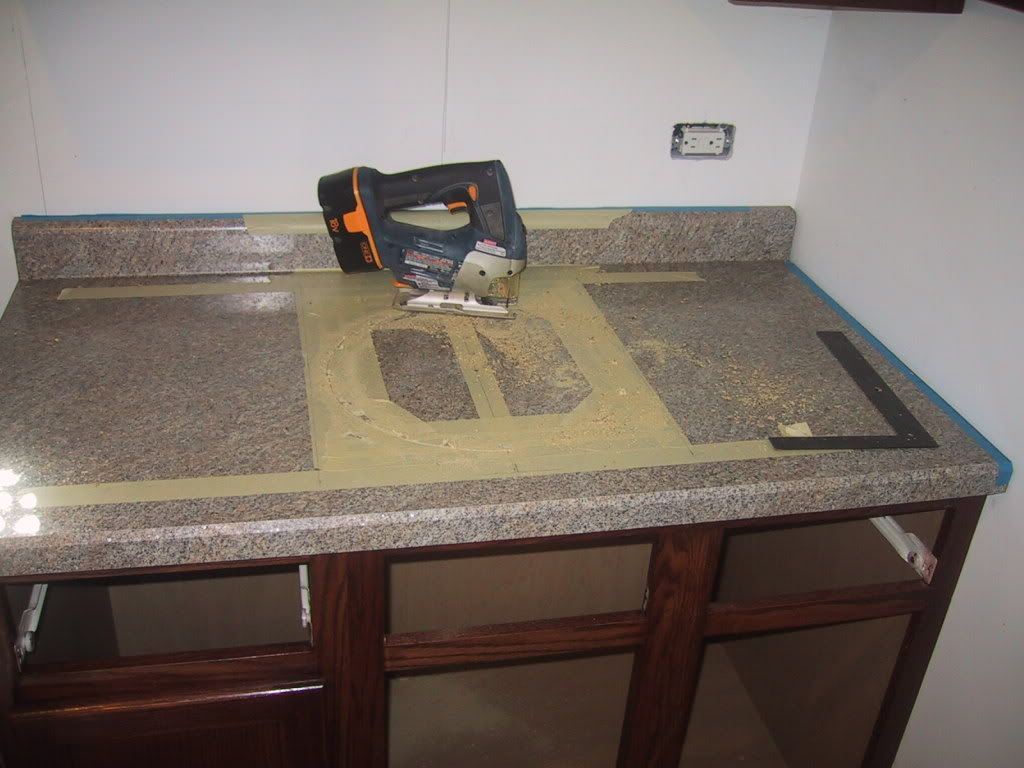

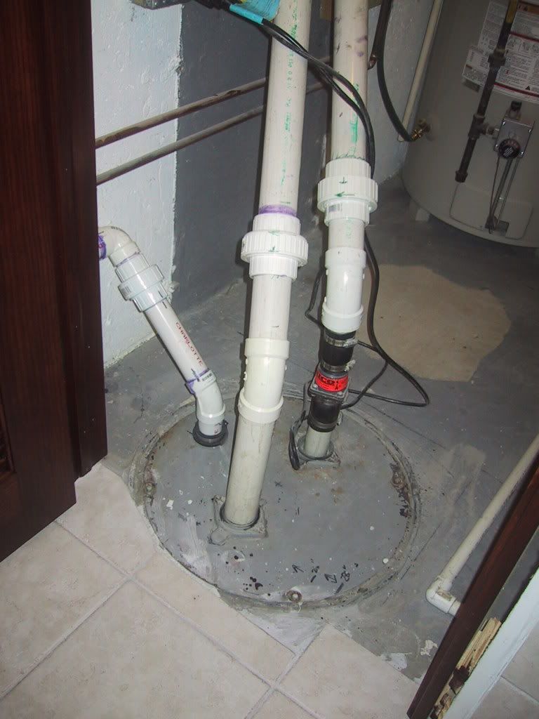

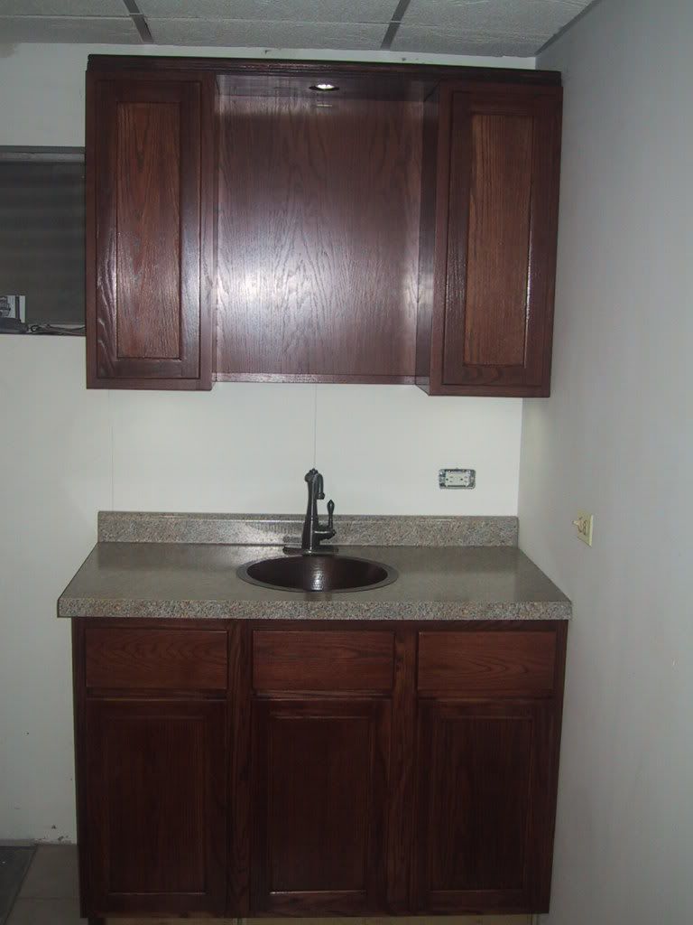

Spent one day of the Easter weekend finishing my bar sink and counter-tops.
On my last update - mentioned that I was hooking my bar drain into the ejector pit, a few photos below:
First had to cut an access hole into the ejector lid (the vent line is the one disconnected for better access)
Reassembled and ready to go:

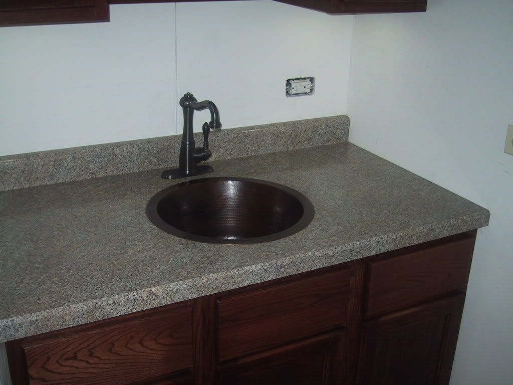

Picked up my "high definition" formica countertops and began installing the bar sink:
And the almost finished product (still need to put a crown mold across the top "bridge")

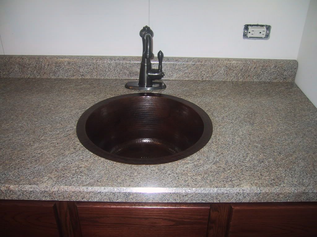

And a few close up photos for those asking about the new HD formica material:

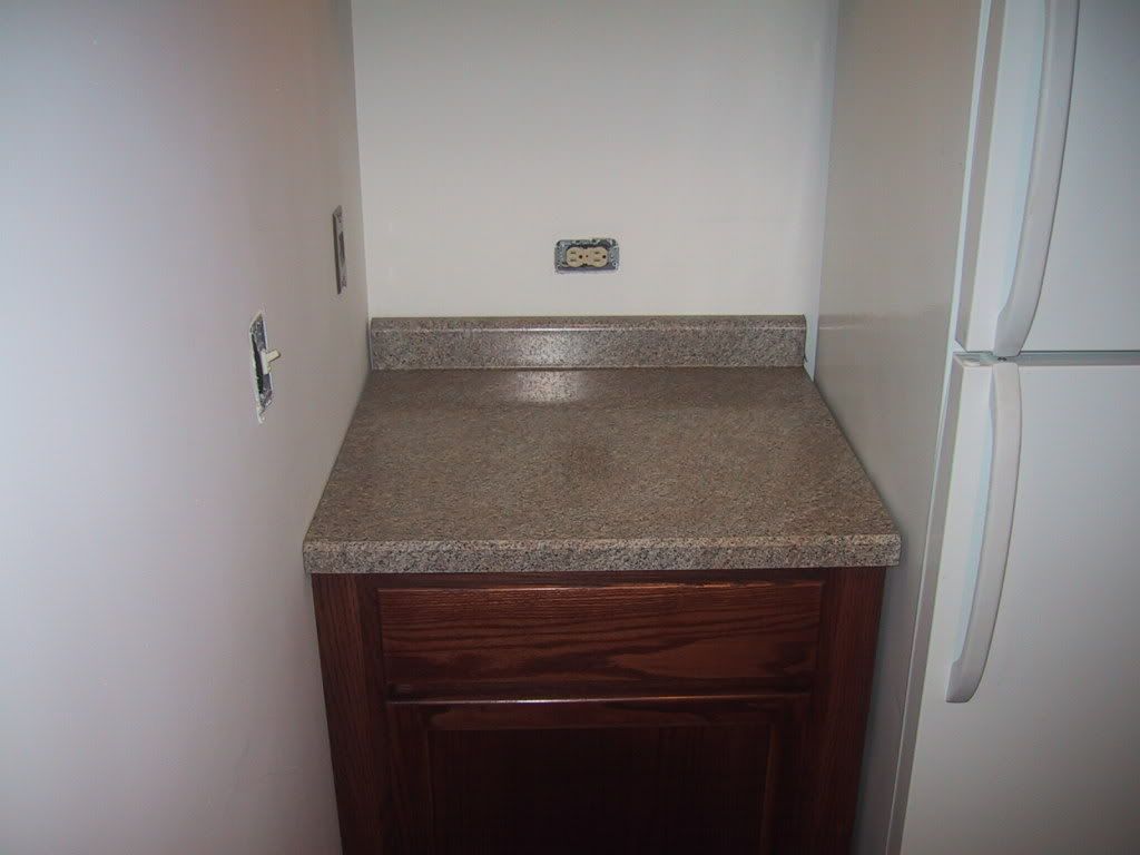

And lastly the snack/fridge area:

Looking beautiful my man!! Is the drain from your sink running straight to your sump pump pit? Anyway I have to say the counter,sink and faucet are gorgeous I love it!!

Actually the bar sink drain runs through a trap and ~4' to my ejector pit. The ejector pit is the one the floor drain is hooked to, this goes to the sanitary sewer line.
The sump system is a totally separate pit.

I was kinda curious about that too. Seemed odd to go to a sump pit. Thanks for explaining.

counter is looking good. I really like the HD formica, for the price.
I told my mom this weekend I was thinking of going that route and she told me I was crazy and that considering the money I have in the basement, why dont I just do granite...I told her I was not as rich as her and that I would split the difference. That conversation ended quite abruptly after that.

Countertop looks great cuz! Curious what it looks like on the underside? Also, is it just one smooth surface or is there a thin coat on top of the formica, like on a pressed wood product?
Does it come with different edge patterns (i.e. ogee, etc.)?

Thanks. I think if one is doing larger counter-top quantities .. I believe the price difference would be small, within $5.00/ft.
However; I was dealing with less than 8 lineal feet - and the granite people are typically not interested in small jobs

1) Yep just finished on one side, the underside and core, is the cheap pressboard stuff.
2) At least 6 different edge finishes including Ogee.

The counter tops look excellent!!! You mention that those are the "high definition" Formica....so is that the textured Formica, right? If it is and it's what I'm thinking, those look even better in person!! Nice choice! My in-laws have that with the 45 oak bevel on the edge.

Indeed the so-called HD formica has a bit of texture to it, and also seems to have some mica or "mineral-like" chips imbedded in the finish. Mine came from Menards.

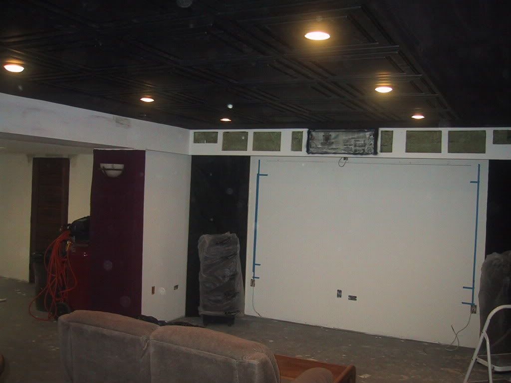

OK - I really did take on some work yesterday. Managed to get the crown mold installed above the wet bar (still need to fill trim nail holes).
Looking for suggestions for the area between the wall cabinets:
Am thinking of a mirror on the vertical space between the cabinets, and perhaps 2 glass shelves about 6" deep (glasses or liquor bottles)? overhead LED light might make it show well?

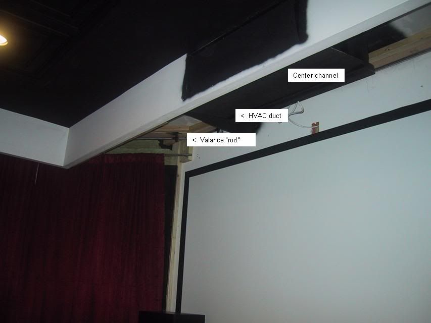

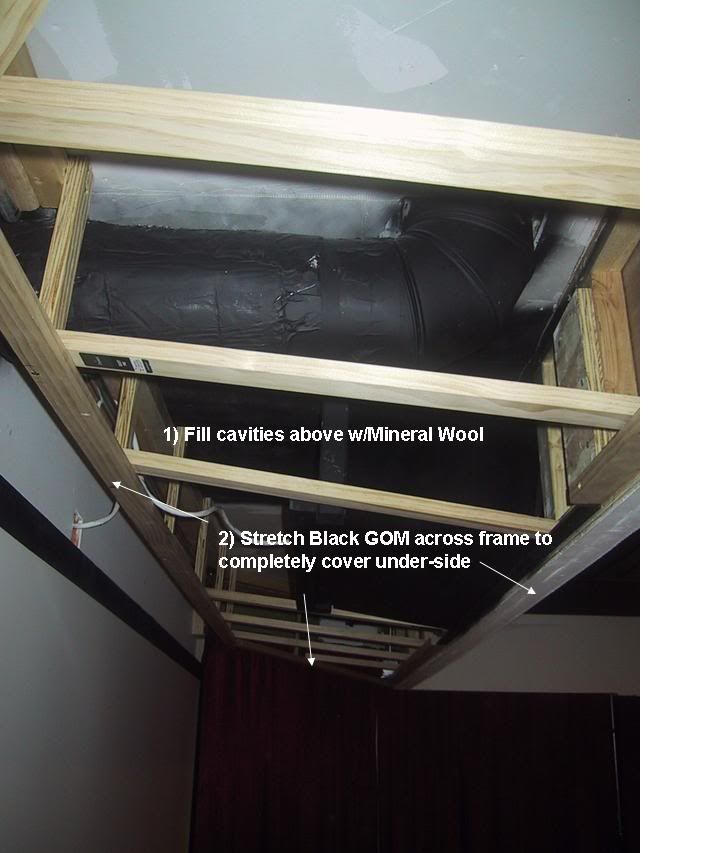

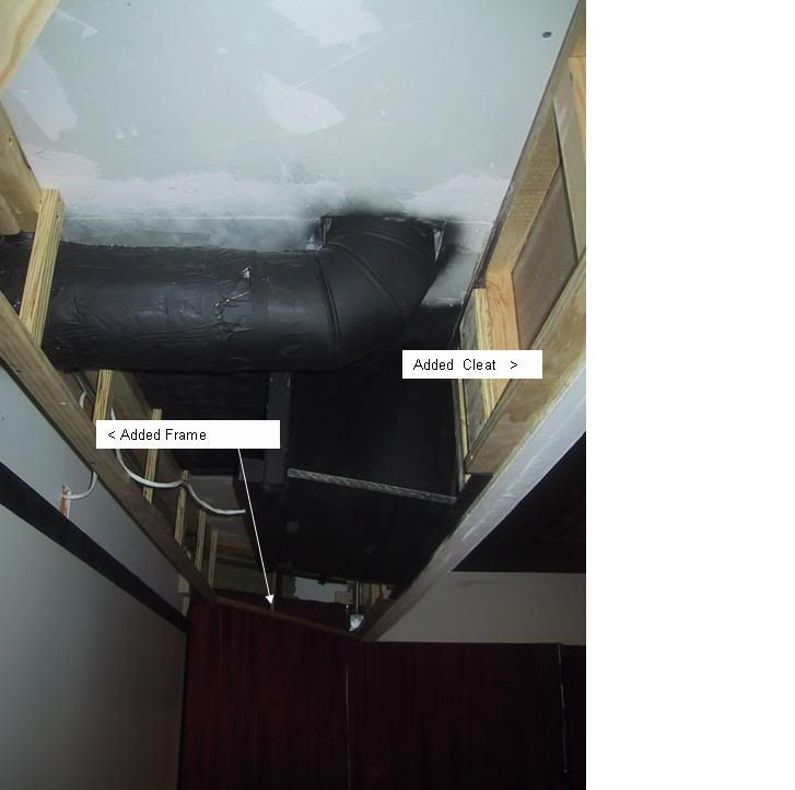

Then on to the soffitt above my screen. The problem here is that the underside of the soffitt is visible when seated in the front row. I find that the center speaker, and the HVAC duct is distracting. My plan is to fill this area with mineral wool for additional bass trapping, and then stretch black GOM across the underside to cover the distractions.
Needed to add some framing to "contain & suspend" the mineral wool and as an attachment point for stretching and stapling the GOM across the underside. There will also be just enough room behind the mineral wool to allow me to add the valance above the screen.
What I have to work with:
And with the added "framing"
Almost ready to install the mineral wool - tomorrow nights project

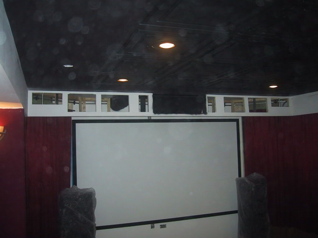

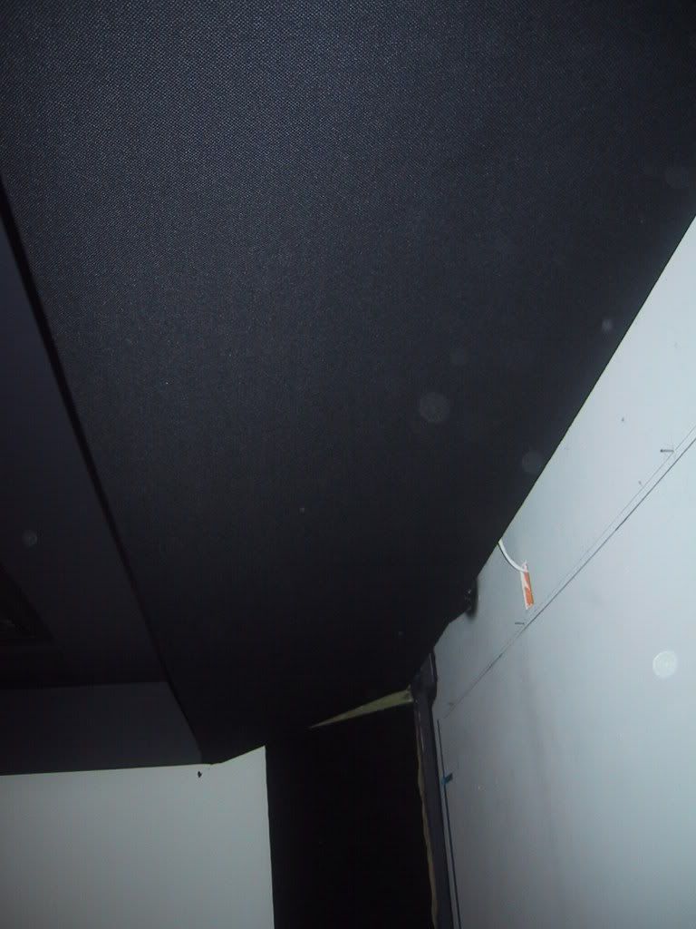

Yesterday's progress:

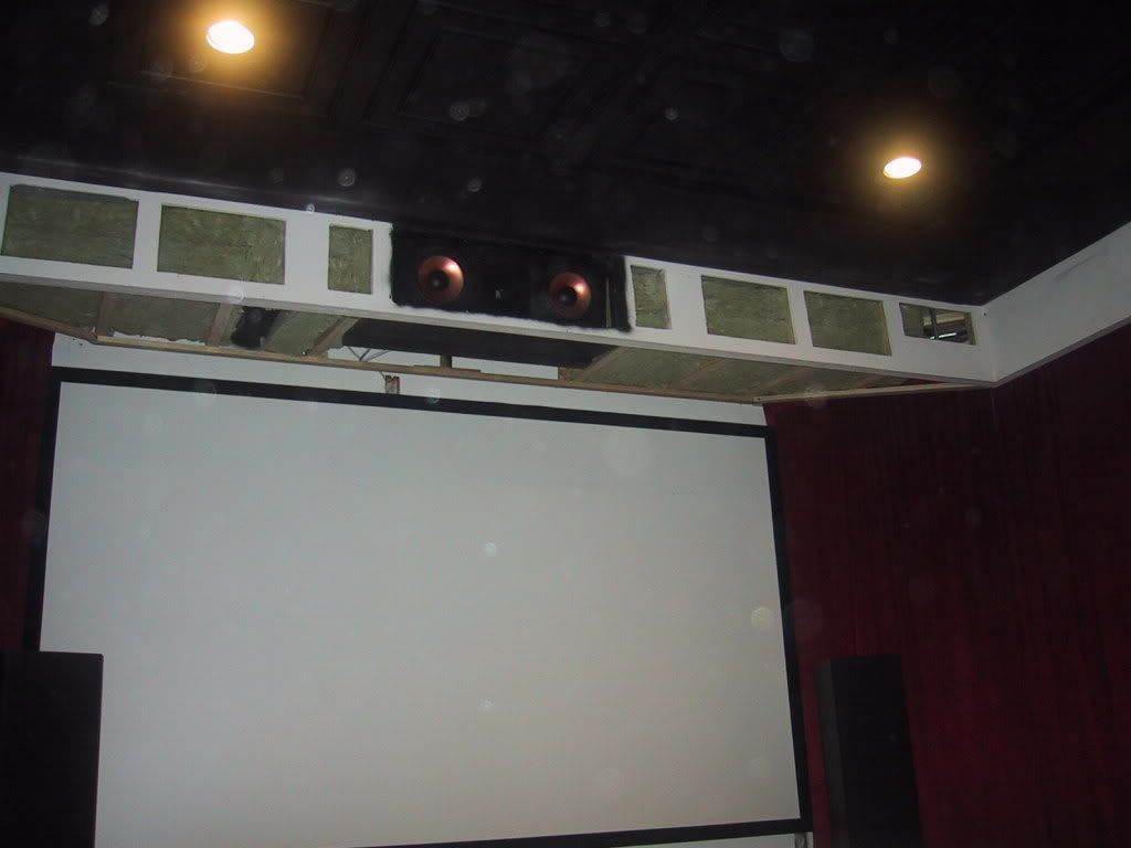

Ordered Black GOM for screen wall and flanking sidewall areas.

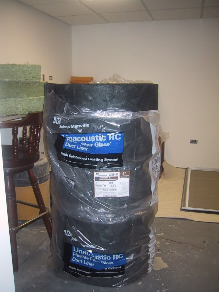

Also picked up Mineral Wool to basstrap the soffitt above my screen.

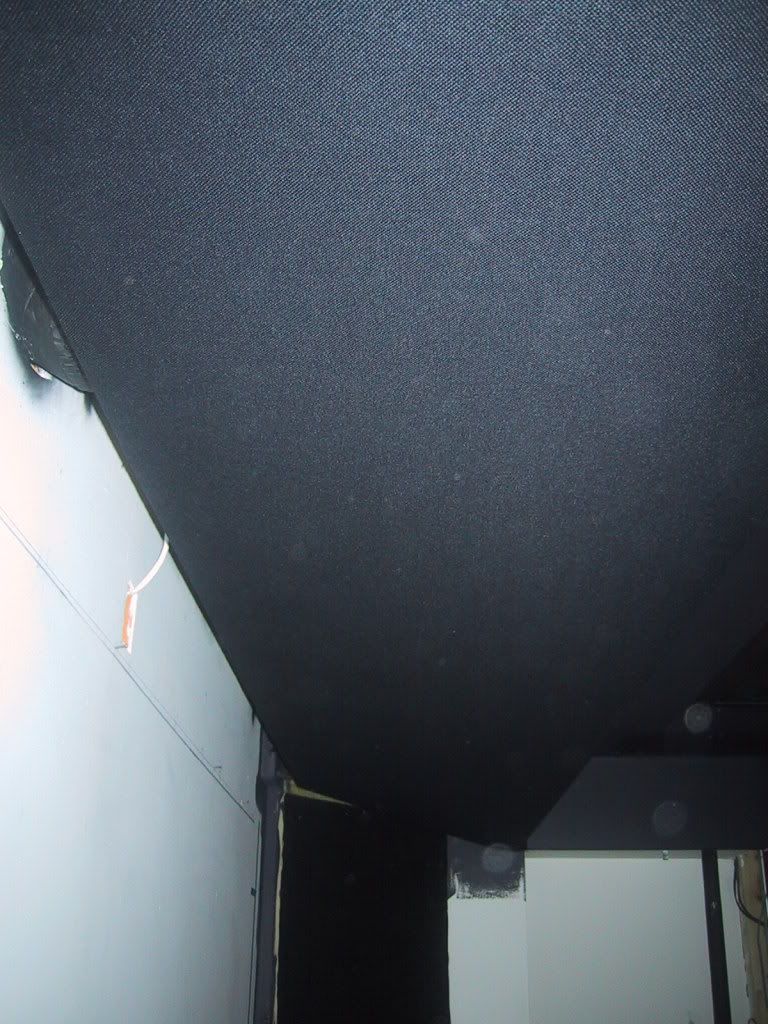

So last night; I "rotozipped" openings into the face of my overhead screen soffitt. When completely finished this "face" will be covered with black GOM, including a removable black GOM grill for the center speaker.
Next up was to fill this cavity with the mineral wool :
The black GOM will cover the vertical face, and will be stretched taught across the bottom side of the soffitt to improve the underside appearance:
Cuzed2

Are you planning on painting the face of the screen soffit that will be covered by the GOM to minimize light reflection?

Indeed; in fact I am going to paint the "faces" of the soffitts below the ceiling black all around, and the face above the screen will be covered with black GOM. I will probably use some black painted trim where the GOM meets painted sections.

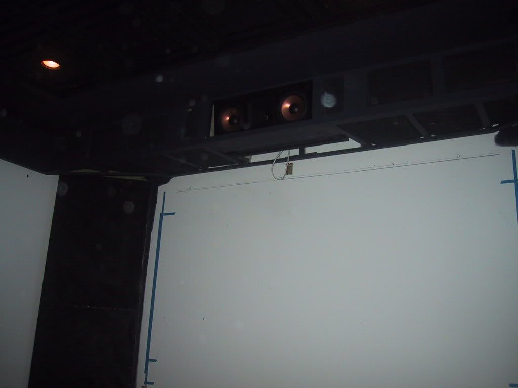

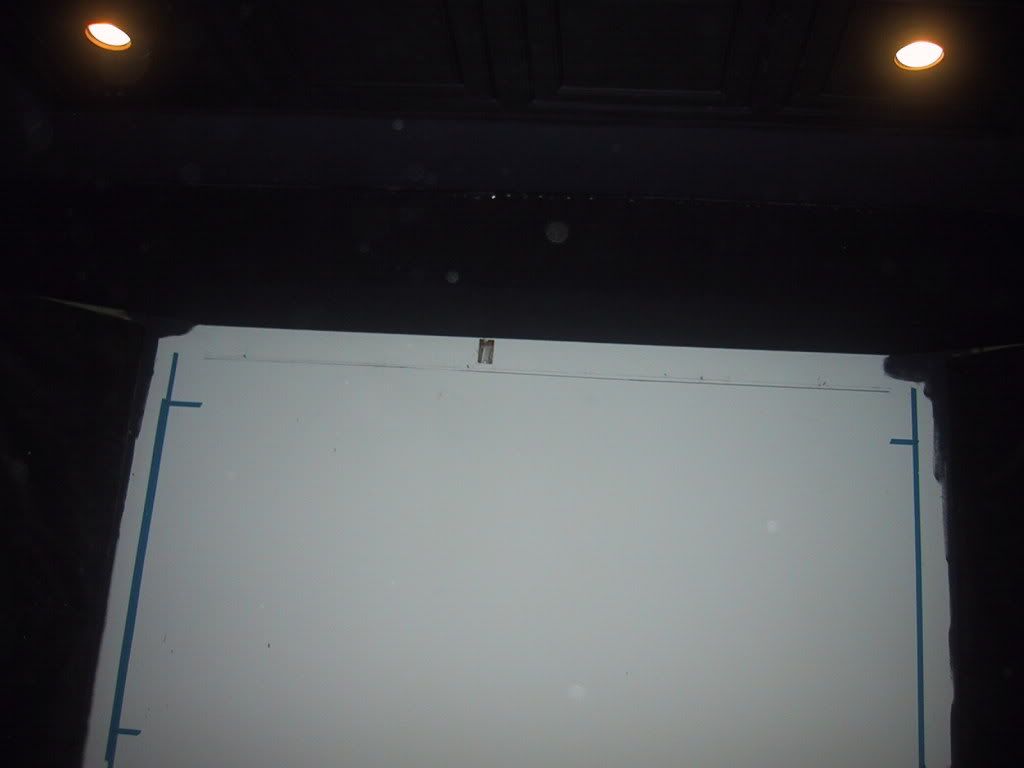

Although no new photos - I have been slowly plugging away, Outdoors and springtime has gotten in the way:
Got the whole house smoke detector/alarm system back on line with all new detectors (this started with the HT ceiling and realization that I had 10 years old smoke alarms).
Ordered and received some black GOM >> A big call out to GIK (and Frank) for great customer service. Ordered on Monday afternoon > GOM on my doorstep Wednesday afternoon !!
Bought a roll of Linacoustic, 1" x 4' x 100' (price was ~160.00).
Pulled down my theater drapes (temporary install for test fitting and custom conduit rods).
Tonight & tomorrow = painting, by this weekend should be into Linacoustic and GOM installations.
More photos later
Cuzed2

So if I am not careful; springtime and my Son's soccer may get me "Loganed". In order to avoid that distinction, I offer the following evidence of forward progress:
I did manage to purchase some Linacoustic:
Last report had me at the point of stuffing my soffitt, removing my screen, and priming the entire soffitt surround in flat-black, in preparation for GOM:
Primed flat black and Linacoustic is now covering the exposed mineral wool (front and underside)
And now with the GOM stretched and stapled, Just what i was hoping; for the underside distractions have disappeared:
The GOM extends from the ceiling/soffitt intersection down vertically, then wraps under the crown and across the underside to the screen wall (allowing space to hang my drapes and valance) . Result: everything has disappeared into a sea of black.
Next up: to install the linacoustic and trim above and below the screen , and the flanking walls.
Oh; and I just got word the Marantz service center called - they have installed and updated the firmware in my Marantz 7002 - will pick it up tonight and get some "working music" back into the room
Cuzed2
CuznEddy Cinema
cuzed2 is offline
