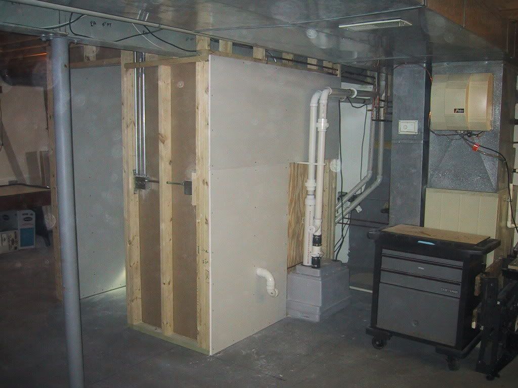

Thanks! As for the elevated throne:
The original owner of this house did not spend the few extra $$ to have bathroom plumbing stubed into the concrete floor. Therefore I had a choice of busting the floor open OR for about $600.00 going with this pump/tank appartus.
It actually worked out well, I went with the lowest profile throne I could find and the end result is a toilet no higher than a handicap throne.
The photo immmediatly below shows the backside of the bathroom wall and the rest of the appartus.

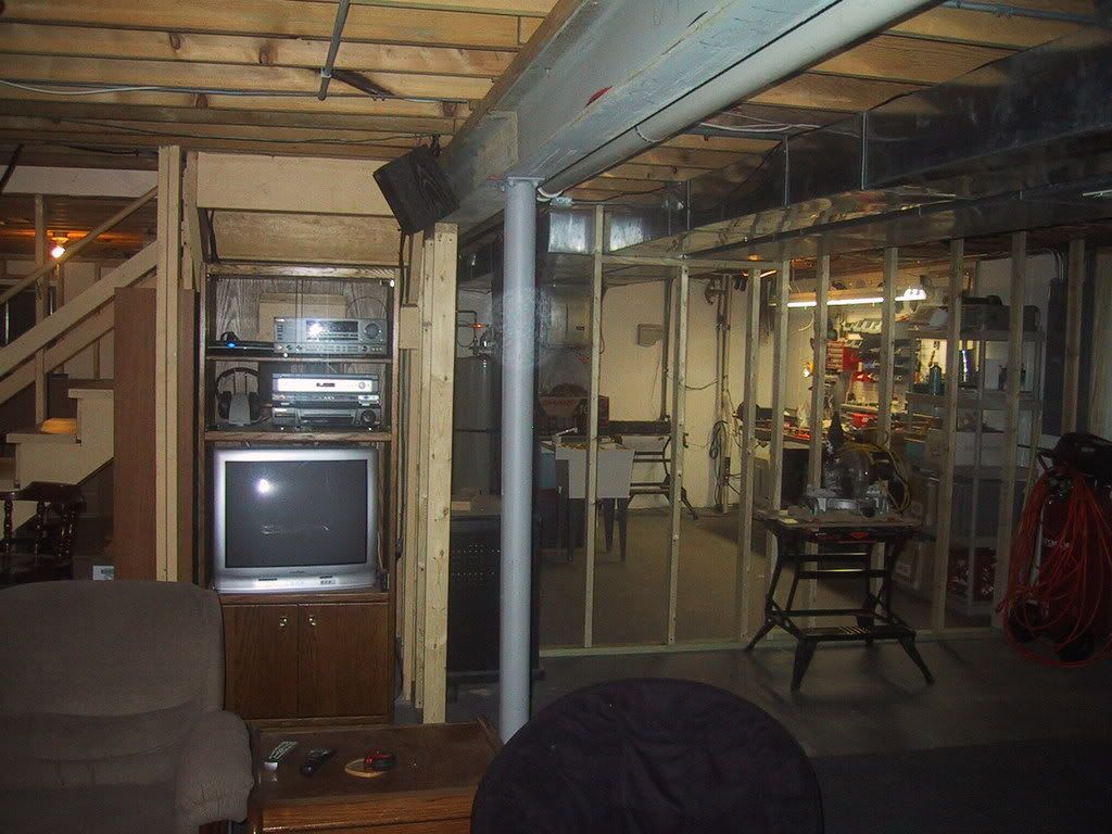

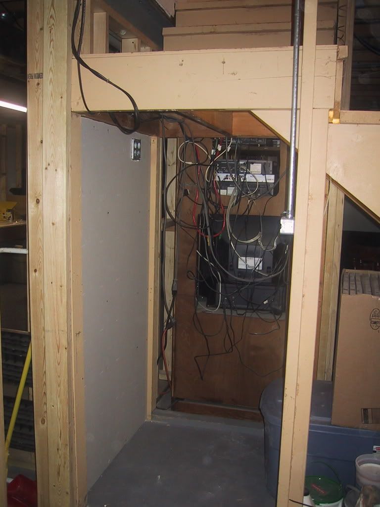

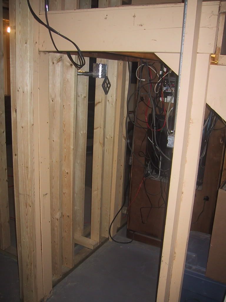

Some more updates and additional progress photos

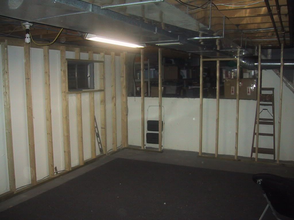

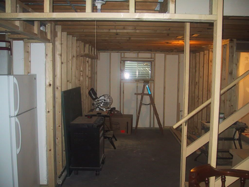

In my effort to frame towards the theater/play room >I have sacrificed another 80 or so 2x4's.
Immediatly below is the open room adjacent to the theater area:
I have started a false wall with doorway access to cover the crawl space:
This view (was standing near the screen) was looking back into the play area showing my temporary equipment rack:
And this last photo was taken from the entrance of the new bathroom, it shows the rear of what will become my equipment closet:

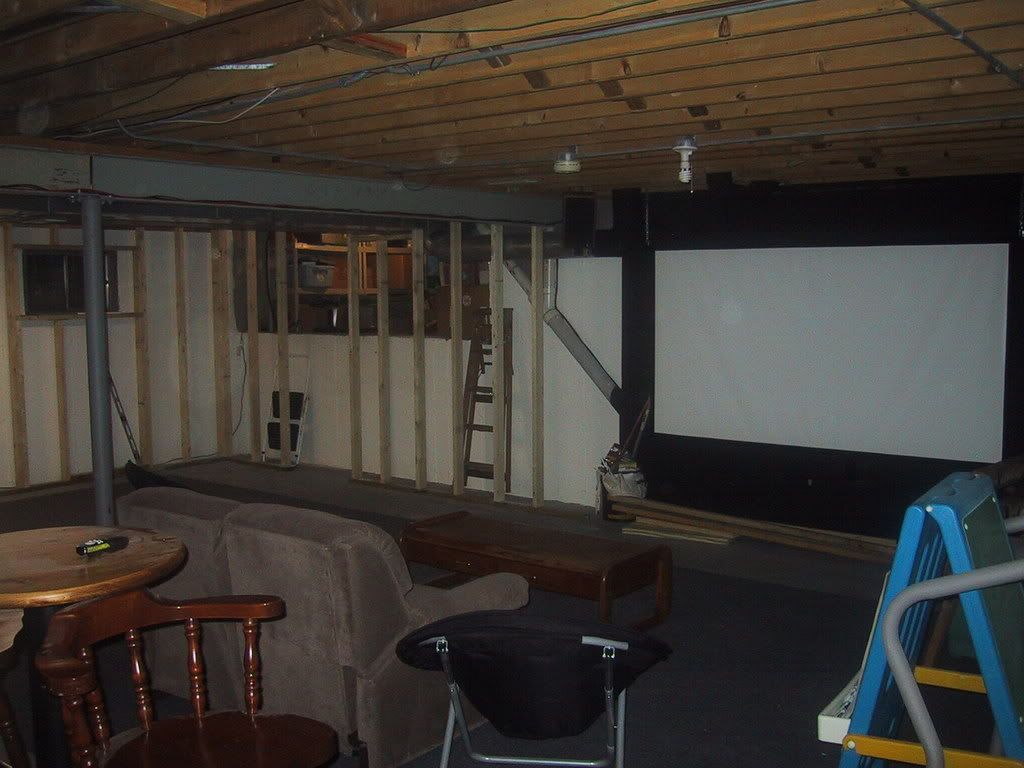

Good Afternoon,

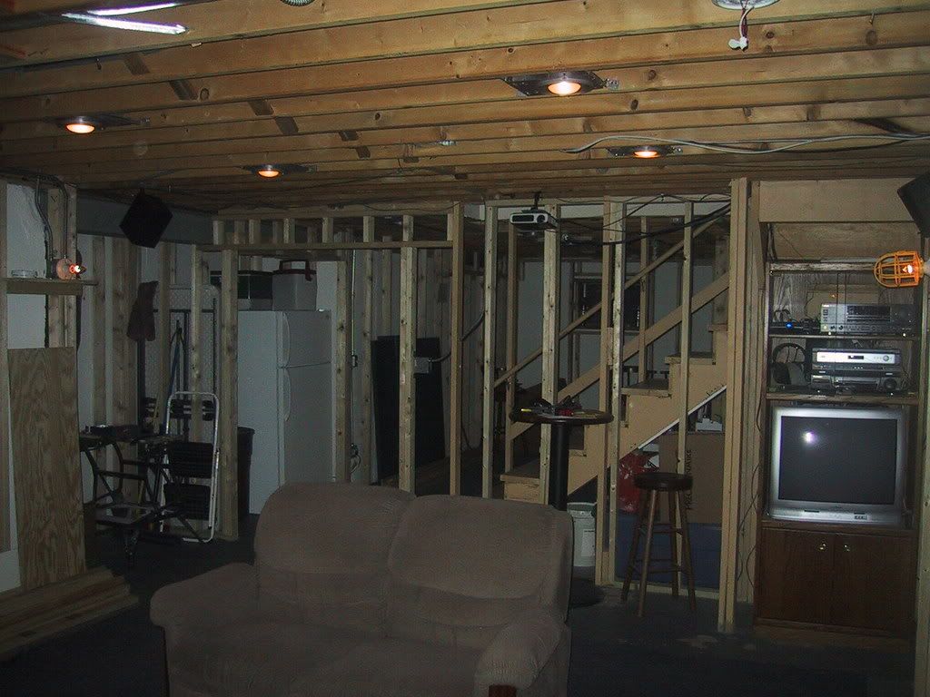

I will follow this post with some photo updates, Since my last update I have now completed 90% of my basement framing. I am now at the point of framing my screen wall. I hope my question on the sketch below is clear.
In the upper RH corner, to the right of my screen, I will need to frame and box-in some plumbing, my water meter is in this space. This will result in a 22" wide x 6' deep bump-out to the RH side of my screen.
I'm thinking I might gain an acoustical advantage (at the cost of floor space) if I were to put a matching wall like structure to the LH side of the screen? What does everyone think, well this help acoustically?
I was also thinking of filling a portion of this hollow space to end up with bass traps?
I know this open floor plan is a bit of an acoustical compromise - I am just trying to make the best of it. Open to any and all suggestions

I would build a box out to match the box out that you need for your water meter. It will help keep the focus on the screen vs it feeling "uneven" to the viewers. I did something similar to this for my wall opposite from my posts. I wanted it to look/feel even, so I built fake posts to match even though it wasn't needed. It just so happened to work out well for wall sconces!!
Another benefit of doing this is it will help keep light off of your screen wall that may come from the open game area. That happens to me when I have the lights turned on in the area that I'm planning to build a bar. Just another thought!!

In fact; later last night I went down to the "hole" (as my wife calls it), and framed in the LH front-side to match. I agree the balanced look already looks better, and hopefully will be better for acoustics.
I also have a support column at the rear left side of the room - I will be disguising this by boxing into a rectangular pillar for a sconce light and my left-rear surrond speaker. I will then bump out the back portion of the RH wall to match.

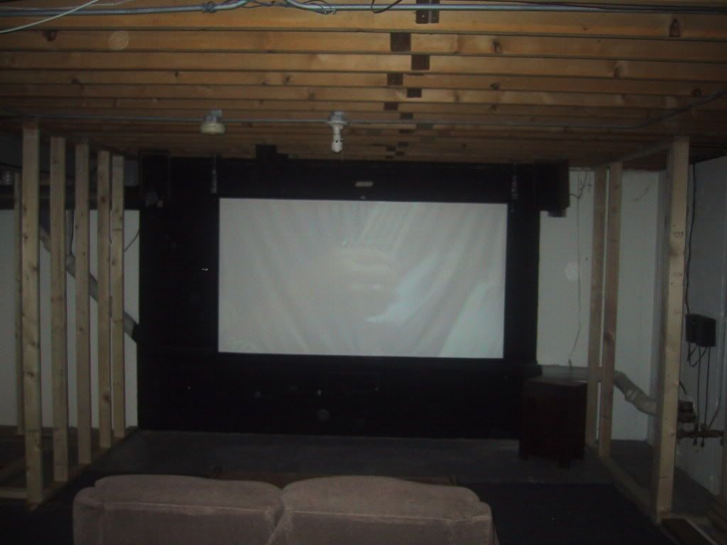

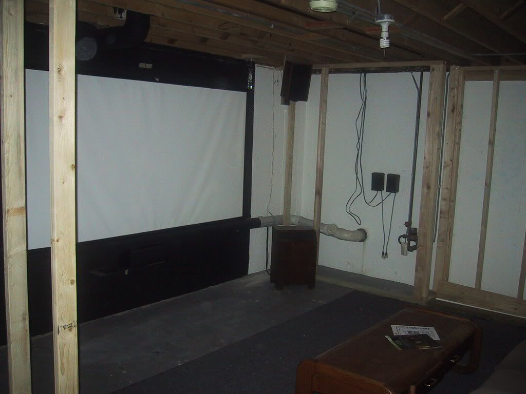

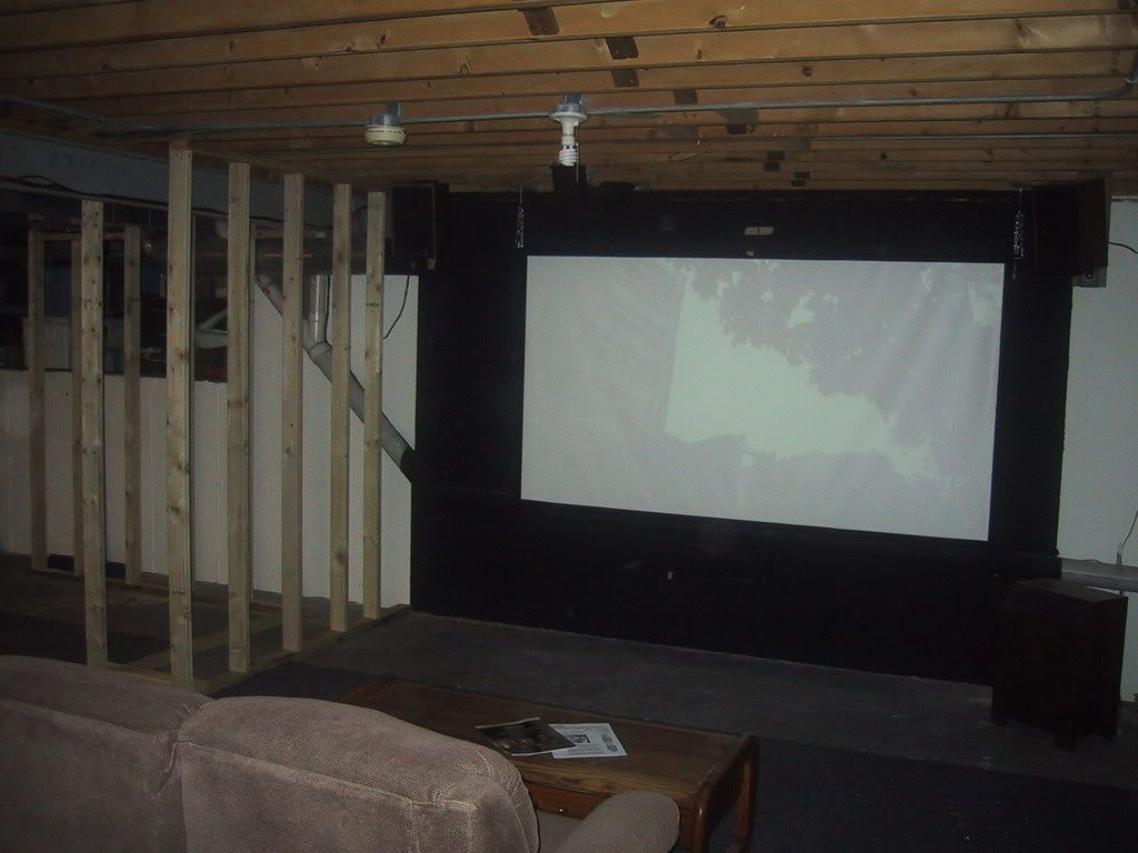

I have done a bit more framing and have now acted on your various inputs regarding my question of how best to build out the screen area. I have now rough framed both the LH and RH sides of the screen area.
In the last photo you can see that I have also framed the RH side-wall from the screen back back thru the theater entrance and into the adjoining bar area.

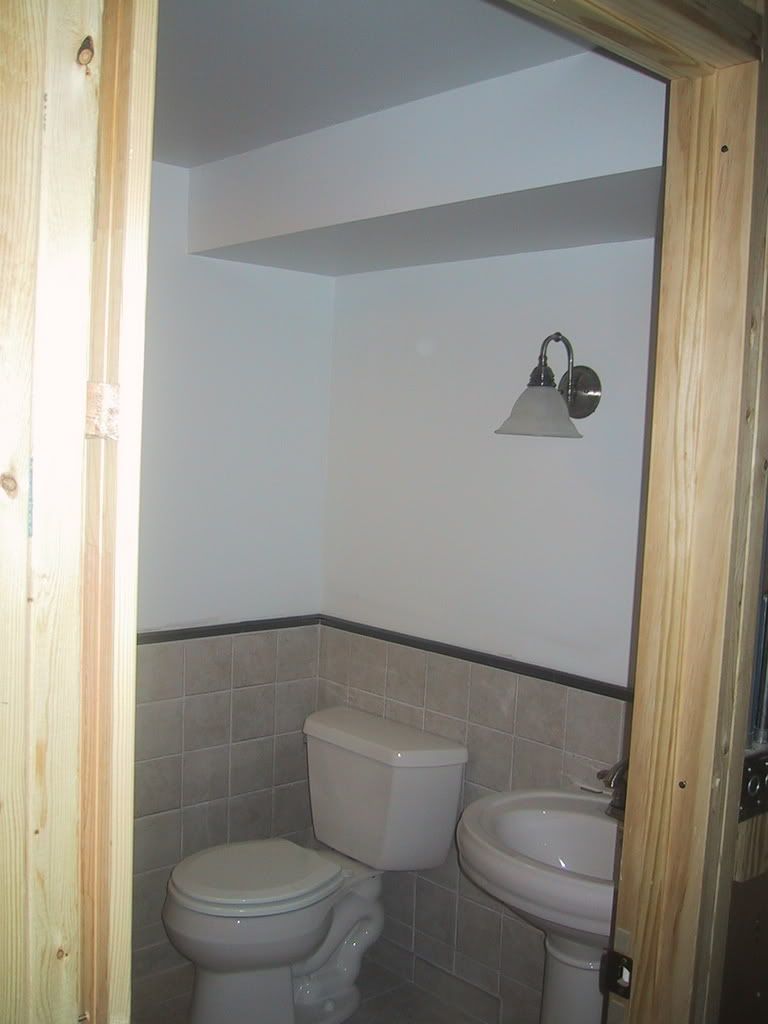

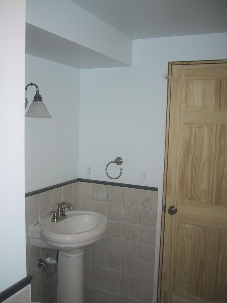

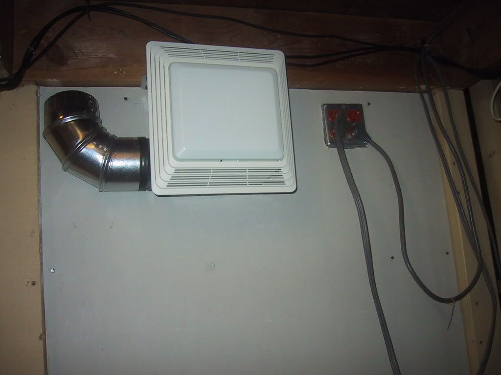

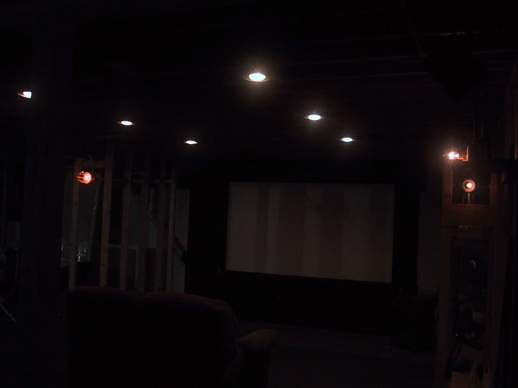

Been a while since I posted, but I think I may have one of the time more time-consuming rooms out of the way and done - the bathroom. 2 quick photos below.
Next up: Bending conduit and getting my electrical and lighting roughed-in.

I have to admit that the I think the bathroom turned out really well! Great job. I just have to ask, and I noticed BigMouthInDC asked also... whats with the elevator toilet?
I'm not exactly sure how I want to finish my bathroom, but I like the tile-on-wall idea - I was also planning on tiling the floor.

As for tile > I had my doubts, but am now glad that I chose to spend the extra 2~3 evenings tiling the back wall.
The elevated toilet was to accomodate the above grade tank/plumbing arrangment shown in one of my earlier photos.
By using this above grade tank/pump arrangment > I was able to avoid cutting open my slab, trenching the plumbing in and laying new concrete. If the orignal owner would have just given the builder the extra $300.00 to have drains stubbed into the slab (to the ejector pit) I could have avoided this elevator throne. Although I have to admit it is no wose than using a handicap throne at an airport.

Craig,
The bathroom looks great. Nice job on it. It's good to see progress still taking place. Keep it up!

Hope Everyone is getting into the Holiday Spirit!

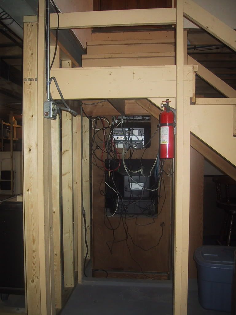

I'm still plodding forward on the Cuzzn Eddy Cinema. Most of my recent electrical work does not show well in photos (although I have attached a few below).
What I have been up to since the last post:
- I have bent a lot of conduit (about 1/2 the basement has 110v installed now)
- Added 4 breakers and associated conduit runs
- Two of the breakers feed dedicated ground 20 amp circuits for my Equip closet
- One is for the 6 can lights I installed at the base of the steps/hallway & bar area
- Ran conduit and installed 3-way switches (and lights at top and bottom of the stairwell
- another circuit for genral purpose outlets in 1/2 the basement
The photo below is my Equip closet with conduit for 20 amp circuits:
Next > with Drywall and 20 amp dedicated ground outlets:
Found a very quiet lighted Bath fan for use in my Eq closet. Trying to decide if I will place my lighted exhaust fan on the Eq closet wall or Ceiling ? It will exhaust the excess heat into my shop area.
Thanks for Looking
Cuzed2
CuznEddy Cinema
cuzed2 is offline

I should call this the snails-pace theater project!

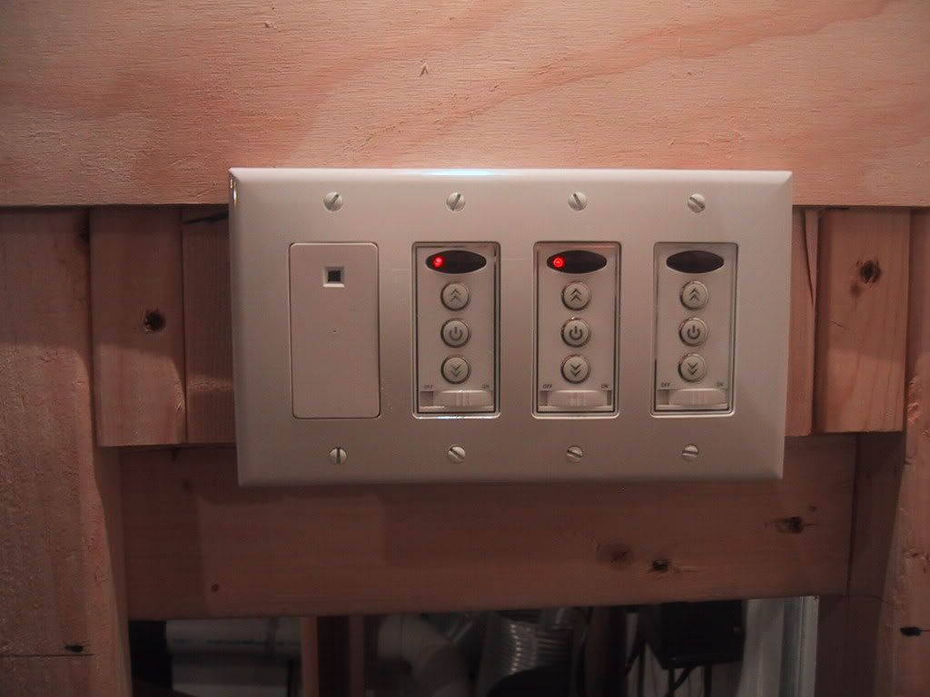

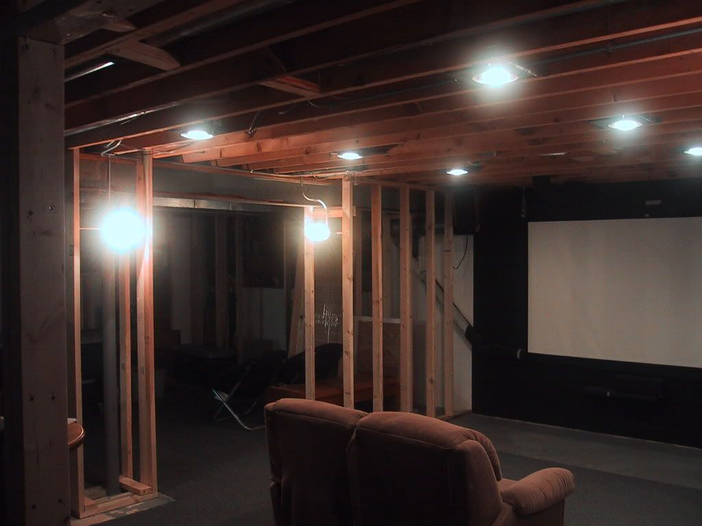

Despite the lack of updates I have been plugging away. The last 3 weeks have been electrical, moving conduits, installing conduits, 6 can lights, and locating 4 sconce lights, have also roughed in my rear column locations for the rear sconce lights.
I am relocating conduits in order to maximize headroom (should have a finished heigth of 7'8").
A few pictures are posted below. Please note I installed some new gadgets:
Installed the Buffalo IR flasher kit > works great. Also bought a 4 gang deep box that will someday allow the upgrade to a Grafik Eye - for now I have some economical IR controlled 3BM dimmers ($89.00 - lots of bang for the buck).
Photos below.
Cuzed2
