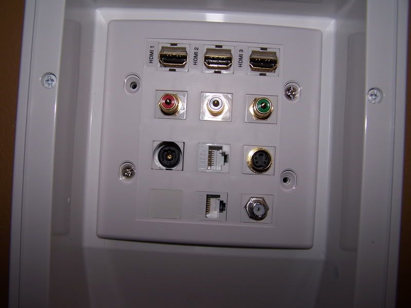

OK, here are some pics of mine.
Front before everything was in. My wife is a label freak and insisted on making them for me.
Back - Man, that F connector was kind of recessed.
OK, I promise the box is not crooked, I was snapping these shots pretty quickly as I was working.
I ended up doing 3 HDMI, the F connector for an antenna feed to the TV, The Toslink for digital out from the TV, S-Video for my Laserdisc player , Component and a couple of Cat 5 runs for whatever. I might end up putting a IR repeater at the top of the TV and I figured I could use une for that, plus I know some TV's already have Ethernet jacks and figure it will be more likely in the future.
Yes, more drunken camera work evidently.
I had to run it vertically due to framing constriants. Because this wall backs up to stairs the studs are close together at at irregular intervals due to extra framing to catch the landing. It was nice knowing I was hitting 4 studs with teh TV mount though.
Oh, this one shows how the 12 port plate does not quite fit in the box, problem was solved in 5 minutes using a utility knife.

So far, the HDMI are wrking perfectly with no issues, but I have only used a 1080i source. As soon as Panasonic gets off their rear and releases their new Profile 2.0 Blu Ray, I will let you know how 1080p does.
Of course, I have what seems like 50 pounds of cable hanging off the back there, even with only a 6 foot run for everything. I had to end up being pretty carefull about how I bundled it all so the cables fed out at the right places and I screwed a deck screw into the stud and tie wrapped the wire bundle to that to give me some strain relief.

A couple questions, since I'm doing my in-wall wiring right now. Plus, I'm a strong proponent of the "one-cable" method . . .
• That looks like a manufacturer's site, not a retail site—where can you buy those recessed plates?
• Does anyone know if those are an acceptable method of passing low voltage cable into/out of sheetrock, according to the current National Electrical Code?
That looks like a manufacturer's site, not a retail sitewhere can you buy those recessed plates?
From forum sponsor Monoprice:
http://www.monoprice.com/products/su...09&cp_id=10425
Scroll down to the bottom of the product list. They even have them in black.
Laters,
Jeff
Cool! Yes, of course, I'm a HUGE Monoprice fan! THANKS! Appreciate you taking the trouble to embed the link for me, as well! Even cooler . . . they even have them in GRAY! (My display-wall is 18% neutral gray) Woo hoo!

Where is you find that recessed plate? It is exactly what I have been looking for. Any help would be great Thanks

http://www.galesburgelectric.com/Car...te-p-8606.html This is the recessed combo box. It was posted above, but is not easy to realize what it was. It is a Carlon proiduct so it is possible you can find it a a local place also.
XBOX Live: SheriffTruman
Do you want a nice Keystone Jack panel behind your TV with HDMI, and Toslink? Check This Thread at AVS

I was surprised to find that the Menards store near me carried the Carlon SC300PRB recessed outlet. It's $9 more than the mail order site but with shipping it's pretty close to a wash so I picked one up the other day for my media room build out that's in process.
There's also the Arlington recessed TV BOX that's available. Not sure if anyone here has tried it though.
I also ran across this site that carries VGA keystone inserts that are dual-wide and fit into plates they carry. I may go that route for filling in the CArlon box.

Can anyone tell me what I'd need to do to insert the power outlet on the flat end and a 6 port keystone plate on the slanted end? I'm hoping I can use something like this as the power outlet:
