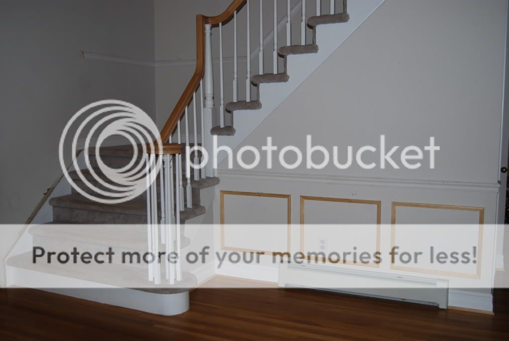

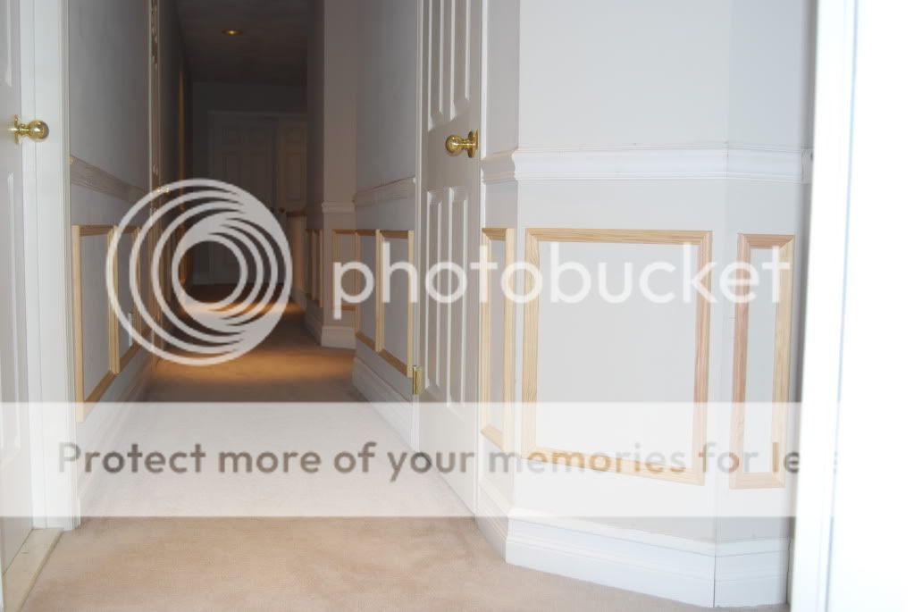

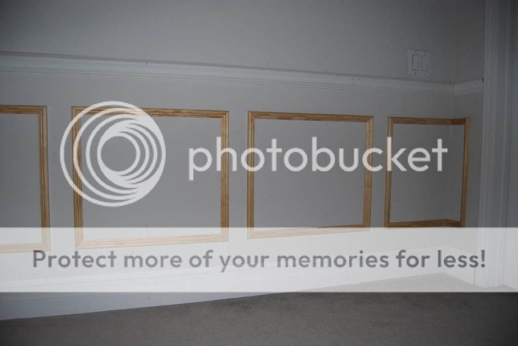

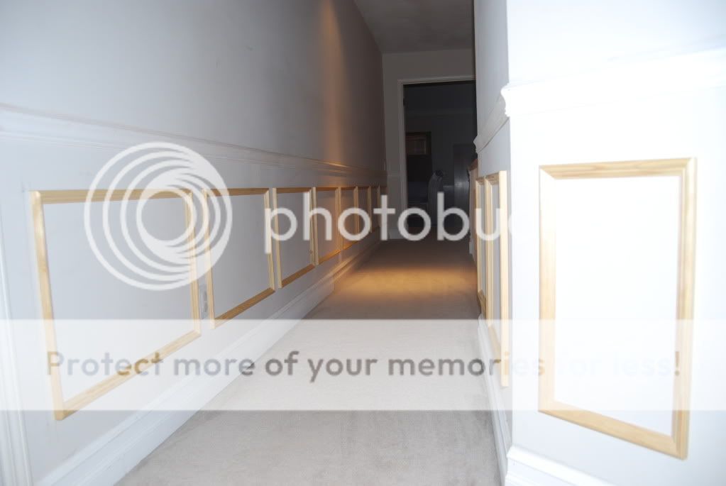

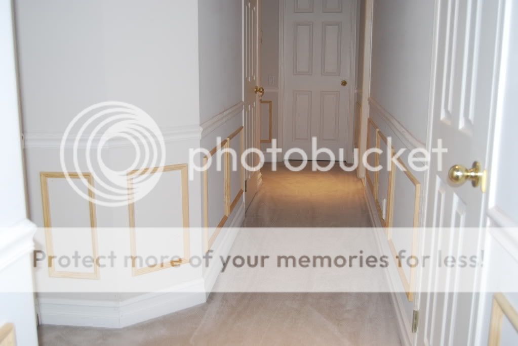

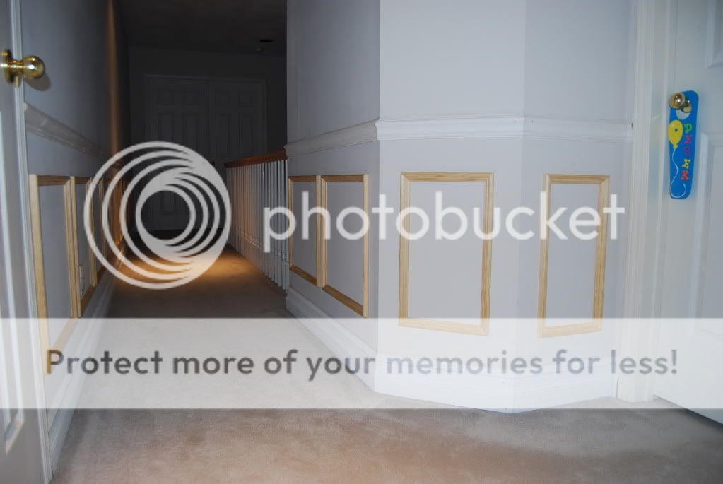

Long hallway half-way done. The helper seems to work a lot faster when the GC is around . Debating whether to extend the picture box to the kitchen and family room area or just leave it with chair and base. Leaning toward just going chair and base since I do not want to make the faux wainscoting overpowering. Thoughts? Also decided to rip out the base trim in our bedroom since I can't have the hallway looking better than the master . Pics as promised. You can see the funky wrap box I had to do by the entrance to my bedroom.
Both the GC and my mom think I made them too tight. I used the link that BIG provided a while back where the 'expert' recommended 3" as the margin (spaces in-between the boxes). Plus, a few people here seem to have used that same width. In that first stand-alone box that I posted a day or two ago, the margin was 5" but I'm going to have them change it to 3" since that's the distance throughout the rest of the main floor.

It looks great Queen! Once they paint it, it will look awesome. The only thing I would have done differently is use 4" space (from each other, from top and from bottom) and made the boxes rectangles instead of squares (stretched them out).

Actually, from top and from bottom it's 4". In-between the boxes (margin) is 3". Picture may distort it but they are slight rectangles (19"x21"). Obviously not changing the hallway but do you think I should revisit the main floor since they're not done yet and do 4" as the margin instead?

That looks awesome, if it wasnt for a baby on the way and the theater that needs done and the small bath my wife just HAD to do, the shed we just got, the babies room that needs finished and the landscaping that needs attention I would consider showing these pics to my wife. We are about to get our baseboards all re-painted in a week and they are adding shoe (paying someone of course), but I do like the higher baseboards.
Are those all new along with the chair rail? I see some nail holes so i think I know the answer but it is better to ask than assume.

I think it looks great Queen. I would probably keep the same spacing throughout the house unless it really bothers you. Maybe some others here will chime in with some additional feedback.

I agree. Keep the spacing consistent. Looks good.

IMO these look great! I wouldn't change a thing.
Yes, base is new (old one was a really small one with no character), along with the chair. I like the new one so much that I'm having them replace the master bedroom trim too. No chair or picture box in there though.

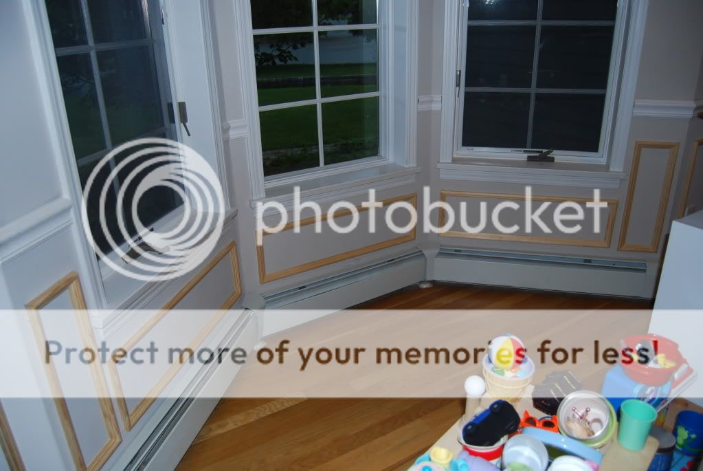

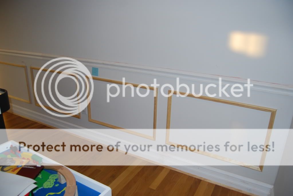

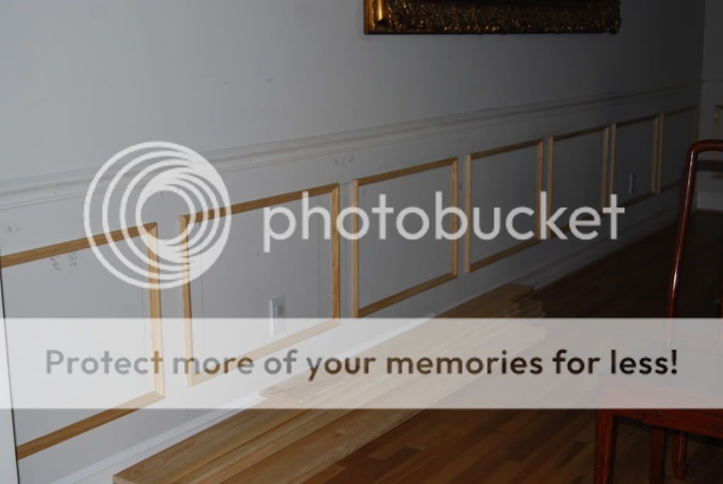

Thanks for all the compliments guys. The GC's helper is doing a fine job. I've decided to pull a 'Shawn' and have them pull off those ten squares in the long hallway upstairs. They'll be able to re-use the boxes in other spots so I'm only out the additional labor to take off and put back on. After I saw how the living room came out and part of the dining room I knew immediately. They will go from being 21" to 28" (just a hair narrower than the rectangles in the living room-first pic posted below). Plus, the margin will increase to 4", similar to the main floor. I really like how the small rectangles came out below the windows. Last pic is the start of the dining room.
I was unprepared for exactly how much picture box molding I would have to purchase. I have to place another order tomorrow, bringing the total to over 600 LF ! I've decided to just go with new base and chair in the kitchen and family room, limiting the faux wainscoting to the foyer, dining room, living room, stairs and upstairs hallway. It's a great thing I was off these two days (for school events) since it was imperative that I be present for all the chaos and last minute measuring. No progress tomorrow as I need to order additional materials. Work will commence again on Thursday.
BIG, as luck would have it, while I was at the lumber yard scrambling to buy some additional molding I saw a display that caught my eye for the room opening headers. And wouldn't you know it, the display said "Arts & Craft" and "Craftsman". I suppose that style is my preference as well . Oh, and the library finally called so you know what I'll be reading tomorrow morning on the train ride in!

The picture frame molding looks great and I love the craftsman style door headers!

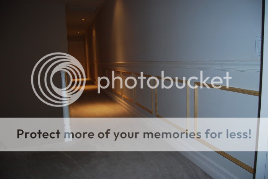

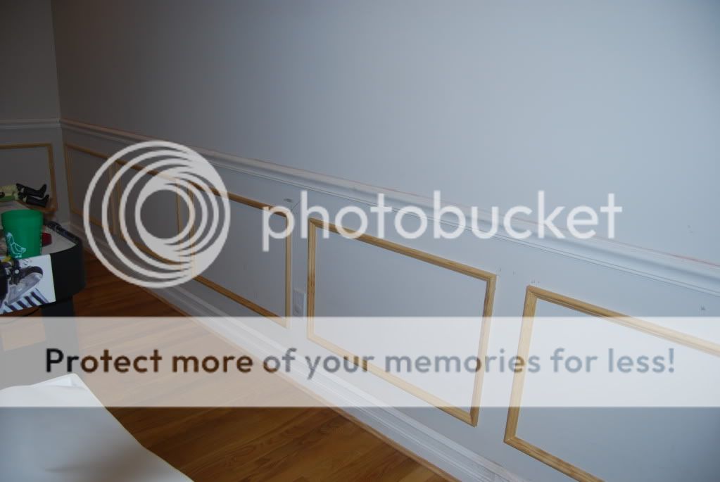

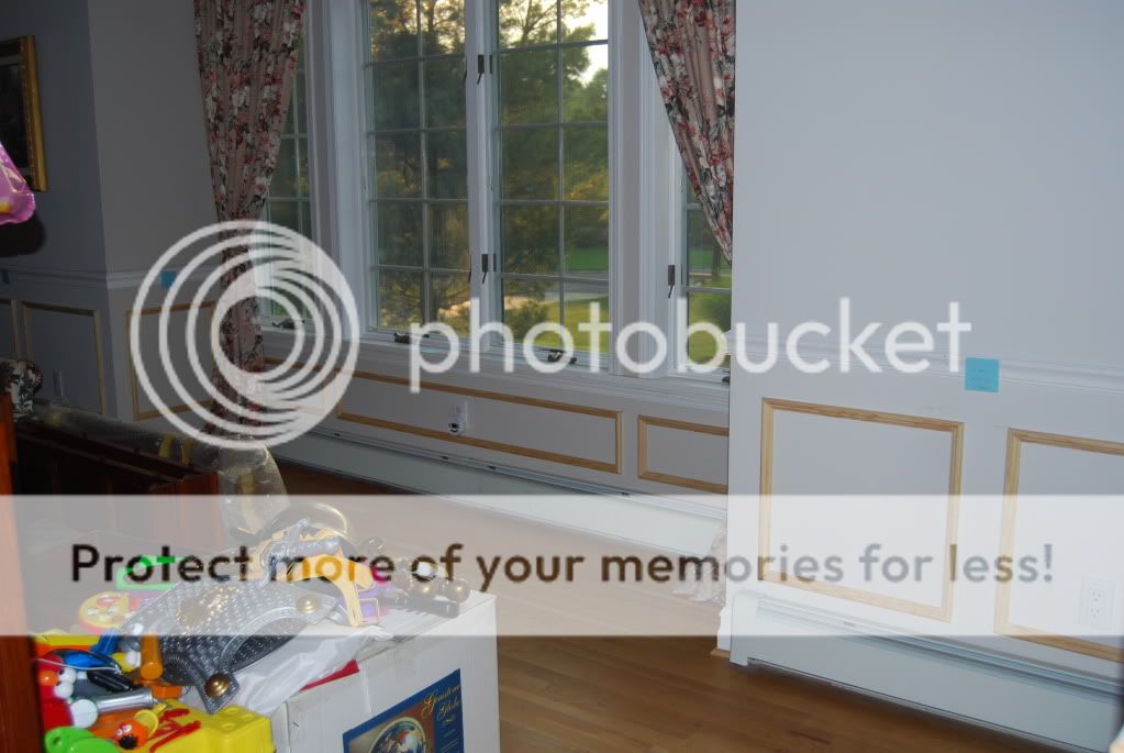

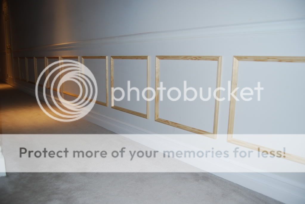

Long hallway redone to make the boxes more rectangular and with 4" margins. Dining room nearly finished (only wall remaining is where the opening frame is since I have not yet decided on the width of the vertical strips outlining the opening).

This really makes for an impressive formal look - nice transformation.
So I'm thinking you are about to break out the caulk and paint...?

How much baseboard heat do you have in your house? is it all like that, or is that to give added heat where the vents are not adequate?
by the way, things look good, but thats a lot of caulking and painting.

Yes, that is an awful lot of caulk. GC thinks I should only caulk the outside perimeter because if I do the inside perimeter then I would lose my bevel and nice shadow line in my picture box molding. Any opinions to the contrary?
Time to call up that painter again. A while back he gave me some quotes. He saw me in HD the other day when I went to pick up some more trim and he chased me down. He said things were slow and was wondering whether my sister still needed a painter. Will have to get more firm quotes now that I know exactly which rooms will be done.
Yes, unfortunately that's how all the baseboard looks throughout my entire house . I grew up with natural gas so I wasn't too pleased that this area didn't have gas lines. It's bad enough I have to cook on a stove without a flame much less have all those darn baseboards all over the house! Plus, the house never seems to get as warm as my parents' house did.
GC's helper unexpectedly showed up today. He was not due until tomorrow. So, the hallway upstairs is now complete. Chair rail in the kitchen and bedroom are done. I decided to forgo extending the faux wainscoting beyond the foyer, dining room and living room. Only chair rail left is in the family room but I need to go to HD and pick up a couple more 9 footers. One thing for sure, is how the chair rail accentuates just how crooked all my walls are. I don't think there is a single straight thing (floors, walls, etc.) in this house!
