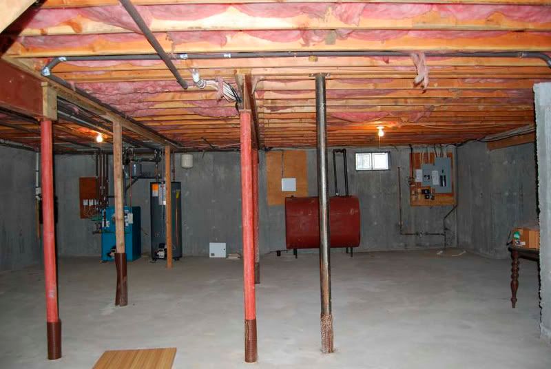

Ok, let's see how this goes. Here are a few pictures of my basement. Sorry about the resolution and awful composition. I had to keep cropping the original images in order to meet upload specs. The red steel pole is the pole at 16'. The cut-out straight ahead is where the fixed screen will be placed. The second photo shows the view looking at the HT from the side. The second furthest red pole is the one that will be right smack in the middle of my theater. The wooden poles on the left (near the burner/heater) are right at the 20' where I can either make a back wall or extend to 30'.
The next two images are my crude attempt at a floor layout (cut in two pieces to again meet upload spec requirements). The square boxes are my chairs. The 'S' means steel pole and 'W' means wood pole.
The remainder of my basement will just be an open (albeit pole-challenged) play area for my kids and a full bath.

hmm lot's of issues.
First just a FYI, you can create a free photobucket account, upload images as is (no downsizing) , copy the [img] ......{/img] link into the body of your post and like magic the photo will pop in.
Looking at what I can see in your photos and sketch it's not clear about how you are providing access to all the mechanical equipment.
Those two wood posts seem inconsistent with the metal beam and lolly columns. I wonder if they were added as an afterthought to cut down on the floor bounce above. If the answer is yes you might be able to move them back or even eliminate with some other measures. How old is this house? What part of the Country?
If you have the time to make a sketch of the entire basement showing how the room fits into the total space that would help us all provide you some feed back.

I have a full sketch but again the space limitations crippled me. Have to look into that photobucket. I will scan at work as a pdf so that way you will be able to see in one piece.
Yes, you are correct. Those lolly columns were indeed put in after the fact due to floor bounce. Even though the original owners put them in I'm very reticent to remove them because the floor span is quite long. In some places we can probably rearrange some but those in the HT space likely will stay. I'd rather not have the bounce on the main floor.
I wasn't sure where to place all the AV equipment-whether to create an in-wall (back) shelf space or just store somewhere in a closet. I have to keep around 18" open-air on the side for my burner/heater/oil tank/electrical box so I have some space there too.

Some more thoughts and questions.
For me the most logical place to put your equipment would be either a bump out rack or closet along the heater wall, near the first row. But it's not clear how you are providing access to the equipment (Boiler, Hot water, Tank) . Building codes generally require so many inches of space in front and to the side of the equipment for maintenance purposes and a pathway large enough to remove and replace the largest piece of equipment. I'm not sure if the oil tank requires a pathway.
The back would work but is more inconvenient.
Now some questions. How are you planning on cooling and heating this room. Looks like you have hot water heating. Don't see any AC. It's not uncommon for a theater room to need cooling when it is full of people and the projector is throwing off heat while the rest of the house needs heating.
You will also need some ventilation for your equipment if it is in a closet.

We will have a closet by the electrical panel (facing theater screen-door will be on the left side). Access to the burner/heater/oil tank will be via a double door in the back. Don't worry, we're leaving plenty of clearance (don't remember exact specs but enough to get oil tank out if necessary) to access and get at appliances.
We have both hot water heater (will create another zone for the basement) and central air. To be honest, I did not think I would need to create an a/c zone for the basement. Is that a big mistake? Does the projector actually give off that much heat?
Ok, hopefully the pdf attachments give a much better picture than my earlier cropped up jpgs. Again, the floorplan is my crude mock-up. Nothing is really to scale. The total basement space runs approximately 1,500 sq. ft, with the theater taking up about one-third of the total space. Thanks.

I'm not so sure the bump out on the side (where the appliances are) would work because I would be worried about clearance for my oil tank. Possibly we could have it right near our electrical panel (which we will have a closet door) which is to the left of the screen. Maybe a movable rack hidden inside the passage way by the circuit board? Do you think that would work?
queendvd2 is offline

Near the breaker panel could work.
How big a theater could you fit in if the screen wall was where the oil tank is. I'm sure you thought about different scenarios, I'm just double checking all your options for avoiding a metal support pole in the theater.
Also in the last picture, just so you know, there are other options available to stiffen that floor and you could remove those 3 wood columns if you wanted to put the theater there.
If you want, and you have a chance measure the size (height) of those floor joists, are they 12's (11.5) or what, measure the span without that after thought of that mid span support, and measure the spacing between joist. I will look up the engineering recommendations in a reference table to see what you are dealing with.
post #21 of 1596 Old 02-18-2008, 10:09 AM - Thread Starter
queendvd2's Avatar
Posts: 1,933
For the oil tank option, unfortunately, we don't have enough length. We would only get 14', which would not be enough to accommodate two rows of seating.
The actual sizing of the lolly columns are just two 1 1/2 by 3 1/2 (prob they're just called 2x4s I'd guess). We have an 8' basement. I'm sure I didn't measure exactly what you needed but there are two layers of 1.5" thick plywood. The bottom layer has two pieces that are 7"w x 176". The top layer has around 7"w x 133". The few GCs that we had come in did comment that it was a pretty long span. Sorry, but I probably did not give you what you needed to calculate accordingly.
Some other GCs recommended removing and then walking upstairs to see whether we felt any bounce. I get worried about removing anything though. I know, structurally they're not necessary since it's obvious the previous owners put in after the fact.

OK, back to the original space and the question of 20ft or 30ft. I can't see extending the room to 30 for the 3 reasons that have surfaced.
1) it will present problems in providing clearance/access for the hot water/boiler.
2) as you mentioned with the size of room and seating purchased you won't have a decent aisle to the back.
3) not wanting to move those wood supports results in a real eyesore. Keep in mind that the contractor will probably replace them anyway with the wall and it will end up being stronger than it currently is.
Having said that I will have a napkin sketch of a 20 ft room later today that includes my thoughts on this space.
One last question how far in front of the cement wall with the oil tank were you planning on building your wall for the side wall of the theater?
Just shy of 5 feet. That's where that wood column stands and will be hidden in the wall. I feel like that should be plenty of clearance to walk around back there and access the various appliances and electric panel.
