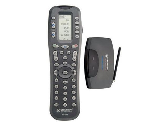

The MX-500 remote is a good one with a very strong dual emmitter IR transmitter. I would suggest you should just upgrade to a newer remote with built in RF and IR. Here is one example that I use and with the RF repeater I can control any device from half a block away lol.
http://www.newegg.com/Product/Produc...82E16880120001
