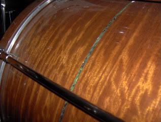

If you go with a tube design please look at Tape-Ease. They have plywood (like drumshells) cylinders available veneered and in sizes of 28"dia x 54" and 24" dia x 96". Reasonable prices. I'm thinking about using them.
I remember looking all the options two years ago on the Tape-Ease site and I think the larger sizes cost a LOT more to ship. if its over 24x27", they can not ship it UPS meaning its a expensive shipment I think.
I still thought it was pretty cool option!
