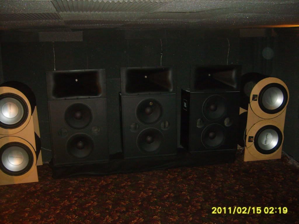

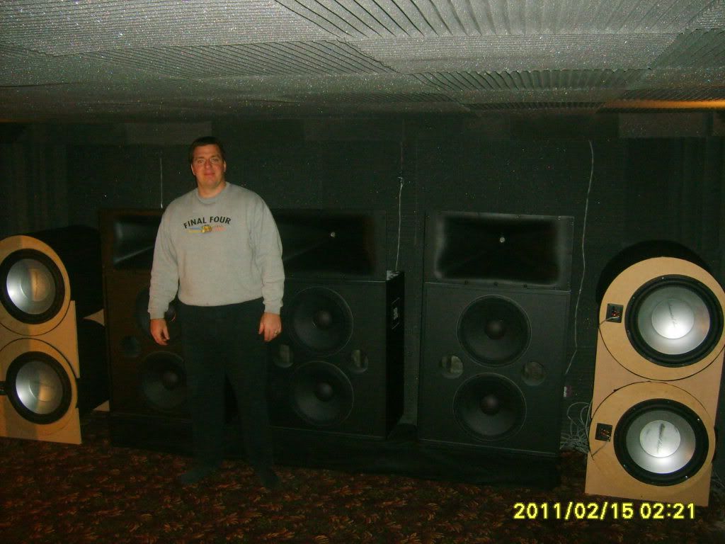

What I was trying to do with this foam I accomplished. I just ran the Dark night at reference levels and my wife said she could barely here it anymore from upstairs. I already built my room with sound board and insulation to sound proof it. I have more serious issues now and I need help. I ran all 8 subs and the bass was hardly there. I am splitting my sub out 8 times so I am either having a low input problem or cancellation problems. I will run just 2 subs(front and rear) and see what cancels if any. When I ran the 8 subs I had 2 in each corner, I will post pics. Anyway, I ran just the 4 back subs and the bass was fantastic. I watched the Dark night. Very articluate, more so then the ported ones. They have more midbass slam as well. I have not tested them with WOTW or Anything else but I will. I just need to get all of them going. Here are some more pics

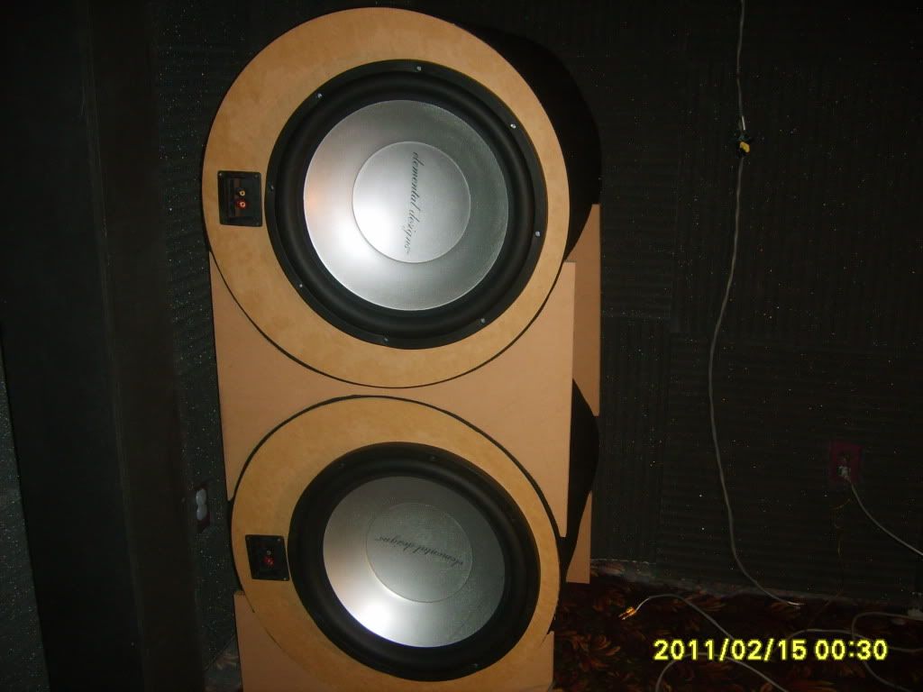

This is how my front left subs turned out.
The new front stage
There I am for size reference, I am 6'3" and 275 pounds
Here are the 2 more subs in the back right corner and then 2 more at the back left corner

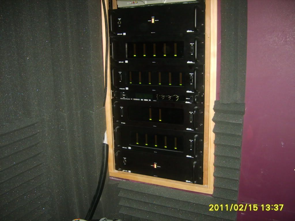

Here is my rack with some new additions, a 6 channel amp and newer processor
