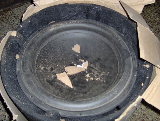

Today is definitely not my day. I just got out the second Maelstrom-X and was going to put it in my cabinet, the frame is cracked and bent. Looks like the driver was trying to chew it's way out of the box. At least it doesn't rub.
13.5megs full res hosted on SkyDrive: http://cid-25586ae8216fdb6f.skydrive...e/DSCN3548.MOV
This is ********, makes me wanna go postal, but my delivery drivers are cool, so I got no one to be pissed at. I really feel for Kevin in a situation like this, personally I'm wouldn't want to deal with this type of crap. I spoke with Kevin earlier today about something that didn't require a RMA or damage claim, and He is great to deal with.

Originally Posted by Kanaris View Post
How was your Maelstrom-X packed? I know when I ordered my Tempests from CreativeSound they shipped them packed in premolded Styrofoam ... there was very little chance of them getting damaged...
It's some die cut foam, looks nice actually:
apparently it took a hit that split the layers allowing the driver to chew it's way out
I'm not looking to send it back unless Kevin wants to make a DHL claim or it behaves badly.
Dan
