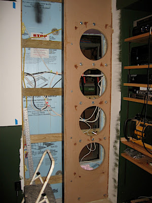

penngray, I see how you used a roundover bit on MDF, I did that for my basic AV closet back doors and found the router cut induced stress onto the MDF and it warped slightly over time, hopefully yours does not show that. A noob mistake, that's why the pros make panel doors for no warpage, mine work for now, slight but you can see it.
Seen from adjoining rec/play room:
