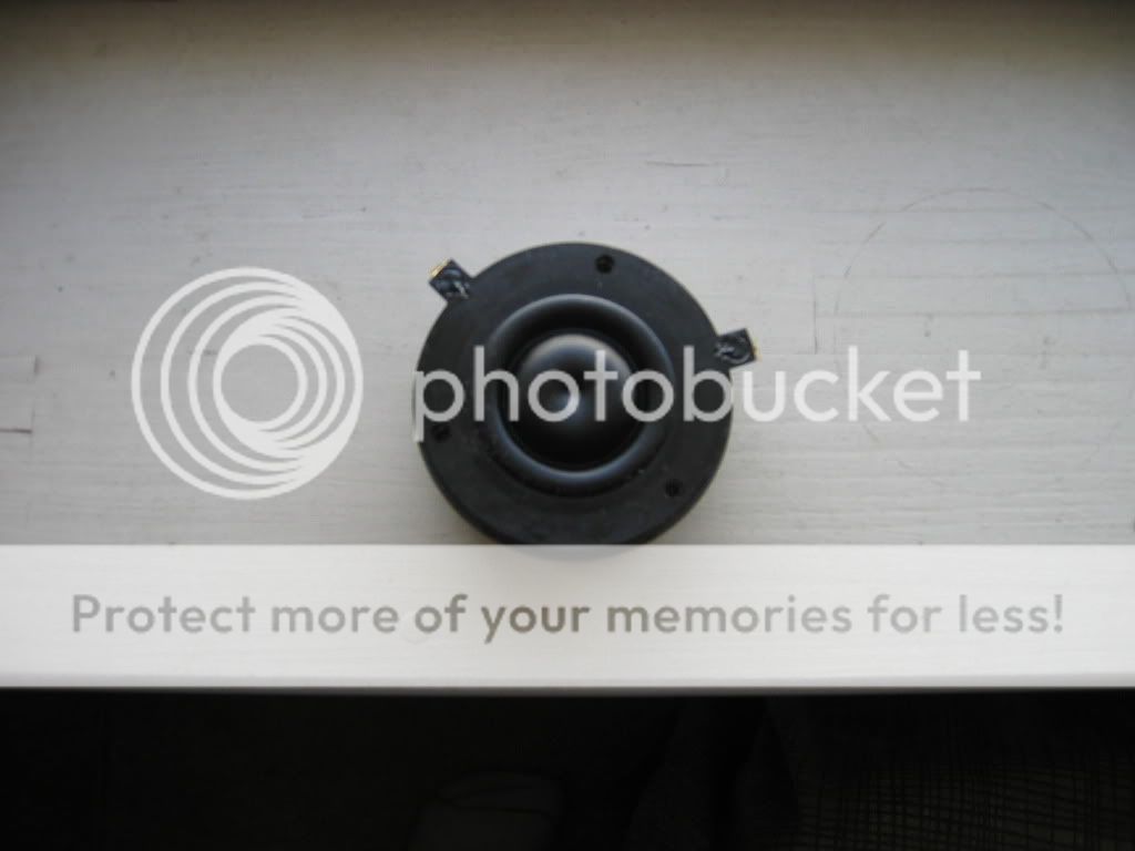

As promised, we'll start with the Deltalight 10. A pretty well made driver all around. Fit and finish are better than i expected and extremely light
The cone has a very slight blue tint to it
Notice the vented pole piece
And the Waveguides
They're kinda flimsy and will probobly require some mass loading of some type
Hopefully the QSC guides will arrive tommorrow. The plan is to route a cavity into the baffle that's 2" thick just in the area that will hlod the tweeter.....faceplate removed of course. With a bit of foam behind the tweeter, should make for a solid mounting point. Then, depending on the finished depth of each guide after machining to get the opening at the right diameter, i'll mount the guides to an overlay baffle and overlay it. Just got finished cutting some MDF panels and drilling the router guide holes using a template this way everything will line up. Did a couple of thinner sheets as 'shims' so to speak.

Mayhem what holds the SB29 diaphragm to the rest of the driver? The three screws you removed for the faceplate? I just ordered the new neo version since it doesn't seem to have the same mounting system as this one and may be easier to screw to the back of a baffle/waveguide.
augerpro is offline

It appears it might be glued on but i'm not going to investigate it either as it doesn't belong to me. The Neo SB29 looks interesting and even a bit more efficient too.

Ooh, that's good to hear. Should be super easy to route a shallow waveguide from wood to move the AC back.

No worries Penn, the diamphram is mounted to a plate which is fixed to the housing somehow and the screws that fixed the faceplate can be re-installed and wil keep everyhting in alignment.
