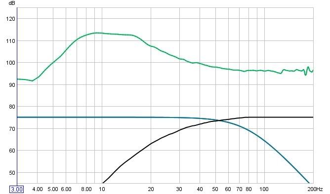

Hey guys, I don't use any eq whatsoever. I did not boost the low end, that is with my lfe settings about 10 db's lower than my other speakers. I have what you call crazy room gain down low. That is the reason I went sealed. Look where the peak is, 7-25 hz. Room gain is great down there because that is the infrasonic stuff.
NEO Dan, I could only assume that my processor lets the lfe go up higher than 20 hz and full range so I have some overlap and why it peaks around 20 hz then add my room gain which is significant. My question is it possible to bring that down or bring my other speakers up. It sounds fantastic on full range with more clarity than ever. I gained more defined punch but lost spl in the punch area. Any suggestions?
It depends on what your goals are but the easiest way to flatten the combined response would be to move the crossover back up above where your room gains starts, say 60Hz or higher. Then you'd only need a single EQ on the subs to flatten them out -- IF that's what you want. I'm not a big fan of a 'house curve' that boosts the lows but some people like it.

Is a house curve typical of boosting 7-Hz or higher than that? Can EQ tame 7-20 Hz?
My graph for my crossover at 80 Hz and all speakers small.
BTW I tried lowering the bass(sub out) 10 more dB's and it did flatten out. What makes it weird is that it makes my subs or sub out's trim level 25 db's less than my other speakers which is far from flat when using test tones.
Sure, your response is flat from 7-20. You just need to adjust the stuff from 20-60 to match it and then set the sub level so the overall response is flat. If you're using pro amps for the subs, you can use their gain controls to help balance things if you don't have enough trim control in the prepro/receiver.

Yes, I have done this since(with processor trim lower) my last post.
Pro audio woofers like the ones used in your mains are of better quality than the ones in your subs.
So your room is 100% sealed with nuclear submarine like doors? How do you get oxygen in there? lol
Can't you just increase the gain for all your other channels leaving the subwoofer channel intact on your processor? I had a problem with using a yamaha PA speaker as a center, it was way too efficient needed to bring all my other speakers up and had the PA speaker at the lowest possible setting, about 9db difference.

MK's gain is really because his room pressurizes very easily. Sealed rooms have that trait....to tame it he should maybe keep the doors open.

Penn, Great suggestion, I will open the doors and then take another measurement, too late right now for high spl sine wave test, shakes the house more than movies since very low frequencies are guarenteed. I did lower my LFE trim and it did reduce the 7-20 hz level anyway. My processor can lower the trim of anyway speaker as far as need be so I don't have to touch the gain on my amps.

Thanks DL
I think you'll be just fine with those drivers, especially since you intend to HPF.
MK,
can you post just LFE and just fronts, that may make things easier to look at.
Also take care not to go too low or high with the digital trims you can run into SQ problems at either end of the adjustment ranges, digital clipping and muting if you drop below the least significant bit(noise floor).

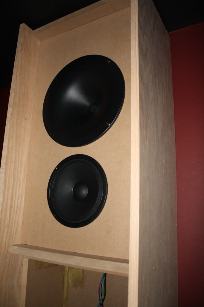

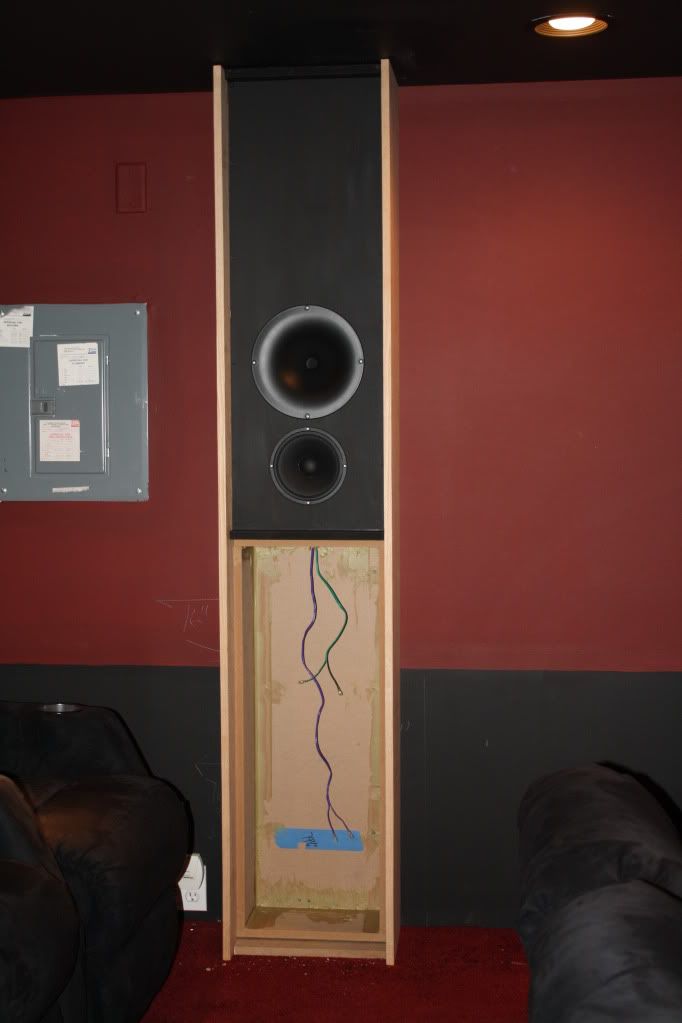

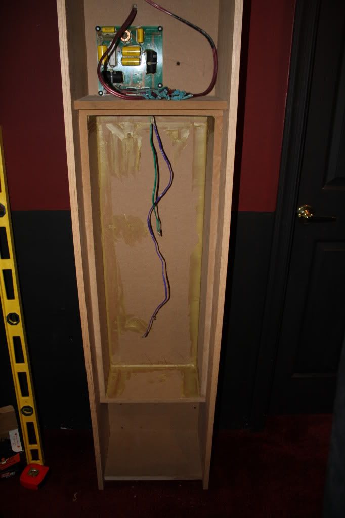

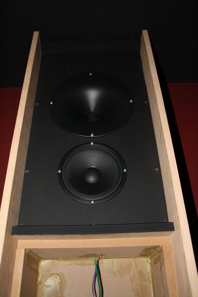

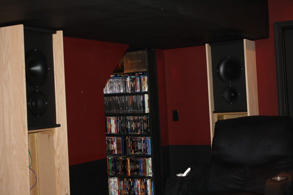

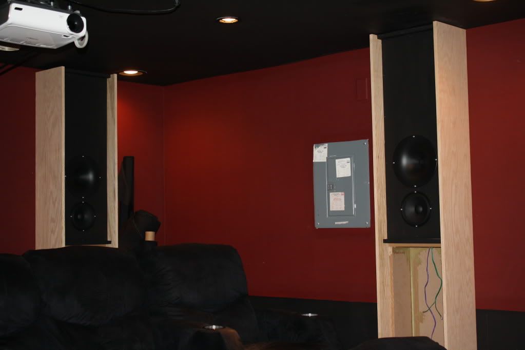

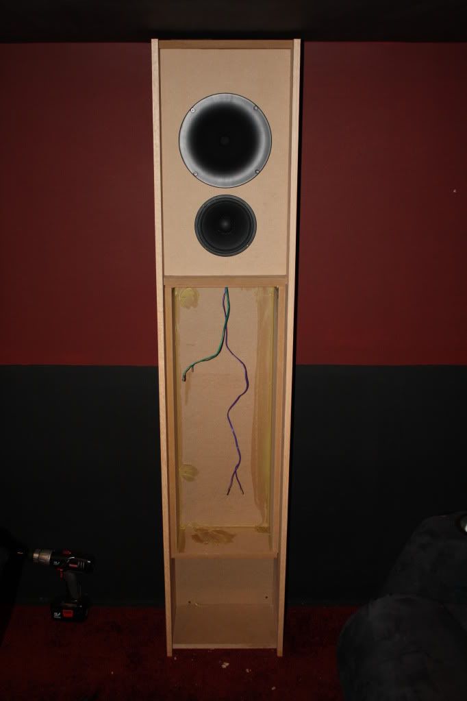

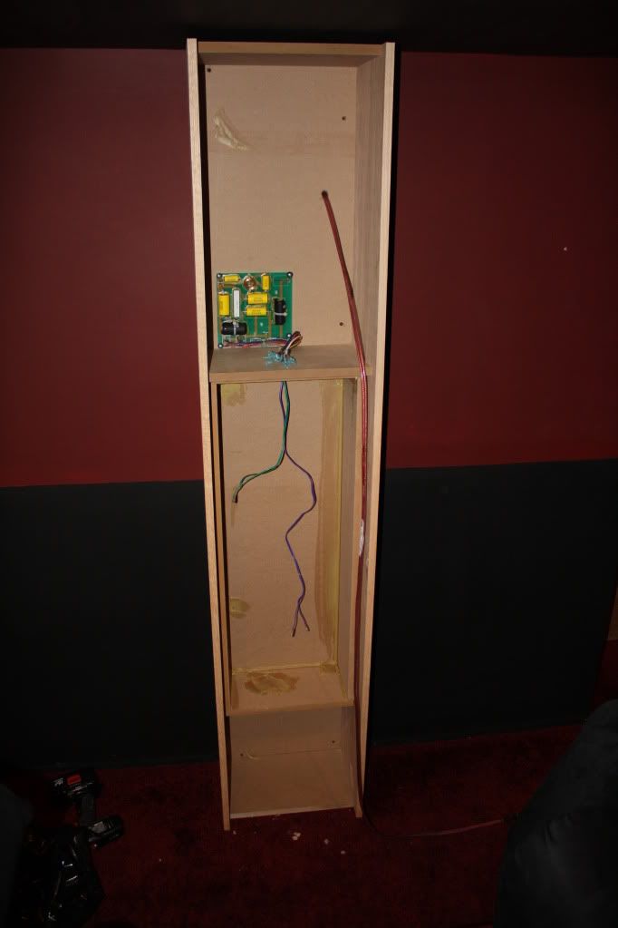

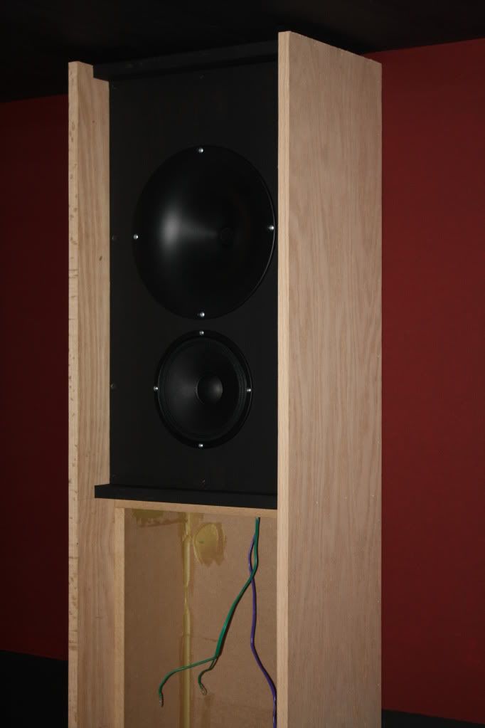

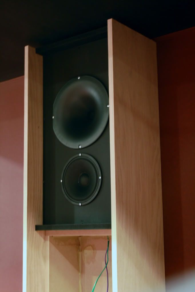

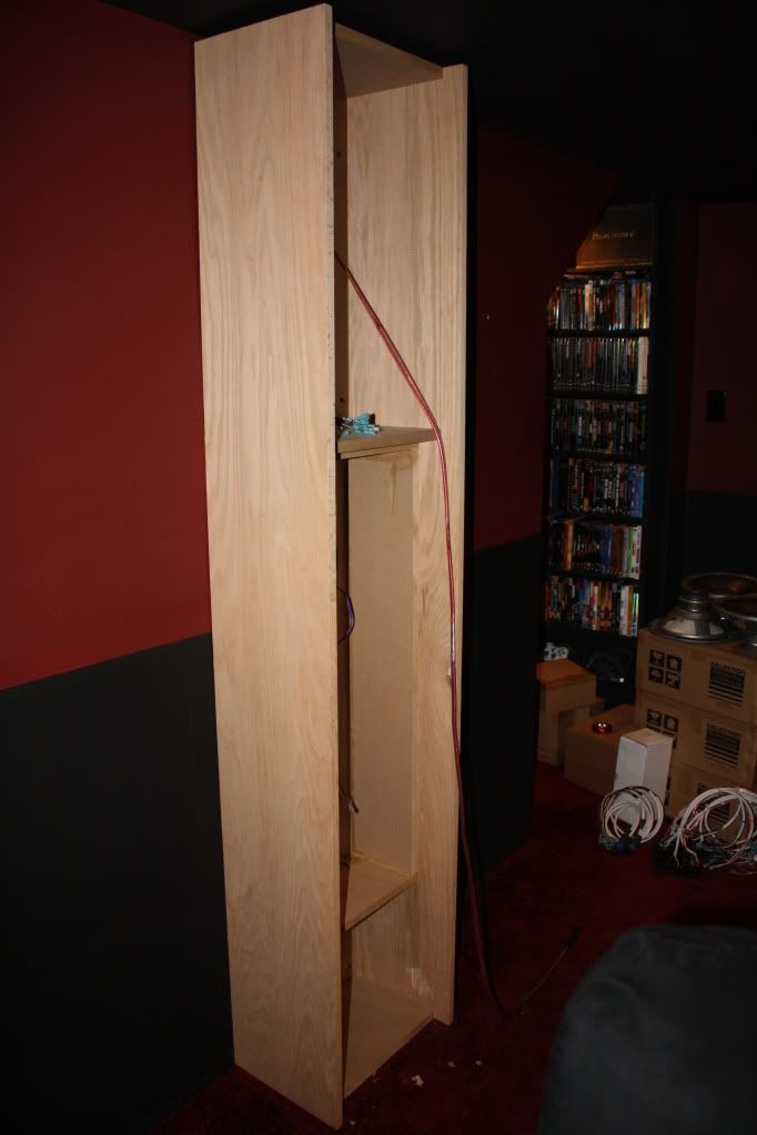

Here are some progress pics from the rear surround build. The xovers, comp. drivers, and mid are from the SC-2150. The waveguide is from the HPR-122i. The woofers are Dayton 12" DVC's.
The woofer portion will now be sealed since I'm dealing with small enclosures (< 1.8" cu. ft.) and needed to be retrofit into the existing columns. Also, all columns will have black fabric grills inside from top to bottom to protect and fully conceal the speakers.
Again, please pay no mind to unfinished theater. There's ALOT missing including fabrics on wall, star ceiling, trim, treatments, etc... basically all of the good looking stuff. Walls are temp painted.
More details to follow.
Rear Surround Speakers

Hi chucky08016,
From the photos, it looks like you intend to use the QSC2150 crossover for your surrounds. If so, you may want to rethink that as the crossover needs to be designed for a specific enclosure and set of drivers. But maybe I'm missing something.
Mike
mikela is online now
post #89 of 220 Old 10-19-2009, 10:52 AM - Thread Starter
chucky08016's Avatar
Posts: 719
Originally Posted by mikela View Post
Hi chucky08016,
Mike
Hi Mike,
Thanks for looking out.
I'm working within the limitations that I have and I didn't want to incur the added expense of having new xovers created just for the rear surrounds.
So far, the surrounds blend perfectly with the front mains and sound great without any adverse effects from changing enclosures and woofers. Even the woofer chosen blends perfectly.
I understand that alot of people will look at this thread and not agree with some of the design choices... that's ok... for me, as long as the end result sounds great and the speakers disappear then I've succeeded.
Trust me, after demoing unreal soundtracks such as Transformers 2 (BD), Star Trek (BD) or musicals like Moulin Rouge (DTS DVD) I can truly say that this setup is a keeper!!
DVD-A music such as Linkin Park's Reanimation (5.1 surround) is not just music anymore, it's an event unmatched on this setup.
chucky08016 is offline
