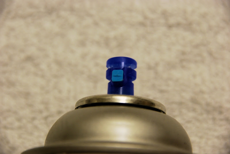

The actuator/nozzle style on the left is likely to atomize better than the one on the right. The left one also produces a "Fan" spray, while the one on the right produces a "conical" spray pattern.
This one also allows for adjustment of the fan spray, by rotating the light blue center, to obtain a vertical or horizontal fan spray.
The better quality aerosol tip can help to a certain degree.
Unfortunately, the two tip styles are not interchangeable.

I am a former automotive painter and still do some custom airbrushing in the motorcycle field. You should never let your paints or any of your paint related products get near the freezing point. They may look fine when you open up the can but it is just an accident waiting to happen. You can waste a lot of money on wasted supplies, not to mention all the time it takes to redo a job when it acts up on you.

Lennon, I agree with Secret Squirrel. Use your imagination and find a place to store it indoors to avoid problems, or it is wasted money.
Product Details
Recoat: after 2 hours
Dry Time: 24 hours
Cleanup: warm water
Coverage: 125 square feet per quart
Coats: 3
Recommended uses: furniture, cabinets, floors and doors
FAQ (From the MinWax website)
Q: Can I apply Water Based Oil-Modified Polyurethane over Fast-Drying Polyurethane (solvent based) or vice versa?
Yes. The two products can be applied over each other as long as the first has fully cured.
I recently happened across a website that was clearing out some wet/dry sandpaper for good prices--just before my computer crashed.
I'll try to find that site again and post a link when I find it.
What I did for finishing the finish, was I sanded to 400 grit before applying the final coat of the finish.
Then, I used ScotchBrite pads to wet "sand" to the equivalent of #000 steel wool, followed by buffing with Meguiare's Show Car Glaze Coat #7, followed by an application of Meguiare's Gold Classic car wax.
PassingInterest is offline
