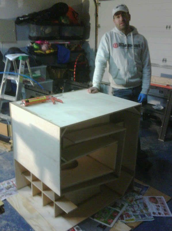

The horn is really starting to take shape now! This being the 30" wide version it sure does sit tall when piecing it together!
superedge88 is offline

It's looking... well Super!

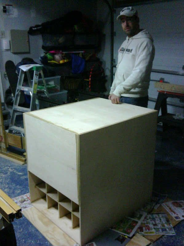

Another pic.
This is where we stopped for the night, after the next build session we should be just waiting for glue to dry then actually be able to test this SUPER THT!!

I may be seeing things, but.... Did you cut the driver hole? I can't see it, maybe it's because it's the 30" version?

Yeah then I went back and edited my post.... I had to go back to the first page. Like you , I was thinking of our 24" builds.

LOL, yes it is because this is the 30" wide version that from this angle the driver hole can not be seen. If you look at the past pictures I posted you can see the driver hole in at least one of them. EDIT: I see you already saw that as I was typing.
A BIG TIP: For thos wanting to build a THT, make sure that you seal on the under side of the T nuts really well, I am sure that there is a good possibility of air leaking if you don't have them quite glued in very well. I used epoxy to glue mine in, then used PL around the edges of each T nut to make sure that absolutely no air can leak around them. Better to be safe than sorry, it would be a huge pain to have to try and seal on the horn side once this thing is all put together and glued.

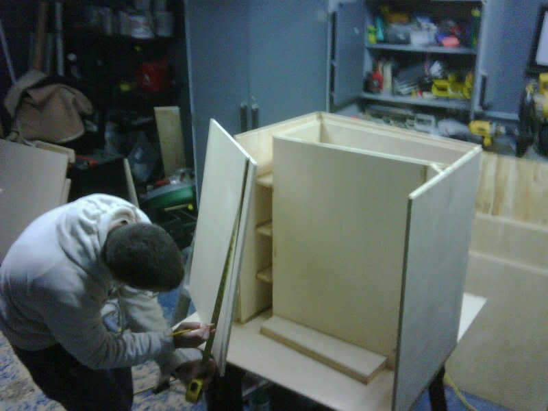

Back at it again!

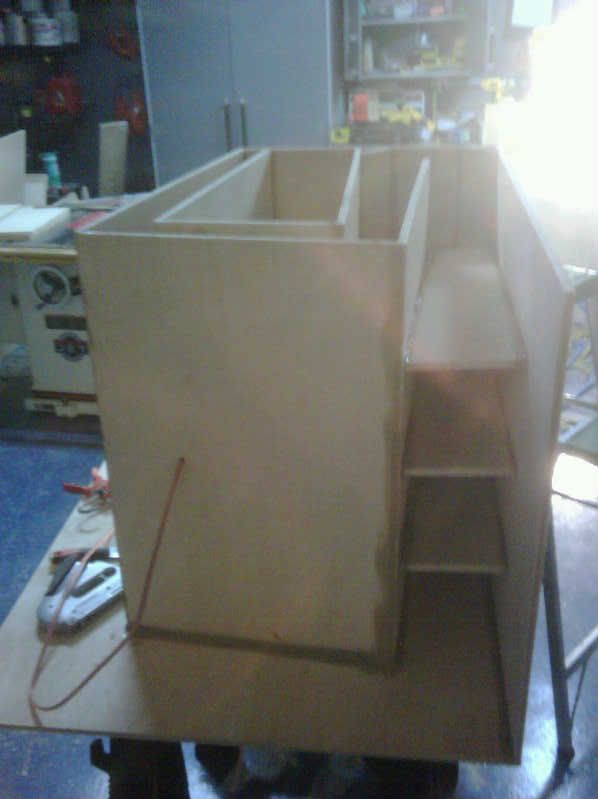

Just one more turn to make!

Starting to look like a true beast!
