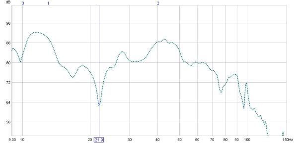

Today I decided to fight the laptop in the name of bass
I got these graphs with an SPL meter and REW, but I forgot to have the meter calibration file activated for all the measurements. Is there a way to go in afterwards and fix it?
What I can say is that I still have a bit of the tube resonance (98hz). Would more padding help the sound, really?
In the outdoors measurements, I seem to lose a bit of output in the low 20hz high teens. Inside, I also lose a lot here, with a bump at 27hz. The 40-50hz range is a big peak.
At 1 watt/meter outside (ground plane WinISD?), I get 84dB sensitivity (not 90? Whatttt?), and then it gets down into the mid-low 70s in the 20s and teens? What is the meaning of this LOW sensitivity? It's nightmareishly low?
Any ideas on the sensitivity (corrected). Is it a problem with the enclosure or the driver? A nearfield of the driver looks correct, save for a bit of resonance at 98hz. Same with the port.
So what is the deal here? Am I losing output somewhere?
My room also seems to have a bad low freq problem <.<<br />
Get more data... fix the problem
I don't know how you are arriving at a sensitivity figure, are you using a digital multimeter to get voltage?
The 98 hz resonance will be healed with absorption in the box, yes, that is possible with a big, long sonotube, infact I had one very similar.
See here: http://www.avsforum.com/avs-vb/showthread.php?t=1141956
Ok. Measure the box outside at 1 meter from the cone, and then again 2 meters from the cone, outside... you will get two different curves. The 2 meter curve will look a lot smoother without a big hump.
The port and driver will be a lot closer path length to the microphone, when you measure farther away.
Most pro stuff is measured at 10 meters with 28.3 volts input and calculated back to 1 meter / 2.83 V.
I can't say that the Rat Shack or even the Galaxy meter is accurate at low frequencies.... even the Behringer ECM8000 I don't trust down low, unless you are measuring with a lot of voltage into the cabinet. IE: almost full tilt operation.
Gain structure in REW matters, especially when you have multiple gains as some of us do. If your soundcard clips, or in the case of ECM8000 mic / mixer, if you clip that it will affect what REW measures.
"What the heck was that crashing noise?" Me: "oh, just tossed the shampoo bottles off the shelf on the opposite side of the house. "
michael hurd is offline
The 98hz resonance will be healed with absorption in the box, yes, that is possible with a big, long sonotube, infact I had one very similar.
Hi, thanks
Yes, I am basing the sensitivity figure on 2v input (4-ohm driver), so unless the sensitivity is always based on 2.83v, even with 4-ohm, it is 6dB low. Otherwise, it is right on the money...
I tried measuring the subwoofer at 18v and noticed the smoothing of dips and peaks, but I did not save the measurement.
After correcting the data of my outdoor measurement, I found the response was actually pretty close to what I modeled, except for somewhat of a dip at 23hz.
I use a pre-amp between the meter and the soundcard input to give full input before clipping, thus maximizing S/N ratio and accuracy as much as I can..
I am continuing to experiment, but trying more spots for the subwoofer would be tiring. I've moved it over 10 times already and it does get tiring. However, I have only had it in one spot since I got the SPL meter. It may be worth trying more spots..
Everything I have tried so far seems to point to EQ and a second subwoofer before getting more power. I think making better use of the power I have would be more advantageous than brute force.
Off to read that link..
EDIT: Yes, I have read that before. It is weird because yours measures very well and mine does not. I don't know if it is a measurement problem or sub problem..
arande2 is offline

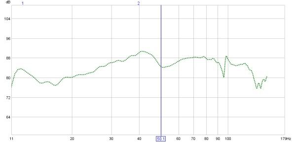

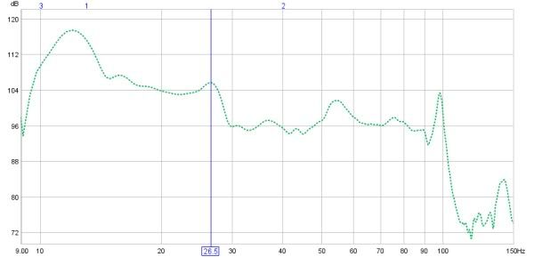

Some graphs to aid...
The measurement I got outside... 1 watt of input...
Nearfield measurement of subwoofer driver before raising tuning to 15hz, 80hz low-pass
Nearfield measurement of port (not absolute SPL)
In-room current ilstening position, 4 watts input, 80hz low pass. I think you can see the problem...

post #72 of 144 Old 01-24-2010, 07:58 PM
michael hurd's Avatar
Posts: 2,174
Quoted: 40 Post(s)
Liked: 39
[quote=arande2;17995056]
No, I was doing a diagonal 1 meter to driver/port, but I am guessing on the ground farther away is more accurate (in terms of absolute spl and relative spl)
Since I don't know what you mean, probably not. If you are asking if I am using the left channel to measure, yes.
Is this because of background noise, wind, etc..?
I still think 2 subs will be needed (weird pressure difference between ear) so I don't get distracted by noises (rattles etc..) where the subwoofer is...
I was planning on more power and EQ anyway
Yes, I broke it in for 3 weeks.
I assume you mean what the VU meter says on the input without any signal. -42dB
Pro stuff is measured farther away to get away from the 'velocity' issue that will affect the measured FR. Tom talked a bit about this issue, but I don't recall where the post was placed.
Place the mic on the ground when measuring the cabinet outside.
Measure on the right channel, and tick the box that says "use left channel as calibration reference" You will find this under 'settings' in REW.
I use an RCA>RCA cable that physically connects the soundcard output on the left channel to the left channel input. This is what is meant by a 'loopback'.
Yes, I was meaning that outside wind noise, trains / traffic will affect the measured FR down low.
Use the sine wave generator in REW to sweep for rattles and go around, fixing them. Rattles will totally ruin the perception, fix them or you will go loopy...
A little bit of thin foam weatherstripping tape can do wonders for hanging pictures, etc.
Can you post graphs of the measurements with the suggested settings for REW? 15-200 hz, 45-105db. Alternately, you can PM me, and I will give you my email, you can send the .MDAT file ( measurement file ) and I can take a look at it.
Some absorption inside the sonotube will be needed to kill the end to end resonance.
42 db noise floor is pretty decent, you should be able to get relevant measurements.

post #73 of 144 Old 01-25-2010, 12:09 AM - Thread Starter
arande2's Avatar
Location: Omnipresent
Posts: 529
Cool I'll see if I can try that stuff (not sure my input is stereo... )
Funny you should mention trains/traffic and wind noise... When I was trying to measure 3 trains went by and it was rush hour, plus it was windy Needless to say, it took a while to get a good measurement. But now that you say it should be on the ground, it's a moot point.

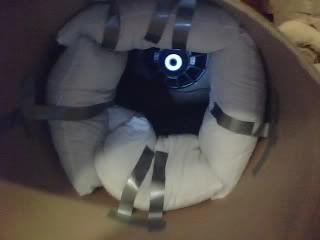

Speaking of absorption, I got some pillows and put them in there. It took care of the resonance
The top endcap already had some foam on it, but it probably did almost nothing being at the end.
I measured the driver again and it showed what I expected (less of a dip at tuning due to higher absorption (and slightly lower tuning), without the nasty resonance. Also it gave a slightly smoother response, but the weird dip around 30hz is still there.

Arande, I took a look at the picture you posted, and it's really not that bad indoors.... you don't have a lot of gain down low, but if you pull that 40~ hz peak down a bit, you fit within a + 3db, -3db window from about 17 hz to 70 hz which is quite respectable, as long as the measurement is valid.
Don't forget that the shape of the graph will look a lot different when you set the graph limits to the REW defaults, 45-105 db, and 15-200 hz, the peak will 'look' a lot less than what shows up in your settings.
I would do a bit of investigation with a sine wave generator parked at your 22 hz dip... something must be vibrating sympathetically to get that deep of a dip. If you don't end up healing it, not a huge problem because the bandwidth of the dip is pretty narrow... you'd likely never notice it.

Thanks for taking a look at it and reminding me of that
I will do what I can about the dip.
My main problem right now is the 14dB efficiency problem. (equal to less than one 20th of the power). That's like...err...uhh... not good!
I also found that turning it on its side either A) got rid of rattling or B) made it quieter... I think it was B.
Also I am getting a (corrected) reading of 102dB with one watt at tuning at the port (15.5inch/8.5inch ratio)
