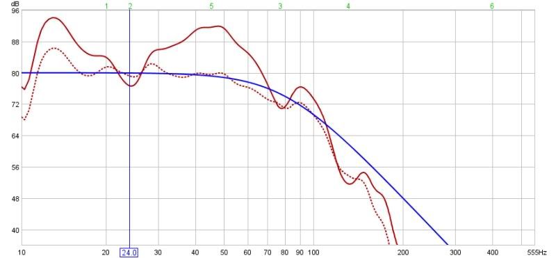

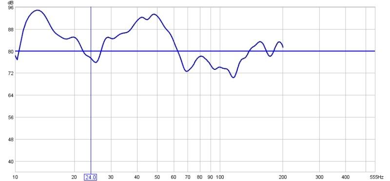

Sub + Speakers
That is the response with the sub closer to the corner than my previous graph and I believe the tuning is higher (14.5-15hz) this time.
Sub only
This is the sub response with the estimated response of one possible BFD filter setup.
I have found that the reason for the respone dip in the mid-low 20s is because the wall by the sub likes to really vibrate in that range
(it barely vibrates except for 22-26hz)

Originally Posted by michael hurd View Post
It sounds like the 'experience' or feeling you are looking for isn't what you can generate with the current device you have.
1) The room is lossy, the output from the device is being dissipated in >10,000 cubic feet, and every surface that sympathetically vibrates will be robbing you of output at low frequencies.
2) You checked outside, and noticed that the output scales pretty linear with the input, so it's not the subwoofer driver. It is working as intended, but it's design band of operation is also where your room is the most lossy.
3) Impact, that kick in the chest / punch feeling is much higher in frequency than the subwoofer you built is designed to reproduce. Not that it can't do it, but it will be a lot less efficient than something like a pro sound oriented cabinet.
4) Output @ 40-80 hz is less likely to be absorbed by walls, ceilings, floors etc vibrating because it's generally much higher in frequency than the panel natural frequency ( how well they are made, how tall / long / thick, supports etc )
5) Cancellation between subwoofers and main speakers. Ported speakers have a rapid phase change around tuning. If your main speakers are ported, and the transition to a subwoofer isn't great, you will also loose energy around the upper mid bass. ( not much impact )
Depending on your desired crossover point, tuning point of the main speakers, etc, you may be able to eq the main speakers rolloff to simulate that of a sealed speaker, and achieve an easier transition with less cancellation.
I hope this helps. Can you rent a pro sound subwoofer to try it out to see if it will meet your needs?
Yes, my thoughts as well.
My mains are tuned 43hz, I have them crossed at 50. The resulting response is flat, but is it possible that a cancellation should still occur and I would lose energy somehow? I doubt it. Bumping the freq response and trying other things does not seem to work.
I've been wanting to try a pro audio sub to see, but it costs too much right now.
I never glued the top cap on the sub, and so it popped off a bit from bass and vibrates loudly. I should probably do something about that.
