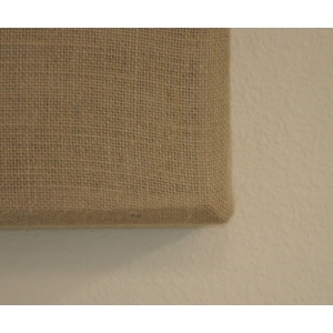

I bought some ATS acoustic panels that I think are very nice...
The build quality is pretty good and simple. I would attempt to build these if I was you.... Its a piece of luan, (thin hardwood ply) for the back, then on the front you take 1x2 pine all the way around. The Pine has a 45 degree chamfer on one edge of the 1x2, staple or screw the pine on from the back of the luan. Then drop in your OC703 insulation and wrap with fabric - done...
The panels purchased come with these clips that make installation very nice easy and close to the wall....
You can buy these from ATS, and I highly suggest them.....
http://www.atsacoustics.com/item--ac...are--IK12.html
Chamfer bit
Here you can see the Chamfer look on the 2" thick panels...
