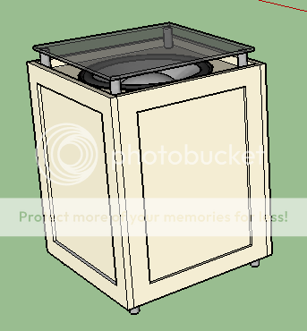

Hey guys, hopefully a quick question. I am going to move to an up/down firing design from the current design (need to change the boxes to match the new décor of the house).
I think WinISD is giving me a 2.535 cubic foot box requirement for a Qtc of 0.702 using Ricci's WinISD driver file for the AV15H.
I believe if I go with an 18" v 18" square baffle and a box of about 20-21" height using 3/4" ply that I'm achieving this spec? Seems to model to about 3 cubic feet of volume, and I'm assuming about 0.5 or so for the two drivers and dowel bracing.
Does that seem correct?

This is kind of what I had in mind, would match the built-in cabinets (would have the cabinet maker built 4 doors to size per box and just build the interior box myself).
Not sure how to get the aluminum or stainless steel dowel rods and affix them to a glass top just yet!

Hmmm ... I ordered a tempered glass top for my SVS SB-13 Ultra woofer from the States years ago, cost if I recall was reasonable (around ~$60 or so for a 17" or thereabouts square). For the life of me I can't find the place I ordered it from...

Could use thick plastic like lexan.
Nice choice. I use up/down dual opposed as well. Will be really nice.

Found the custom glass shop..
http://glasstopsdirect.com/

I would use glass myself. Also you can use glass standoff hardware like these:

Saw those (Can't recall where though ... have a link?). But I wasn't sure how they would be affixed to the glass hardware. Are they screwed into the glass, or would they simply sit on the outside edges?
