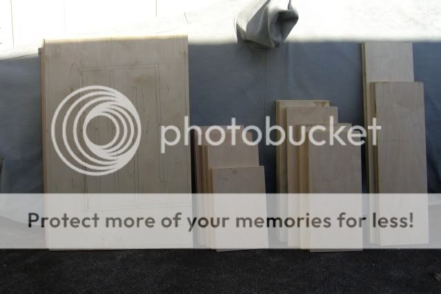

Over the past 2 days, I made some sawdust Here's a pic:
I cut enough birch ply for 2 cabs (1.5 sheets) I used your awesome cutsheets!. I'm waiting for the anarchy's and NHT amps to arrive. A big thanks to lilmike for all of his help and everyone else who made this a reality!
